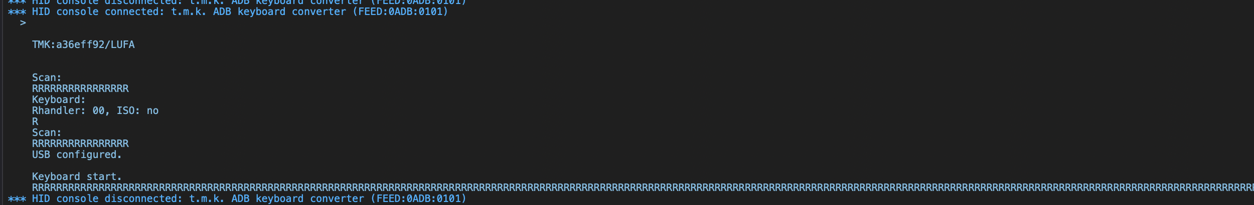

I've been trying to build a standard ADB-USB converter using QMK and a Pro Micro.
Started out using the standard layout from QMK Configurator and an S-Video cable I cut in half and soldered to the Pro Micro. Didn't get any lights on the keyboard or any functionality. Added an additional pull-up resistor between PD0 (Pin 3) and VCC. No luck. Tried using an S-Video socket wired to the Pro Micro and a proper ADB cable between the board and the converter. I get keyboard lights blinking on startup but then no keystrokes.
Tried using a manual QMK build with the console enabled. This yields "adb_host_kbd_recv: ERROR(-30)" over and over again in the console. This happens whether the keyboard is connected or not.
Keyboard and cables are known working (with Drakware).
Never had this happen when making a standard QMK converter... Any suggestions?

Try a sanity / hardware check by loading Hasu’s TMK ADB converter firmware on it.
raoulduke-esq
12 Apr 2021, 20:42
Muirium wrote: 12 Apr 2021, 20:01 Try a sanity / hardware check by loading Hasu’s TMK ADB converter firmware on it.
I feel less sane, but at least I got some better output... This is with no wires connected to the pro micro.

12 Apr 2021, 20:59
Need to hook up those wirrrrrrrrrrrrrrrrrrrrrrrrrrrrrrrrrrrrrrrrrrrrrrrrrrrrrrr…
raoulduke-esq
12 Apr 2021, 21:09
Should have mentioned I started with everything hooked up; same rrrrrrrrrrrrrrrrresult.
12 Apr 2021, 21:10
Bummerrrrrrrrrrrrrrrrrrrrrrrrrrrrrrrrrrrrrrrrrrrrr
Got another Teensy you can try? And are you using resistors for pull-up? If so, maybe they’re the wrong numberrrrrrrrrrrrrrrrrrrrrrrrrrrrrrrrrrrrrrrr

Doing a Pro Micro- gotta spend $5 on the 3-4 pin jobs instead of $20. I tried a different Pro Micro and added an external 1k pull-up (which I pretty much never have to do with a Pro Micro but I figured why the hell not) and everything seems to be fine both with TMK and QMK. Will throw the other controller in my "highly suspect" pile and see if it's good for anything else later.
Thanks for helping with the troubleshooting! I was too frustrated to consider such a simple fix.

I tried taking the dubious Pro Micro and adding the external 1k pull-up and then everything worked fine on it as well. Seems this is the one case I've encountered where a pull-up is absolutely required. Hope this helps someone in the future!
