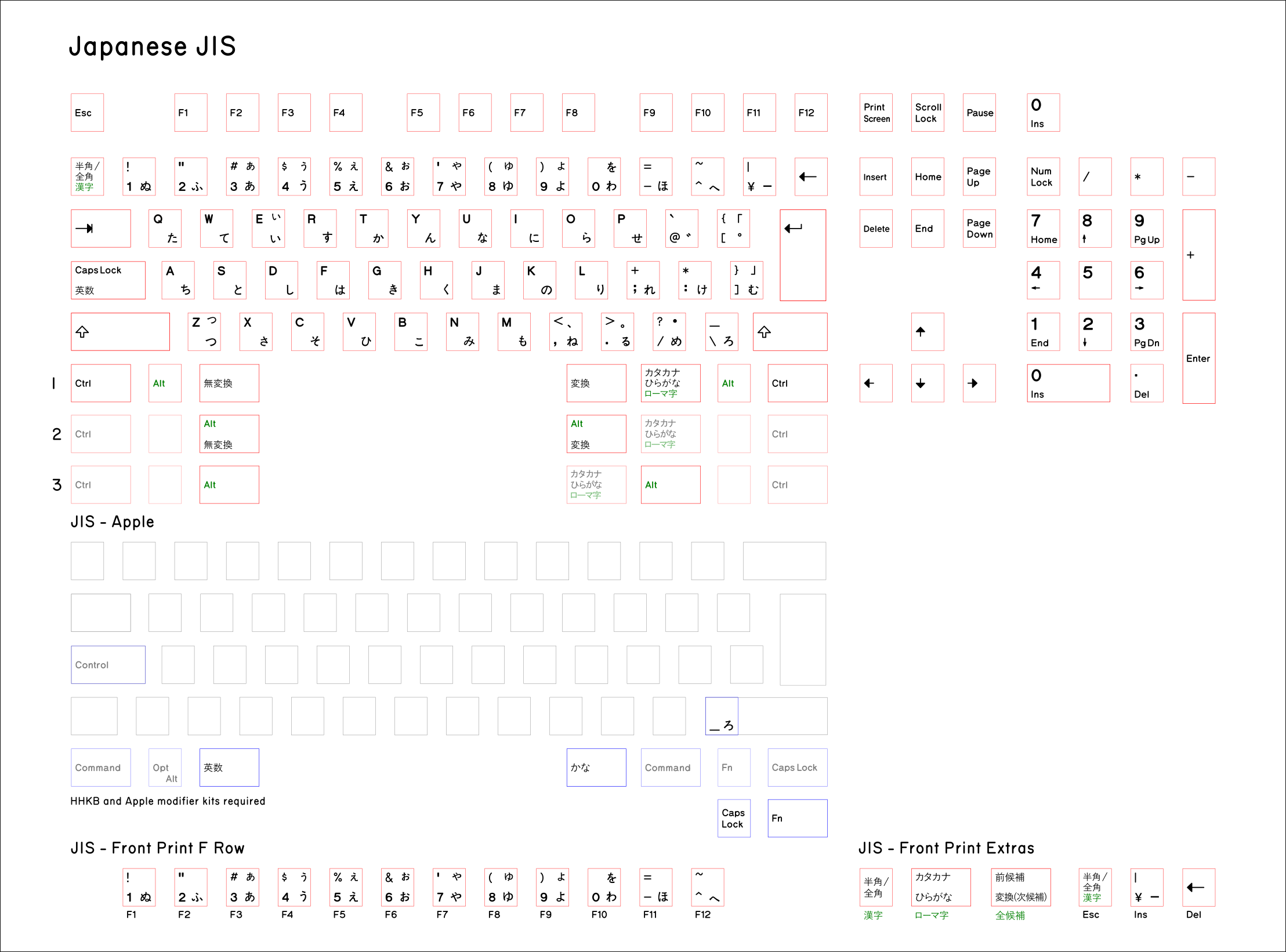

I have previously used the 5576c01 layout as a reference to create a keyboard layout. This uses a font that is much closer to Ishii Gothic than Yu Gothic. I can provide you with a print sheet that is almost identical to the 5576 layout if you ask me for help. This font is a bit tricky to work with, so if you don't understand Japanese, it will be difficult to handle. I also know all the keyboard layouts for the 5576 and have friends who like keyboards, so I can create a custom set that the Japanese would like.
I thought the Alt Gr key was used in Europe? I'm not familiar with it; it's not in JIS.
What I would like most is to have a short space key rather than a complex Japanese character layout. The "convert(変換)" and "no convert(無変換)" keys are not practical unless they are as easily accessible with the thumb (which may vary from person to person) as the space key. Because nowadays, the function keys and the spacebar can replace those functions. The Japanese have made the space key longer because they don't need to use the conversion and non-conversion keys as much anymore. But if the space key were shorter, those keys would be more useful.

I'd happily second a shorter space key, but unfortunately the previous example already seems to be using the shorter space bar style (the same as the one in JIS Unicomp layout) and I'm not sure it can come any shorter.

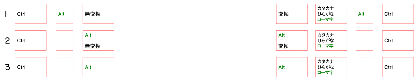

It is my understanding that the Japanese orders will have a 5.5U spacebar (Unicomp style) as I have been showing above. With what you and Dön have been saying about using longer spacebars it seems that option #3 would be a good addition?PRIPARA_PLAYER wrote: 03 May 2021, 13:58 I'd happily second a shorter space key, but unfortunately the previous example already seems to be using the shorter space bar style (the same as the one in JIS Unicomp layout) and I'm not sure it can come any shorter.
Ellipse wanted me to minimize it for the base sets so things would not be delayed while the factory works out the front printing. That is why the more accurate front printed stuff is in an 'Extras' set.PRIPARA_PLAYER wrote: 03 May 2021, 05:39 On a side note, your first three front print extras are also all keys I would plan to pick up. I'm not sure if you can't have front print in the default set, but if you can then my preference would be for the first two to be in there, and the third is to again match historical accuracy over modern keyboards.
As long as the option 1 keys are offered as extras I think option 3 is likely the best bet.
Edit: Actually, it might be better to swap alt and the hiragana key for symmetry and so the key is closer to space.

If you can get me the font and maybe an Inkscape or Illustrator file (like the picture you posted) with the characters typed out, I think we could figure it out. An Inkscape/Illustrator file with the font converted to outline paths could also work. My Japanese knowledge is not the greatest but I am used to entering characters using Unicode.:Dön: wrote: 03 May 2021, 12:31 I have previously used the 5576c01 layout as a reference to create a keyboard layout. This uses a font that is much closer to Ishii Gothic than Yu Gothic. I can provide you with a print sheet that is almost identical to the 5576 layout if you ask me for help. This font is a bit tricky to work with, so if you don't understand Japanese, it will be difficult to handle.
Sounds good.PRIPARA_PLAYER wrote: 03 May 2021, 17:22 As long as the option 1 keys are offered as extras I think option 3 is likely the best bet.

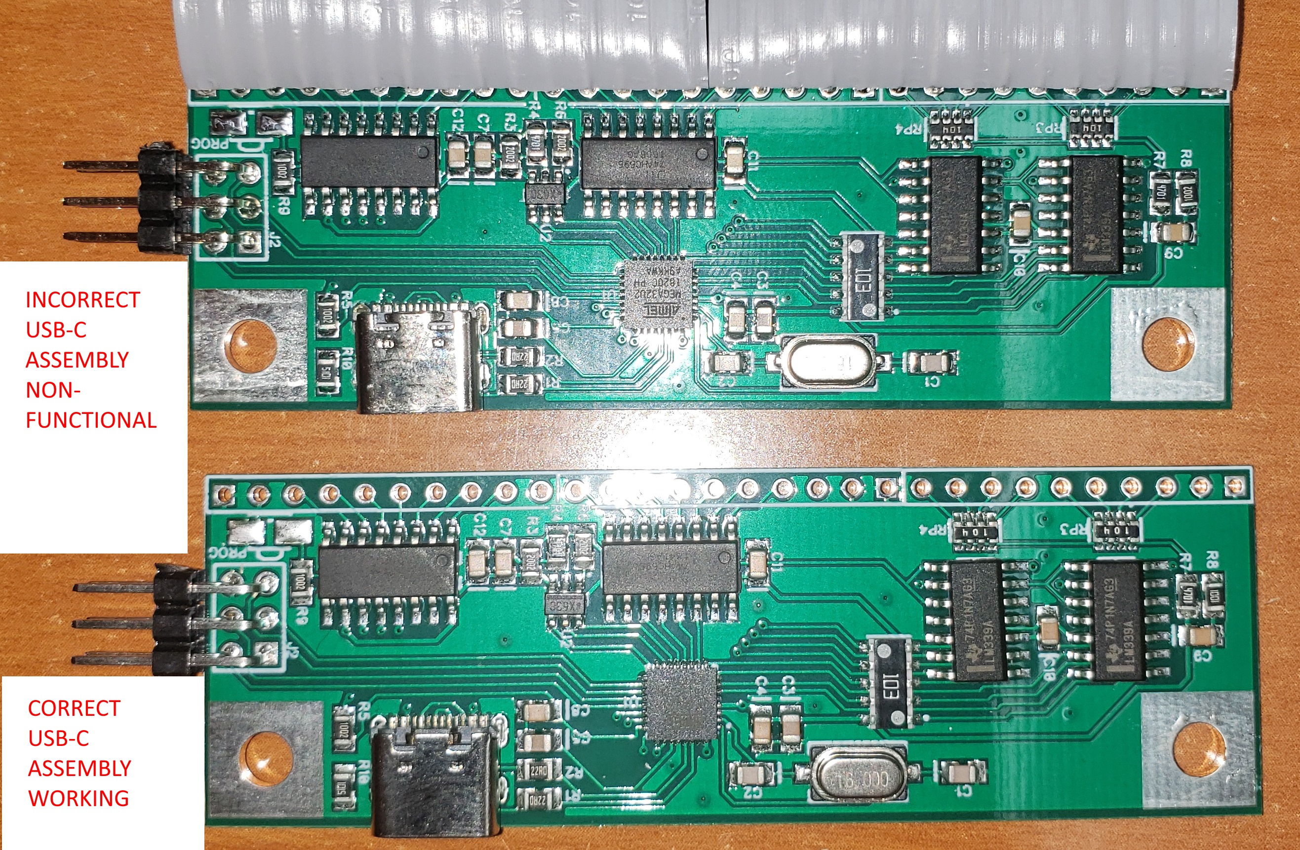

Question to reflow soldering / PCB experts: is anyone interested in a handful of (free) xwhatsit controllers that did not pass quality control standards? Example issues: row or column not detected, entire controller not detected by computer.
The controllers would be free and I would cover the cost of shipping in the US, with the only requirement that you make a good faith attempt to repair them and let me know in detail how to fix them, so I can pass along the info to the factory. Maybe you'd need to remove one working shift register chip over to another PCB and keep one or more of the PCBs as "for parts" units, for example. I'd also request that you fix and mail me back one or two of the many controllers I send over, just to show the factory that they are in fact repairable.
In the attached comparison, my suspicion is that the PCB on the top had its USB-C connector soldered at such an angle that caused the controller to not work. It just shows every gray dot as pressed in the xwhatsit capsense utility program, at any threshold value (xwhatsit's Model F testing PDF notes that a working controller should display no gray dots at the very first startup and should initially auto calibrate to threshold value 681). The one on the bottom is tested and working.

I think option 1 is the best. The proper length space key for Japanese is 2.5U. Maybe you guys say you can't manufacture this...Zed wrote: 03 May 2021, 17:20It is my understanding that the Japanese orders will have a 5.5U spacebar (Unicomp style) as I have been showing above. With what you and Dön have been saying about using longer spacebars it seems that option #3 would be a good addition?PRIPARA_PLAYER wrote: 03 May 2021, 13:58 I'd happily second a shorter space key, but unfortunately the previous example already seems to be using the shorter space bar style (the same as the one in JIS Unicomp layout) and I'm not sure it can come any shorter.
My font is a Chinese font and Japanese is not displayed. I think you need to know the difference between Chinese and Japanese to handle it. The same kanji will look different in Japanese and Chinese. If you send me the draft data of the print sheet, I may be able to provide it in outline format.

Now that sounds a bit complicated! If you can work with an Inkscape file, I can send you a file through the Private Message system here.:Dön: wrote: 04 May 2021, 03:42
I think we will be able to offer several bottom row options

lachmoewe
- Location: Hamburg
First time posting but I might be able to judge this. You are right, it does look like the USB-C socket is placed way off. Repairing this is nearly impossible, as the socket most likely uses 2 rows of SMT pads in very close proximity hidden from view. If there is a short you will not be able to see it.Ellipse wrote: 04 May 2021, 02:48 In the attached comparison, my suspicion is that the PCB on the top had its USB-C connector soldered at such an angle that caused the controller to not work. It just shows every gray dot as pressed in the xwhatsit capsense utility program, at any threshold value (xwhatsit's Model F testing PDF notes that a working controller should display no gray dots at the very first startup and should initially auto calibrate to threshold value 681). The one on the bottom is tested and working.
One solution to this problem can be to use a different footprint for the socket, with smaller holes for the THT shielding pins for tighter tolerances and less room for it to be soldered at an angle. Do you know if a two step soldering process is used with this part? Most fabs I know of solder the signal pads first in an oven and solder the shielding pins manually afterwards.
For further analyzation better pictures would be nice, maybe you can get a few macro shots from the side so we can see the solder connections. Can you state which exact model of USB-C socket is used?

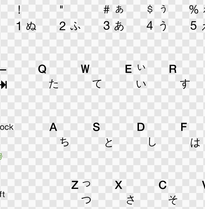

I got the new font from Dön and it looks perfect! Well done! I haven't updated the artwork yet but I had another question about the alignment of the some of the Hiragana punctuation.:Dön: wrote: 04 May 2021, 04:20Oh I see, I just created an account a few days ago so I didn't know about the private message feature.Zed wrote: 04 May 2021, 04:12Now that sounds a bit complicated! If you can work with an Inkscape file, I can send you a file through the Private Message system here.:Dön: wrote: 04 May 2021, 03:42
I think it can handle svg files and the like.

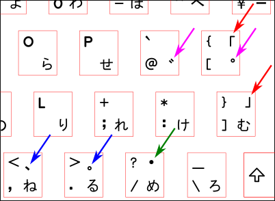

Blue : bottom left justified
Green : vertically centered, horizontally centererd?
Purple : top right justified?
Red : vertically centered ?, right justified?

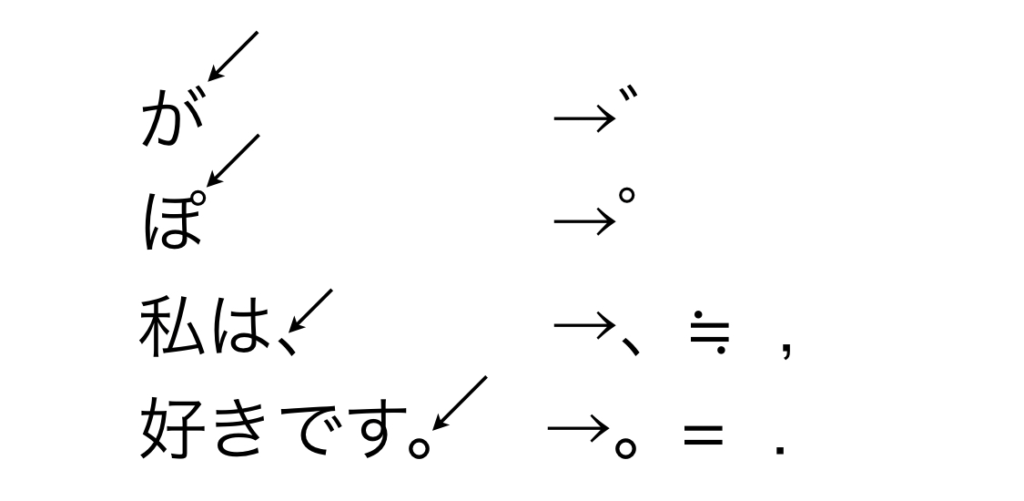

I think I have things correct but IBM does not agree. They seem to put the red and purple symbols left justified.
This is something where modern keyboards aren't entirely in agreement. IBM did left alignment and Lenovo still does, Realforce I believe does middle alignment, and some other companies do right. In this case my preference is definitely for left alignment to match IBM/Lenovo.Zed wrote: 05 May 2021, 00:49JIS punctuation alignment.png

PRIPARA_PLAYER wrote: 05 May 2021, 03:20This is something where modern keyboards aren't entirely in agreement. IBM did left alignment and Lenovo still does, Realforce I believe does middle alignment, and some other companies do right. In this case my preference is definitely for left alignment to match IBM/Lenovo.Zed wrote: 05 May 2021, 00:49JIS punctuation alignment.png
Thanks! I'll move things to the left to match IBM.:Dön: wrote: 05 May 2021, 03:12 I feel that the position of 」 symbol is inappropriate. This is one of the symbols for brackets in Japan. It should be treated like any other parenthesis symbol. It should be aligned to the left.

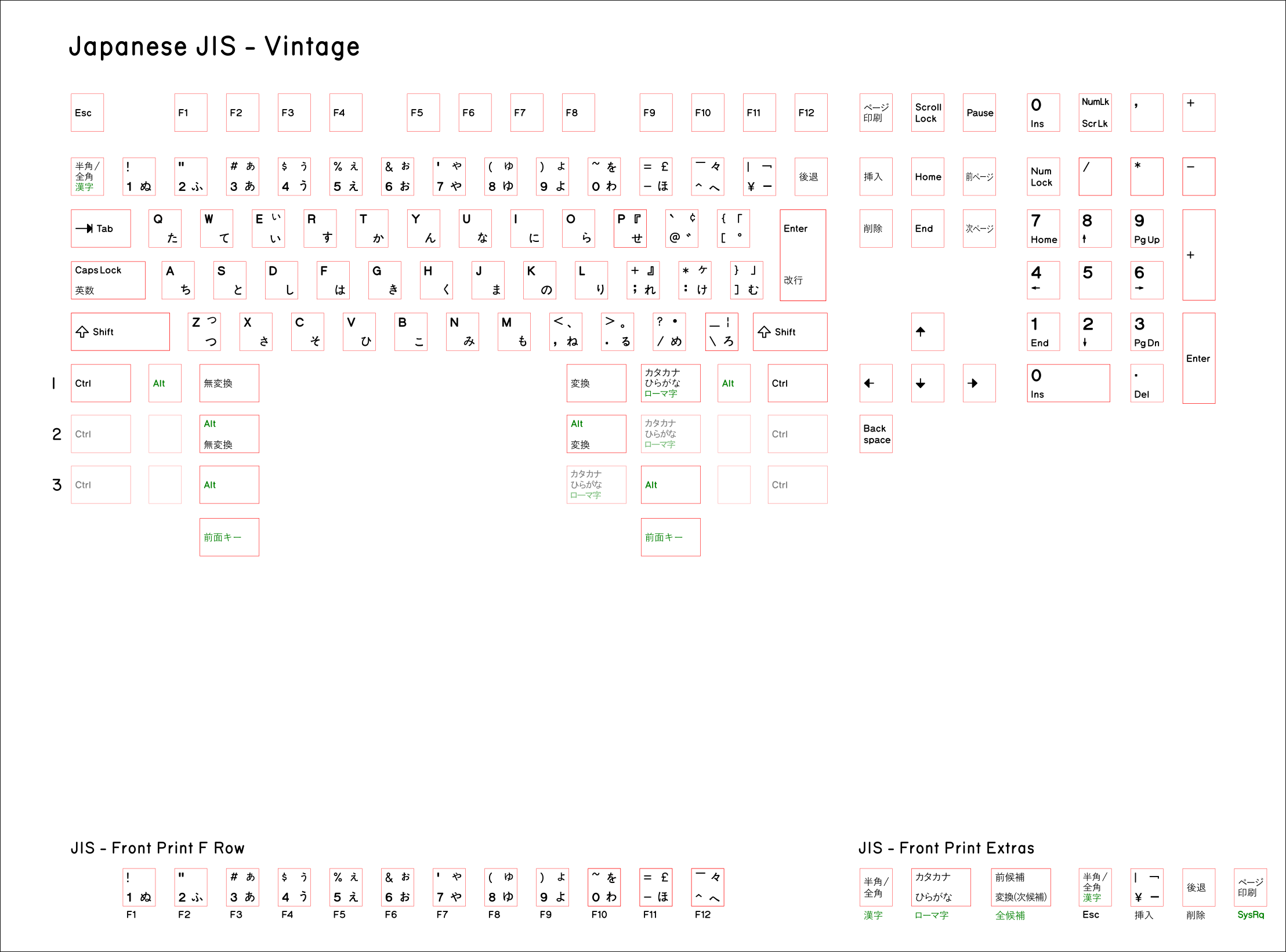

I was thinking that perhaps we should go with a Modern and Vintage style Japanese layout to make everyone happy. What do you think? Vintage Tab key could be made more vintage (double arrow style) but I'm not a fan. All 3 bottom row options included with each set. New font shown.
If you can make both then I'd very happily take a row 1 vintage. Regarding tab, I quite like the 003 tab that has two arrows and no letters on it.Zed wrote: 05 May 2021, 06:09 I was thinking that perhaps we should go with a Modern and Vintage style Japanese layout to make everyone happy. What do you think? Vintage Tab key could be made more vintage (double arrow style) but I'm not a fan. All 3 bottom row options included with each set. New font shown.
The new font and left alignment look great!

I am glad that the Japanese was well placed.
As a Japanese person, I feel that the tab key is the standard style of a letter and two arrows.
By the way, the most common 5576 style is a01, not the c01, 003, etc. that you are referring to. For the Japanese, the a01 is the standard when it comes to IBM keyboards.
