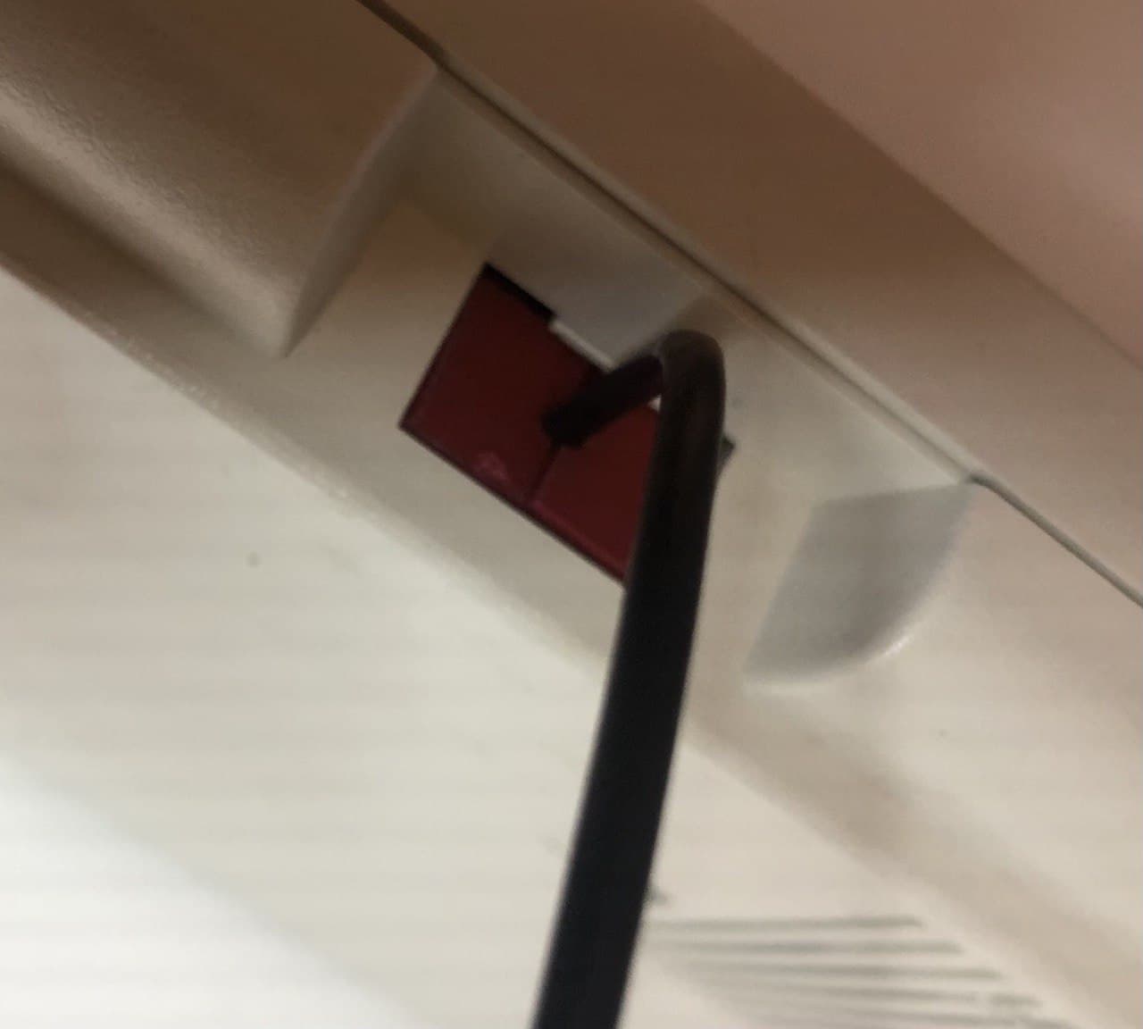

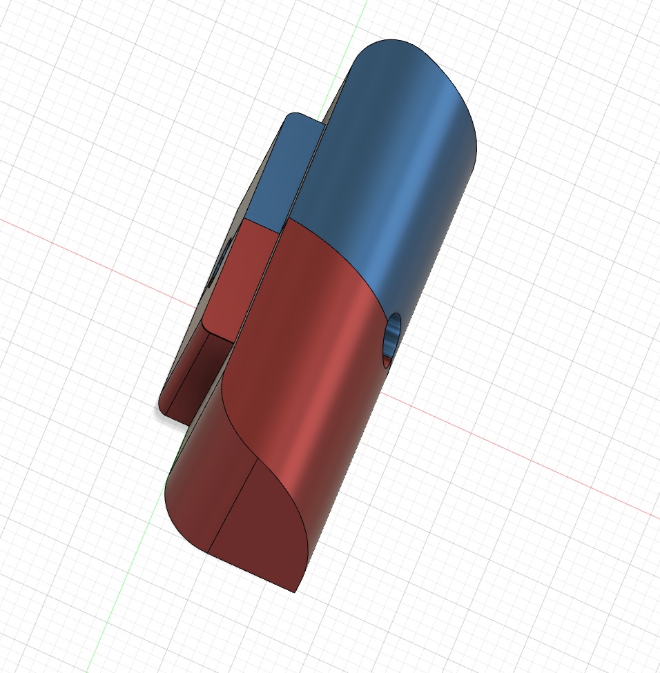

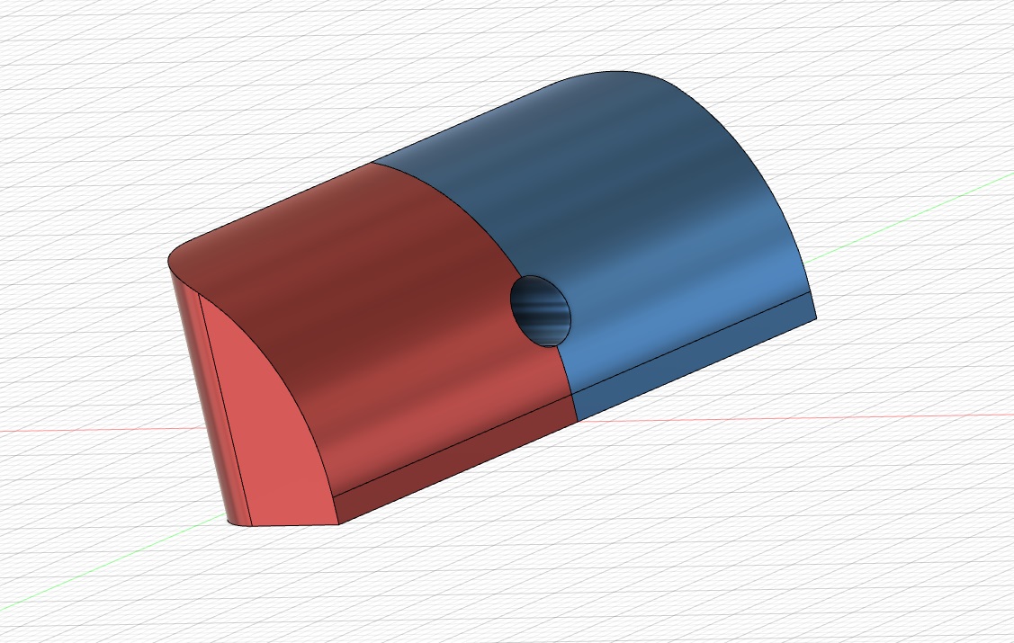

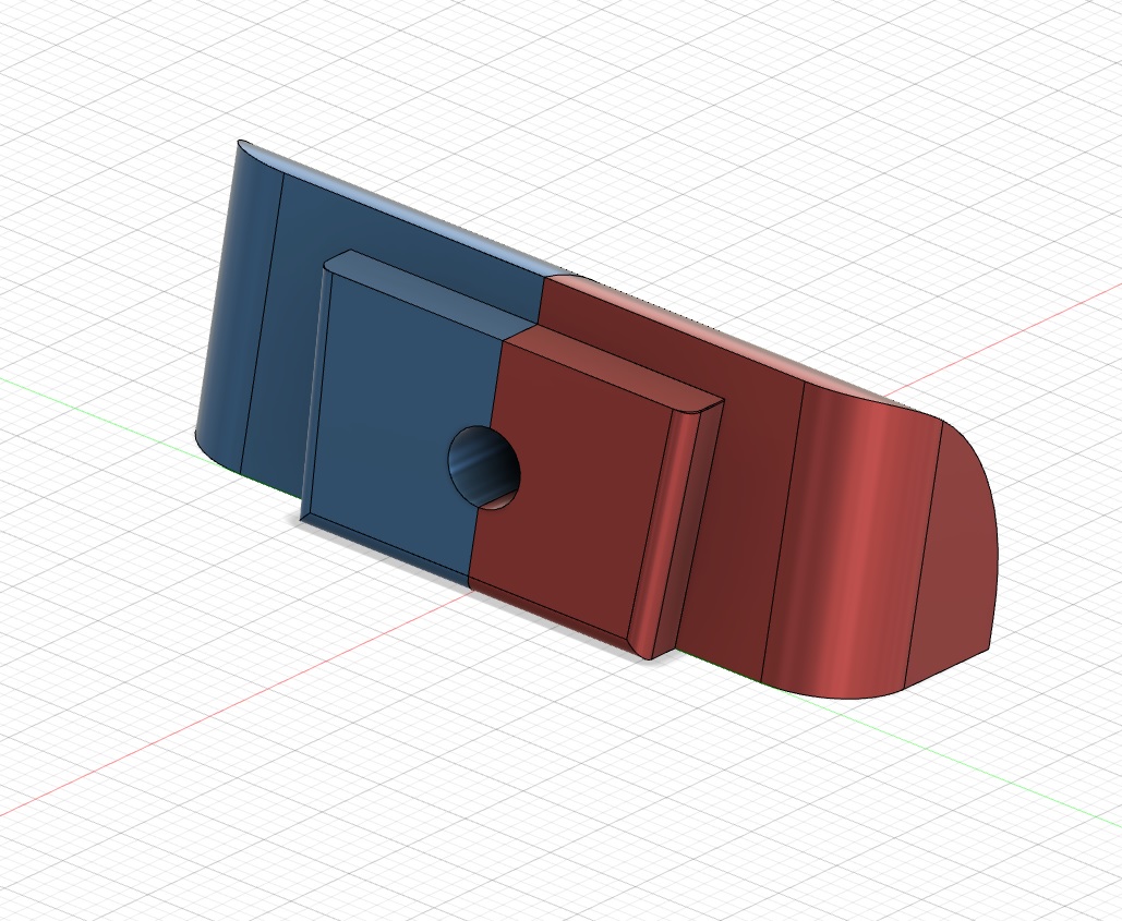

Following the part which I designed to hold the cable: and here the result (I printed a test only):
I have attached the STL files to this post also.

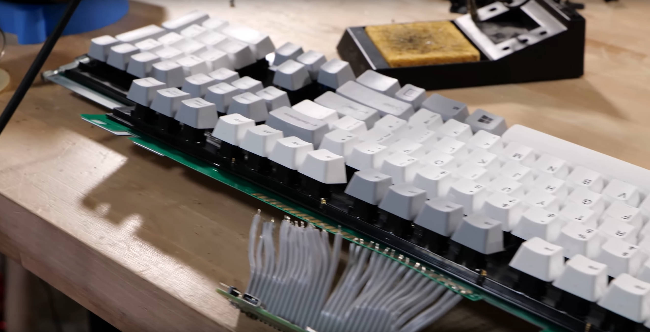

If you take a look at this pyrelink's built:
and compare it with mine:
you will notice that there is a "connector" in the middle. This setup swaps the cables but in pairs !
If the "normal" = pyrelink soldering patter is (rows) 1,2,3,4,5,6.... and (columns) a,b,c,d,e,f ... my setup creates a distribution like follows: (2,1),(4,3),(6,5)... and (b,a),(d,c),(f,e) ...

And looking at the part that I designed here:headphone_jack wrote: 10 Dec 2021, 15:27
Yes, an integrated controller would be great. Could even implement reed reset support for aqadisassembly-free reflashing. As for the hole in the case, I think it would be cool to be able to use the original detachable cable over SDL. Making a daughterboard that connects to the controller would be a relatively simple process. Just something to think about!
it should be possible to integrate a little switch connected to the reset pin ( xwhatsit example here https://lh4.googleusercontent.com/zPPZ0 ... d9pdQ=s800). This will avoid dismantling the keyboard to perform a reset, indeed.
If a different controller is used, it could be connected to the applicable reset pins.

One additional question:
https://www.youtube.com/watch?v=xCHbd3x13rU
In this video they he is using our FSSK PCB, isn't it ?
An screenshot follows ... it looks like one of the early PCBs (they were green)

Definitely want to be able to build one of these without a rat king inside like that. (No offence to the builder, just saying that my handiwork would lead to a tribunal at The Hague.)
Integrated controller then!
