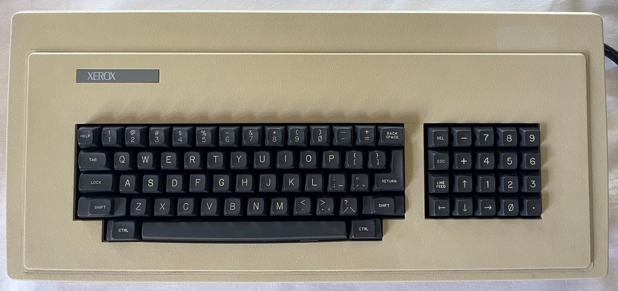

This is the X928 keyboard with Maxi-Switch switches.
There are more pictures on Bitsavers.
This was the only keyboard for the 820. For the 820-II, it was named the ASCII keyboard.
It is just regular parallel ASCII, with 7 data bits, although 8 lines are present on the connector. The command keys send the obvious ASCII control character, except the arrow keys which are up 01, down 02, right 03, left 04. The CTRL key also selects the third ASCII character (|, \, ~, `) on the keys with three legends.

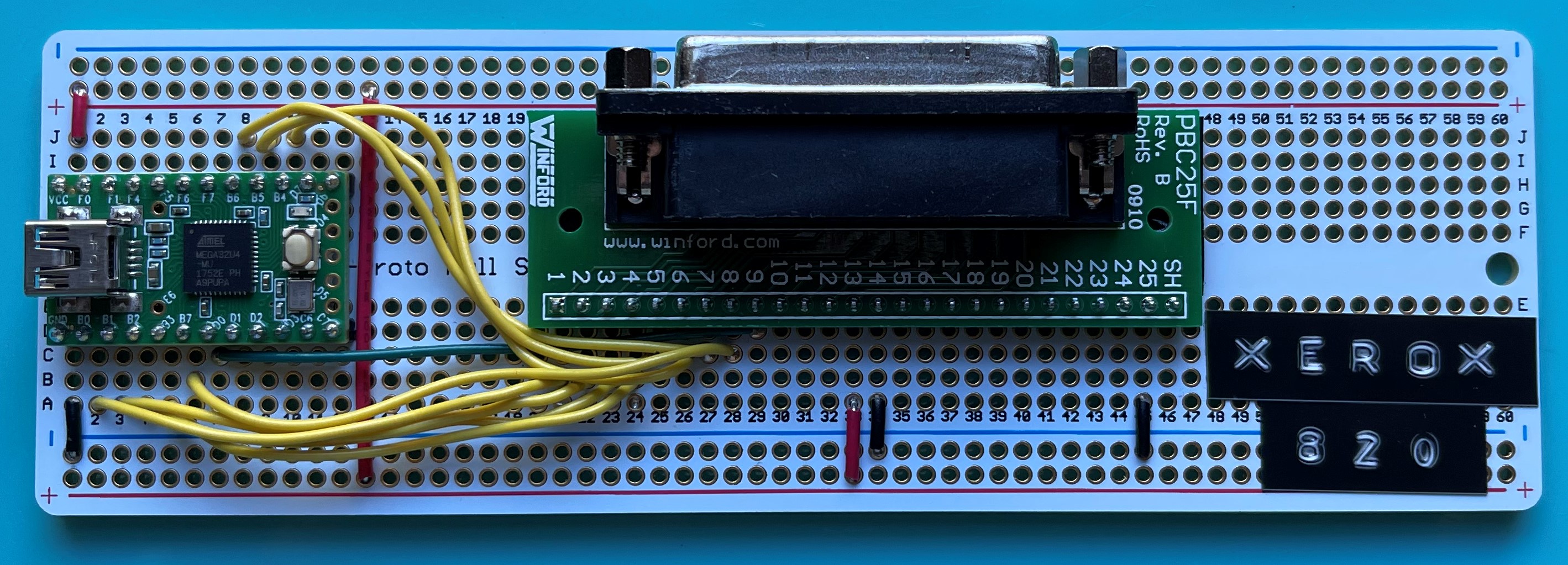

As usual, USB conversion means emulating a serial port.

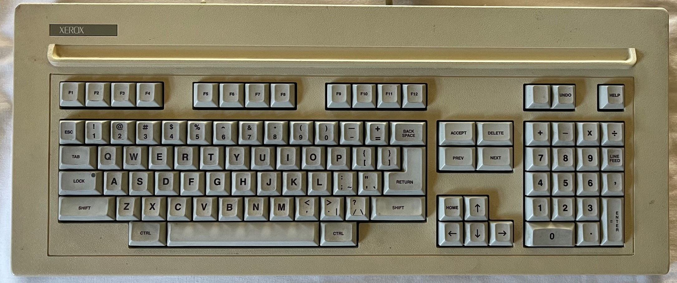

This is the G25 keyboard for the 820-II, with Cortron (ITW) switches.
Again, there are more pictures on Bitsavers.
It is also known as the Low Profile Keyboard (LPK).
The connection to the 820 is identical, as is the basic hardware / firmware in the 820 itself for reading the strobed parallel output. Likewise, it can use the same converter hardware. But this time, it is key state updates, called position-encoded by the Technical Reference. These come as two parallel bytes: a prefix giving make vs. break and the active state of the shifts, followed by a scan code byte. It also supports passing through movement from an optical mouse, though I don't have access to one.
This works pretty well as a real USB keyboard using QMK. It gives key press and release transitions for every key, supports n-key rollover, distinguishes left- and right- shift and control. Only the LOCK key is a little inflexible: it maintains state locally and sends down and up alternately, as though it were physically locking.
