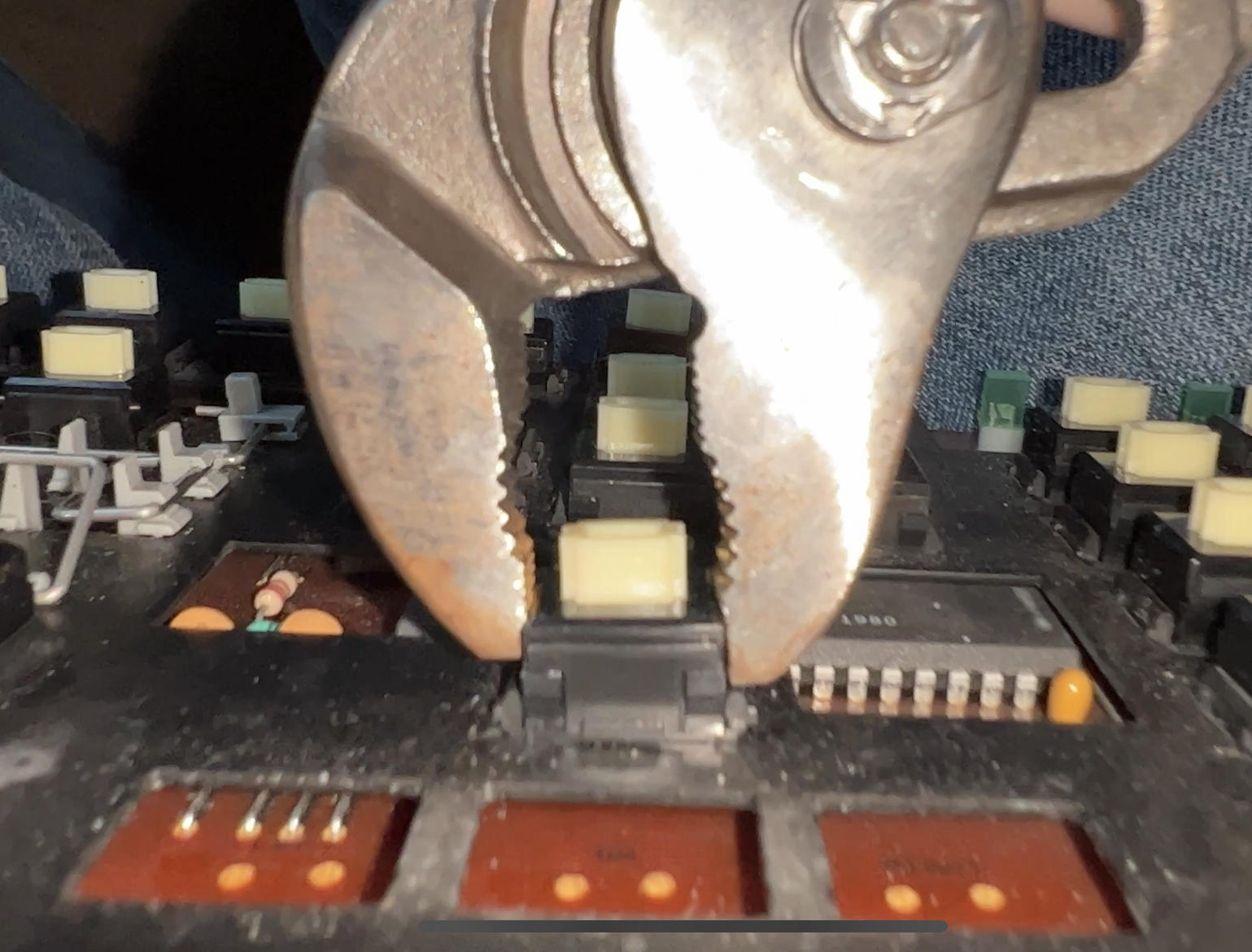

I recently desoldered and removed clone Alps switches on a Focus FK-2001 using a pair of channel lock pliers. This worked but a couple of switches had pieces chipped off and I wondered if there was a better way. If anyone has advice or methods that might work better I’d appreciate any advice. Below is a pic for reference.

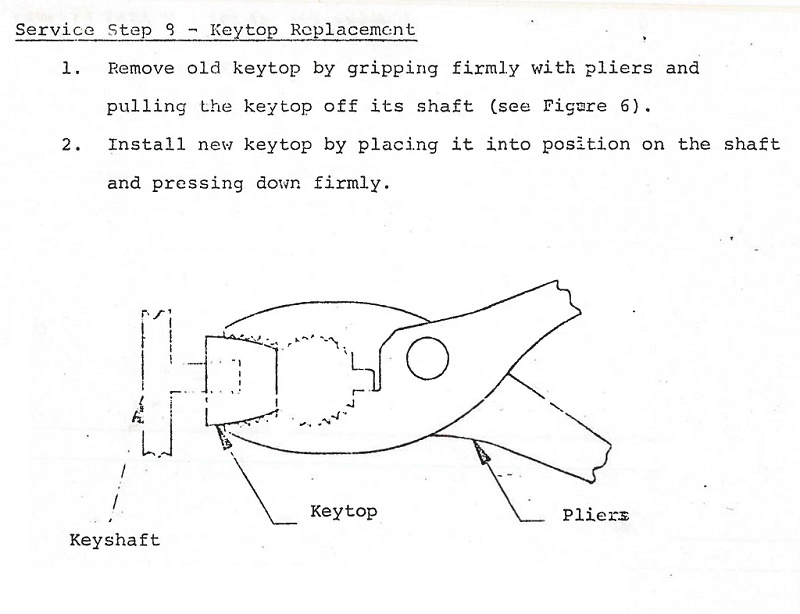

That looks like a pretty cruel tool for working on small plastic electronic devices.
jsheradin
24 Jan 2022, 18:10
fohat wrote: 24 Jan 2022, 17:52 That looks like a pretty cruel tool for working on small plastic electronic devices.
Manufacturer recommended depending on the era.
The pliers weren’t my first attempt. After prying with my fingers failed I grabbed a rubber grip mat and was able to pull one side of a switch up, but the other side was really stuck in there. I tried a couple of other switches with the same result.
I then tried pliers with some scotch tape covering the teeth but there wasn’t enough grip. I then tried wrapping a rubber band around the teeth and that didn’t work either so I decided to just use the bare metal teeth. It worked but chipped off the side of the plastic retaining clips on a couple of switches.
They were really stuck in there! I wasn’t planning on keeping the switches so I wasn’t concerned about them surviving this operation - I was more concerned about the switch plate and PCB, but I did want to ask for advice before removing my orange alps.
For some reason it never occurred to me to use a flat head screwdriver. I need to remove a switch to resolder and I will definitely try that first.
I considered disconnecting the PCB from the switch plate but there’s a soldered in screw keeping them together and I thought it would be easier to keep them together for the new switches.
