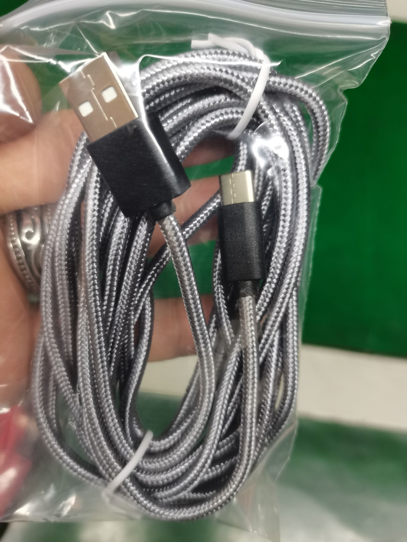

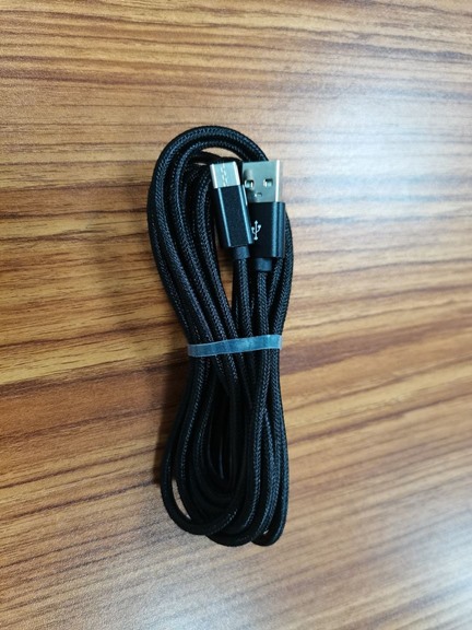

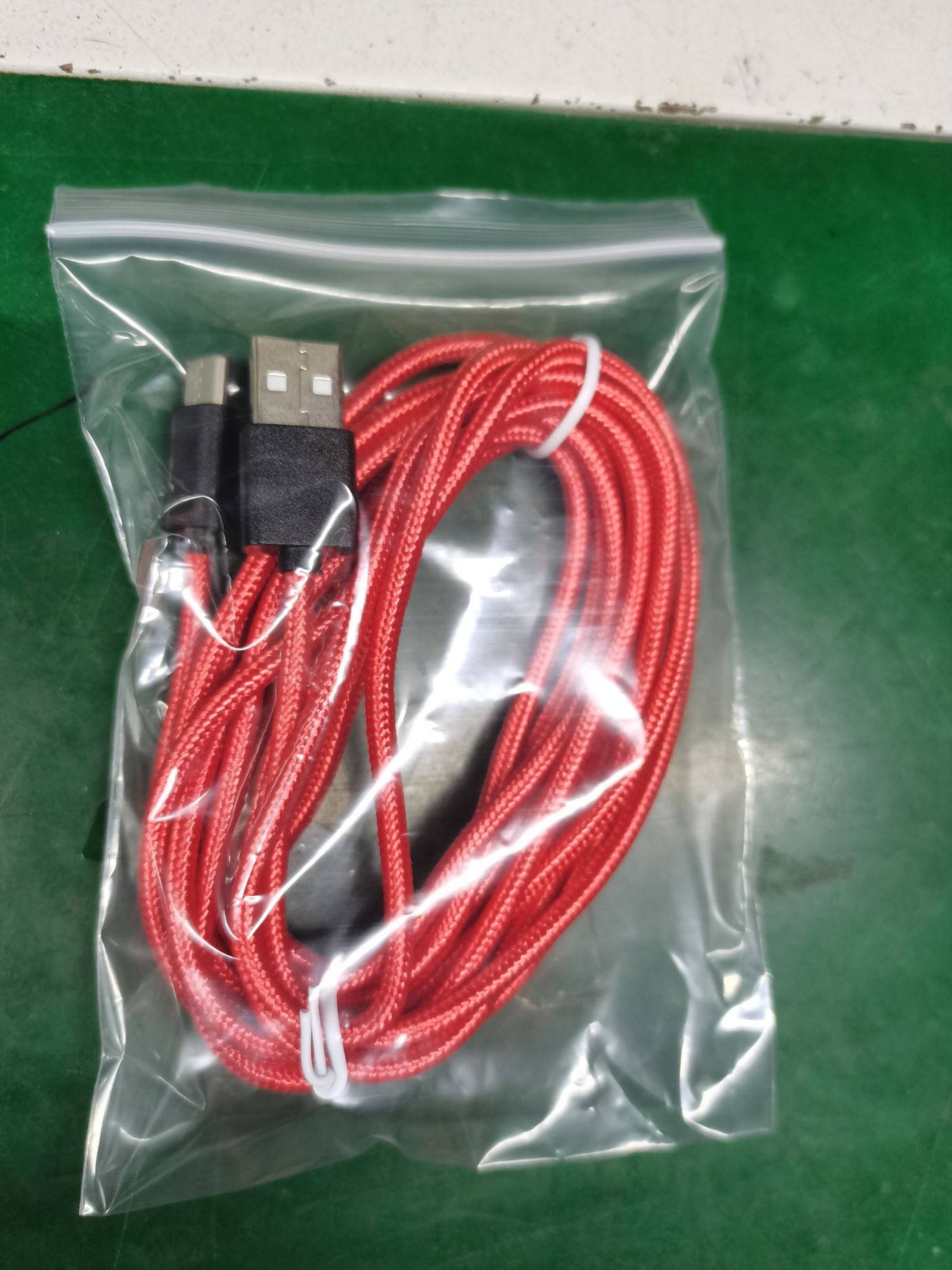

As a small update - as part of the current batch of keyboard parts in the container ship I ordered some USB-C braided cables in red and gray - now available in the store. These are only available as additional cables, not as replacement cables for the ones included with the keyboard (the included ones are all black; all cables are 3 meters in length). https://www.modelfkeyboards.com/product ... ard-cable/
- usb cables (1).jpg (432.2 KiB) Viewed 11210 times
- usb cables (3).jpg (402.69 KiB) Viewed 11210 times
- usb cables (2).jpg (77.21 KiB) Viewed 11210 times

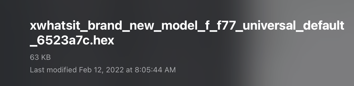

I really hope I didn't ruin my board.. I was trying to flash the default layout back onto the board and I used the [qmk configurator](http://35.164.28.200:5000/) site to compile and download the hex. I used the "universal" file rather than the "wcass" recommended in the manual (damnittttt). After flashing with that firmware, the keyboard doesn't work at all and isn't recognized by pandrew or qmk toolbox.
Is the best course of action to follow this guide?? https://imgur.com/a/kth6dHt#O0IArSE
I'm really shocked flashing that firmware completely took this board offline...

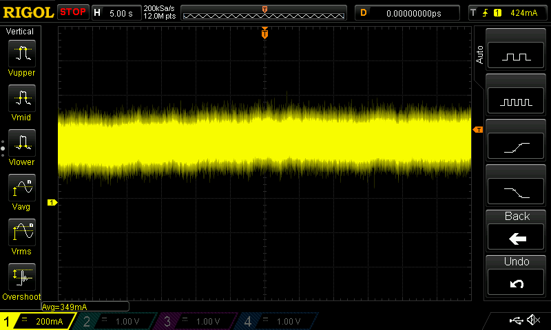

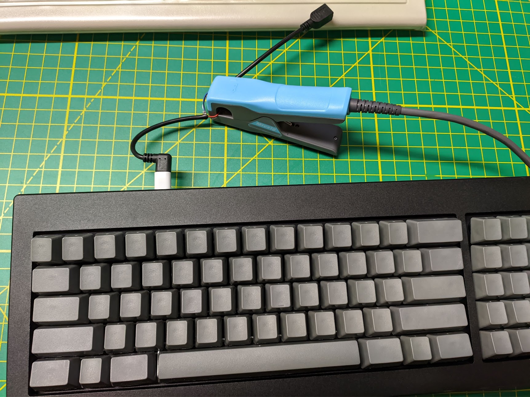

Out of curiosity I broke out a current probe and recorded 60 seconds worth of typing.
dddyrseth
- Main mouse: Vertical & (AAA)Wireless
- Favorite switch: Alps SKCM Salmon
Thanks!jsheradin wrote: 26 Feb 2022, 04:38Out of curiosity I broke out a current probe and recorded 60 seconds worth of typing.
Looks to be about 1.75W with no real difference between idle or use. My measurement gear's not really good for the mA range so not sure how accurate this is.Spoiler:
