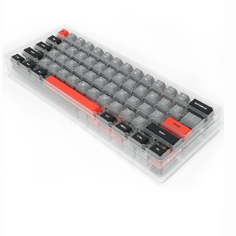

I came across an interesting MX keycap set which, if nothing else, offers at least another choice. The Skyloong keycap set is made of silicone and ABS with a profile similar to SA switches.
Skyloong-Silicone-Keycap-Soft-Game-Office-Programmer-Mechanical-Keyboard-Cap-61-64-68-84-96-104.jpg_Q90.jpg_-2 copy.jpg
Skyloong-Silicone-Keycap-Soft-Game-Office-Programmer-Mechanical-Keyboard-Cap-61-64-68-84-96-104.jpg_Q90.jpg_-2 copy.jpg (108.6 KiB) Viewed 11543 times

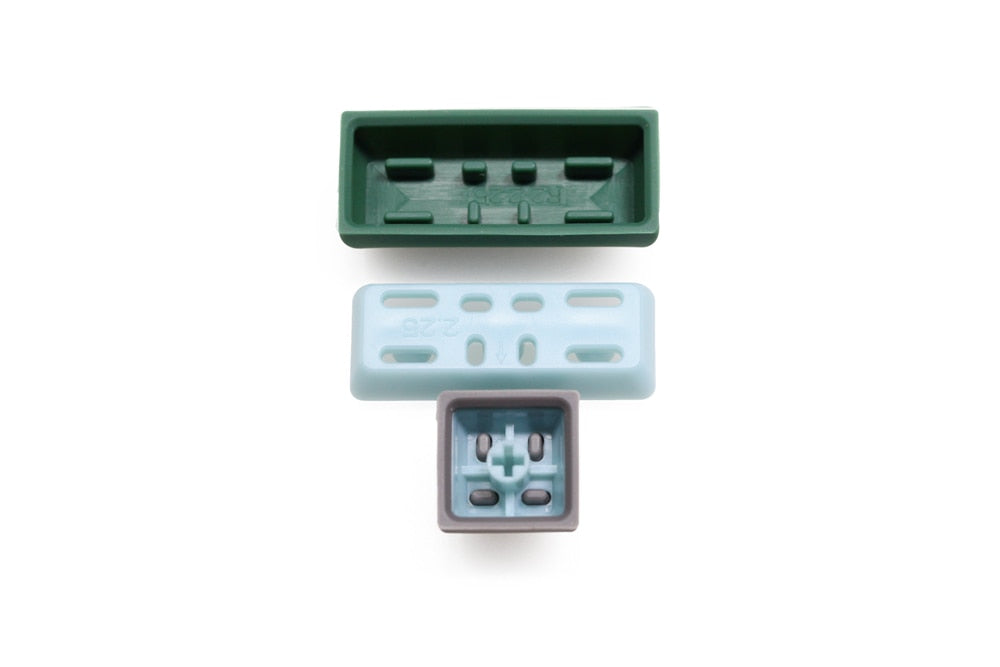

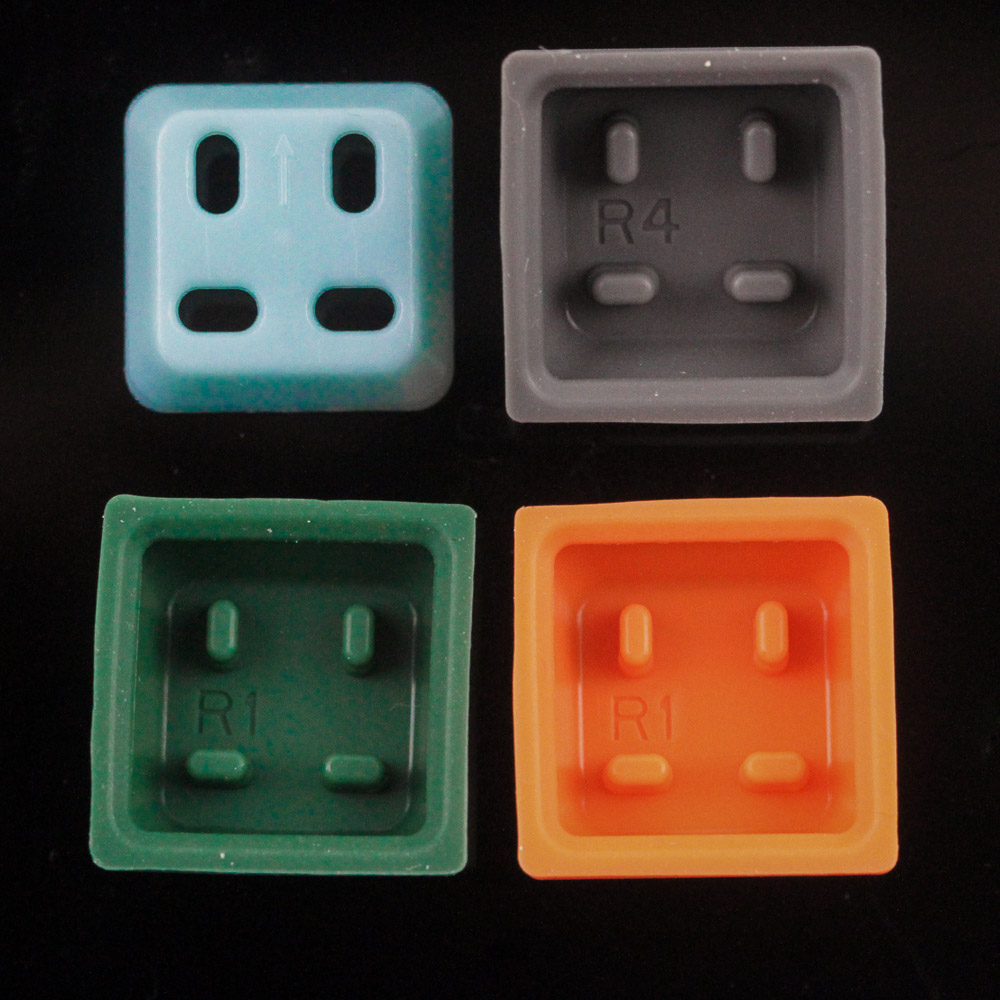

The most interesting part is its two-piece keycap: an ABS insert that snaps onto the stem and also into the silicone cap. It’s not unlike the two-piece keycaps found on Model M keyboards.
It is possible to 3D print replacement inserts with ALPS mounts instead of MX mounts. The resulting part can be epoxied in place, allowing for a single unit size to cover the entire range of keycaps sizes. It might be possible to core the stem out of a less desirable keycap using a small hole saw turning it into a stud.

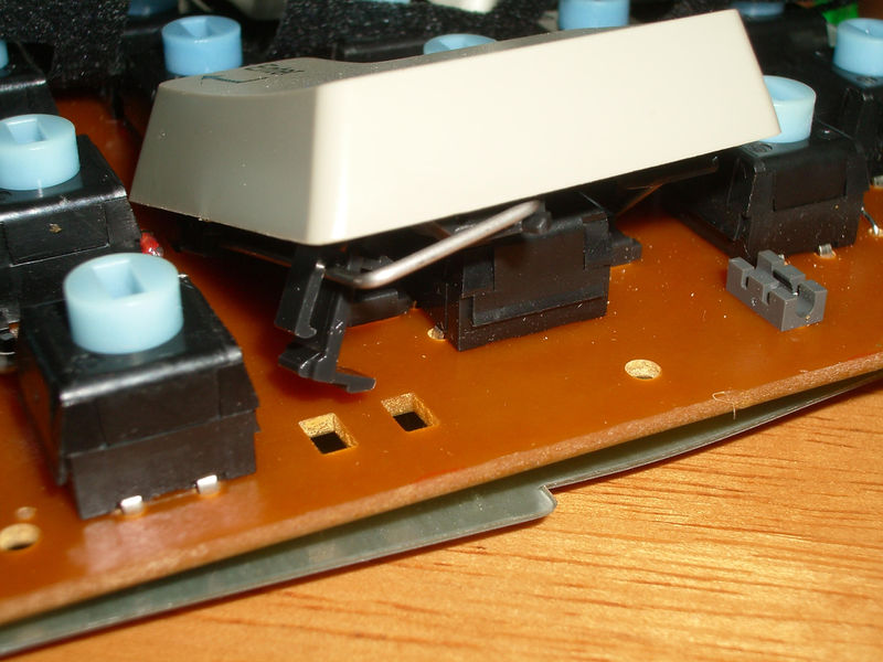

Alps often have finicky stab clips which insert into the caps. I find Costar stabs irritating on MX, let alone Alps' own. Don't even get me started on Alps double-stabbed Big Ass Returns!
wiki/Zenith_Supersport_SX#Gallery
Notice how close the wire stabilisers fit with the plastic of the caps? How well is that going to work with two-piece caps?
Sure, it's an Alps integrated dome keyboard, not SKCM. But it comes to mind because it's legit Alps-made, and that very key gives me nightmares!

I want to reiterate and clarify the alternative to 3D printing I suggested; it might be more economical and possibly more durable to salvage the mounts from a set of less than desirable keycaps. This would entail "coring" out the small area where the mount is located, leaving a stud which can be adhered to the insert using epoxy. The coring can be done with a dremel leaving the mount and a perimeter of plastic around it. It might be too proud or not flat enough (curvature of the keycap), but sanding the mating area of the stud should fix it. The height of the stud should be measured using a cheap caliper to insure a uniform height for all the caps.

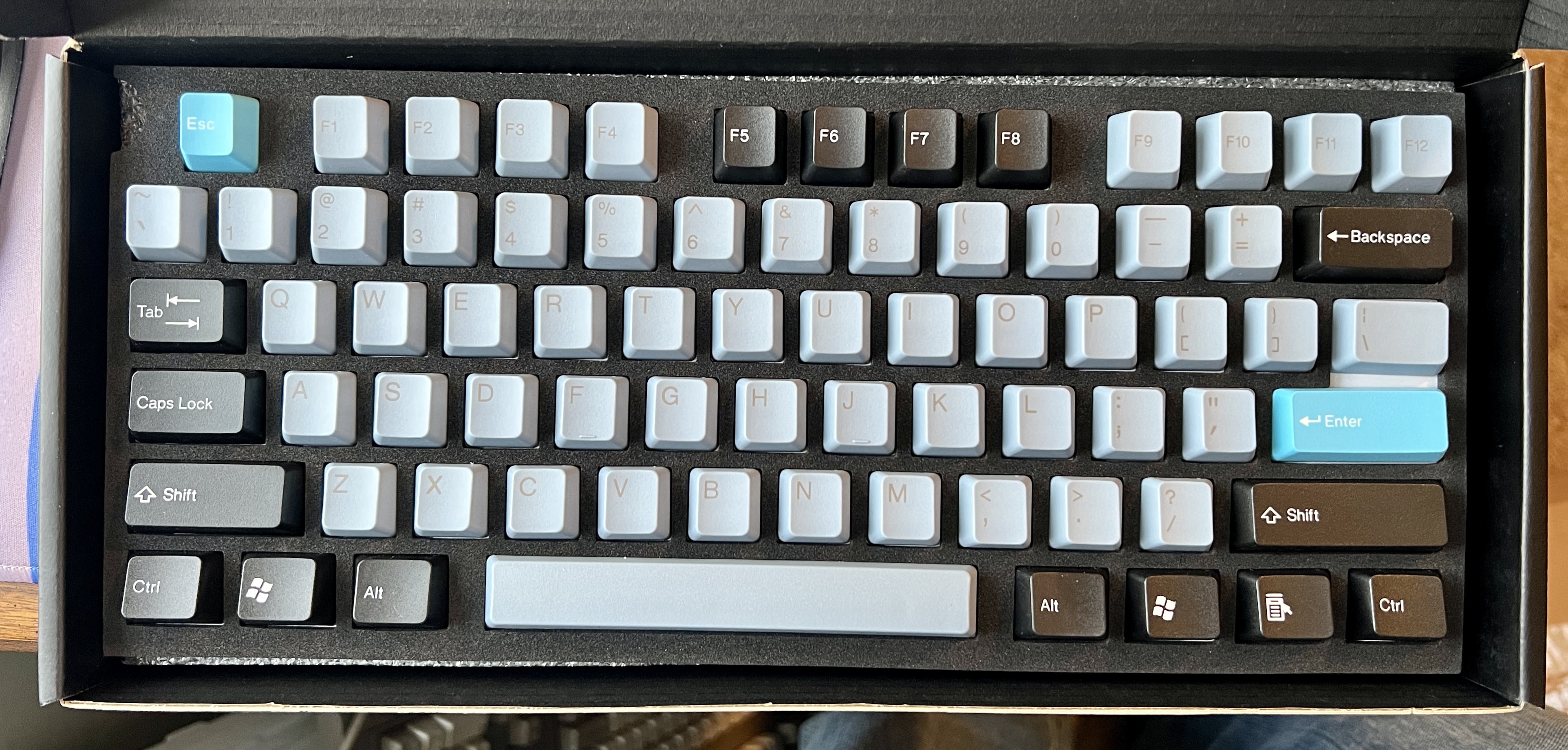

I purchased a set from the link you shared. They have nice caps! Below are pics of the set and the bonus gifts they include in the order. Overall the keys look great and I’d recommend them. The only issue for me is the Focus layout uses a split tight shift with the \ key and the set didn’t include keys for that, but I’ll work something out.
Key set:
Key caps

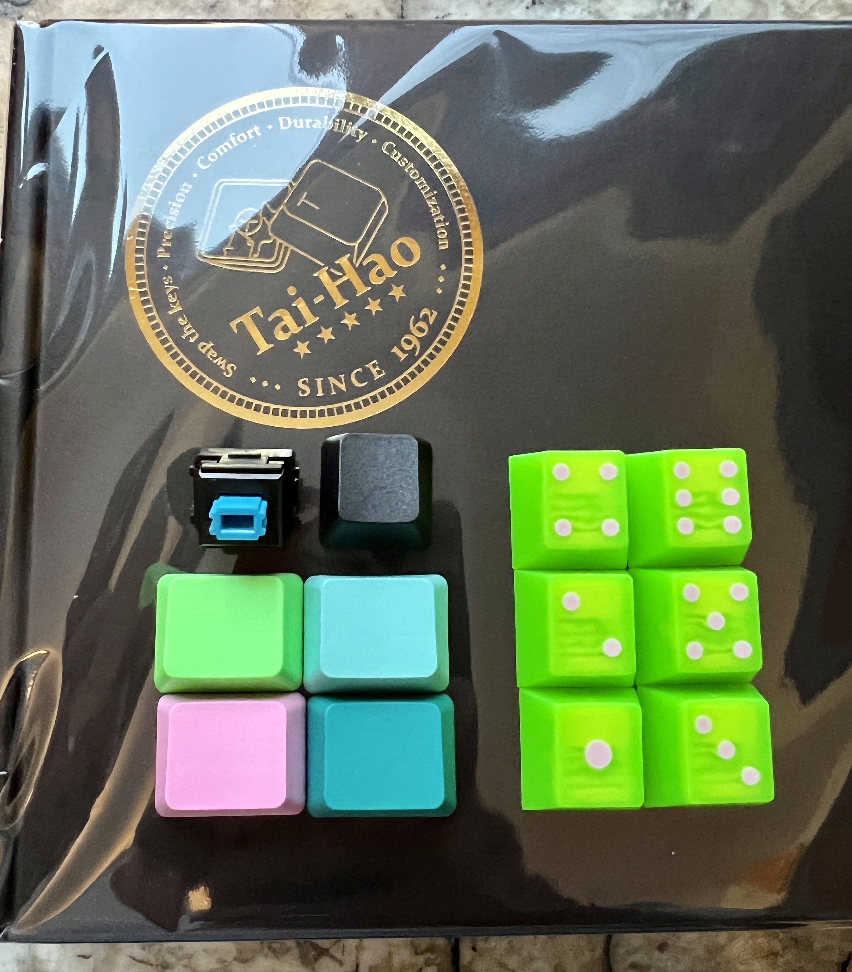

Bonus gifts. A blue alps clone and some blank alps keys on the left side and cherry mount dice keys on the right side:
Bonus gifts
Bonus gifts

When I saw this, II thought, "Why does thefarside's keyboard have so much space between the keys?" They're still in the box. Duh.

Oh. One other comment. I've bought a couple Alps key sets from Tai-Hao and the "extras" were MX mount.
