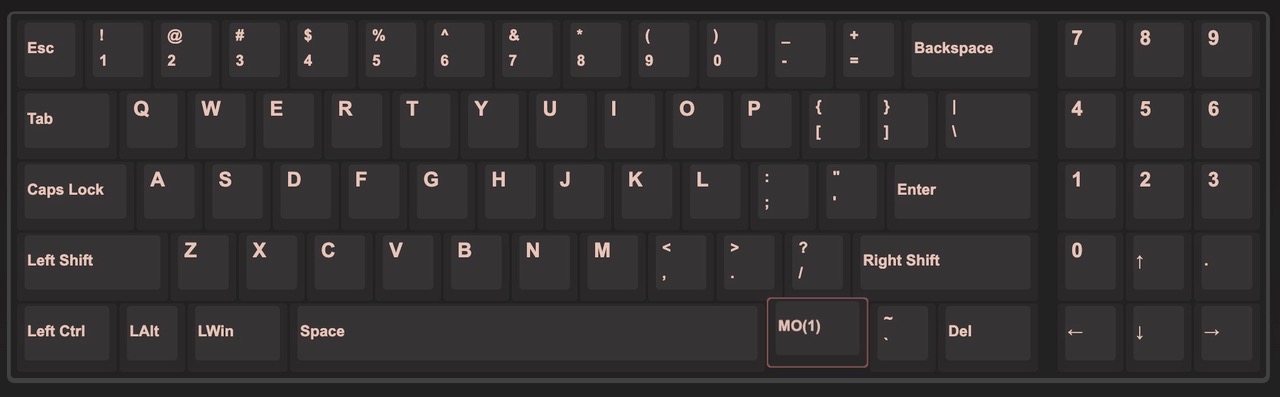

Hey! While trying to figure out why my computer doesn't like the keyboard from time to time i did a firmware write using Atmel Flip with the file "Via F77 - ANSI-ISO - PrintScr.hex". Now I can't in any way manage to get the keyboard to get into bootloader mode, so I can't reprogram it. I should note that I didn't use the pandrew utility to do a EEPROM erase before I loaded the above file using ATMEL FLIP, maybe that screwed something up?
I remember the FN key default being bound to the lower right CTRL, though if I press lower-right CTRL+SPACEBAR+R, it doesn't enter boot loader mode. Tested leftshift+rightshift+b as well, to no avail.
Any ideas what I can do? Is there any other way to enter boot loader mode so that I can just do a clean eeprom-flash?

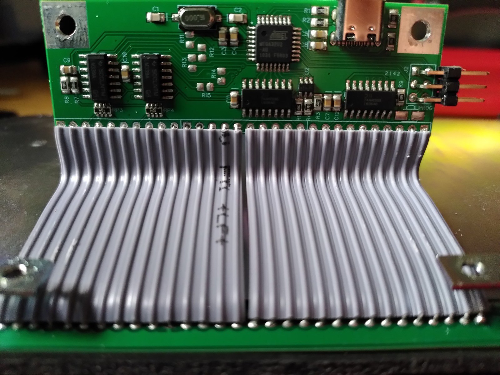

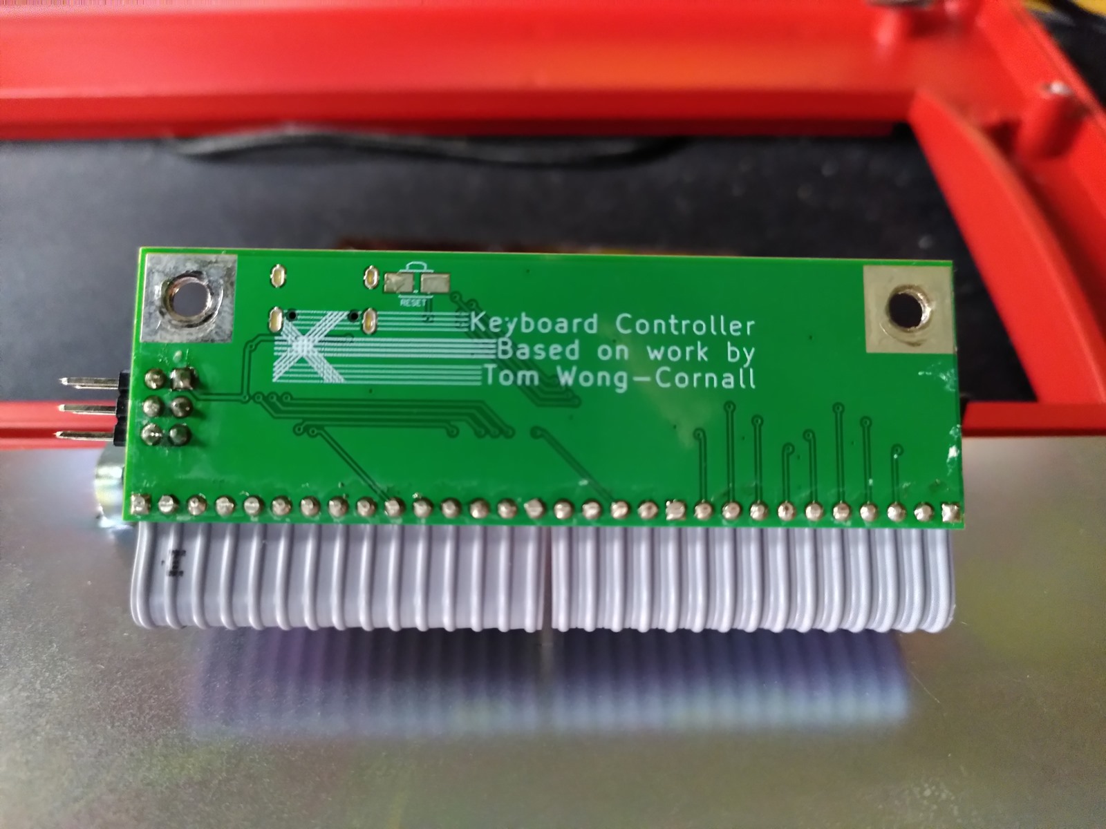

I opened the keyboard, and though I didn't find any reset pads, I found the PROG-pads. I followed this manual: https://www.modelfkeyboards.com/manual/
It says you should short the PROG pads and not any reset-pads.
I've tried this for over half an hour now, and it still doesn't enter boot loader mode.
What I do is:
- Short the pads with a tweezer (while keyboard is unplugged)
- Plug the USB-cable in
- Remove the tweezers (here I've tested to do it for various times, from instant to waiting a few seconds).
The keyboard doesn't go into boot-loader mode but it's still a normal keyboard in Windows.
Any suggestions?

Keyboard is in bootloader mode! You REALLY need to apply force with the tweezers on the pads for it to work.
The good news is that it doesn't seem to matter how much time it goes before removing the tweezers. What I did was:
- unplug keyboard
- Short-circuit the pads (uzing tweezers with quite a lot of force)
- Plug the keyboard in
- Wait for 1-2 seconds
Then it went to bootloader mode.
Thank you all!

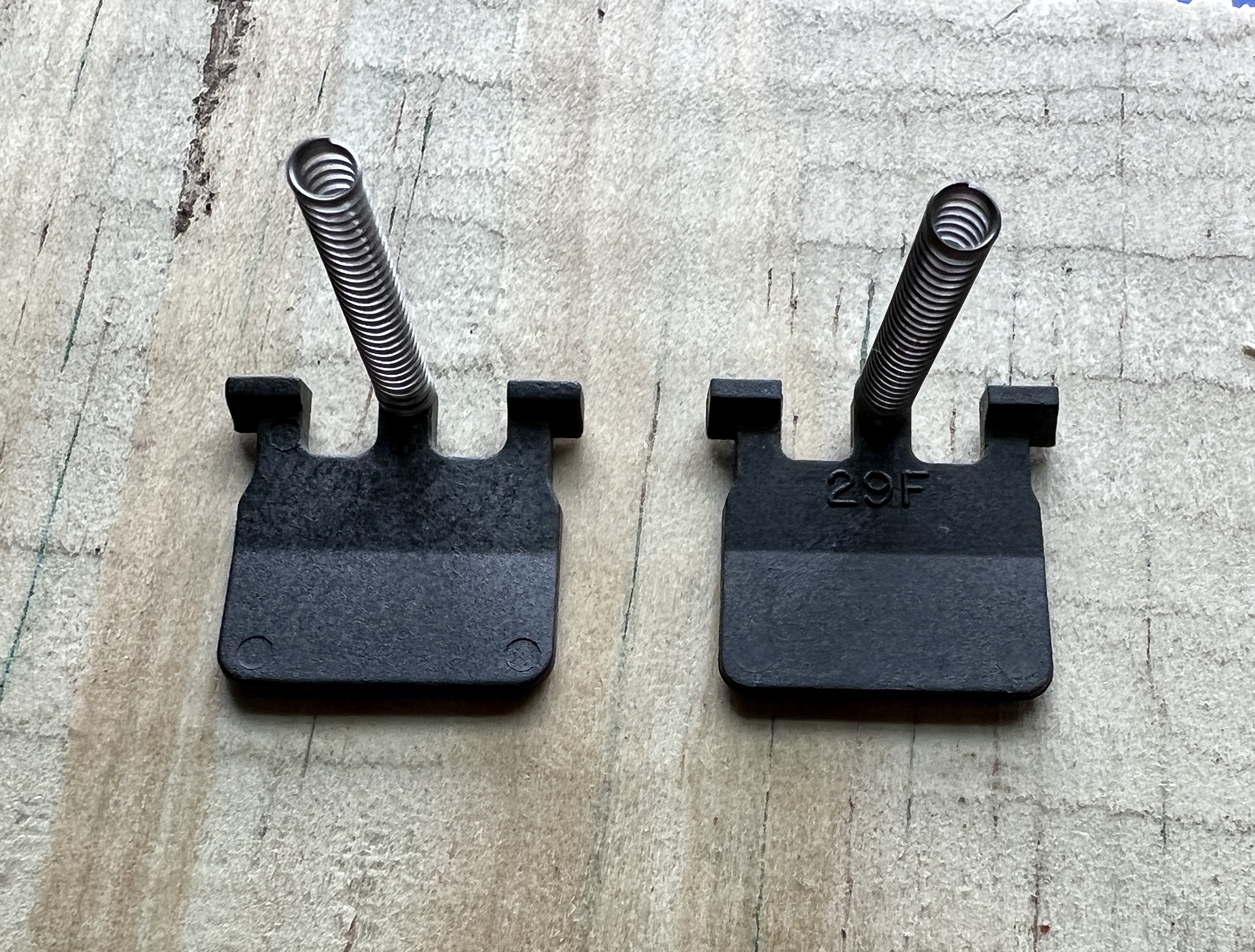

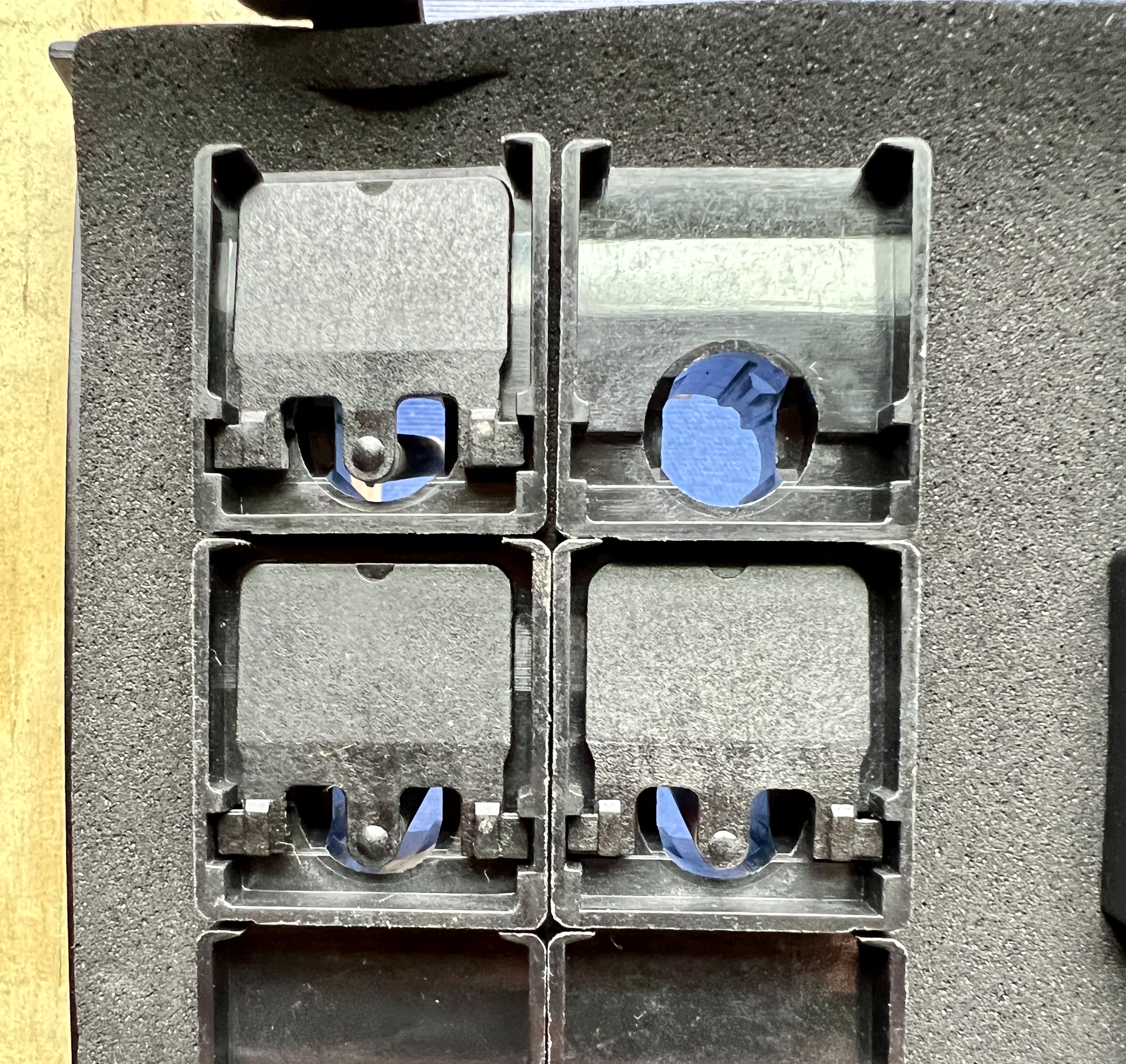

Someone sent me the following regarding "multiple keys registering when one key is pressed.
I've had a look at the troubleshooting guide which suggested it was maybe a problem with the flippers/springs. I've tried reseating the caps for the keys I'm having issues with, but that doesn't seem to affect the problem at all.
Any idea what the solution might be?

- thefarside
Yes they are. In the picture below the bottom right flipper is a reproduction and the two on the left are original IBM. On this picture the one on the left is a reproduction and the right is original IBM: Hope this helps!Arkku wrote: 23 Aug 2022, 21:27 Random question, but are the springs and/or flippers compatible between these new Model F keyboards and the vintage ones, e.g., XT and AT?
Also, I heard there are some flippers (XT maybe?) that have angled edges and might not be compatible with AT and 4704 style flippers. I can’t speak from experience and maybe someone who knows better can chime in. I know the reproductions are AT and 4704 style.
Ellipse
It is my understanding that all Model F flippers are compatible with all Model F keyboards. Nice photo comparison!

To be safe, can you confirm that to get the ~ `key I have to order the F77 with the" HHKB-Style Split Right Shift and Split Backspace "option? And if I order the keyboard now, what are the delivery times? Thank you
Arkku
- Location: Finland
Note that you can remap keys as you prefer. Personally I have the ~` key in the top left corner, and to get Esc I can press Fn together with that key. My Fn key is done using the split right shift. Of course you can also do the same the other way around, so that it is Esc normally but Fn + Esc is ~`, whichever you use more.Miky2147 wrote: 24 Aug 2022, 21:21 - I am Italian but for some years now I have not used the ITA layout anymore, I only use the US layout. I have a question: to write in Italian I need to use accents (and the apostrophe) that on the US keyboard for the grave accent I have to press first ~ `(top left under esc) then the letter concerned and it will come out for example the accented letter "è". This keyboard doesn't have that key but it has the esc key in its place, how am I going to type?
Another thing you can do to get an Esc is to configure a key like Ctrl as a combo key that works as Ctrl when you hold it and press another key, but sends Esc if you only tap it. (I do this with the "caps lock" key, i.e., the key that is above left shift.)
Splitting the backspace is of course a viable option, which I have also tried but I seem to have a reflex to press the left side of backspace when I correct a typo I just made and the right side of backspace when I'm deleting something that was there before… So it may take a bit of getting used to. (I converted one of my F77s to a split backspace first but reverted it back to a normal backspace a week later. I'm still trying the split backspace on my F62, though.)
Anyway, my point is: these keyboards are very customisable: you can do custom mappings in firmware, including one or more "Fn" keys and layers that you can toggle between, and if you get a few extra keycaps you can split or unsplit keys later.
