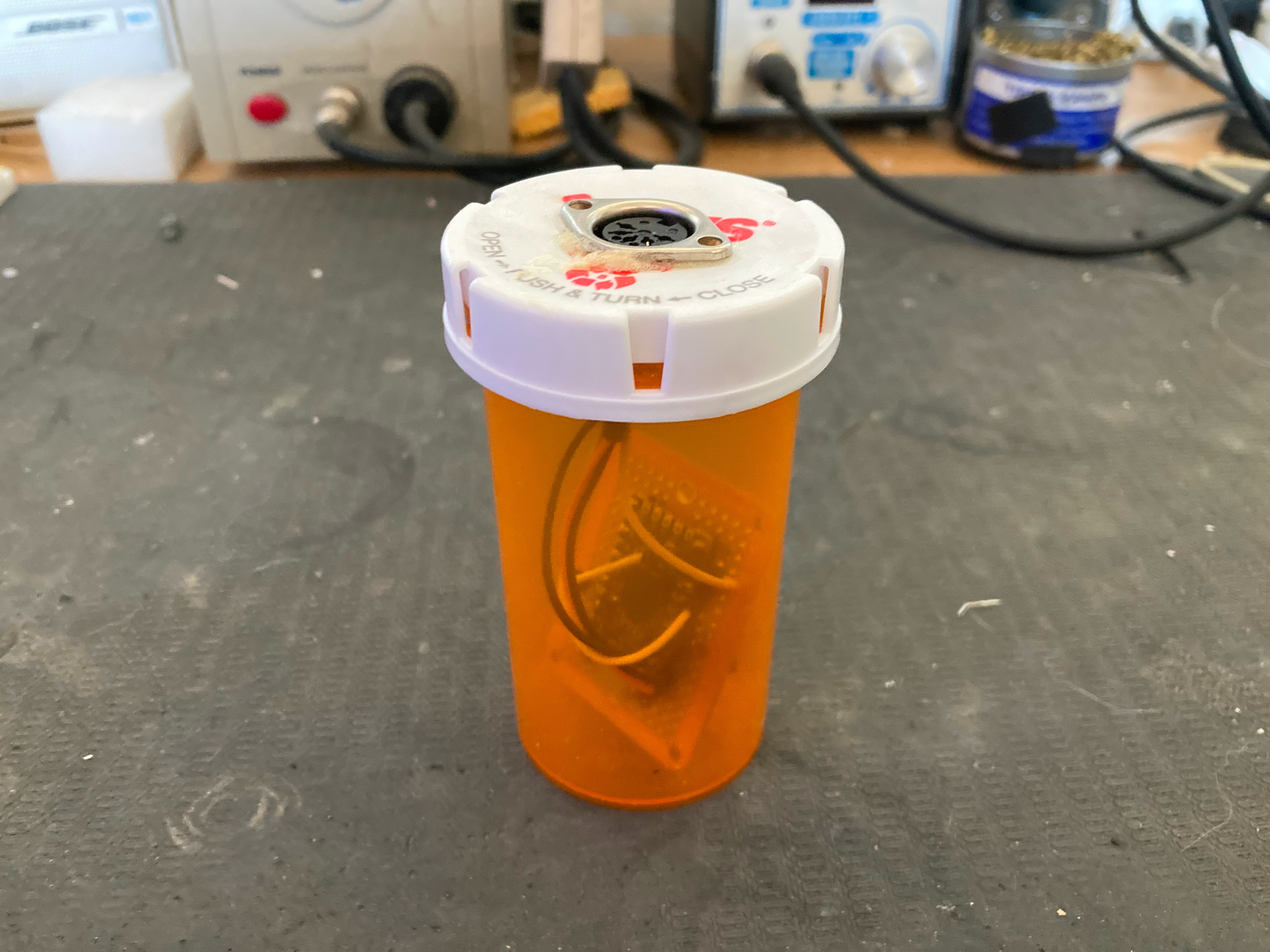

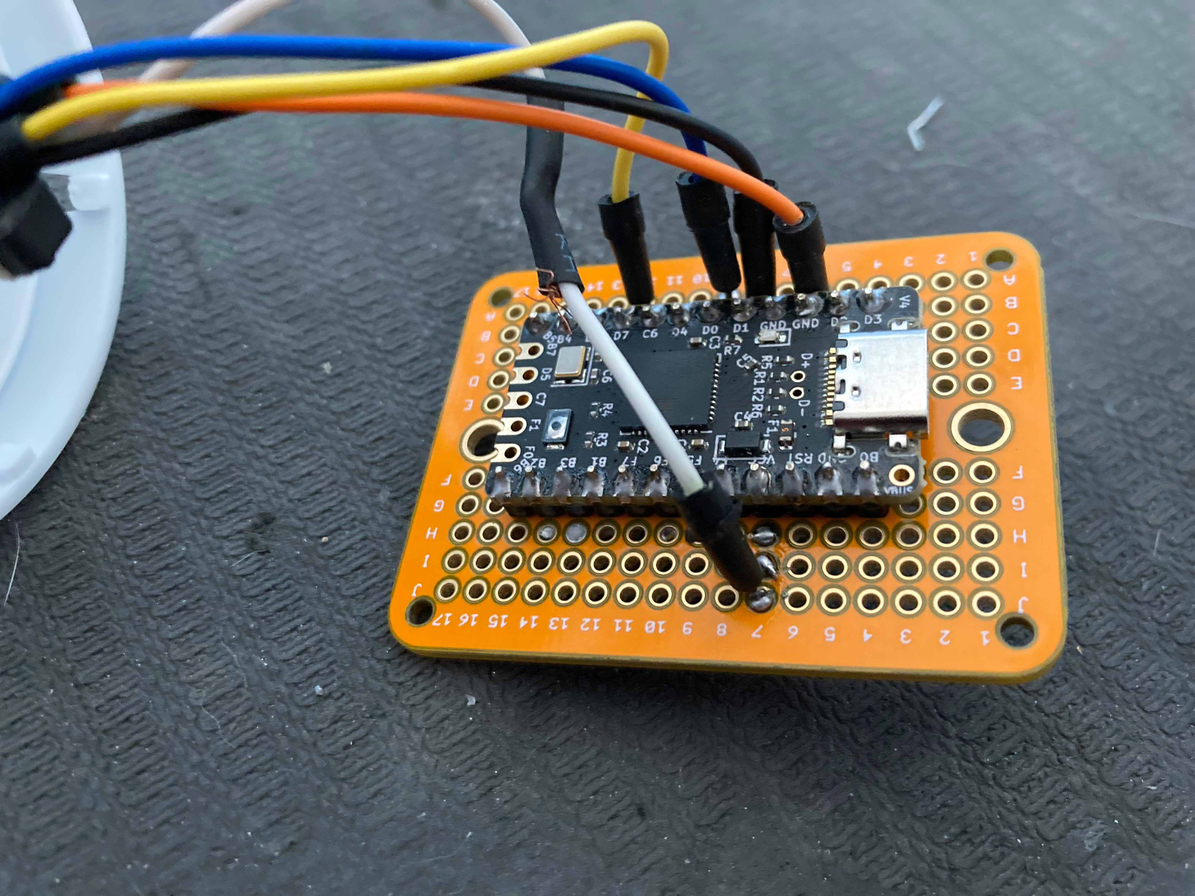

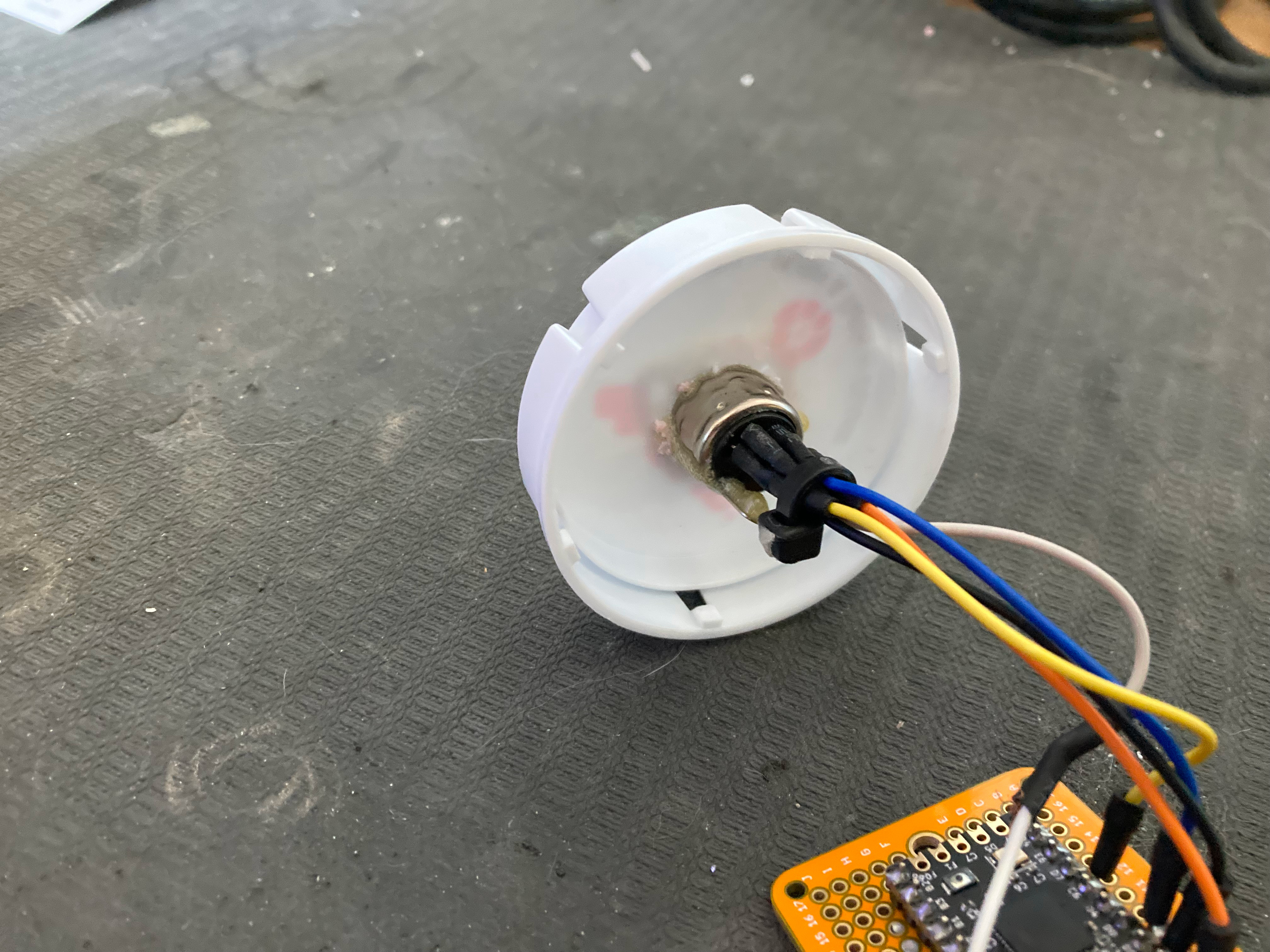

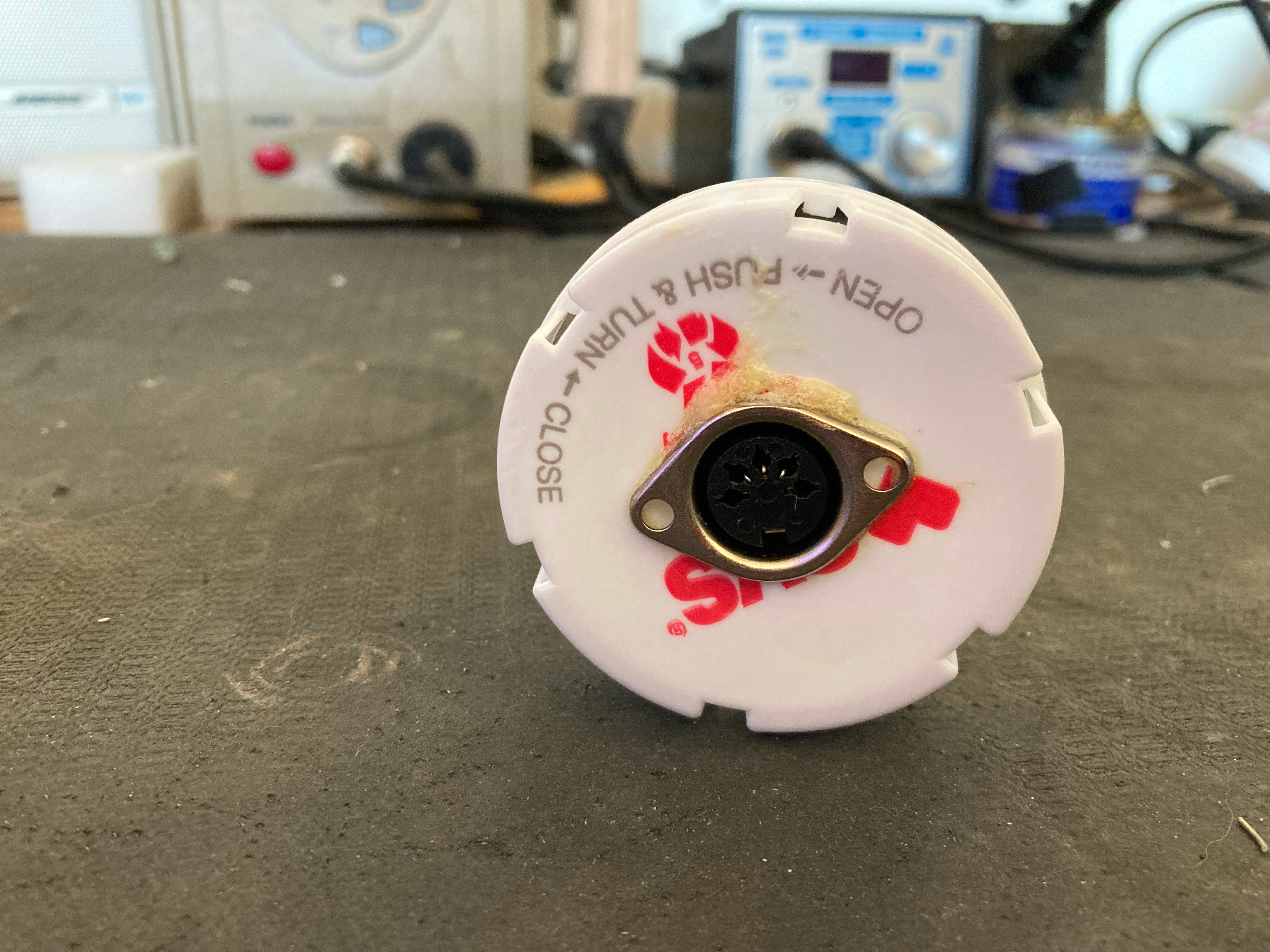

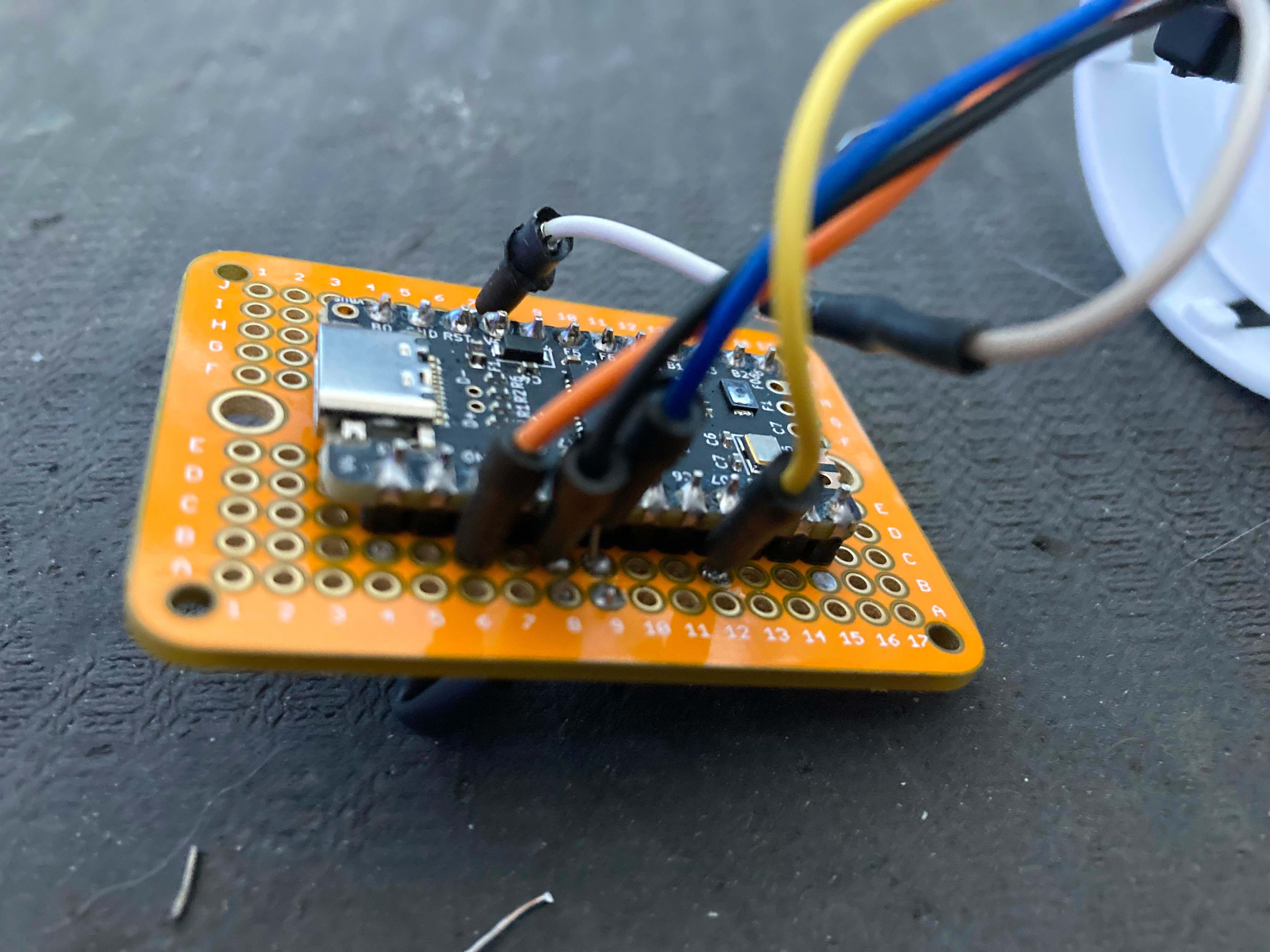

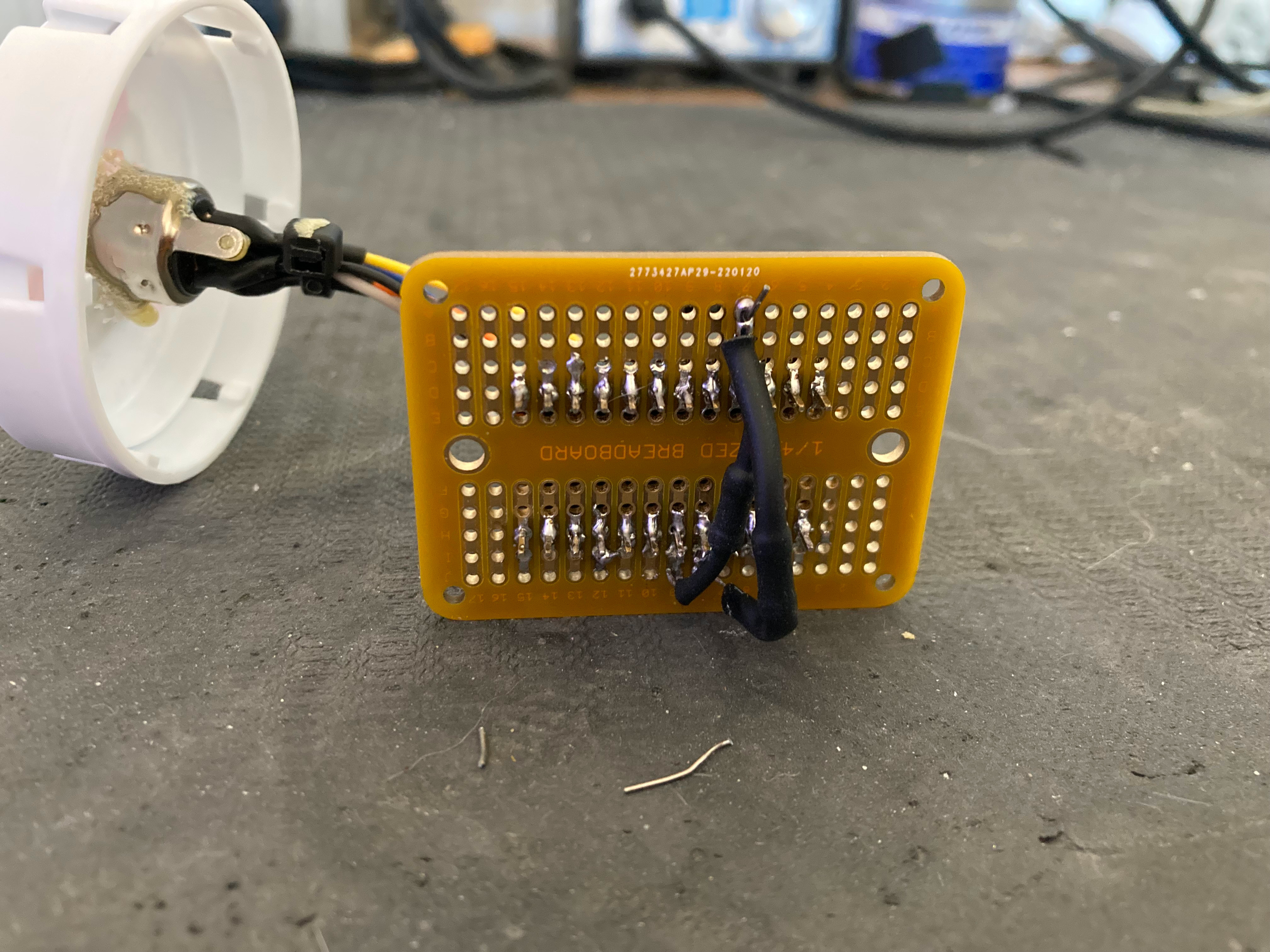

The pics.

* 1553 shows two black shrink-wrapped things. Those are 1K Ohm resistors from VCC to Data and Clock.
* Yellow cable is for reset (not used on this Model F XT, but I soldered it in anyway).
* 1552 has a dollop of solder that looks like it's touching both columns 11 and 12. It's not. Hard to convey 3D-ness.
* Yes, this is way uglier in close ups than I thought it'd be. It's a prototype. I'm old. I use a 5K magnifying lamp.
