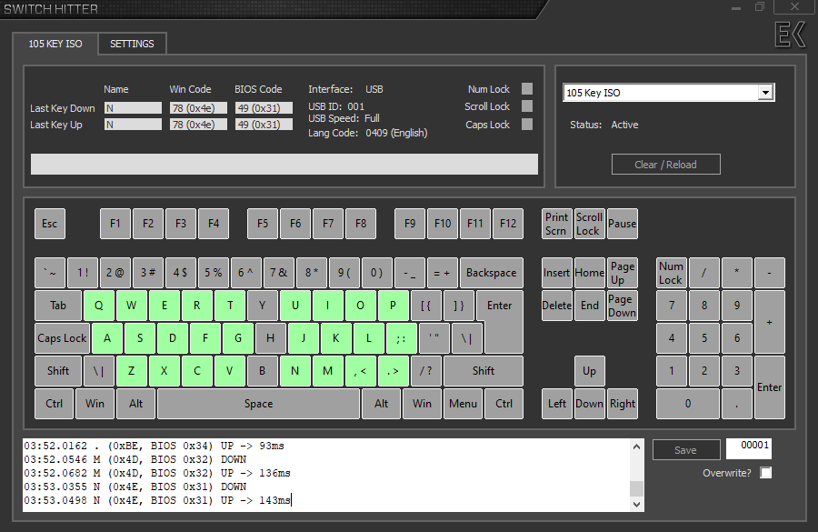

For years I've used the Switch Hitter program from elitekeyboards.com. It appears to no longer be on their site but you can still find some links to download the latest/final version from other websites if you do a search for it. It should pop right up in any search engine. Features I like about this program:
  • Supports 4 keyboard layouts by default: ANSI 104 / 87 and ISO 105 / 88
  • Shows full details about a pressed key: name, win code, BIOS code, and more
  • Has a log that shows the history of what keys you've tested and their details
  • Visual indicator if a key has chatter (aka alert)
  • Has a reset button to clear all keys back to untested state

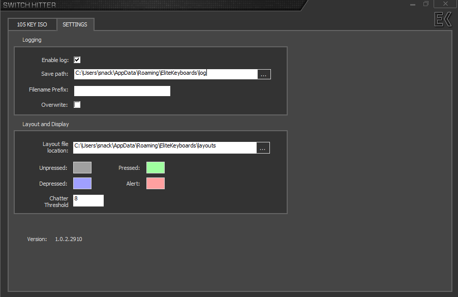

  • Visualized using 4 key states: unpressed, depressed, pressed, alert. (Colors are customizable through settings)
  • Lock key testing
  • Ability to create custom layouts by defining a configuration file (seems simple but I'm not sure how flexible it is in terms of placement just glancing at the config files)
I just noticed that last feature today. It's something I've been looking for while searching through other testing programs and most don't seem to have it.

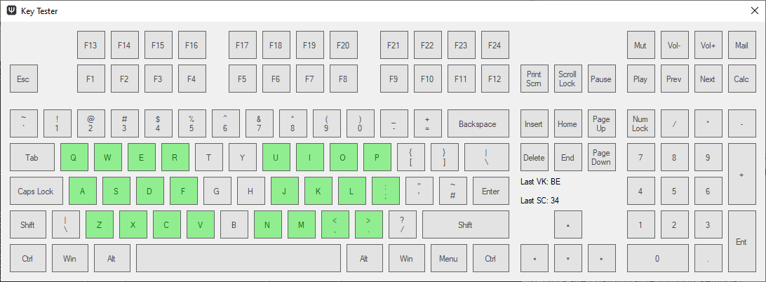

More recently I've found myself using the keyboard tester that's built into QMK Toolbox, mainly out of convenience since I'll already have the program open. Here's a comparison of the features offered by that mini tool:
  • A single 126 key universal layout
  • Limited details about the pressed key: scan code and "VK" (virtual key??)
  • No log
  • No chatter indicator
  • No reset button, have to close out of QMK Toolbox completely and open it fresh
  • Only 3 key states: unpressed, depressed, pressed
  • No lock light testing
  • No option to add custom layouts
I find both programs useful and it's very nice that they're free. Obviously I find the Switch Hitter more featureful and it also just "feels" better (hard to put my finger on).

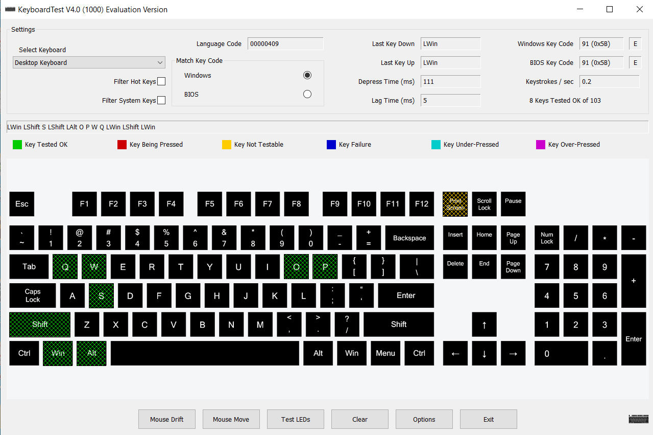

One alternative that I've found is KeyboardTest from PassMark software. It seems to have similar features offered by Switch Hitter but is not free. At $29 for a single license and volume licensing packages available, I get the impression that it's more geared toward corporate IT departments as a support tool (not a bad thing necessarily, but still a bit pricey compared to free). I don't have this software but here's another feature comparison based on what I see on the site.
  • Multiple default layouts
  • Full details about a pressed key (see above) + some more
  • No log, or at least maybe it's summarized keyboard-level logging for testing several keyboards in "batch mode"
  • No "chatter" indicator, but maybe that's covered by some of the other key states it has
  • Yes reset button
  • 6 key press states: tested OK, depressed, not tesable, failure, under-pressed, over-pressed
  • Yes lock key testing, but seems to be on a different screen
  • Yes customizable layouts. Small library of downloadable layouts of common boards on their site (mostly cheap dome boards but I also see OmniKey and a few IBM boards). The config files for layouts seem similar to Switch Hitter so can probably define your own. Looks like it has location information.
  • + mouse and mouse key testing capabilities
  • + Maybe more? (limited info on their site, pet peeve of mine)

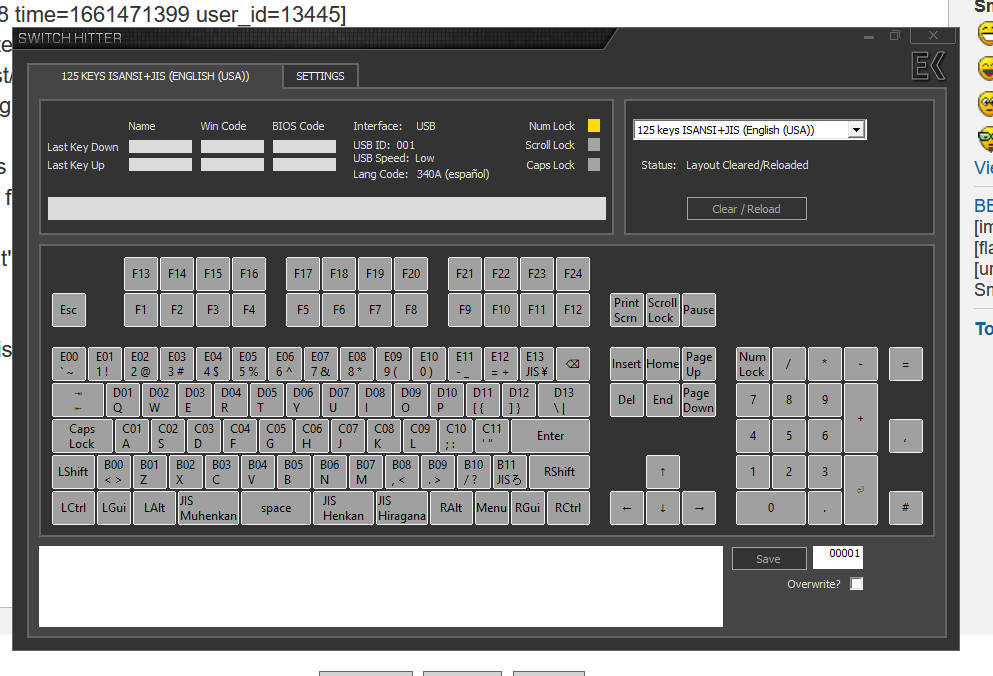

Switch Hitter.
Switch Hitter.

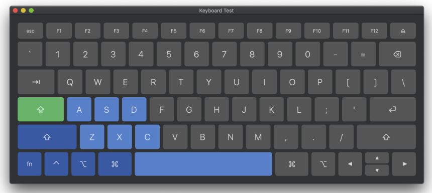

To see which keys are being pressed on my Mac, I'm using Key Codes out of the App Store.
29 Aug 2022, 19:06
Looking at their promotional screenshot:

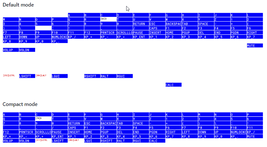

I can't say I'm impressed! If you squint in the right place you can see the active modifiers listed out, but it doesn't strike me as an effective keyboard tester. You really want things plotted out on a chart, like Key Hitter does, and Pandrew's Utility for IBM capsense controllers:
In fact, that very app may be the most effective starting point for a modern, configurable layout, open source, cross platform answer to all this.
Here it is showing my Kishsaver, note the different layout:
Something like this, labelled with the keys as they actually are, would be just the ticket. Pandrew's utility is really for debugging capsense IBMs specifically, so focusses on their matrix's rows and columns. That can be handy for repairing any (well known) keyboard, but the more general use case is even simpler.
