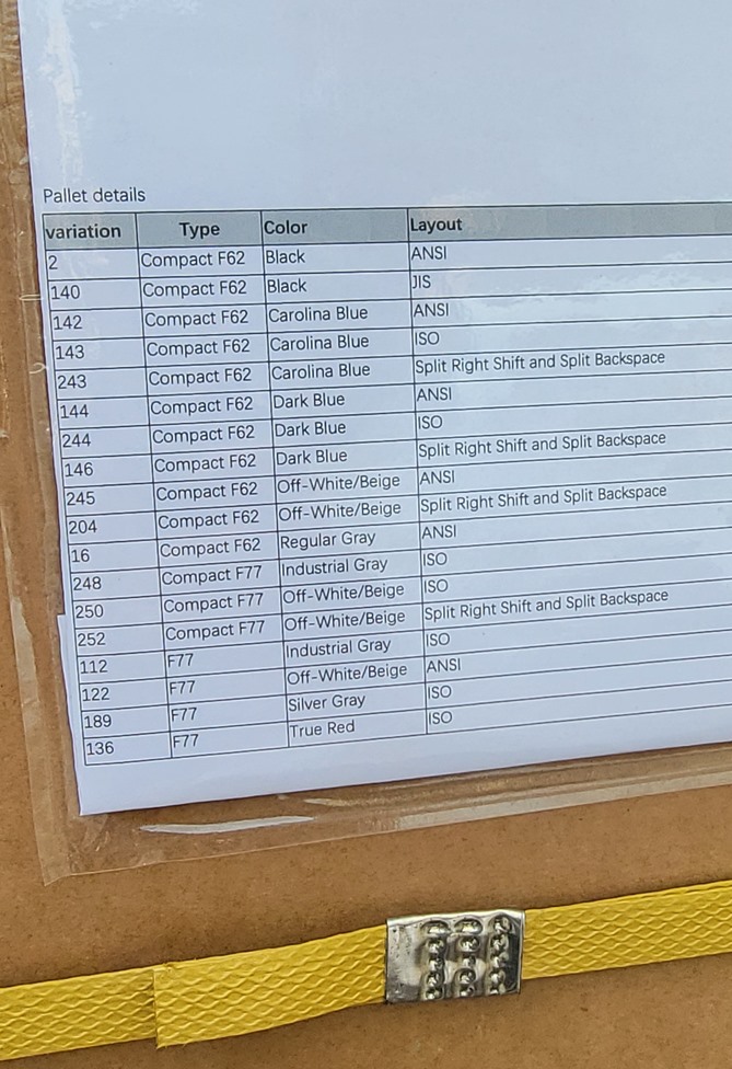

Fourth container shipment update (final round keyboards for F62/F77):
The forwarder picked up the shipping container. This shipment should arrive to me in about 2-3 months (significant congestion in the port of NY and a major shortage of truckers from what I was told). Below are some photos of the beginning of the loading stage (Only some of the boxes are visible in these photos but it will be a full 40' container). Hopefully the factory will send additional photos later.

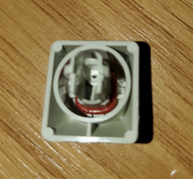

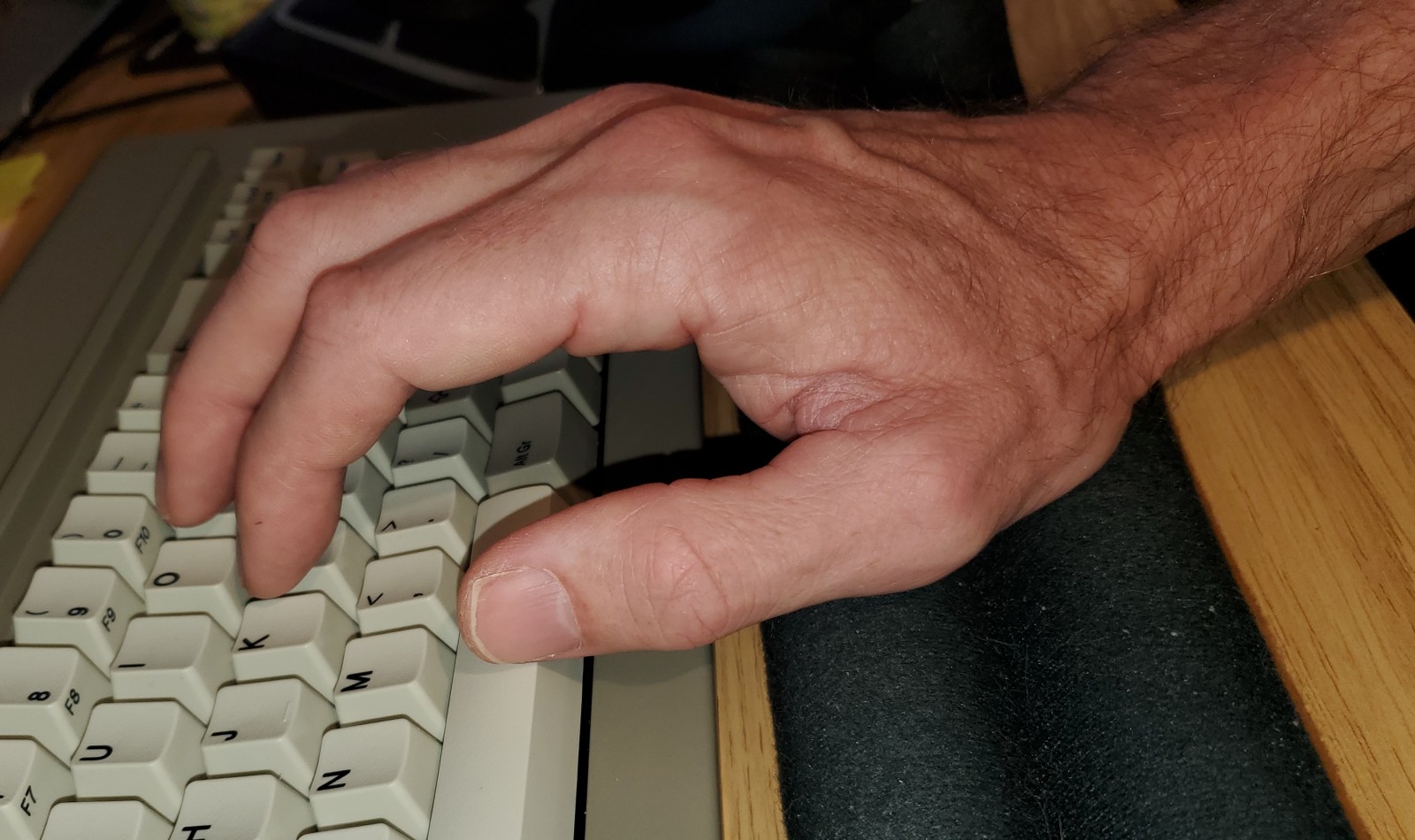

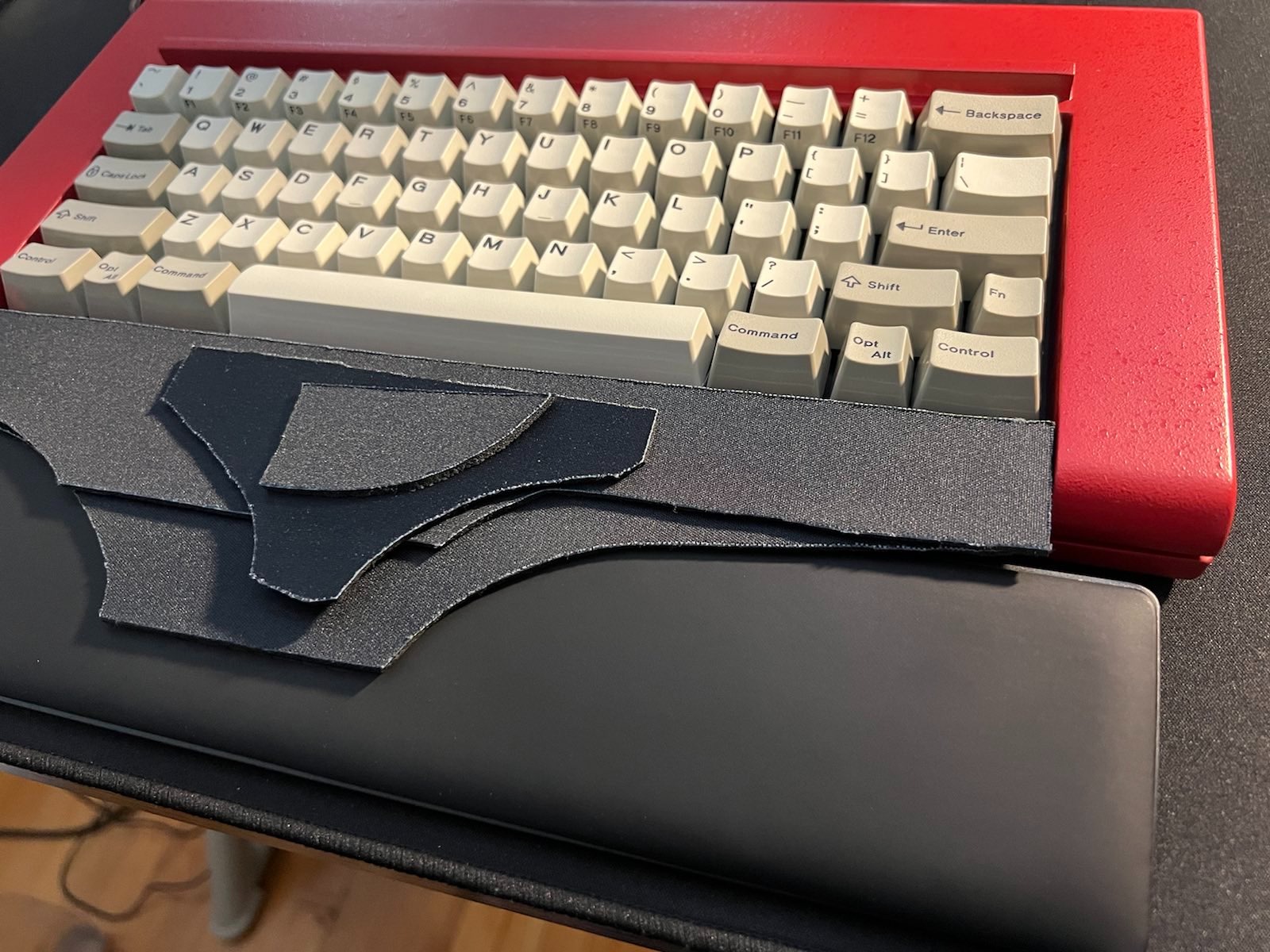

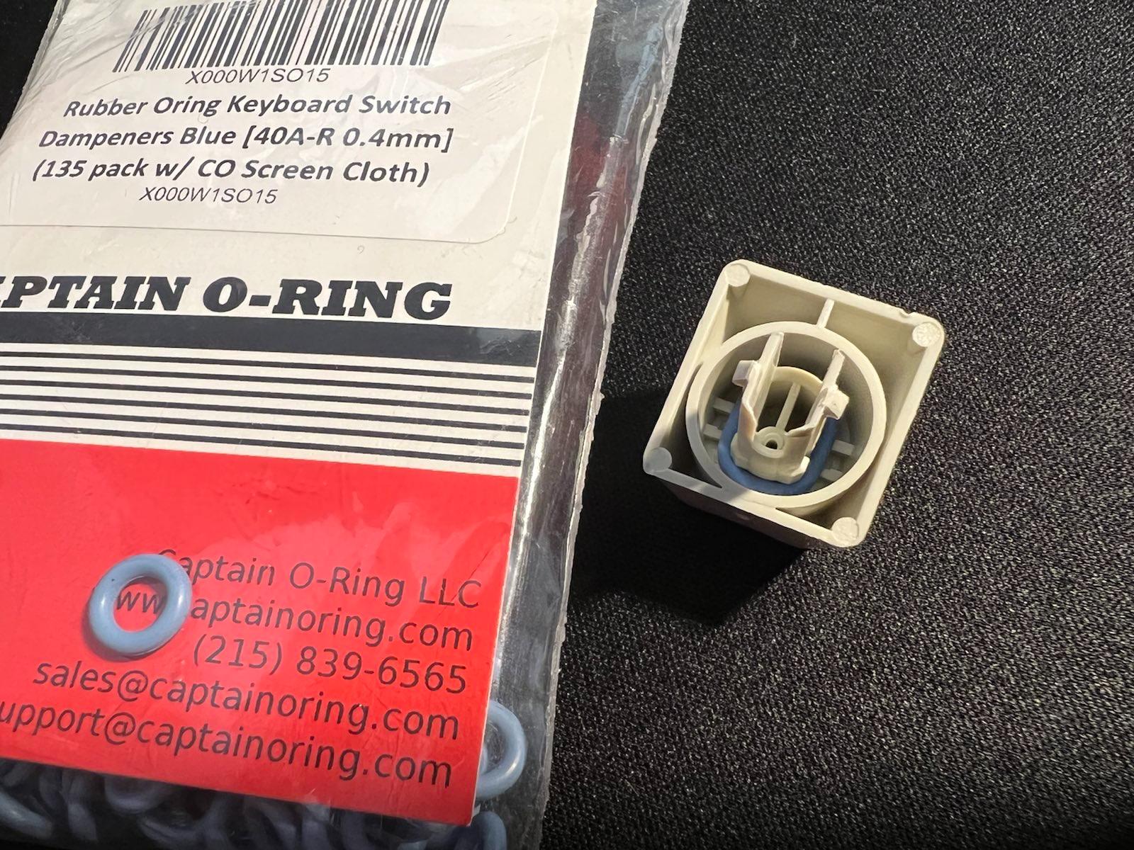

With permission I am quoting someone's interesting experimentation to adjust the spring length and add o rings to the keys, and some questions for everyone:
"I am working on an ergonomics-motivated modification to reduce key travel on the Model F. As part of the process, I have to stretch the springs by just the right amount to move the actuation point closer to the top of the keystroke. This is a pretty tedious and error-prone process, and once over-stretched, I find it difficult to compress the springs again without introducing buzz, so I am going through a lot of springs this way. For my purposes, the ideal spring length is 18.75mm, as measured by my Vernier calipers."
My reply: During my R&D, I actually ordered 2 batches of springs slightly longer than my current batch, 18.475mm and 18.5 mm. [note 9/7/22 I still have more than 160 springs available of each type if anyone's interested - please PM or email me]
Replying to me: "I just installed the new springs in a couple of keys that were giving me some issues, and I am happy to report that the longer springs work really well. They require just a very gentle stretch to work with 0.4mm EPDM O-rings around the stem (a trick carried over from the Cherry MX world -- see attached). This reduces vertical key travel a bit and makes the keyboard a little easier on the tendons. I am somewhat curious to see how much more I can reduce it, but that is a task for another day when I have more free time. For now this already makes a huge difference in comfort.
What other ergonomics tricks are you aware of with the F62/F77? One of the things I really struggle with is the height of the thing. I built up a temporary palm/wrist rest out of an existing one and some cut pieces of a mouse pad stacked on top of one another to form a gentle slope toward the middle. This helps with using the space bar without making my thumb tendons too angry and the slight "hill" in the middle takes some load off of the pisiform bone when resting the hands. I made a thread with some ideas here. I am curious to see how others solved similar problems."

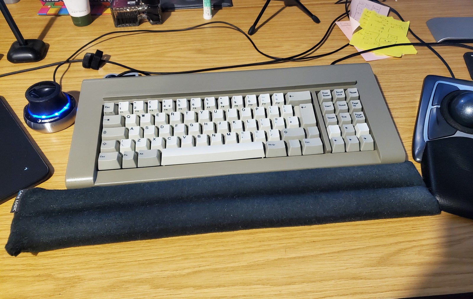

Ellipse wrote: 07 Sep 2022, 19:13 What other ergonomics tricks are you aware of with the F62/F77? One of the things I really struggle with is the height of the thing. I built up a temporary palm/wrist rest out of an existing one and some cut pieces of a mouse pad stacked on top of one another to form a gentle slope toward the middle. This helps with using the space bar without making my thumb tendons too angry and the slight "hill" in the middle takes some load off of the pisiform bone when resting the hands. I made a thread with some ideas here. I am curious to see how others solved similar problems.
Interesting re. the rubber rings, I'd not considered that. I used to use red o-rings on my cherry blues so I've just tried one and it gives a nice soft finish to the keypress, also the key still works fine with the original springs. Right.... this may take some time. (just checked - 1.5mm thick)
For wrist wrest I have an old thick double gel thing (although I can't find it online anymore "CaseLogic GL-1") which is the perfect height for the ModelF for me (~35mm), being a really soft gel I find it moulds around my wrist and I tend to have it slid slightly back:
20220908_080206 (1).jpg (370.49 KiB) Viewed 22633 times
(having trouble getting a picture of the height! but about this:)
