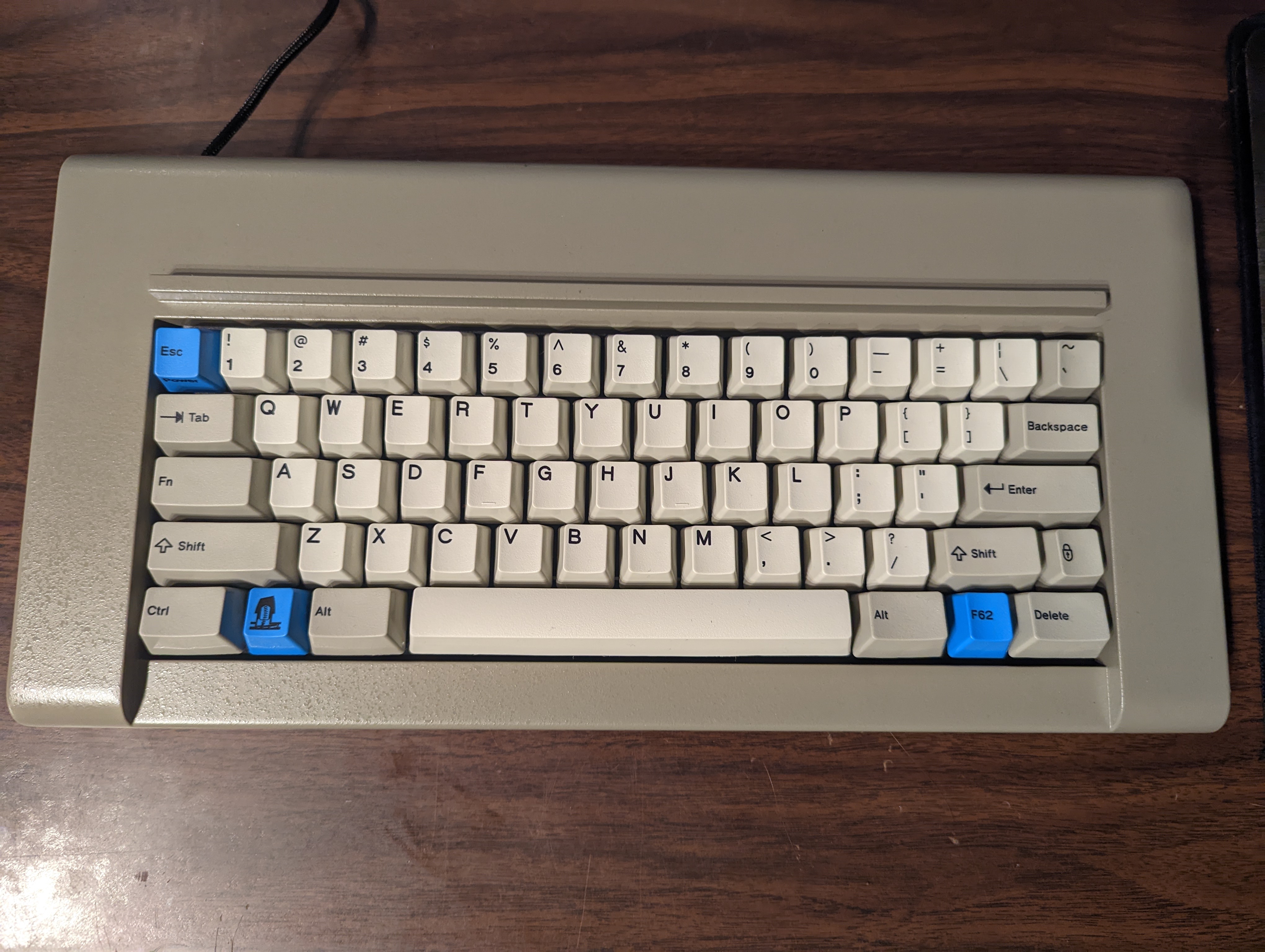

xji wrote: 12 Sep 2022, 18:11 I'm at the last step of assembling the keyboard (F62 model with HHKB layout), where all that's left is the bottom row of keys. However, apparently the lower end of the keys would overlap the stabilizer wire of the spacebar? Here's a photo:
In the first photo it looks like the stabilizer wire has moved on top of the hooks, whereas in the second photo it is correctly installed. It should be in both hooks, then the keys will sit above it but bottom out before they hit the wire.
(To answer the question: yes, reinstall the spacebar to be like the second photo.)
That was it! Thanks. Now I'm typing on the keyboard already :)

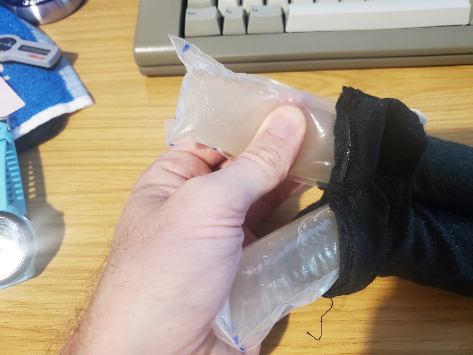

taraskremen wrote: 10 Sep 2022, 20:59 The gel rest in the pictures looks interesting. It is rather difficult to find one tall enough for this board, but it's good to know that they are out there. From the images, it looks like your F77 if flat on your desk. Is this the case? In any event, thanks for sharing!
Yeah annoying that this one's no longer made, someone must do something similar, I find it's perfect for me and the F77.

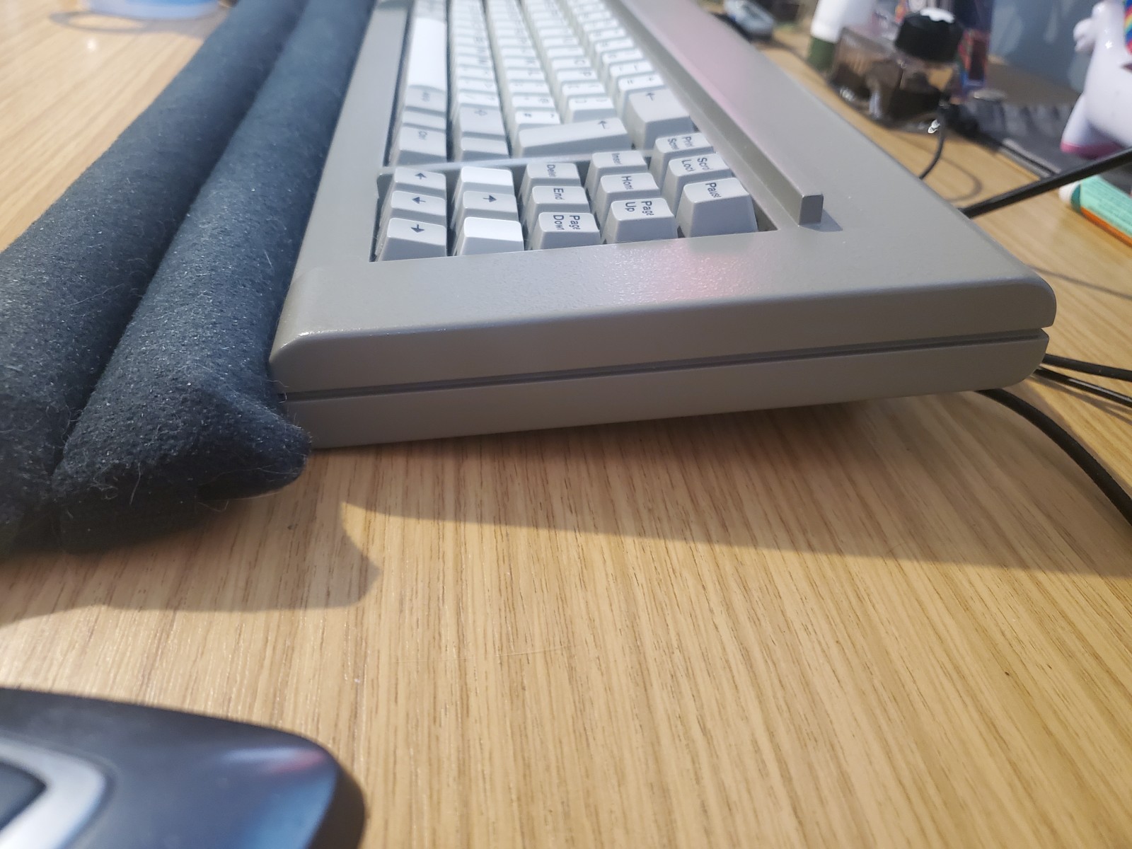

I have the large bumpers at the rear sloping the keys forwards, this way the rest sits just proud of the metal case. (I have them stuck on with double sided tape, as you can see I was experimenting with different heights until I was happy :D )
The gel in these is very soft so it deforms and moves much more than most gel rests - it's like a "gel/air" mix inside a tube:

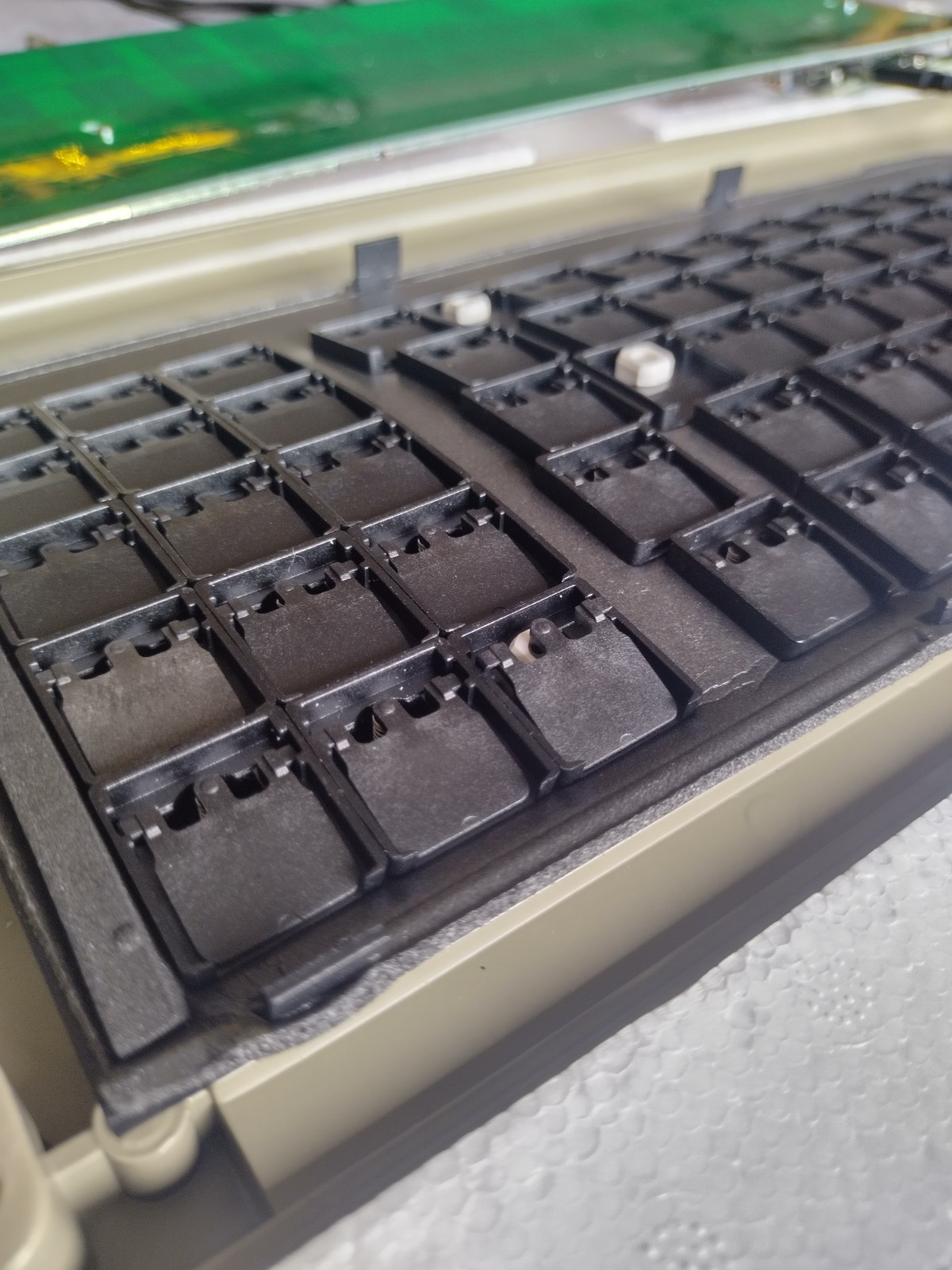

xji
14 Sep 2022, 08:28
Heisenberg122 wrote: 08 Jul 2022, 00:33
Ellipse wrote: 06 Jul 2022, 06:06
Heisenberg122 as noted in the manual that specific issue is probably fixed by tightening the 2 controller ground screws and perhaps adjusting or replacing the spring of the space bar.
Ellipse, thanks for the answer.
I did the following tunings without testing them one by one. So I don't know which one corrected the lag problem but now it seems that the problem disappeared. I can type on the keyboard without timing mistakes;
First, I removed the spacebar and loosened the metal tabs a bit as advised in the manual. Now it a way rattles.
Second, I removed the spring and replaced it with a new one from the first aid kit. And I tried my best to put it inside the barrel exactly as described in the videos.
Third, I replaced the complete space bar set with the stabilizer metal wire from the second spare key set
Now, the spacebar registers perfectly without any lag. So, I don't know which one of the tuning steps above worked, but it's O.K. now except for the rattling of the spacebar :) which doesn't matter to me.
I also have the same issue with the space bar lagging, especially on the right half of it (around the 60% - 80% range counting from left to right), which is customarily the part I use while typing. Curiously, without the stabilizer wire, I can indeed press down on the right half (albeit the lag still somewhat persists), while it's almost impossible to press down on the left half.
Also, if I keep pressing down on the space bar around that 60% - 80% area, the keyboard fails to register continuous <space> inputs, while pressing down on any other area (even more to the right) seems to work fine.
I tried to adjust the metal tabs to little effect.
Does the description above point to a clear issue? I imagined it might be something obvious if only a certain segment of the space key behaves differently. Maybe I should tinker with the metal tab to the right a bit more?...
I also saw this paragraph from the manual that a common solution to a lagging space bar would be to "loosen the clips a touch with a screwdriver". Could somebody point to me what the "clips" here refer to? Since it's not saying the "tabs", I supposed it's something different, but at a glance I couldn't find anything I could touch with a screwdriver... Or does it indeed refer to loosening the tabs a bit more? (Somebody also mentioned "controller ground screws" above.)
I would appreciate your help here. Thanks!

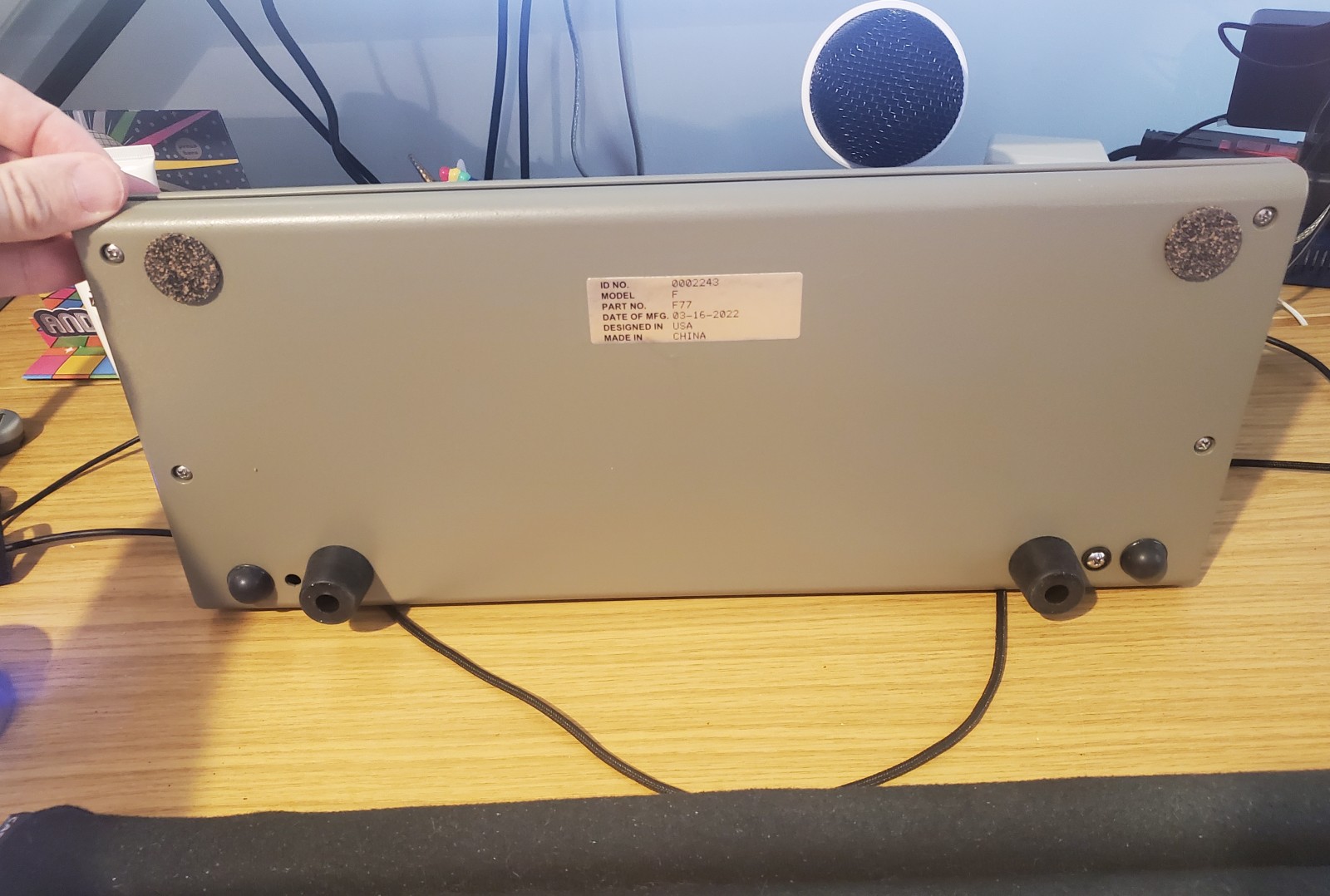

xji
14 Sep 2022, 08:37

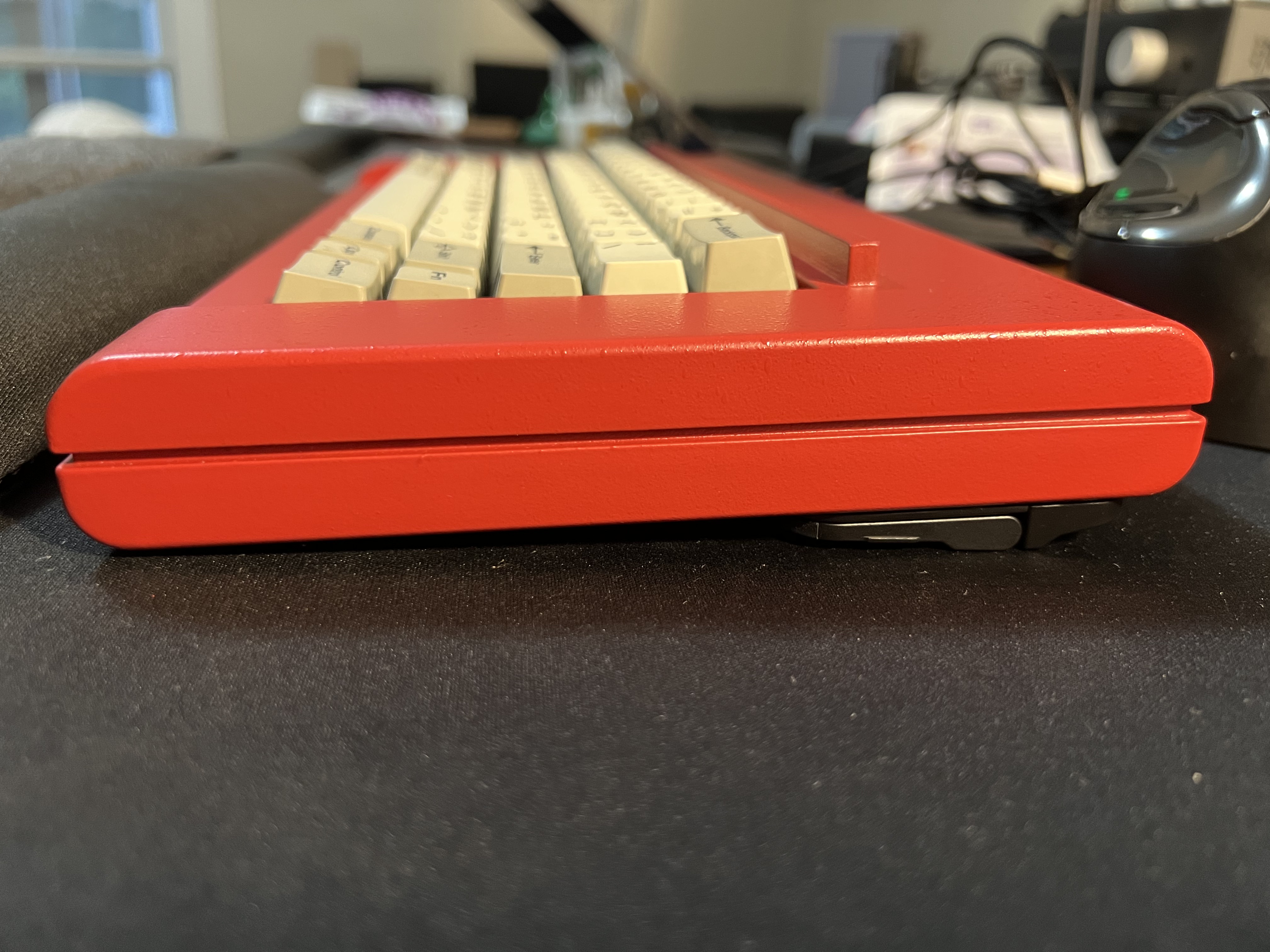

Another issue I have encountered is that the keyboard actually wobbles a bit diagonally on the desk while I type. I wonder if this could be addressed by redoing/tightening some of the screws on the bottom, since I'd imagine the bottom of the keyboard itself must be flat.
Arkku
14 Sep 2022, 12:15
xji wrote: 14 Sep 2022, 08:37 Another issue I have encountered is that the keyboard actually wobbles a bit diagonally on the desk while I type. I wonder if this could be addressed by redoing/tightening some of the screws on the bottom, since I'd imagine the bottom of the keyboard itself must be flat.
Did you install the feet? The bottom of the keyboard is not supposed to directly touch the desk.
Ellipse
14 Sep 2022, 17:53
xji as noted in the post you quoted, adjusting the spring is a top recommendation for inconsistent key registration, but also please do follow the manual on the project web site which has a section specific to troubleshooting, and specifically to adjusting the space bar. The clips and tabs are the same thing - two of these hold the space bar stabilizer wire in place underneath the keys.

xji
15 Sep 2022, 08:13
Arkku wrote: 14 Sep 2022, 12:15
Ah, of course I totally overlooked this. I see now on the store page for bumpers that the square rubber bumpers are included by default with the ultra compact layout. Thanks for pointing this out!

Jesse9766 wrote: 13 Sep 2022, 20:14 I just received my keyboard a week ago, and have troubles with the ANSI-US left shift registering when pressing the right side of it. The spring buckles, but the key isn't actually activated. The key works normally when pressing the left side. I've tried taking the keycap out and putting it back in, but the issue still occurs. Has anyone experienced a similar issue, and how should I fix this?
Turns out mine had the same issue. Noticed after some use. Whittled a chopstick to a narrower point and used that to reseat the spring a few times. I eventually decided it was a bad spring, so I installed one of my spares, and the new spring buckles properly.
Note that the docs Ellipse mentioned are very particular about spring orientation, as well as some other things you can try before resorting to reseating the spring.

Jesse9766
16 Sep 2022, 01:32
the_reifier wrote: 15 Sep 2022, 23:07
This advice was pretty helpful - at first I used tweezers to reseat the spring and that didn't seem to fix anything. I replaced the spring with a spare and it works better now. Still an issue with registering pressing the very right edge, so I suppose I'll need to play around a little bit more, but at least it's usable now. The left shift key has a little more resistance than the rest of the keys, perhaps I should adjust the insert a little bit.

Received my F77 after a bit of wrangling with Canada Post
('it's heavy' commented the person who finally handed me the package).
Initial impressions to provide a data point:
  • Keyboard sound slightly different than I expected, not in a bad way. The plastic 'clack' component of the sound carries further than I expected, the metallic 'ping' does not. So the sound in the adjacent room is similar to a very enthusiastic kid opening giant bags of Lego bricks and pouring them onto the floor. If someone complains about the racket, I might have to switch to my HHKB outside daylight hours :}
  • Initial installation went very smoothly, just 2-3 keys needed a second attempt to install. Looks like it pays to read the instructions and hold the kb spacebar side up :) that said, because I was figuring out the layout as I went along, I didn't follow the directive "don't let the keyboard rest horizontally until each key has been fully pressed in" as I kept lowering it to go through my collection of keys.
The couple of issues that came up were easy to fix:

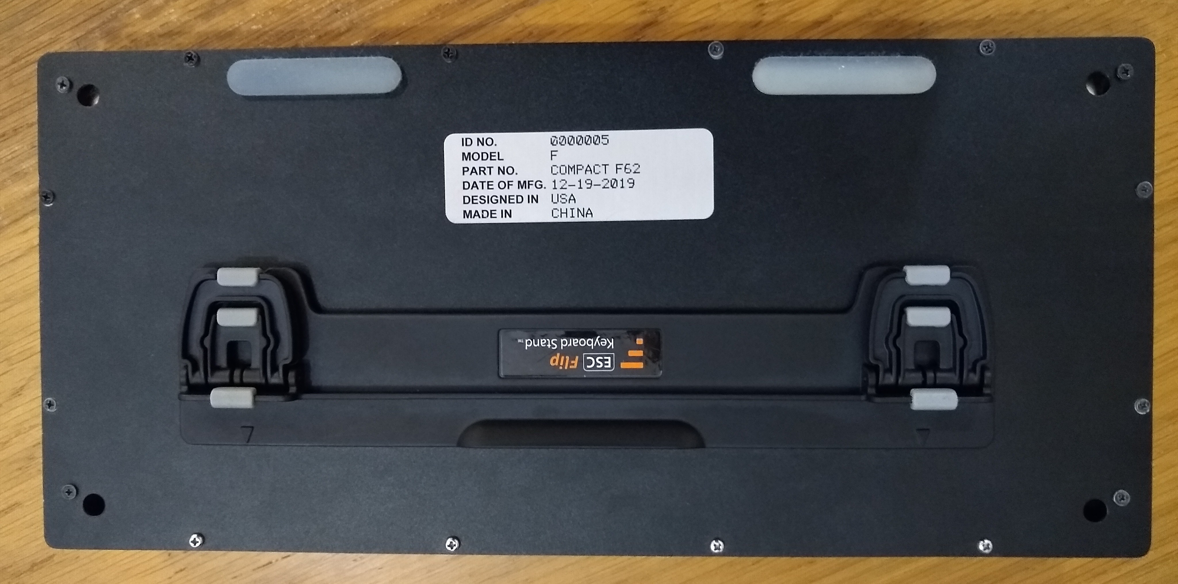

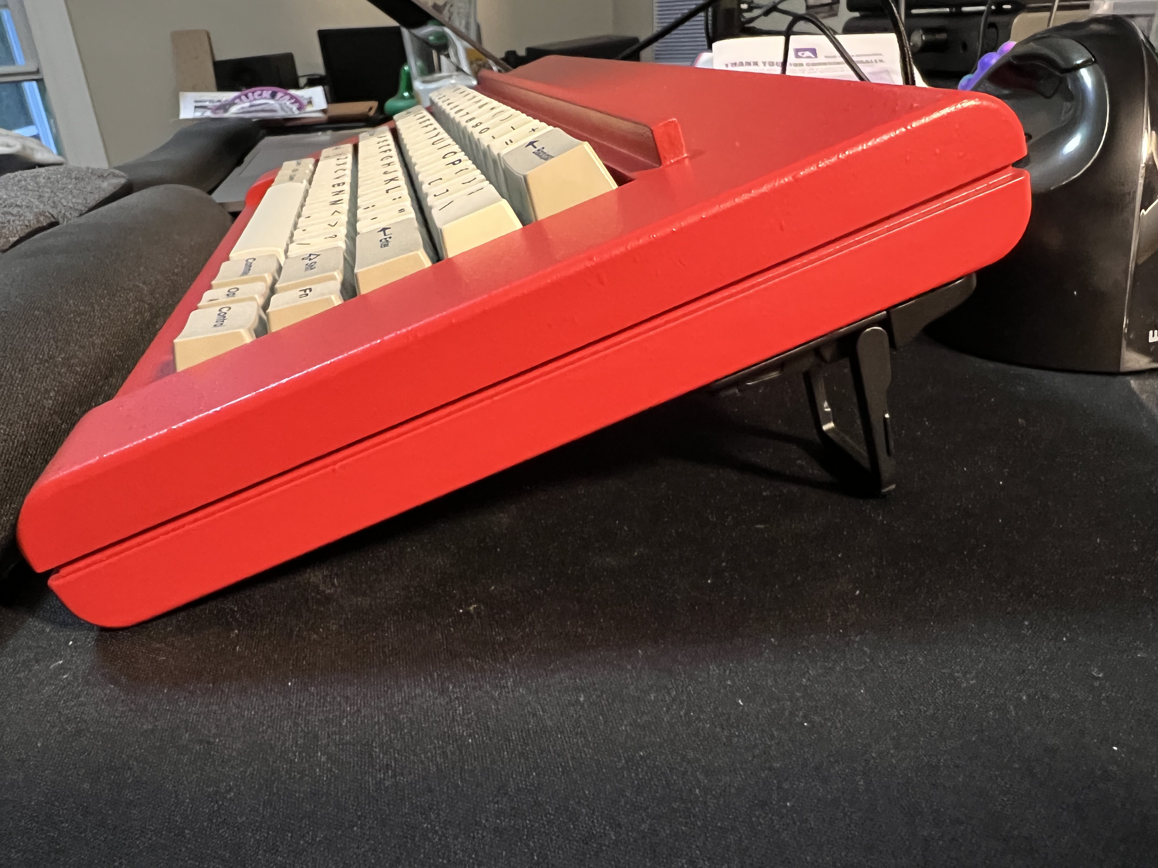

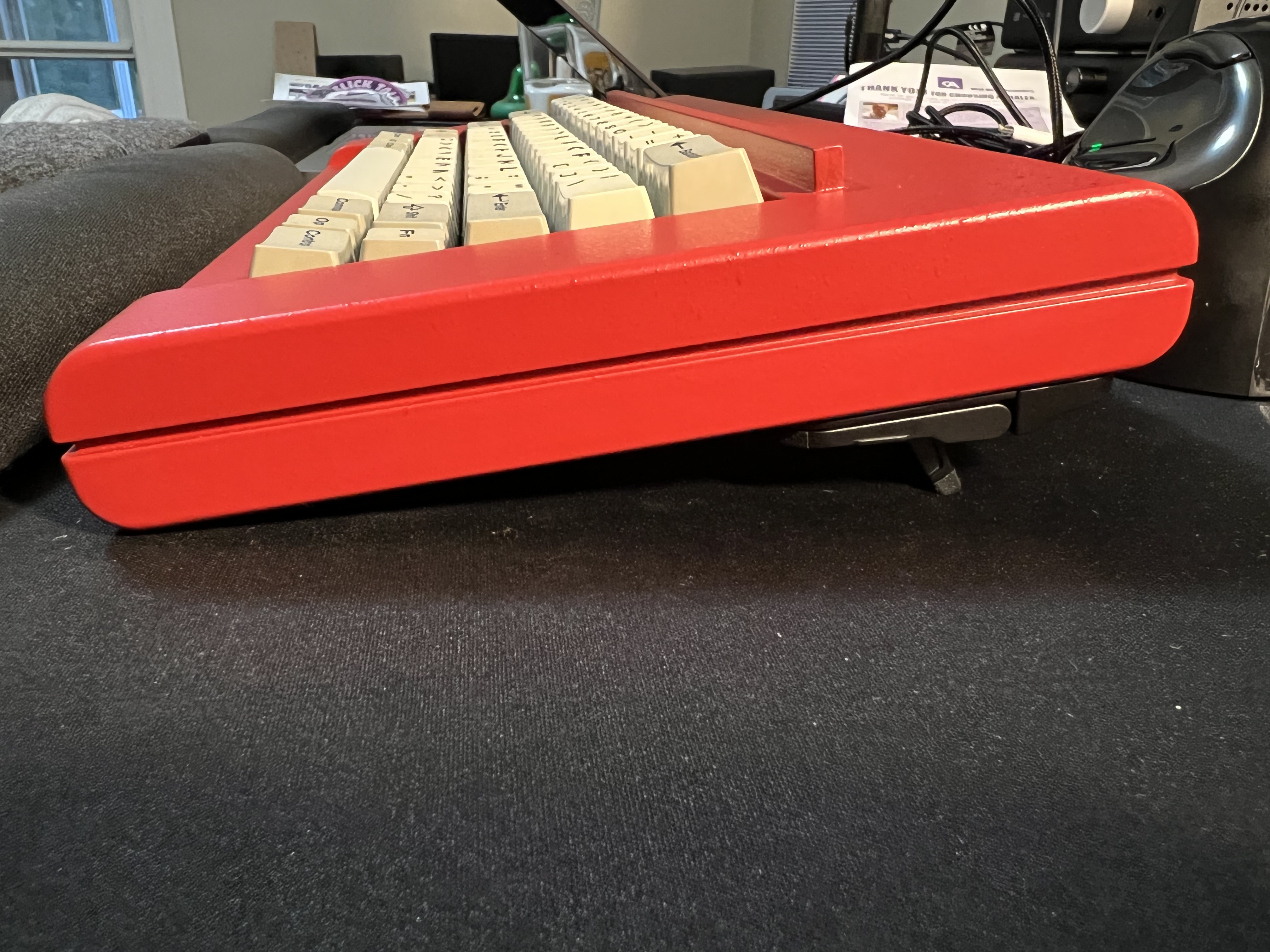

  • Keyboard wobble after attaching the cork feet. I thought the keyboard could be leveled by adjusting the bottom screws, but apparently not. In the end, I stuck layers of electrical tape under one of the feet to even it out.
  • Right Shift key was unreliable. Tried reseating the keycap several times, finally gave up and just replaced the spring to fix it.
  • Kept seeing transposed / out of order / out of sequence characters e.g. 'build/buidl', 'help/hepl'. At first I thought this might be that 'loose controller screws' issue described in the manual -- but opening up the case I found the controller was tightly screwed in. Loosening and re-tightening the screws didn't fix it. Then I realized that all transpositions involved the 'L' key. Pulling out and carefully reseating the keycap fixed it -- the transpositions decreased in frequency and then stopped entirely after a bit of typing to break the key in.

Jesse9766 wrote: 16 Sep 2022, 01:32 This advice was pretty helpful - at first I used tweezers to reseat the spring and that didn't seem to fix anything. I replaced the spring with a spare and it works better now. Still an issue with registering pressing the very right edge, so I suppose I'll need to play around a little bit more, but at least it's usable now. The left shift key has a little more resistance than the rest of the keys, perhaps I should adjust the insert a little bit.
Glad that helped. Did you orient the replacement spring such that it is at the noon-1 position? This seems to matter.
Coincidence that the same spring was bad on both of our boards :D I bet the 2U+ size (requires stabilizer) reveals any flaws in the springs. If this is true, then the enter and Rshift springs may need adjustment or replacement on some keyboards.

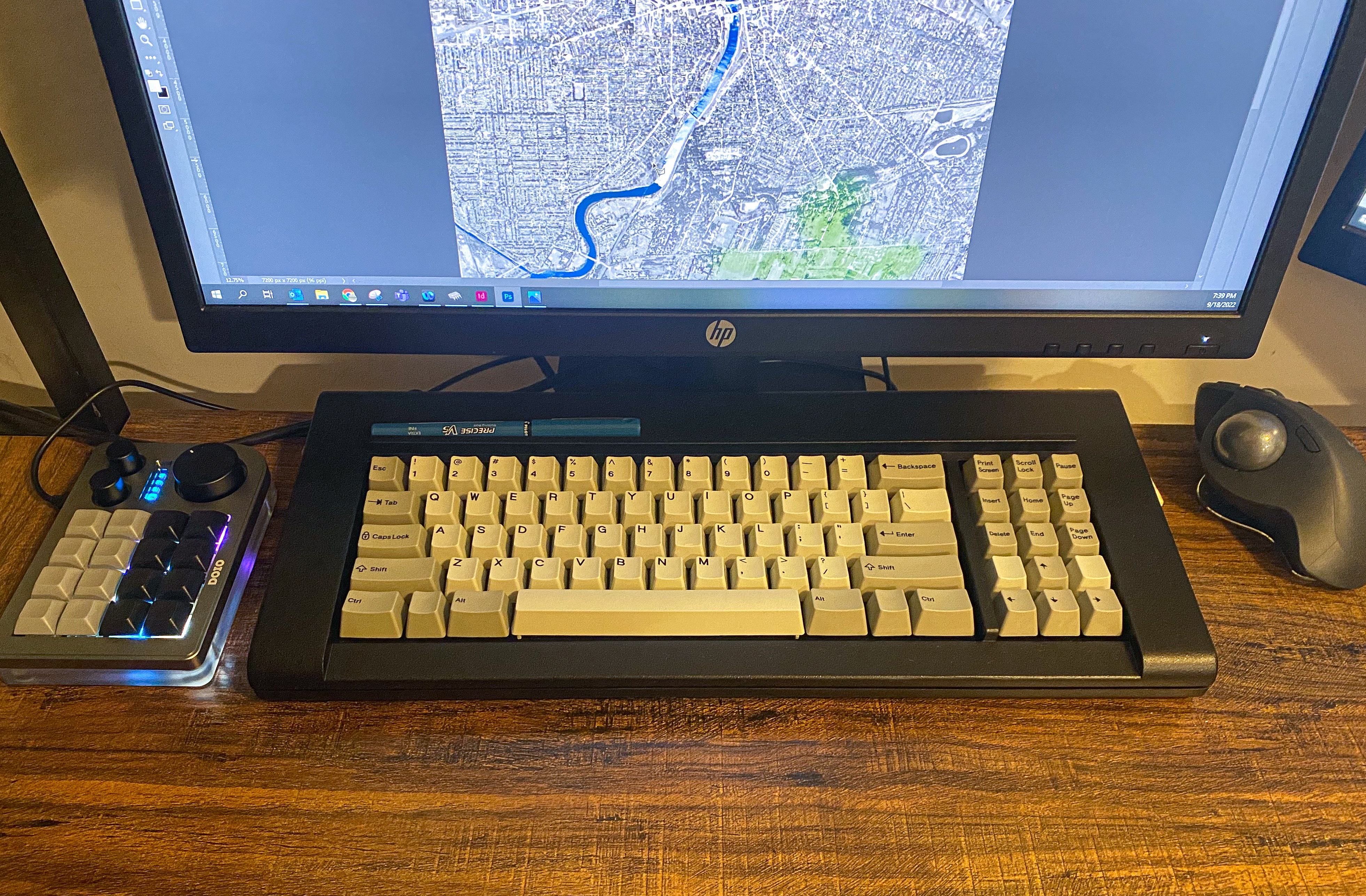

Posting, with permission, another nice and unique setup, this time of the F62 classic style keyboard in Industrial Gray, with a customized split right shift layout.
f62 - Copy.jpg (2.52 MiB) Viewed 11175 times

taraskremen
21 Sep 2022, 01:07

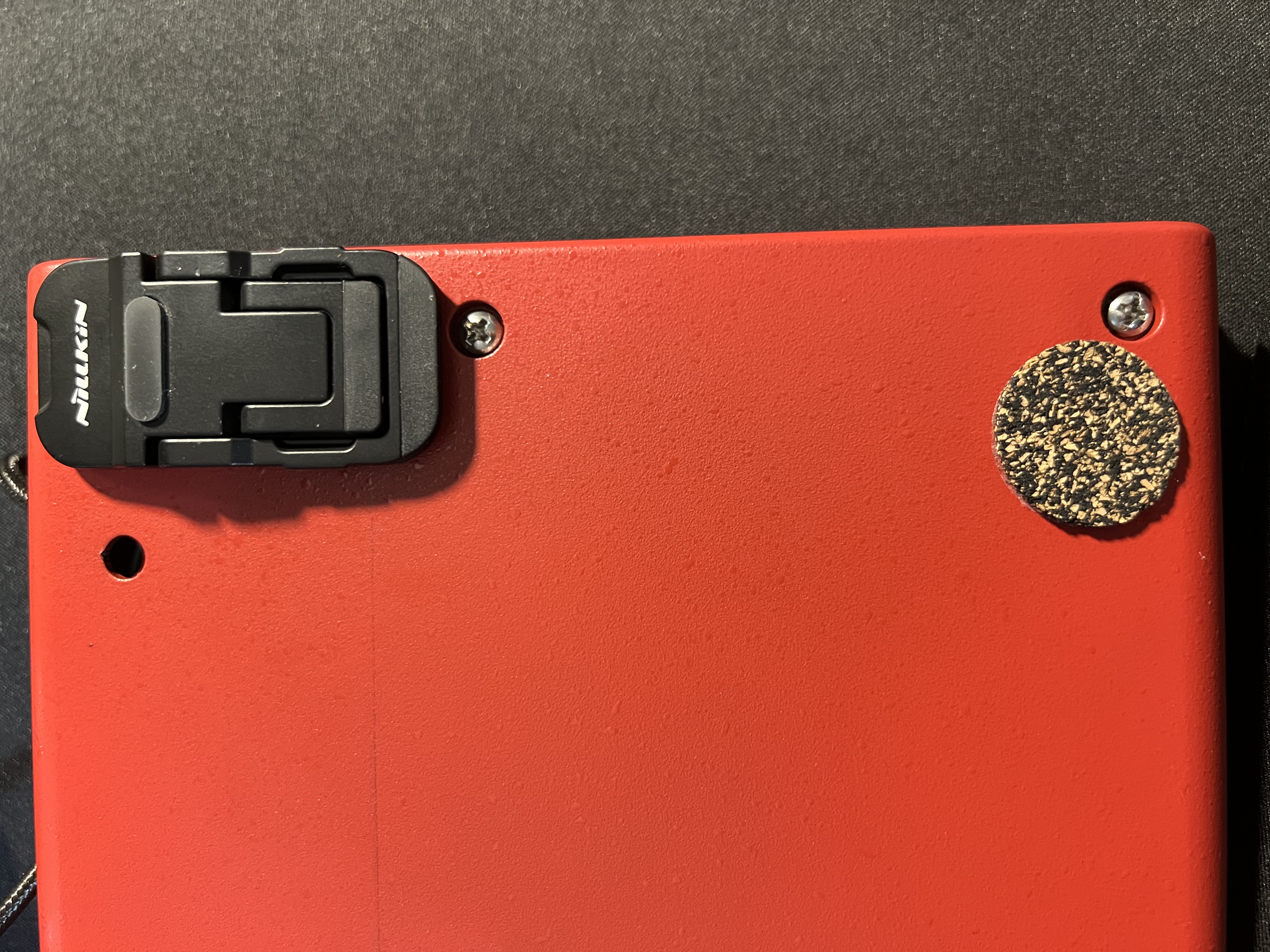

Going back to my earlier post about the o-ring mod, I wanted to show what the difference looks like between a key with the blue o-ring installed and one without an o-ring. In the photo below, the key on the left has the o-ring, and the one on the right does not. I cannot overstate the effect on typing comfort. It is really night and day. I can finally use the F62 as a more-or-less daily driver, whereas before the mod I had to stop using it after a few hours due to tendon pain. The several days it took to re-adjust the springs were worth it, IMO.
Another thing I wanted to mention is that I found that these risers work pretty well with the F62 (and probably with the F77). I followed the directions and left them alone for at least 12 hours before using the board, and they are staying put so far with just their adhesive pads. In addition to slightly elevating the back in the folded state, they give you a choice between two positions, which is handy.
