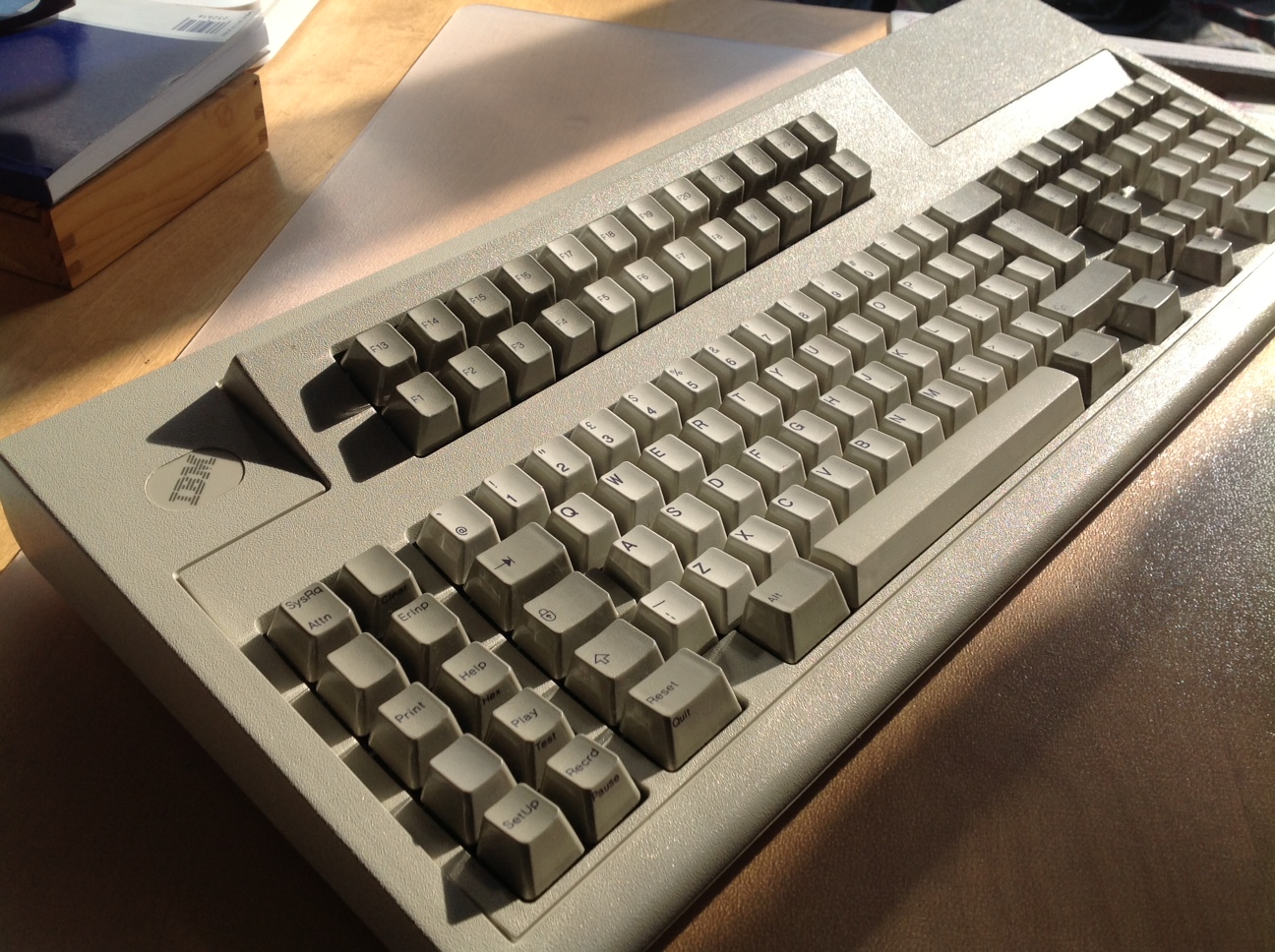

Hi,
I restored a few Model M 122 key terminal keyboards and also used the Soarer's Converter to flash Arduino Pro Micros with.
The way to write your config files and flash them to the converter is fairly easy if you done similar things before. But when you did not, it may be a bit difficult. That's why I tried to make a UI for the Soarer's Converter.
With this very early version you can see your keyboard and click an a key (right ALT in this example).
You can then select a key to remap to (I only entered 3 keys for testing).
And then you see the mapping below.
Of course there are many features still missing, e.g. switching to another keyboard layout, macros, layers, read and write configs to the converter directly etc.
But do you think this could be interesting to continue as a tool for beginners?
EDIT: See viewtopic.php?f=7&t=27533 for releases and download links.
