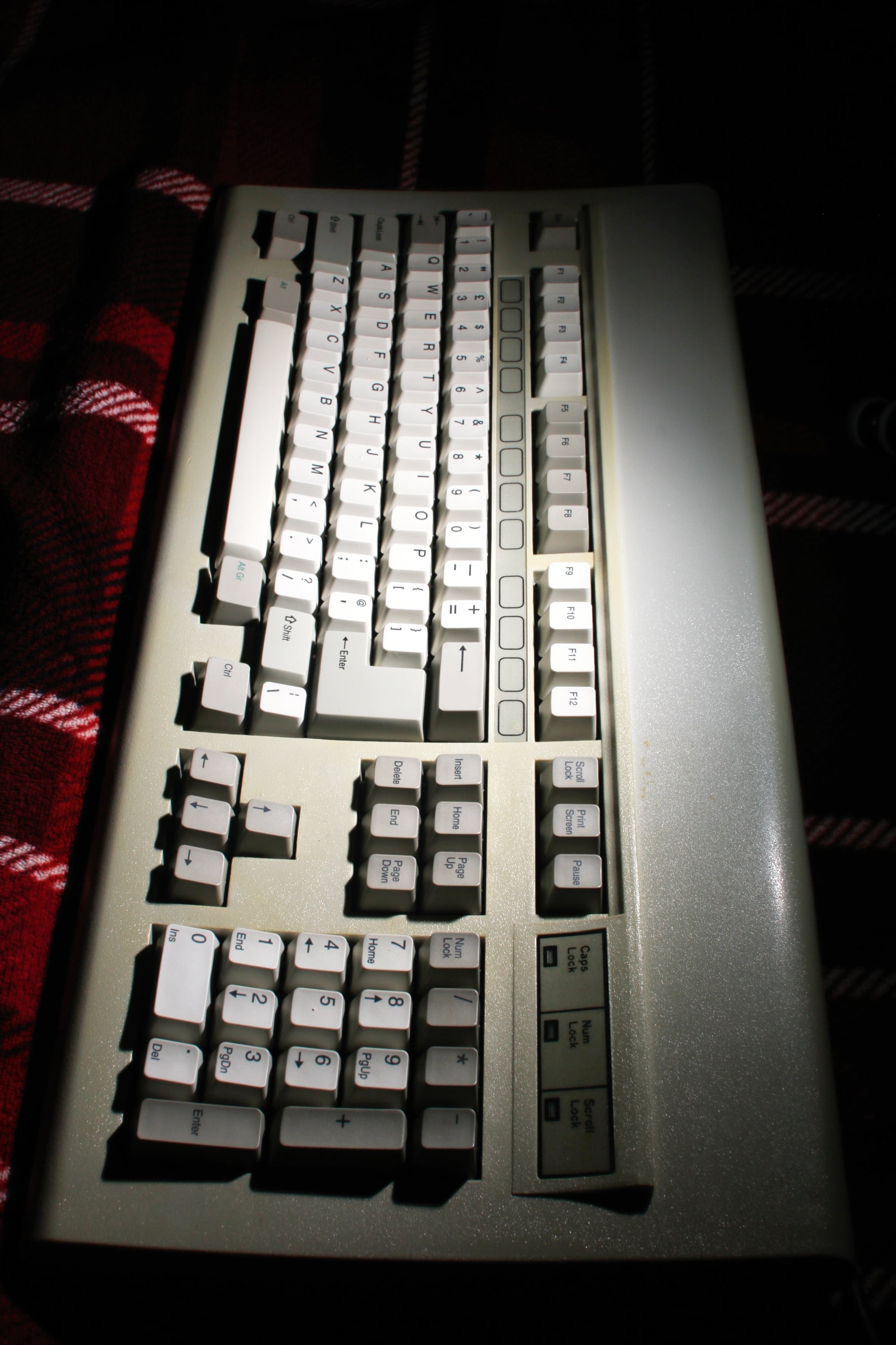

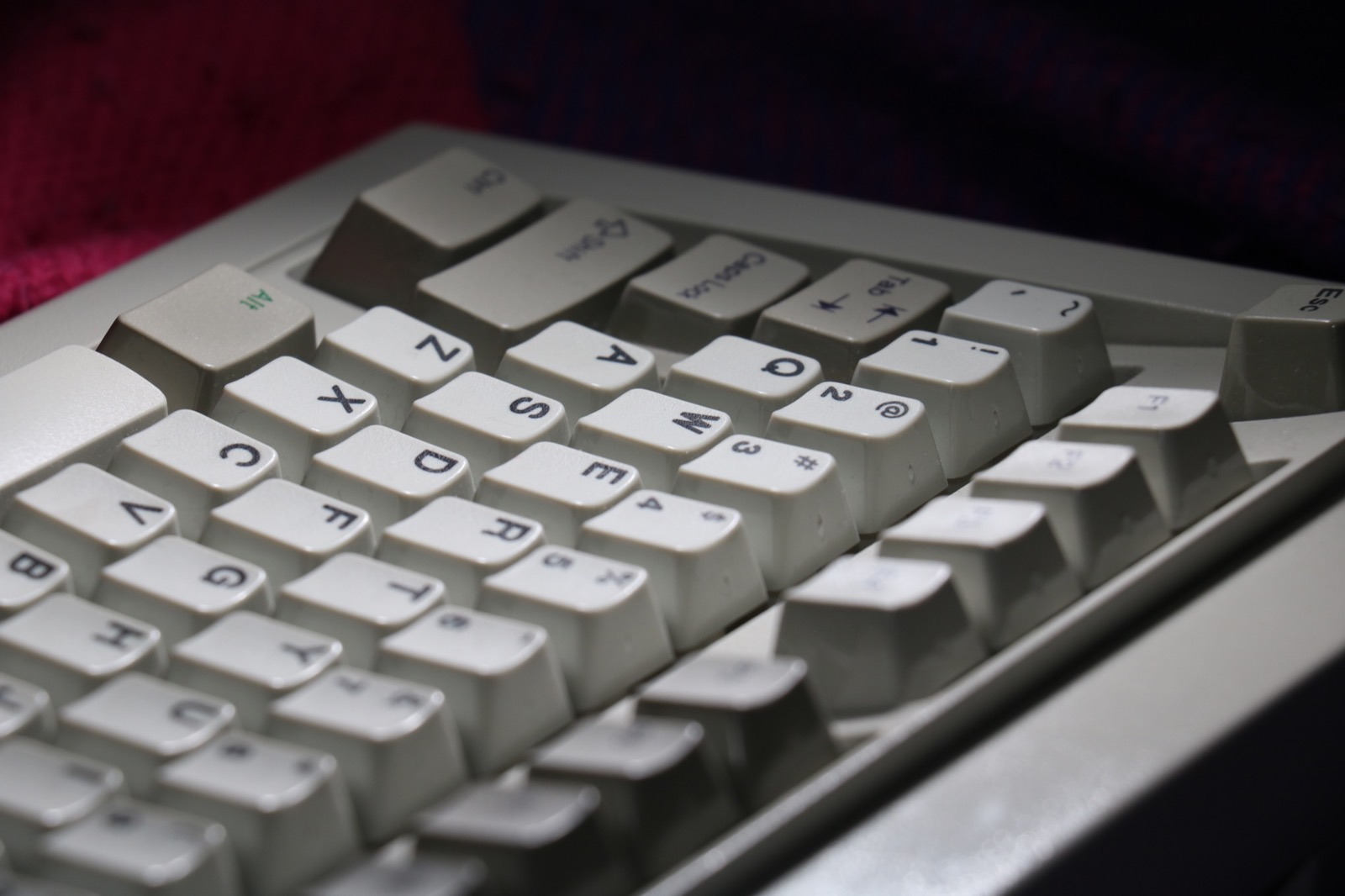

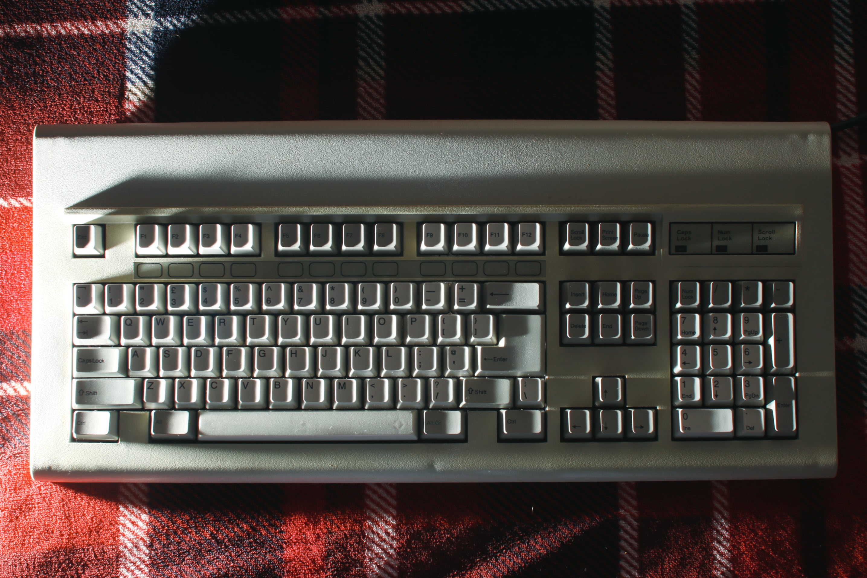

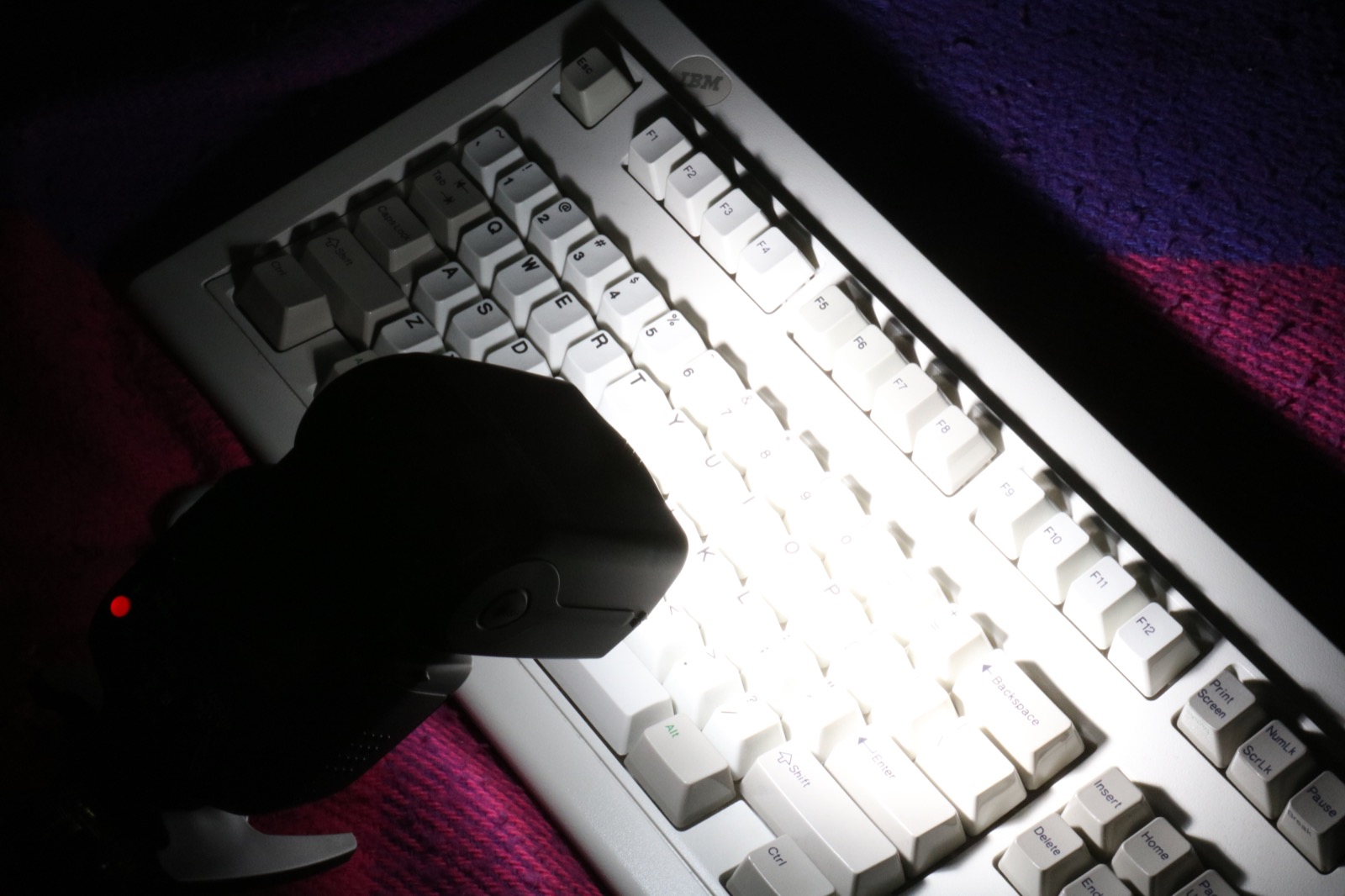

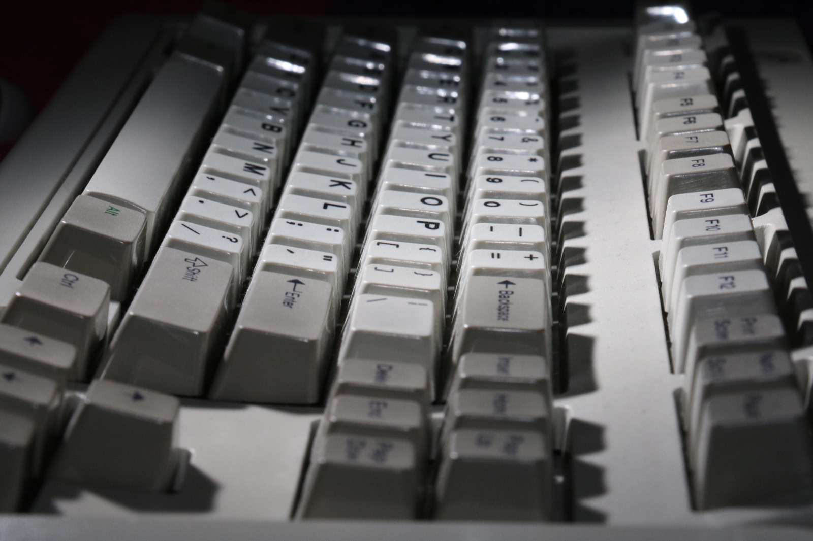

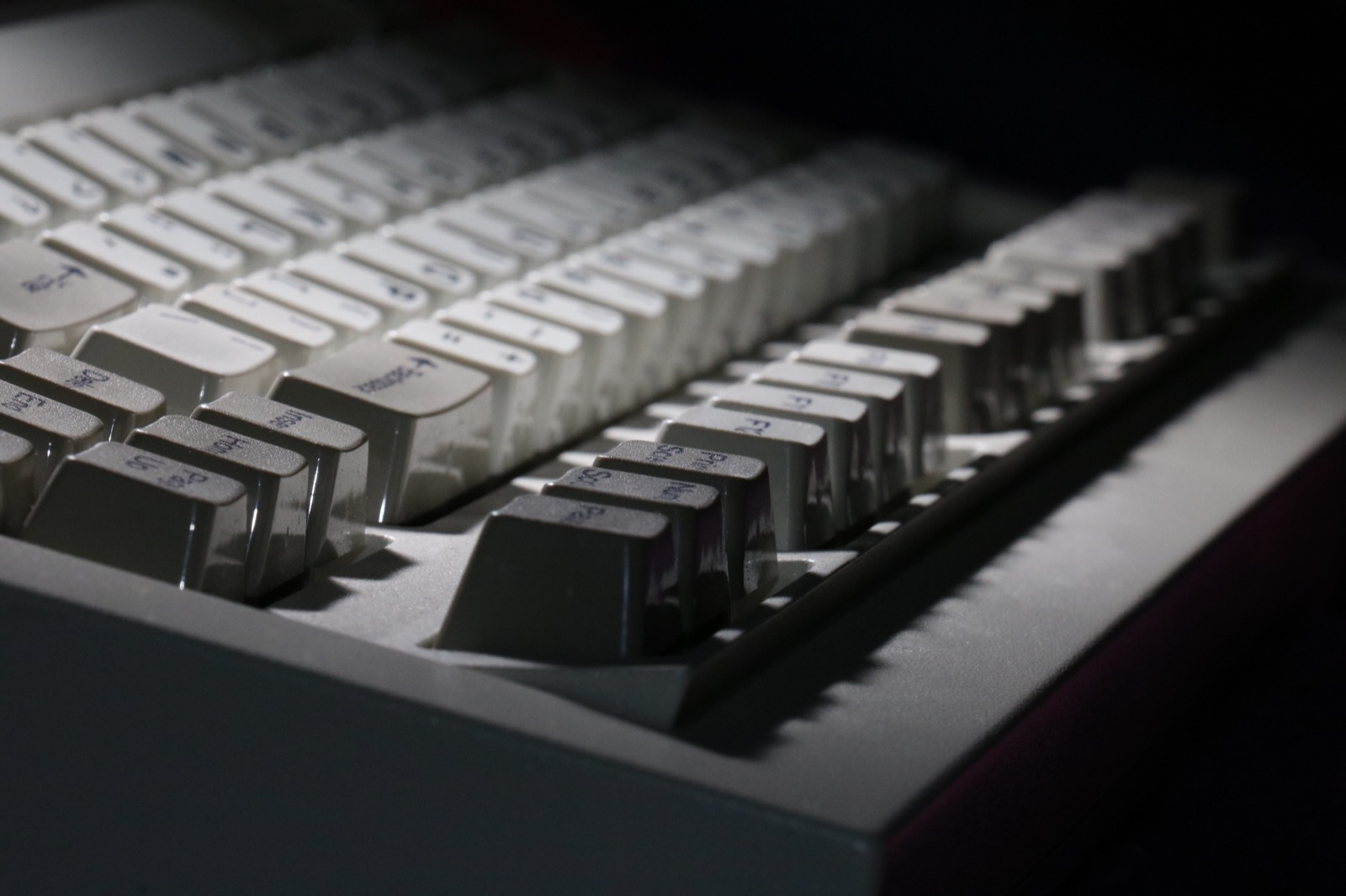

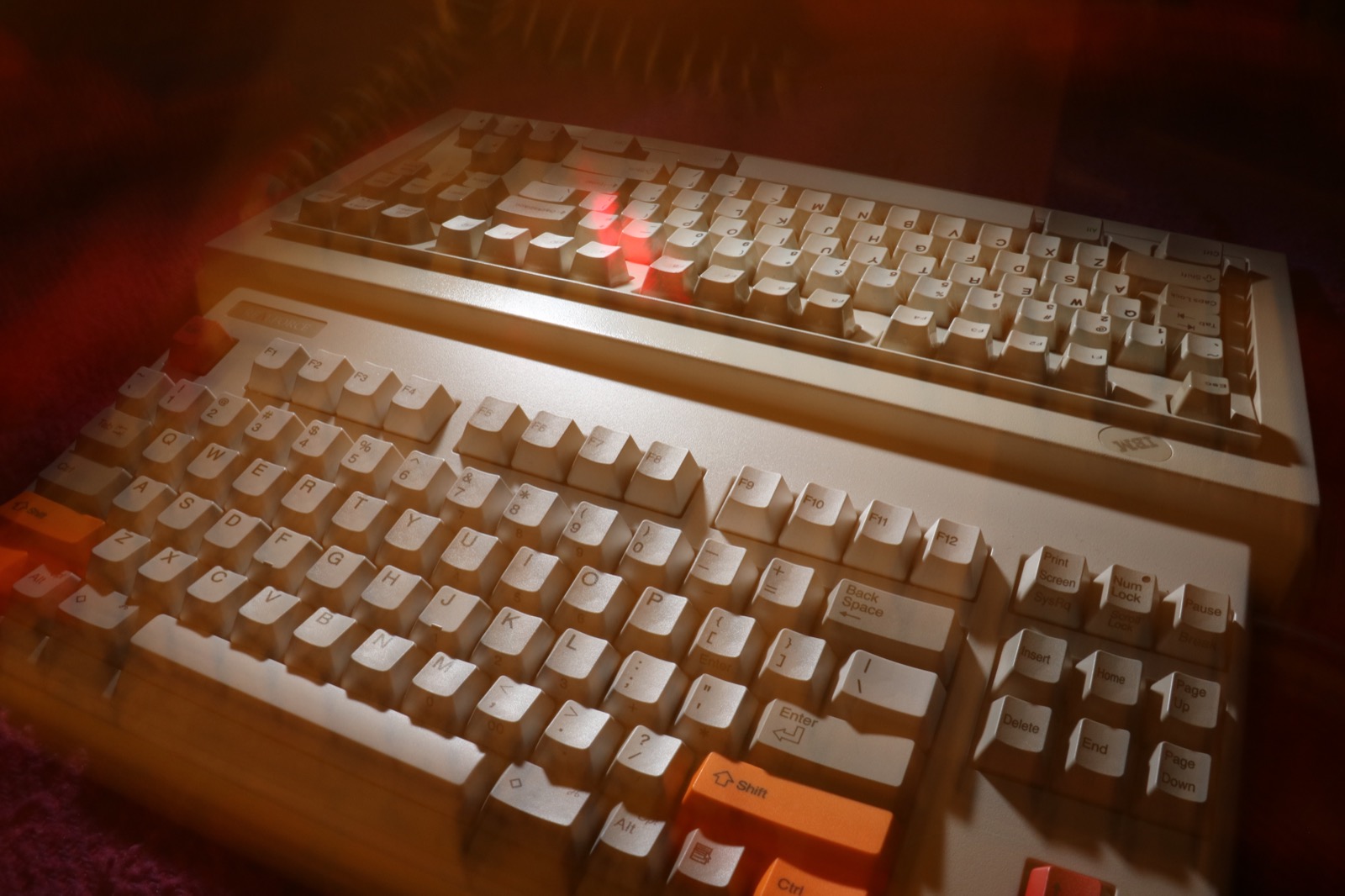

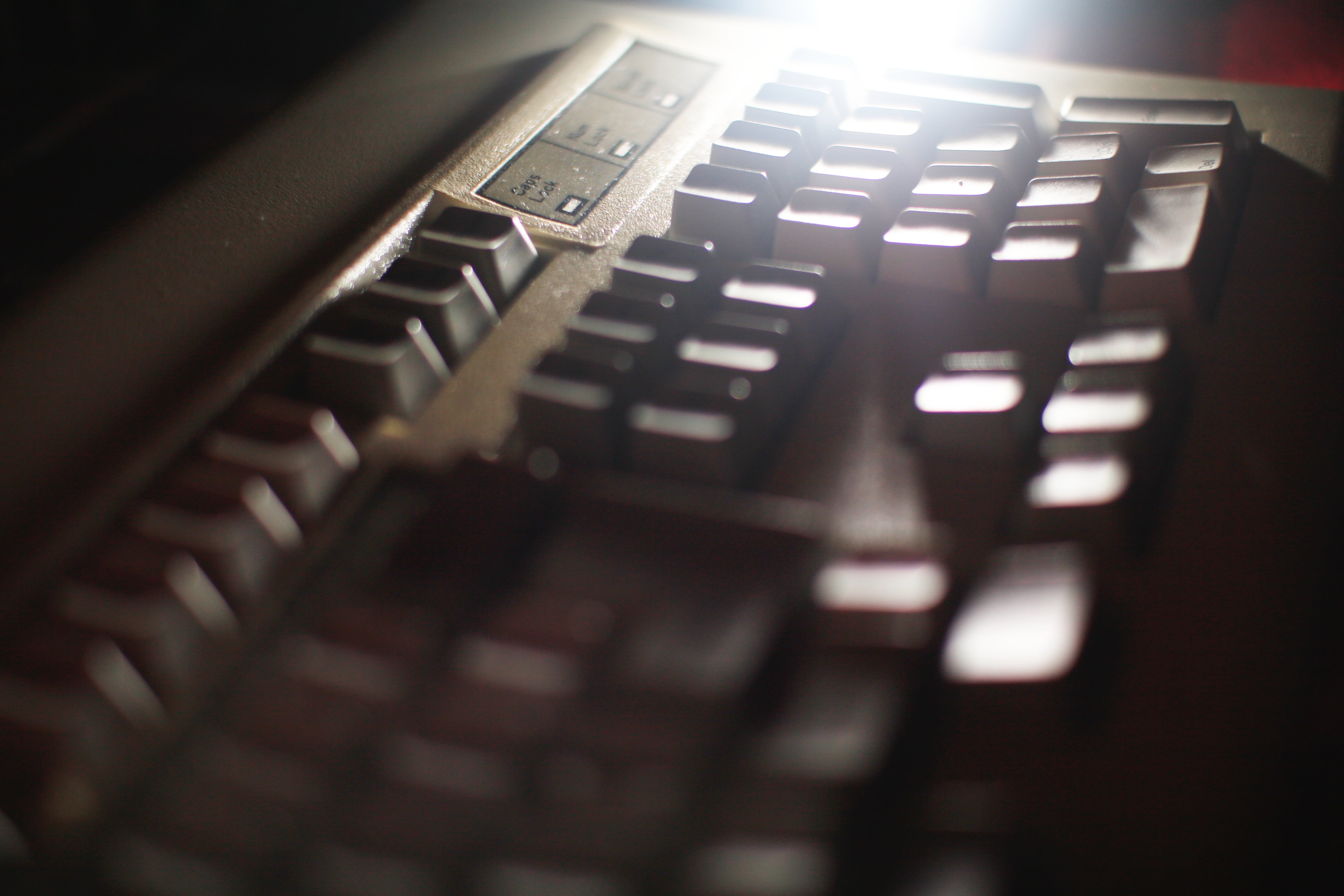

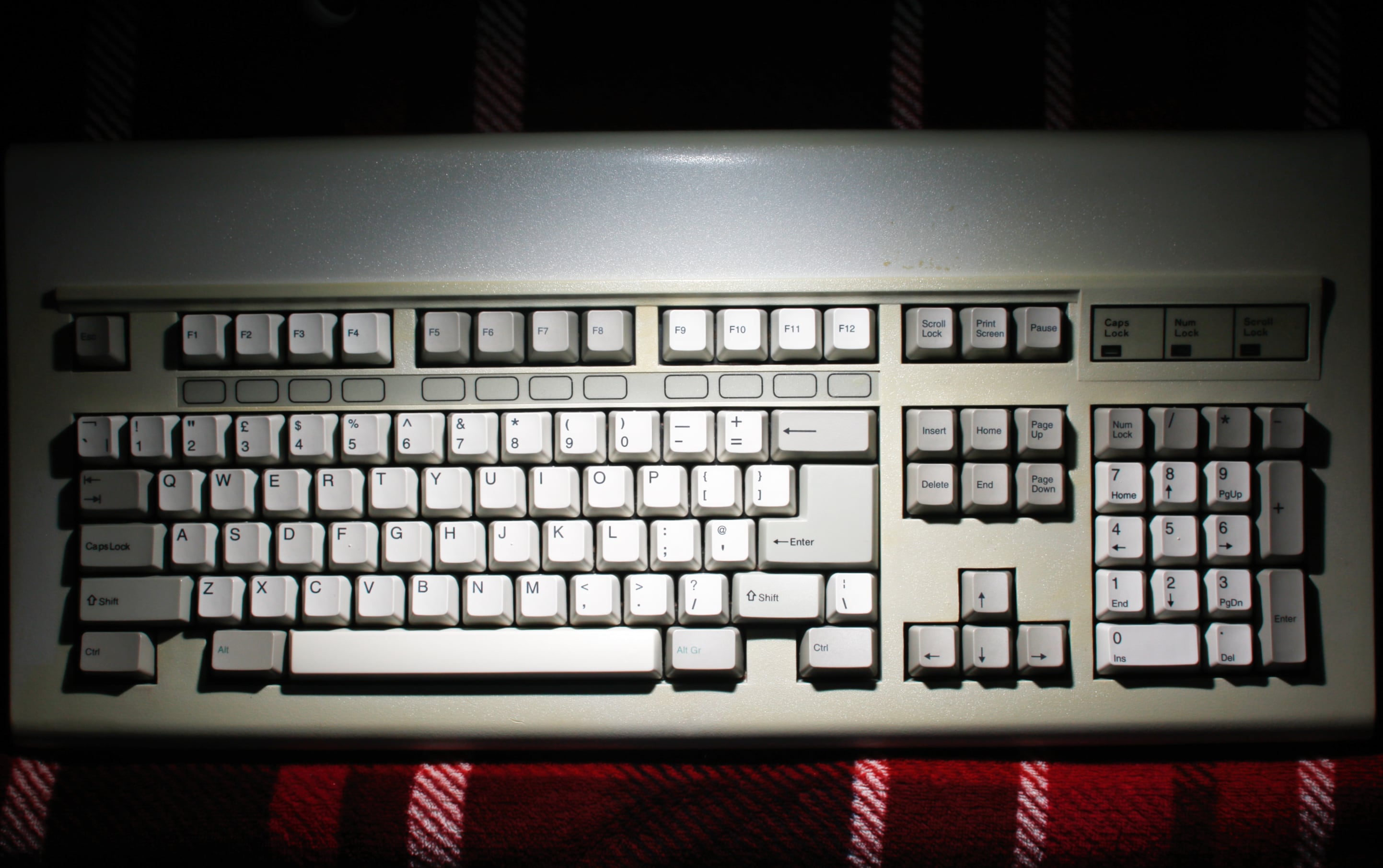

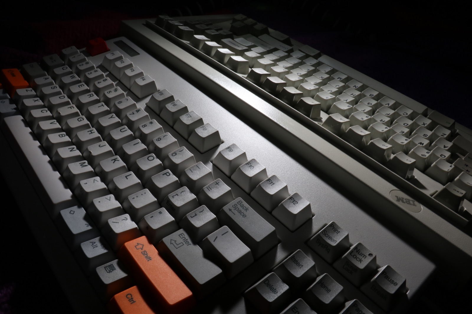

Without further ado, behold my first, very experimental, session with flash lit keyboards.

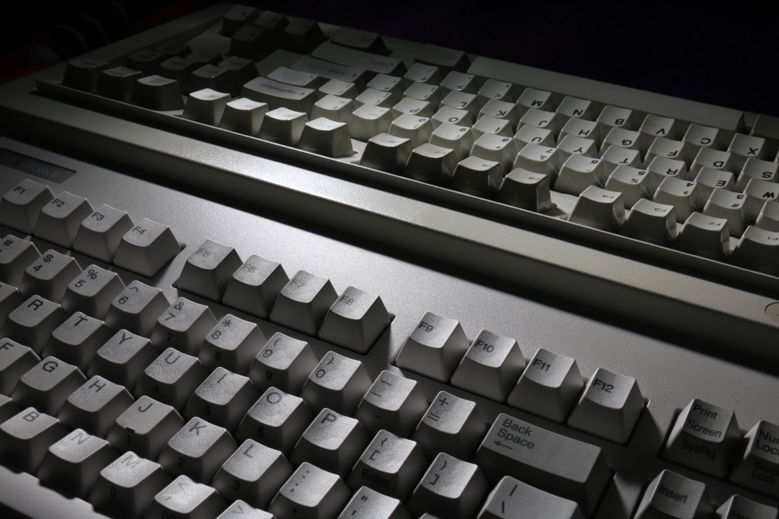

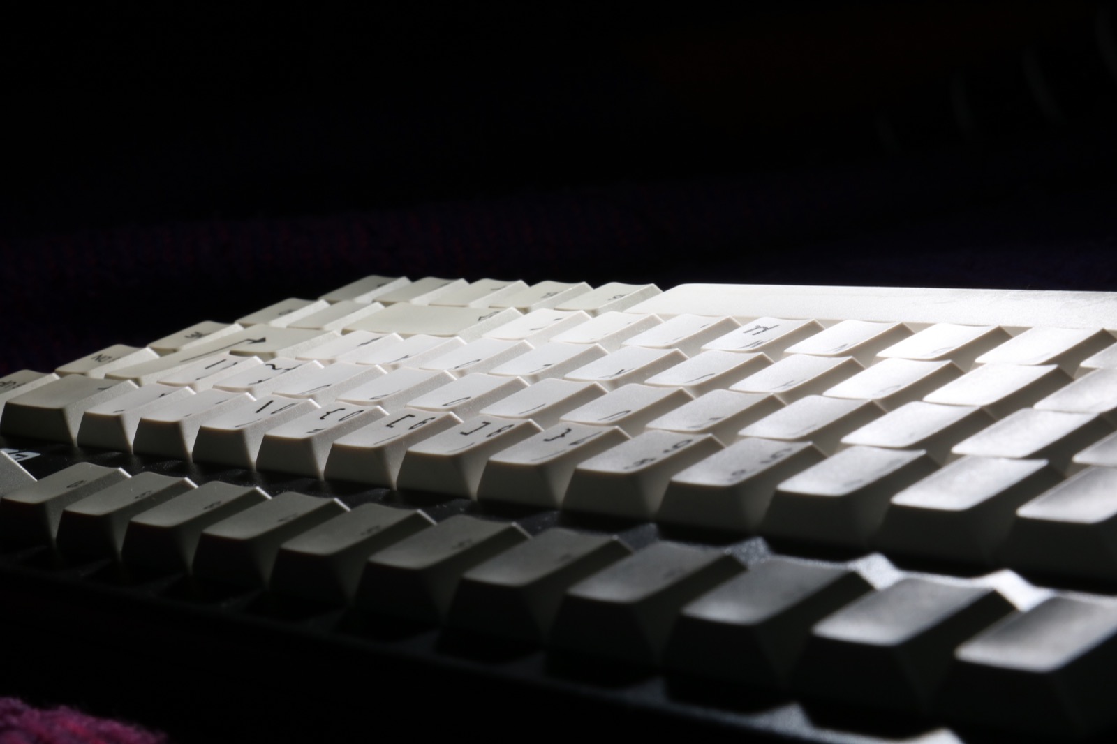

Yes, so I'm just pissing about with super high contrast! This is not what you'd see in a diagram of good strobe technique…
But I do like the extreme shadows it brings about.
The rich dark dyesub XT alphas I have on my SSK here really pop quite nicely in this light.

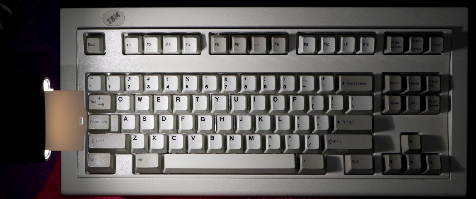

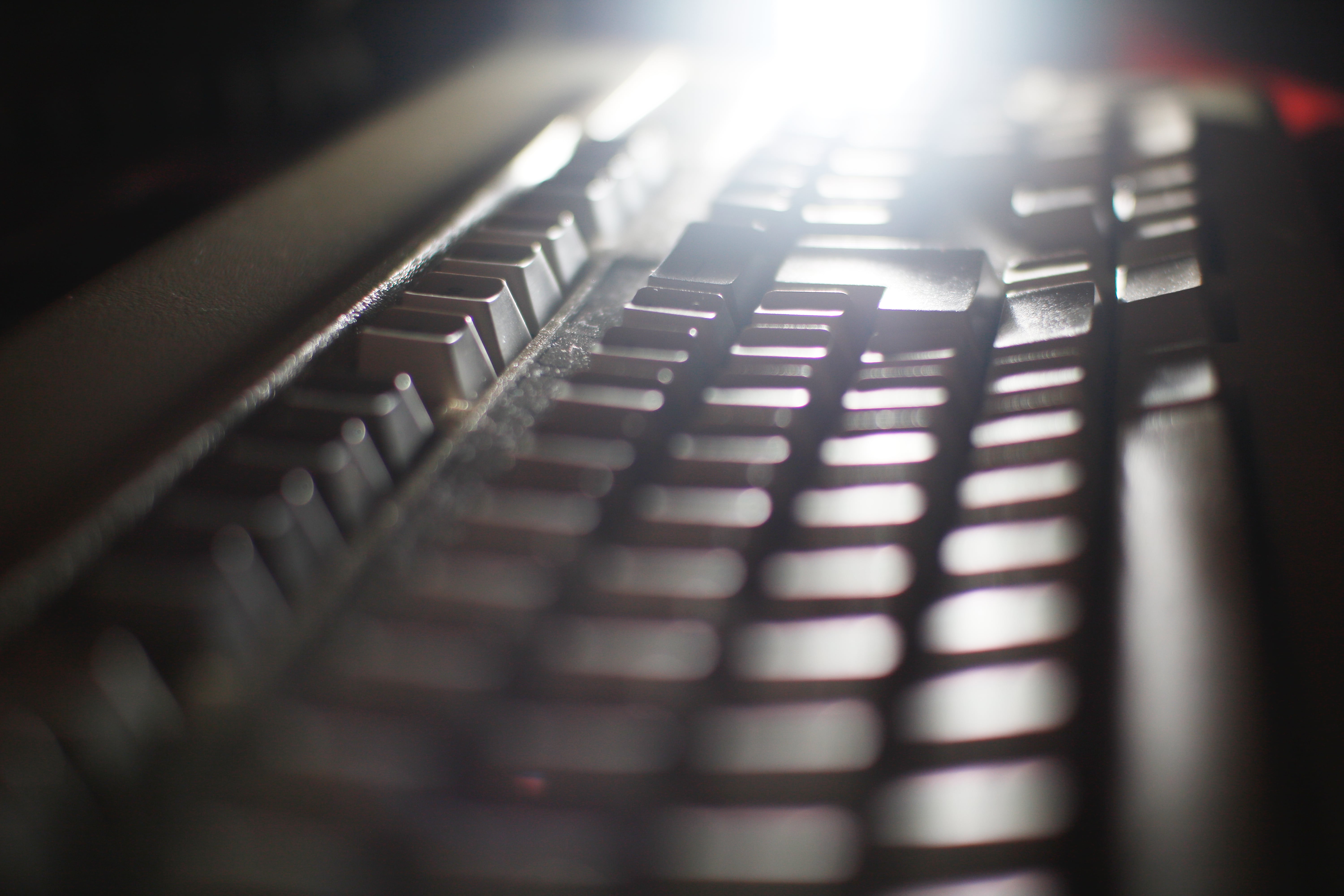

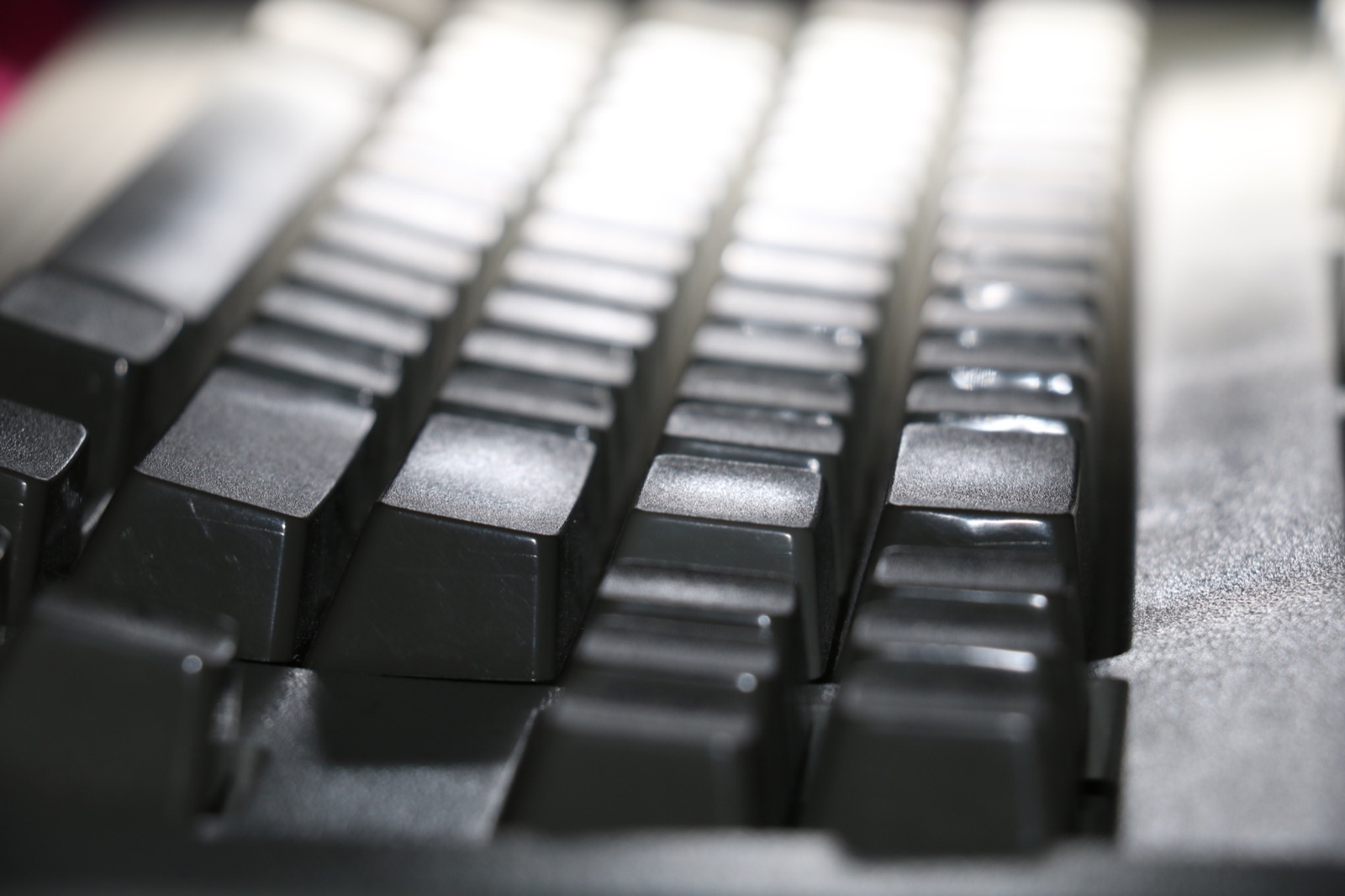

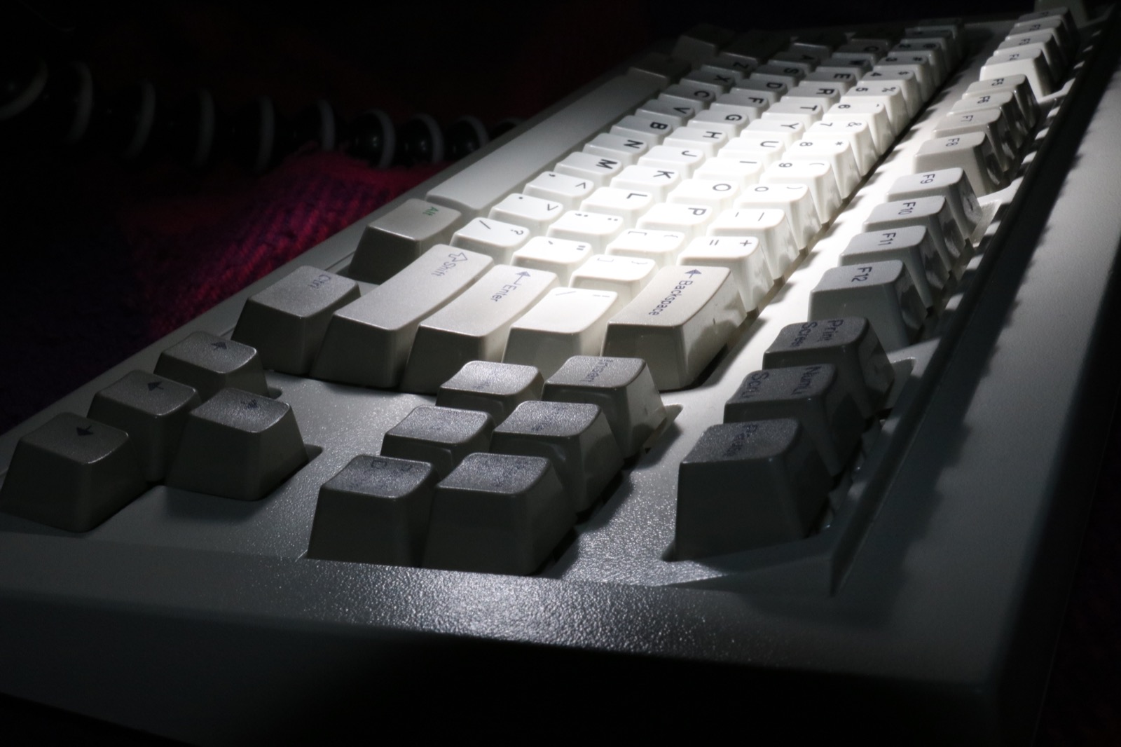

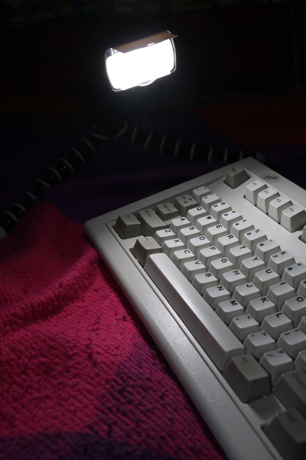

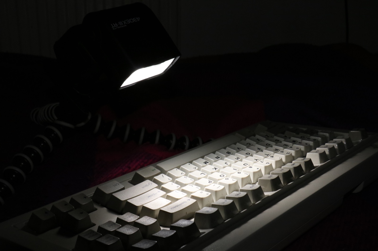

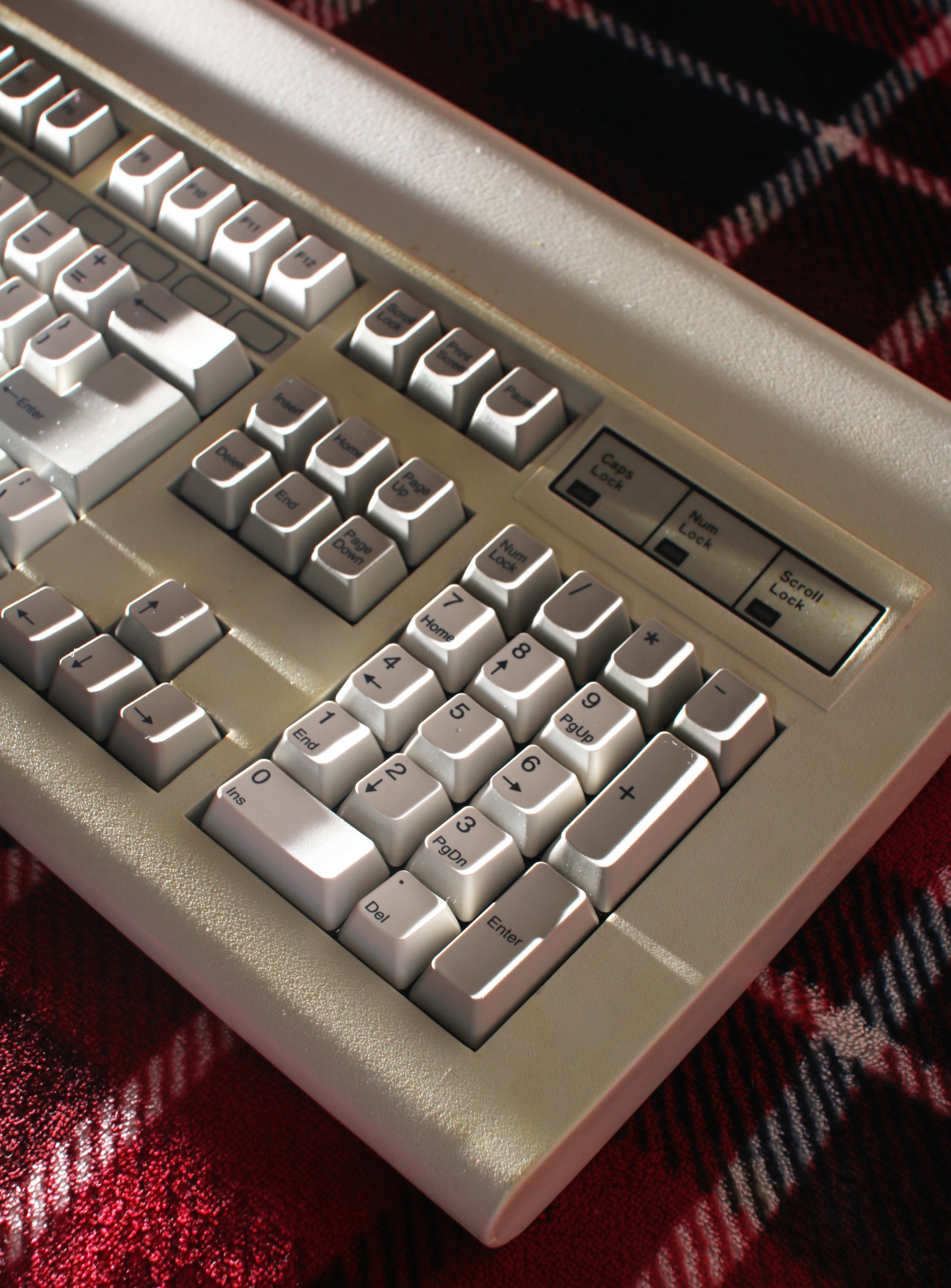

As far as I'm concerned, the key to flash photography is to separate the light source from the camera. I had my 760D's wee flash opened up throughout this session, but merely as a remote control for the real flash gun. The two were linked optically, so the camera could send pulse codes about exposure levels and when to fire, without actually lighting up the pictures itself.
I popped the flash on a GorillaPod so I could position it as I liked. Here it is in a slightly more practical pose, with the scatter card out for a softer light.
Yes, it's a cosy winter blanket. I didn't want to scuff things up working on a hard surface in the dark!

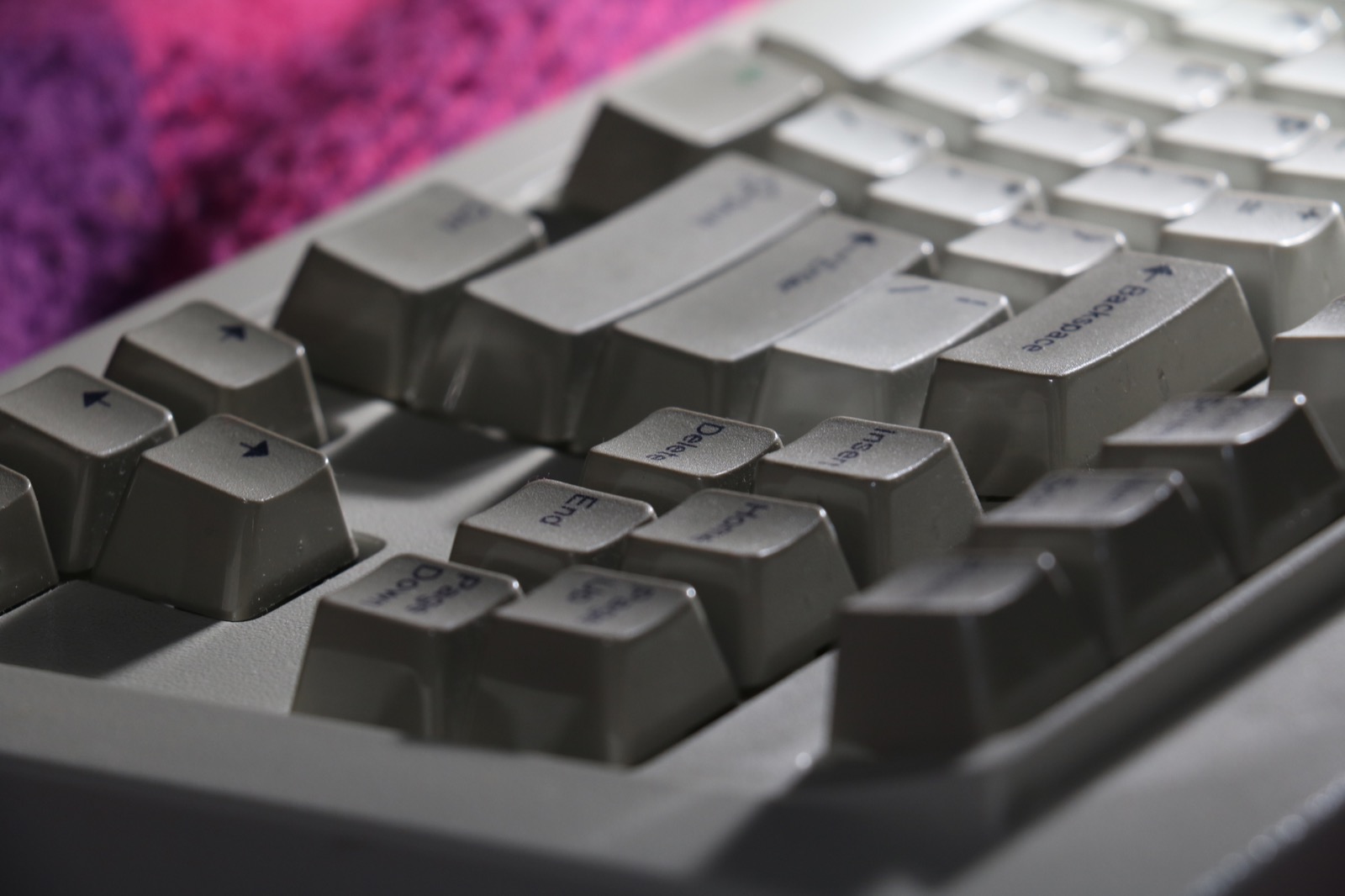

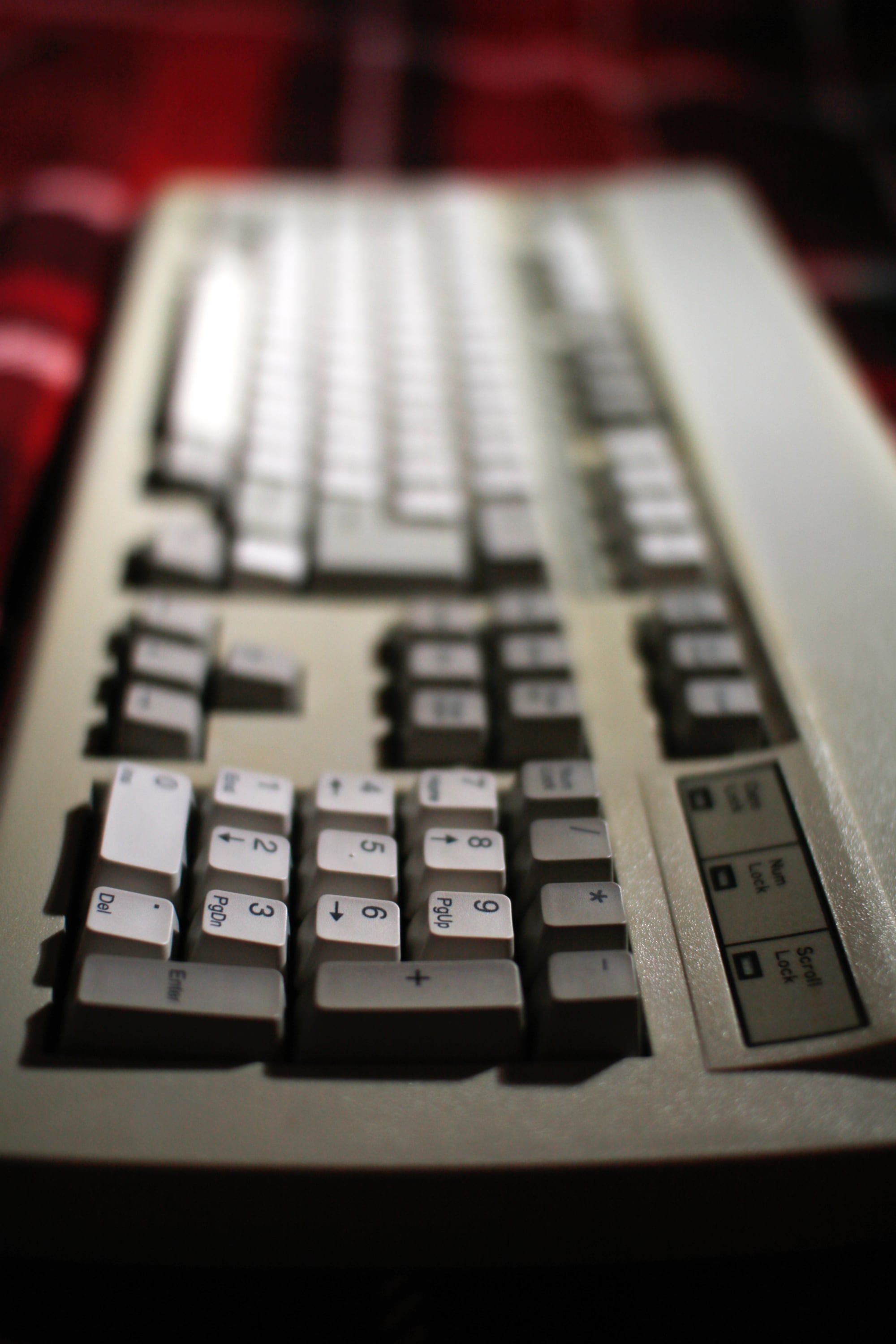

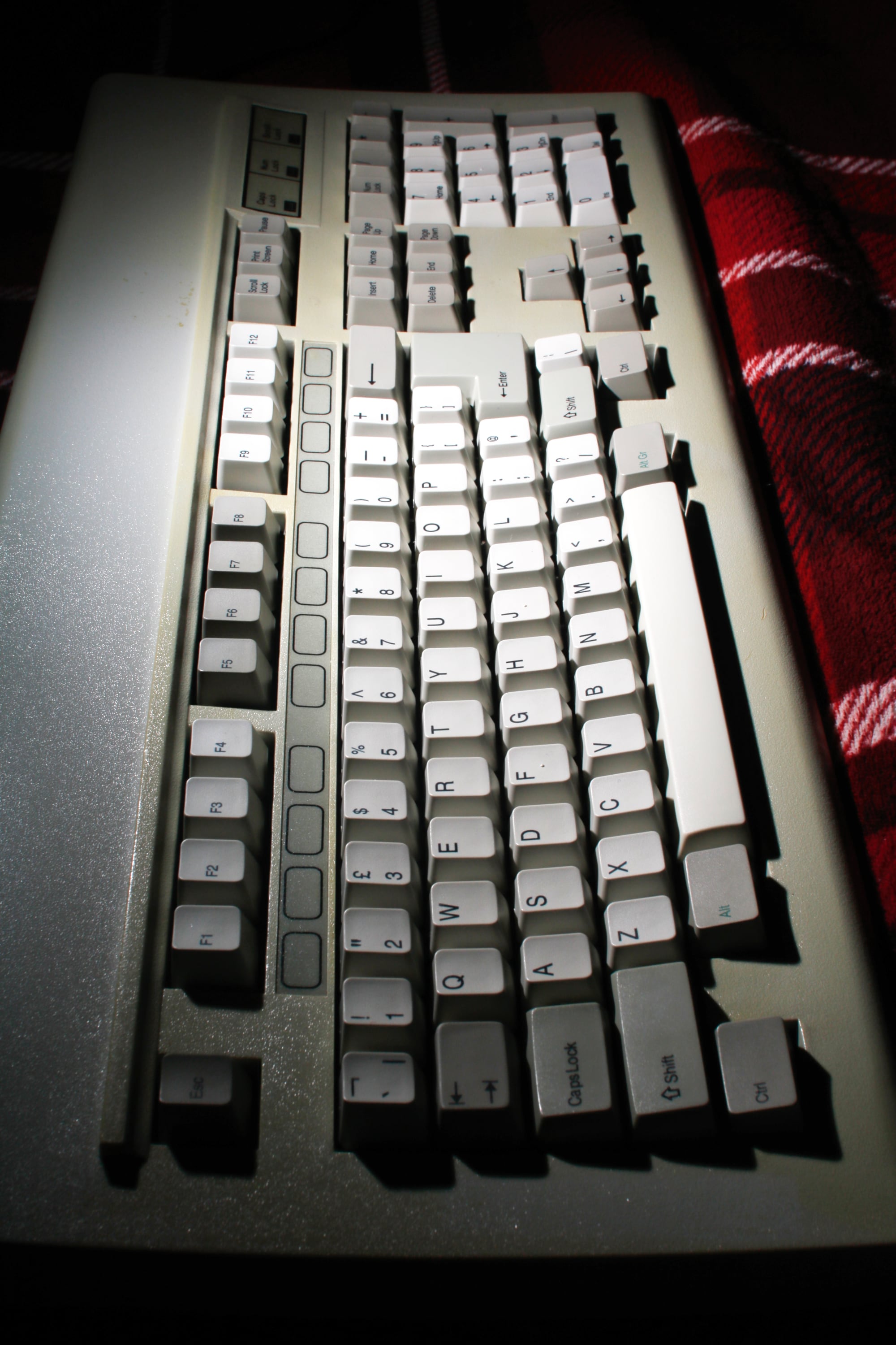

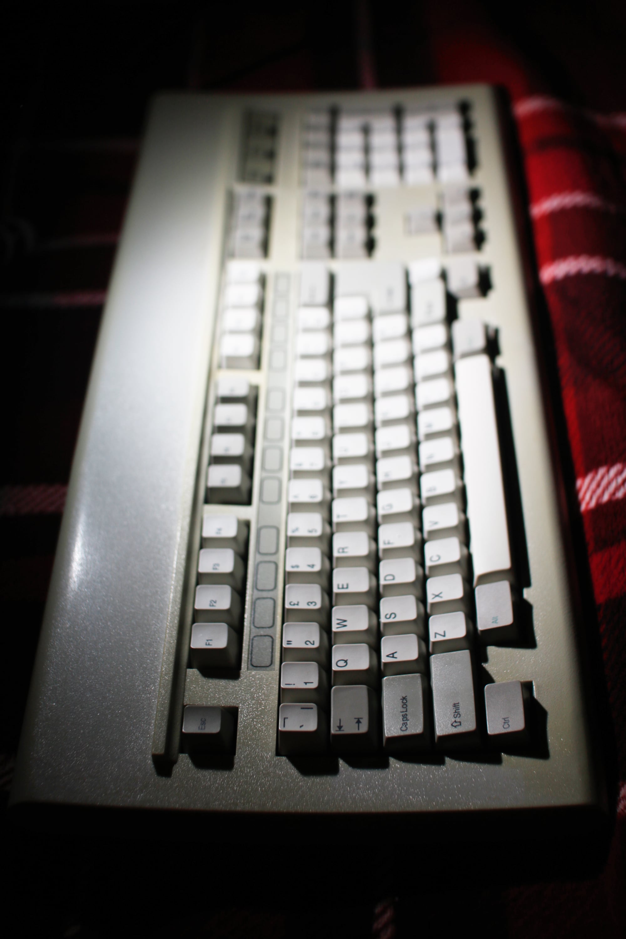

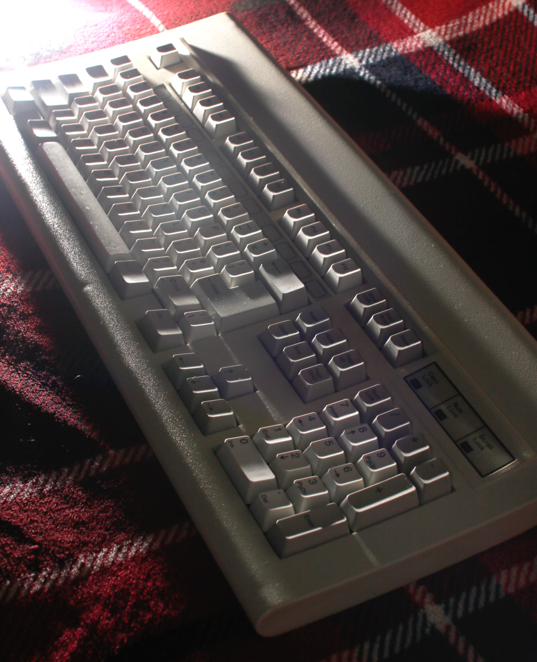

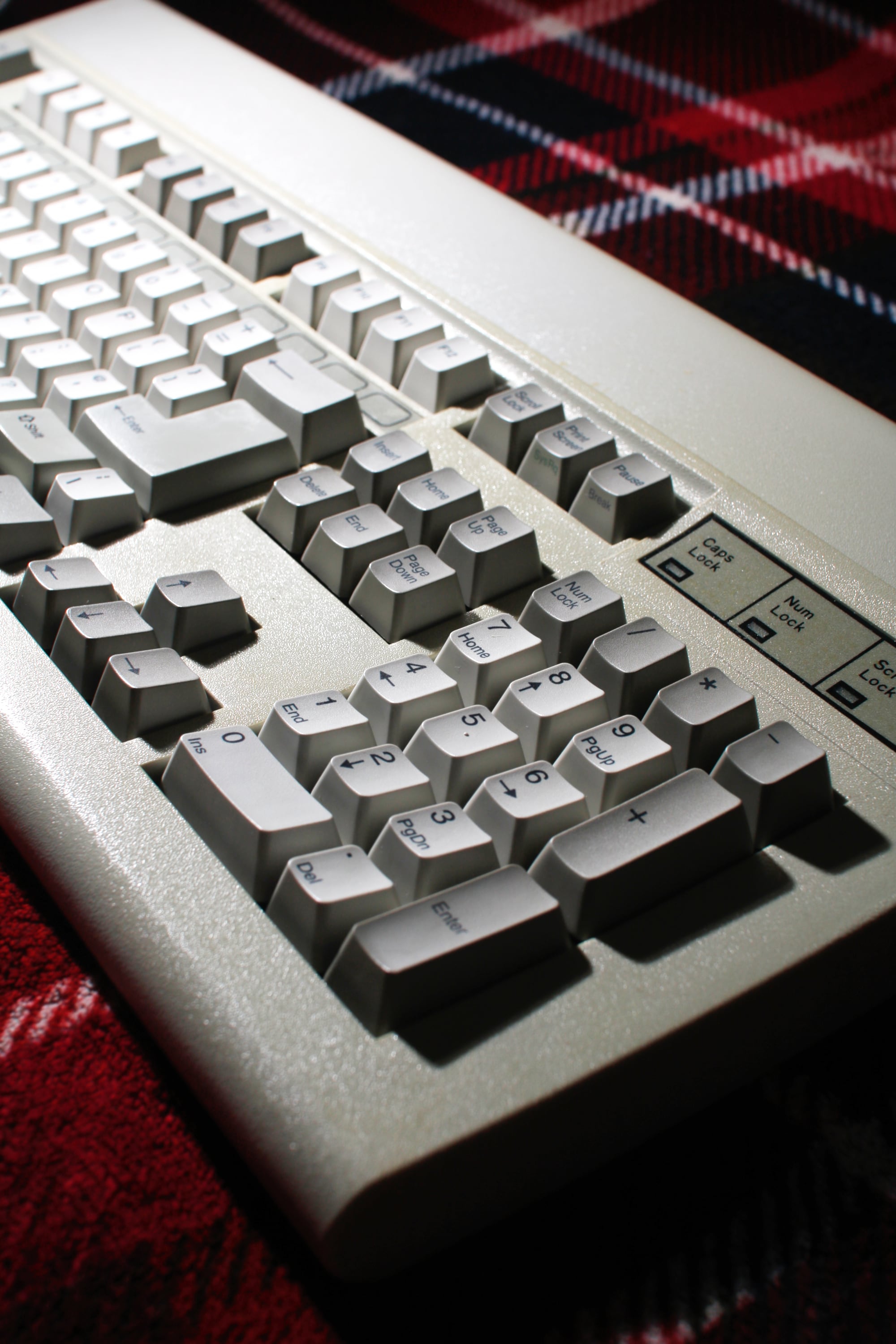

I'd been shooting entirely in Manual for the whole session. This feels like unfamiliar territory for me, as the light meter isn't much good in the dark when I'm composing a shot. But the flash and camera communicate wirelessly, conspiring on the right level of light to match my choice of numbers. This worked surprisingly well, time after time, no matter what damn foolish thing I was up to next with the placement of camera and flash. Impressive!
Eventually I decided to try Aperture Priority and, uh, this is what I got.
The flash fired all right, producing the initial image. But the shutter stayed open for second after second until I gave up and switched the camera off. The result was this trippy 60s impression of the picture I had meant to take.
That's better.

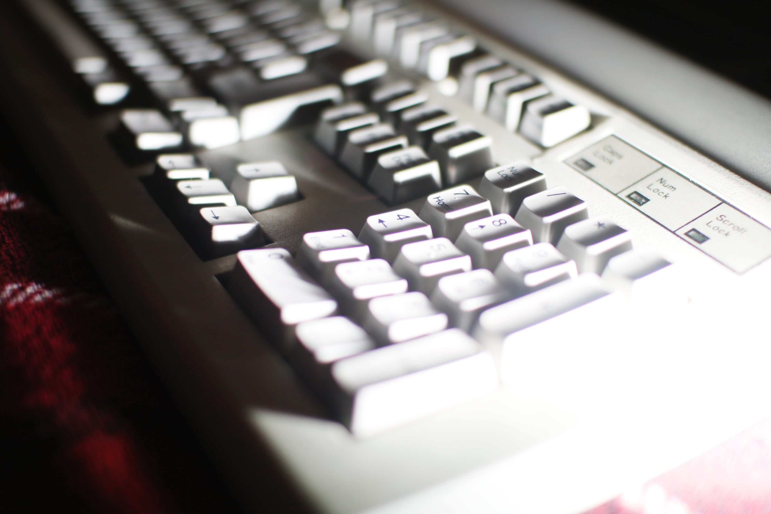

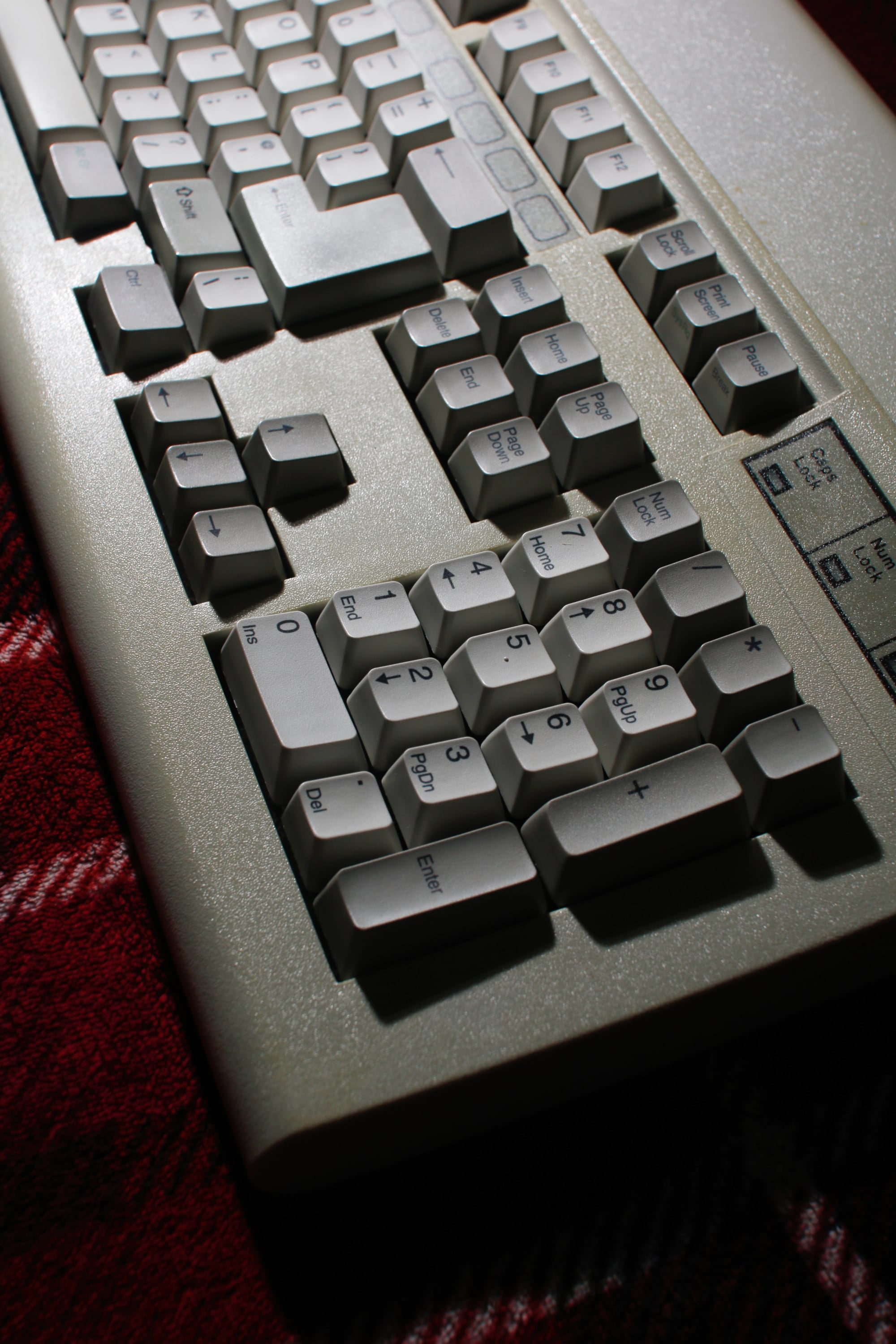

For a first session, I got more pretty pictures out of it than I expected. Sometime soon, perhaps, I'll be shooting sweet stuff like Madhias! Maybe. Whatever I manage, I'll document my progress in this thread. Might as well see some improvement. Fingers crossed.

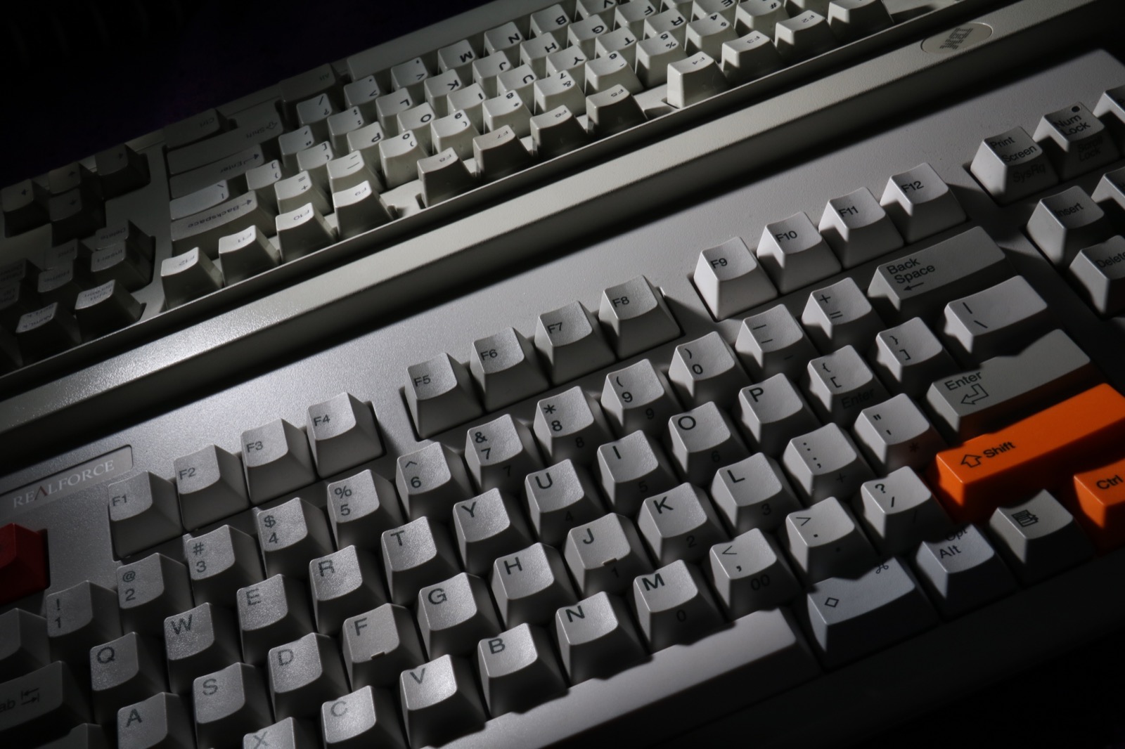

This afternoon's lesson: using flash to fill the shadows at my standing desk.
I doubt the man himself would approve of his new surroundings!
Despite these looking like night time shots, they were in fact taken on a clear summer's day. It's shadowy enough there to push my camera straight up to ISO 6400, which isn't smart. So I went for my flash and played around a lot with angles to get something right.
Once again, I've gone for dramatic shadows. I'm a sucker for them. Keep the flash low, use the built in scatter card, and illuminate from nearby, at around the level of the keys. Choose your aperture for how much blur you're after, and away you go. Bear in mind that the higher the f/number, the more power you'll need from your strobe. That's why the second picture looks more nocturnal than the first. The room's natural lighting shows up better at a wider aperture and dimmer flash.

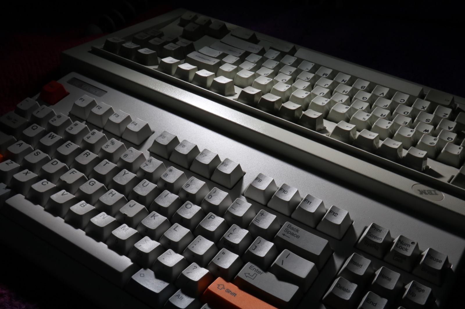

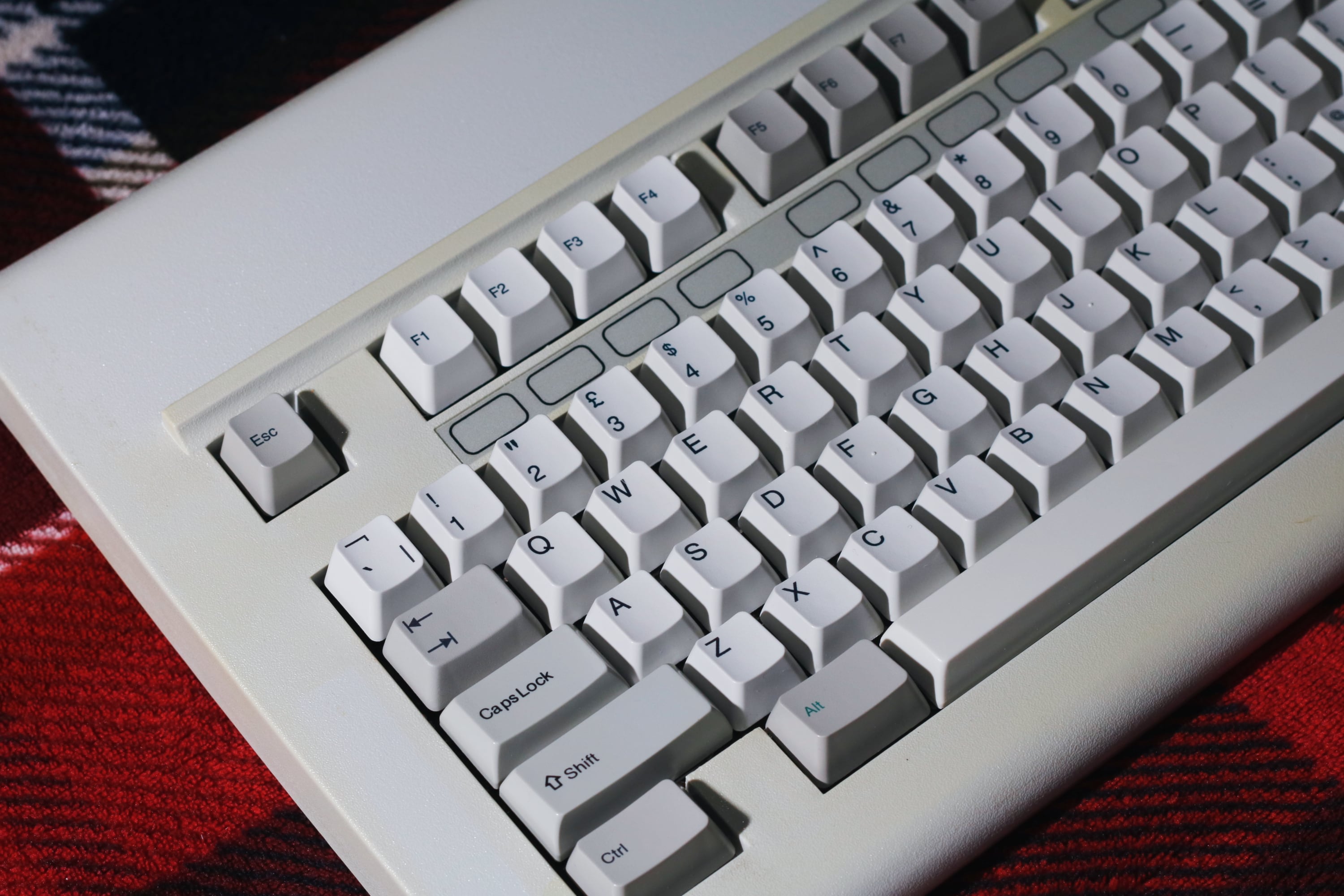

A recent pair of acquisitions—and the long December nights—prompted me to whip the flash out again. What we see here is a Focus FK-555 with blue Alps, natch, wearing the dyesubs from an Alps AT102.
[email protected] (514.75 KiB) Viewed 29035 times
[email protected] (453.12 KiB) Viewed 29035 times
The attentive will spot the telltale that I’m a Mac user, so don't know the true order of certain keys I actually use for volume controls! Fixed since, along with that bit of fluff on the numpad 7 key.

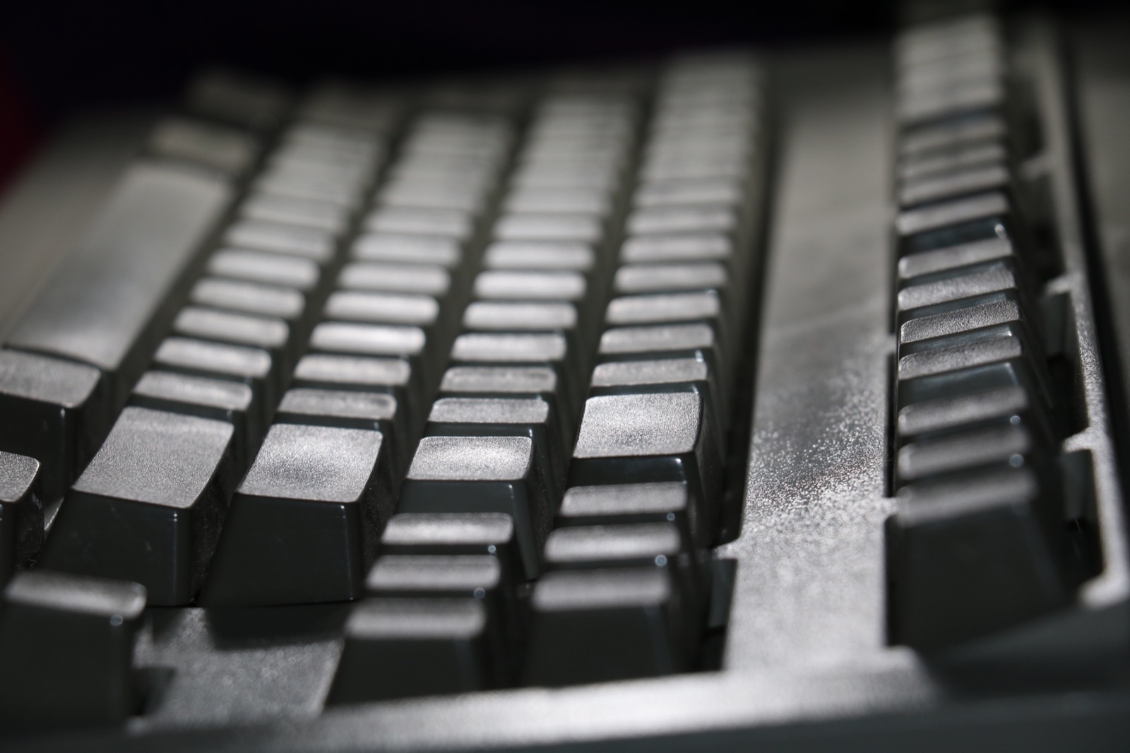

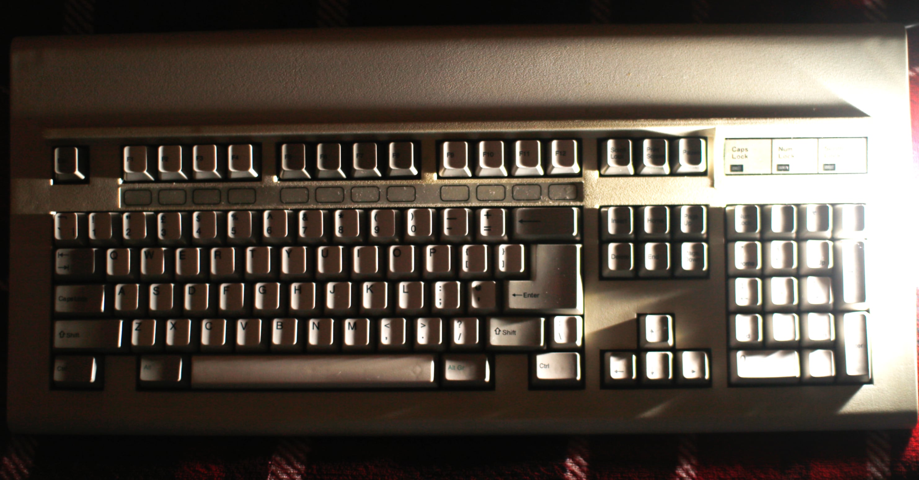

Shooting towards the light, for maximum shadows, and a great big splash of electric fire is quite something. The photos come out real ghostly, with just the jarring white edges lit, especially the keys. To see the keyboard again you need to dial up the curve in levels a bit, which yields all this.
[email protected] (244.51 KiB) Viewed 29035 times

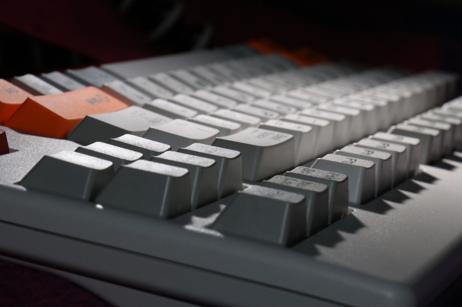

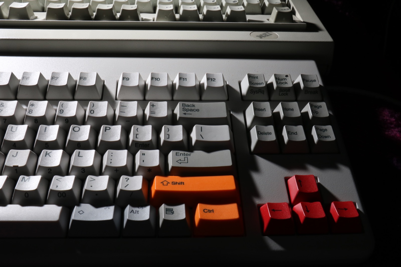

Yes, you can still get bokeh in the dark. Shooting at f/2.8, the flash dials down to match. The shots I did at f/16 however really let it rip! That's (counts on fingers) 5 stops slower, meaning 2^5 = 32× more flash!
[email protected] (477.34 KiB) Viewed 29035 times
Not all caps could come across from ISO to Focus layout. Can you see which are still Focus originals? The spacebar is the same length on both keyboards but the stabs are completely different: this Focus uses Cherry stabs, which I really dig for convenience's sake and are somehow 'done right' so it doesn't feel like a slouch. Some other keys are different sizes, though there's one more which quite surprised me…
