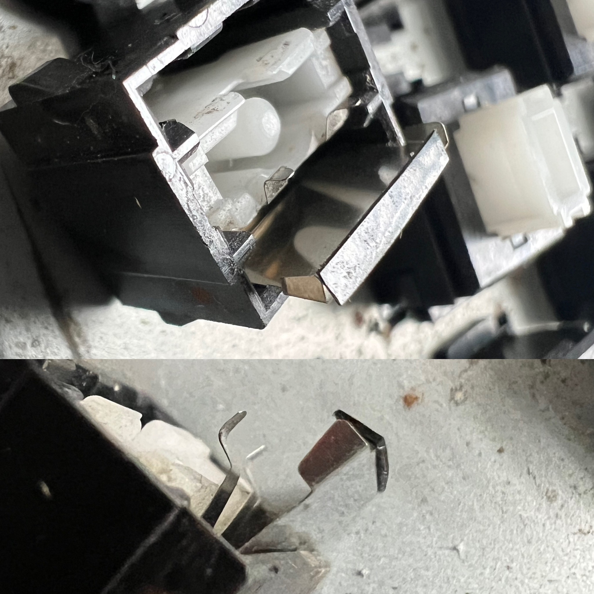

This works great! Bending the bottom is too inconsistent. Bending the ears didn’t work. Paper or tape behind it dampens it to be tactile. Just taping the bottom is perfect!thousandperfume wrote: 23 Sep 2021, 17:26 The upstroke click on clicky alps stems from the bottom tabs of the leaf spring having too much play with the top housing. I used tape to cover ONLY the bottom side of the leaf (as not to silence the click) so that it doesn't move, and I managed to fix it. If it messes up with the sound, try repositioning the tape to have as minimal interference as possible.
