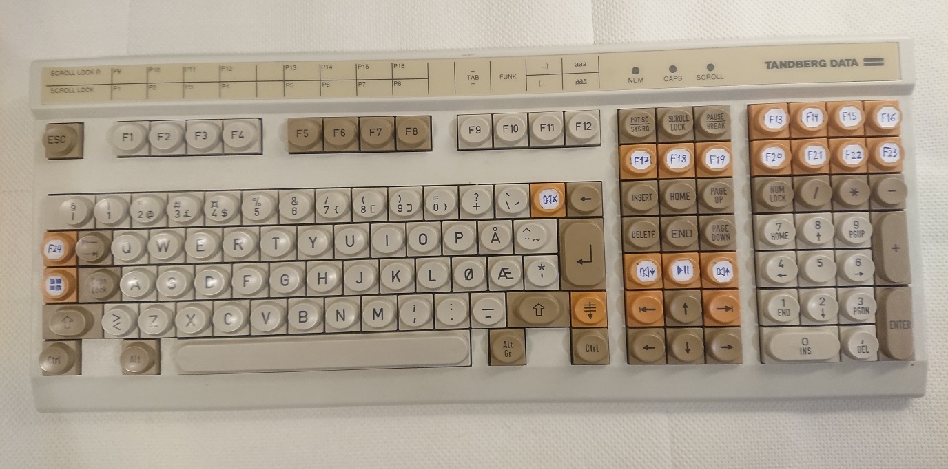

I got my hands on TDV 5000 keyboard (marked TDV 1200 on the PCB-board). It has what looks like regular PS/2 connector on the back. I tried to connect it to PS/2 port on my PC using brand new DELTACO Switchcabel PS/2 DEL-45A - but got no lights or any response on key presses.
Didnt do any other testes when connected - but I did take it apart just to do a visual inspection. Tried to take pictures of any points of interest I could spot:
https://www.dropbox.com/sh/teajwebsbuq5 ... M--ua?dl=0
I have no experience with older keyboard like this, but I do have some very basic understanding of electronics. I also have multimeter, soldering tools and 100mhz oscilloscope.
I would love to get this keyboard up and running - as all switches seems to be in great condition also all double shot keycaps are nearly mint condition.
Would greatly appreciate any help, advice or just ideas of what to try and what to do next :)

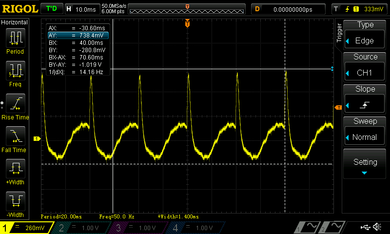

Thank you! My experience with oscilloscope is very limited, so Im not sure if I did it correctly :? but here are my results:

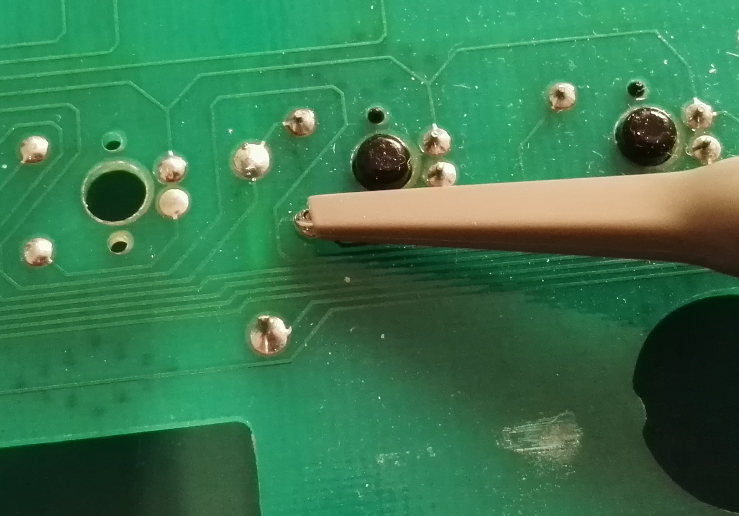

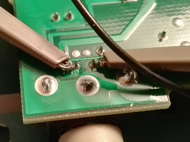

First I connected to a switch on the board it self:
Screen Shot 2016-03-01 at 08.35.40.png (636.48 KiB) Viewed 11367 times
and got this reading:

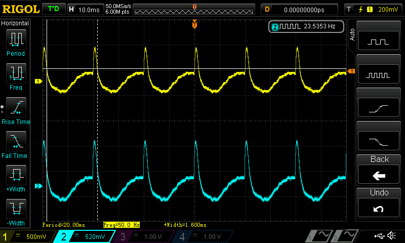

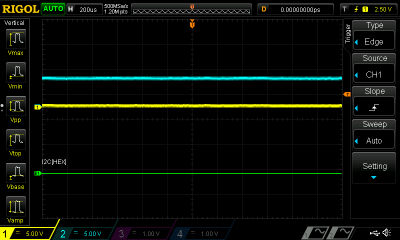

After that I connected to two points and tried to press a key:
Then I connected to PS/2 lines while it was connected to PC:
Screen Shot 2016-03-01 at 08.37.24.png (783.17 KiB) Viewed 11367 times
Here I cound't see or trigger and decode anything:
Not sure if my setup was incorrect or trigger was to high/low - it was getting pretty late so I called it a day :| .
I kinda hope my setup was wrong and that there is data - at the same time - I never was able to see any reaction to keypresses on PS/2 lines no matter what I did.

Good to see that the controller is alive and scanning. So it's still possible that it is also fine otherwise and it is the socket, the cable or the PC side which is at fault. Resistors pull the clock and data lines up to 5V so you can signal the lines simply by shorting them to ground - first the clock line, then the data line, then release clock and you should see a series of pulses on the clock line. If this doesn't work check the continuity of the traces between the ps/2 socket and the controller pins. If you really can't trigger that reply, the controller must be broken and you need to replace it.
The fact that key presses don't trigger a clock burst is not indicative, because the controller might expect an initialization command from the PC before it starts sending anything.

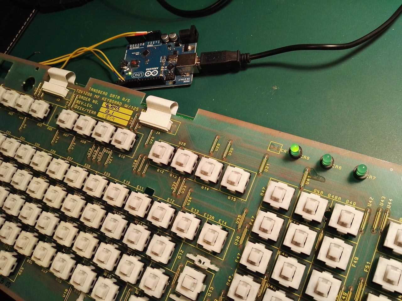

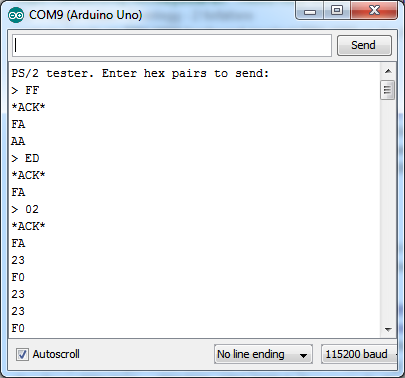

After some googling I got to this article:
http://codeandlife.com/2013/07/15/ardui ... rd-tester/

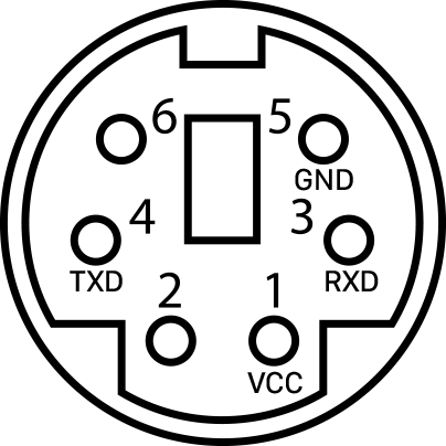

It is about using Arduino as PS/2 keyboard tester. So I connected it as per PS/2 port specification - but got ones again nothing. After some testing with multimeter I got an idea that maybe it is not PS/2 port after all - maybe it just looks like one. So I scanned all pins on connector, to the board and traced them back to CPU. Then I created this diagram:
Compared to regular PS/2 port - all pins are swapped around.
So now with better understanding of the port on the keyboard, I connected it up to Arduino ones again and got this very promising session:
To say that Im incredibly happy to get this far is an understatement :D

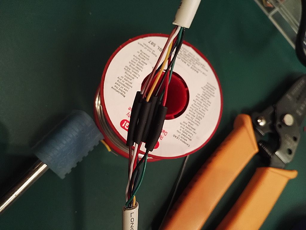

I ended up making a new PS/2 cable and connecting it directly to PC:

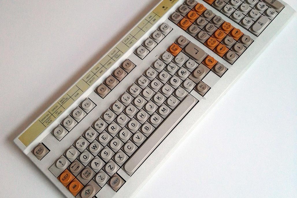

And this is how my desk looks with keyboard:
I can't use extra keys, but will try my luck with Microsoft Keyboard Layout Creator...
I found a book about NOTIS-WP and now kinda understand what all the extra keys supposed to do - for the most part there is a modern shortcuts - at least for use in texteditors / webbrowsers. I will post it here as soon as I get time to translate it from norwegian to english
