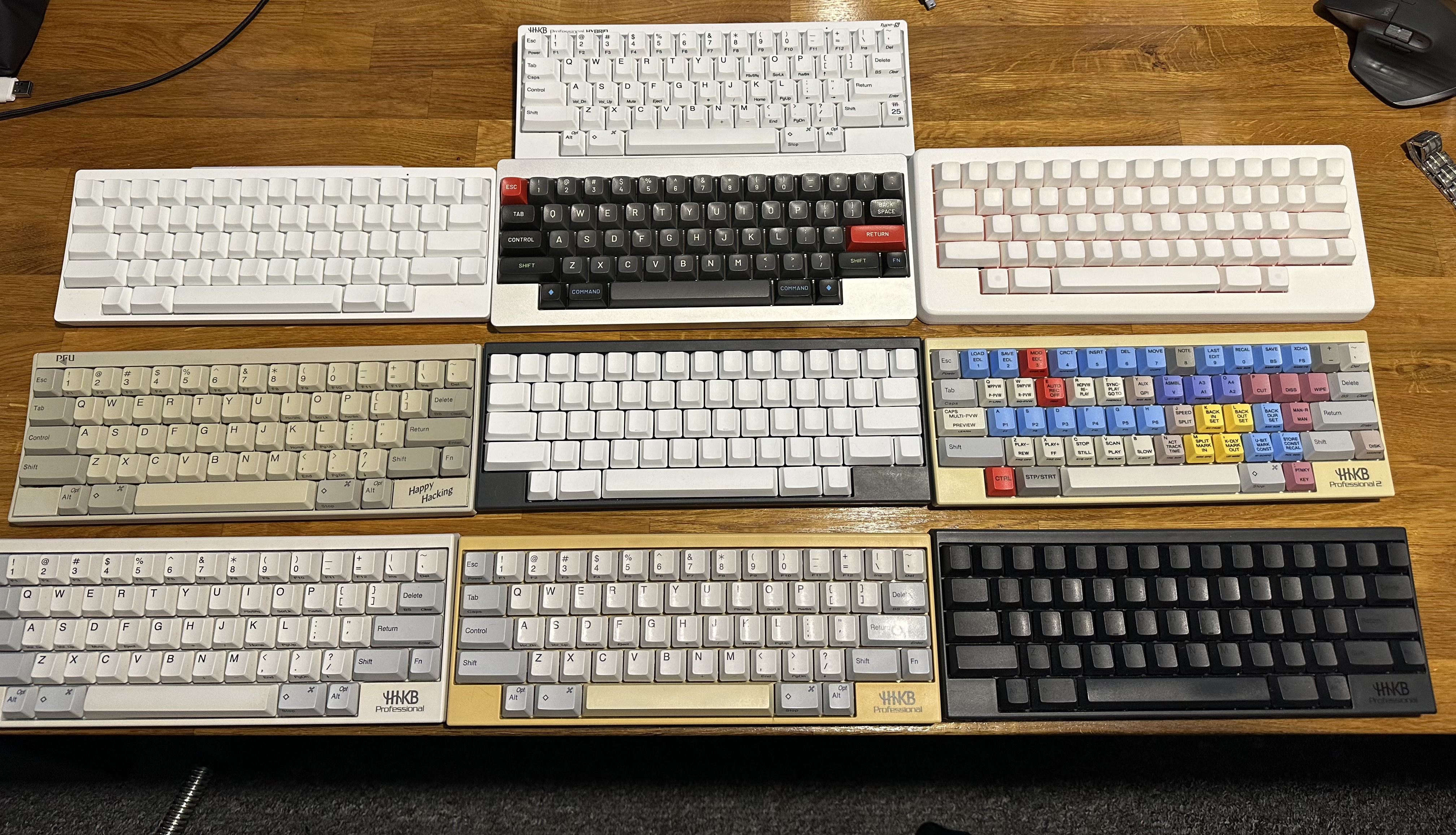

wobbled
10 Feb 2023, 17:42
Muirium wrote: 10 Feb 2023, 09:29 It’s too early in the day to summon the fury and dismay my actual reaction to those Christ awful legends, which are yet another step entirely in the wrong direction for the HHKB. Maybe I should just hoard the good ones while they’re still out there, like Wobbled? :lol:
I am however in favour of MX topped sliders, and even—sacrilege alert!—a 6.25u spacebar for the HHKB. I’d love more freedom in caps for it, if they’re really hell bent on ruining the gold standard they’ve always had, right out the box.
Surely it’s only hoarding when they no longer fit on your desk? As it happens, I am safe at the moment.
JCMax
10 Feb 2023, 22:06
That collection is BAD ASS!!!
