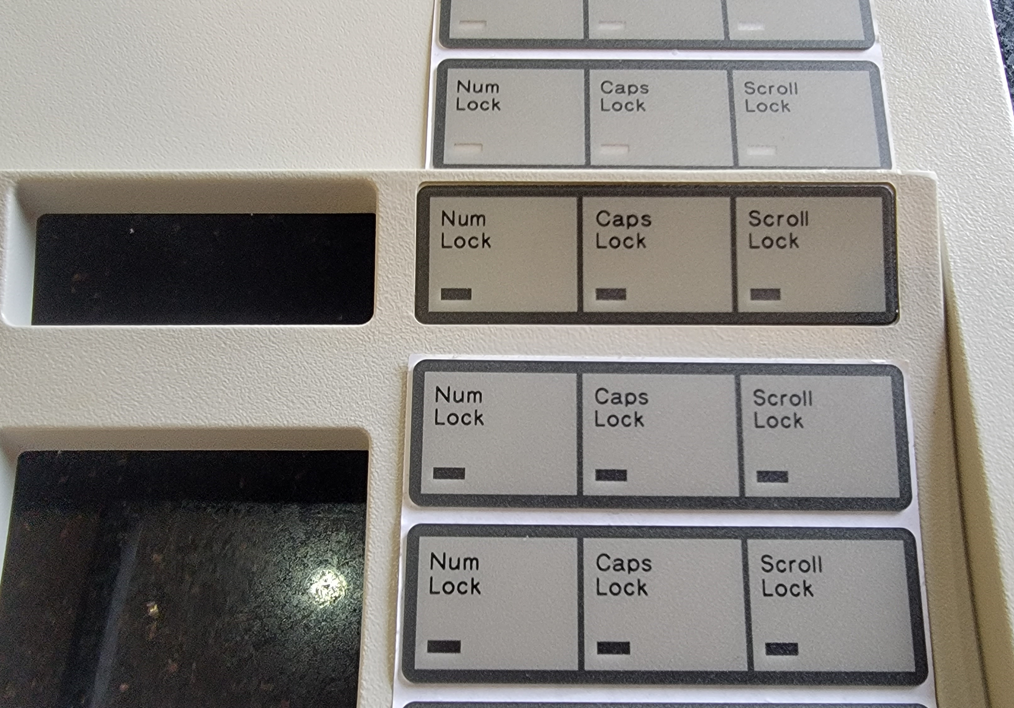

I have just approved production on the LED overlays. Even this not-too-complex part was difficult to source and took about 9 months to find a supplier that can meet the requirements. The texture of the plastic material was most challenging. Now the Round 1 beam spring boards can start going out. The samples look good, though I noted that the factory needs to adjust the color balance before proceeding (or maybe it is just the lighting angle). (The one installed on the IBM Model M case is the original one for comparison)
- webwit
- Wild Duck
- Location: The Netherlands
- Main keyboard: Model F62
- DT Pro Member: 0000
Your ll kerning is better!

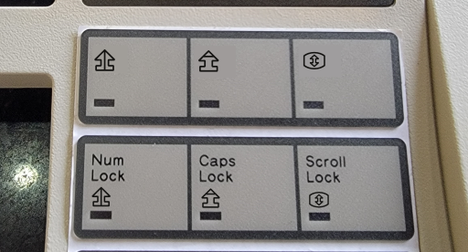

Really interesting project, this overlay.
I'll just add my comments here as well. Maybe a version using the standardized pictograms (iso 9995-7) could be interesting (I had good comments about my layout, thanks guys
). It's just a proposition.
Personally, I like the second proposition (bottom, English + iso 9995-7). I could be interested in the future.
- iso9995-7-overlay.png (229.47 KiB) Viewed 14914 times
Ellipse
webwit - as always we have Zed to thank for the excellent results on all of the key sets and LED overlays.
If anyone is interested in any additional designs enough to cover the minimum order quantity costs please email / PM me within the next week or so as things become finalized. I have seen some nice suggestions today from AlexB555 as well as from others in the past. I have to double check whether the minimum order quantity is 10 or 20 for each design with the standard pricing in the shop.

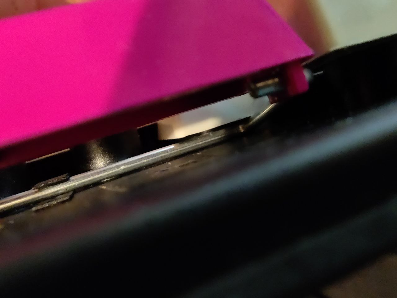

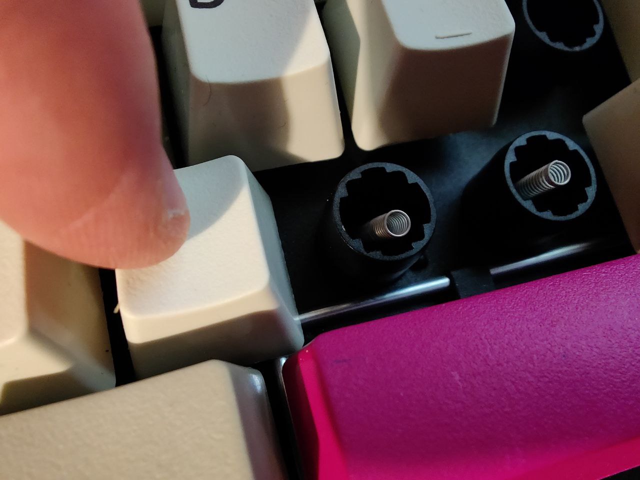

Does anyone happen to know why spacebar wire keeps hitting some of my keys such as X and : on Model F62? I can't seem to figure this out at all. Wire is placed correctly inside of those metal clips as well. This doesn't happen on my IBM M SSK when I swap them. Spacebar is original but I have dyed it fyi. Happens on original IBM M SSK spacebar as well when being used on Model F62. I tried IBM M SSK wire but the issue is still there. I'd love to hear if other people have this very same issue so I can fix this somehow.

Shinryuu wrote: 09 Mar 2023, 15:02 Does anyone happen to know why spacebar wire keeps hitting some of my keys such as X and : on Model F62? I can't seem to figure this out at all. Wire is placed correctly inside of those metal clips as well. This doesn't happen on my IBM M SSK when I swap them. Spacebar is original but I have dyed it fyi. Happens on original IBM M SSK spacebar as well when being used on Model F62. I tried IBM M SSK wire but the issue is still there. I'd love to hear if other people have this very same issue so I can fix this somehow.

How's your space bar conflict nowadays? I can't seem to figure this out at all. I also did try to add some stuff inside of those metal holders but it prevented wire from moving correctly.Scarpia wrote: 02 Nov 2022, 19:03 I got my F77 in July 2020 so it’s been a little over two years; since I’m sharing an office I don’t always use my loudest keyboard but I’ve probably used it about a third of the time.

Thanks for the reply. I'll try to debug this somehow.

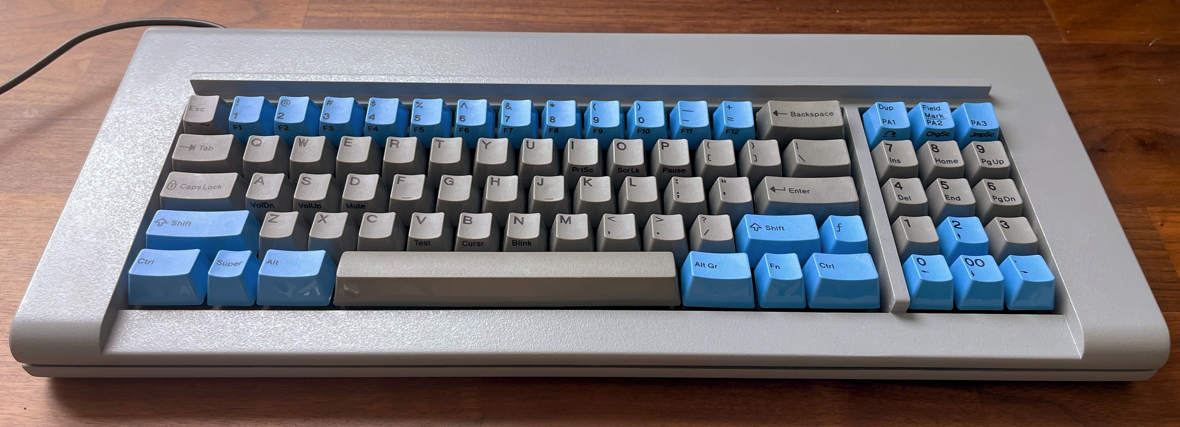

Here is a nice F77 Silver Gray case color with blue and dark gray custom keycaps. Sharing with permission.

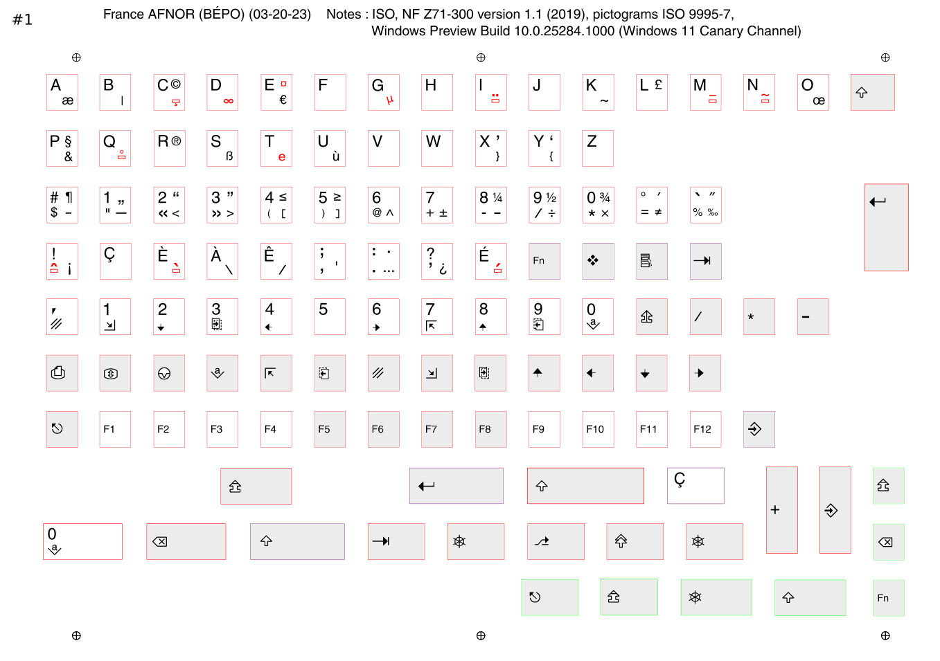

The forum member behind the new Quebec CSA has just submitted a new key set, option, French AFNOR (BÉPO), and has comments below. I have sent the design to the factory, to be included in an air shipment going out this month or next month. I am ordering a few extra sets in case anyone is interested. The gray shading indicates that the keys will be pebble color while the rest will be pearl.
"This layout was developed in the early 2000s and standardized by the French government in 2019. Contrary to the traditional French AZERTY layout, the French BÉPO seems more appreciated in Quebec/Canada. Microsoft seems to offer this "new" French layout in their preview build since November 2022, I expect to see this layout included in the next stable version soon. I need to install the correct preview build on my computer and test it. I will let you know when it's ready. This layout is more "classical", doesn't have a proper gr2 key (ctrl-right), just a second boat wheel (right) and the Christmas tree (Alt Gr) will be blue. This layout is ISO only."
https://kbdlayout.info/kbdfrnb/overview%2Bscancodes
The µ on the G key is turned to the left. Normal?Ellipse wrote: 21 Mar 2023, 04:19 The forum member behind the new Quebec CSA has just submitted a new key set, option, French AFNOR (BÉPO), and has comments below. I have sent the design to the factory, to be included in an air shipment going out this month or next month. I am ordering a few extra sets in case anyone is interested. The gray shading indicates that the keys will be pebble color while the rest will be pearl.
How the author proposes to solve the Esc vs. $ # - ? This one seems tricky in this layout...

Looks to be on purpose. I quite like it.

I am noticing a few "discrepancies" in the drawing that are ultimately related to differences between the actual standard and Micro$oft's implementation. I'm gonna have to take a detailed look.Ellipse wrote: 21 Mar 2023, 04:19 The forum member behind the new Quebec CSA has just submitted a new key set, option, French AFNOR (BÉPO), and has comments below. I have sent the design to the factory, to be included in an air shipment going out this month or next month. I am ordering a few extra sets in case anyone is interested. The gray shading indicates that the keys will be pebble color while the rest will be pearl.
Also, the new standard creates two distinct "new" French layouts, "standard" and "Bépo". Ellipse, be sure to clearly specify this one is the latter.
