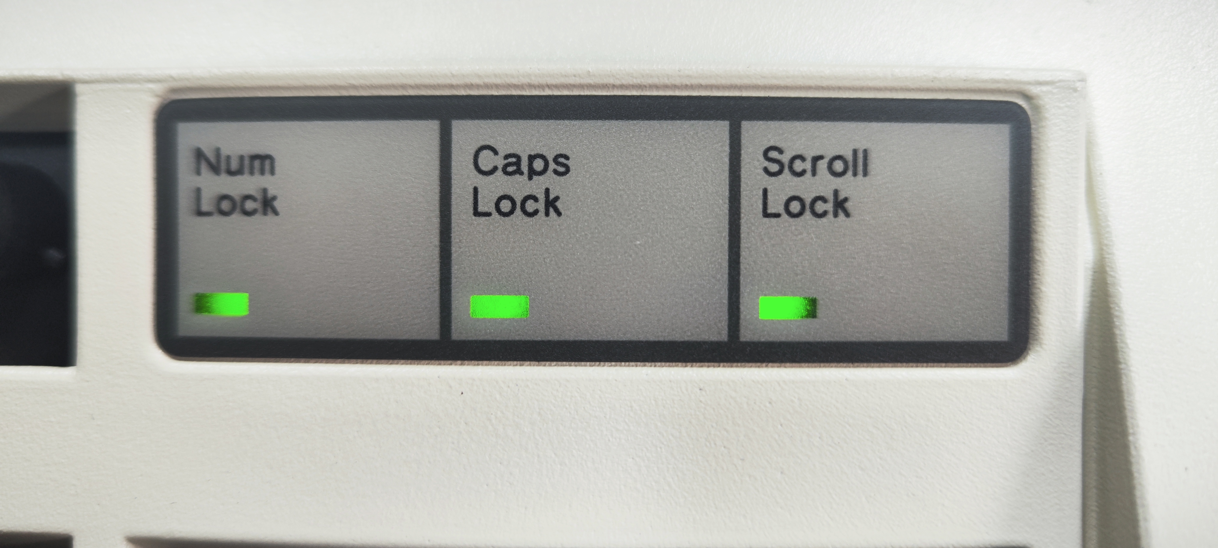

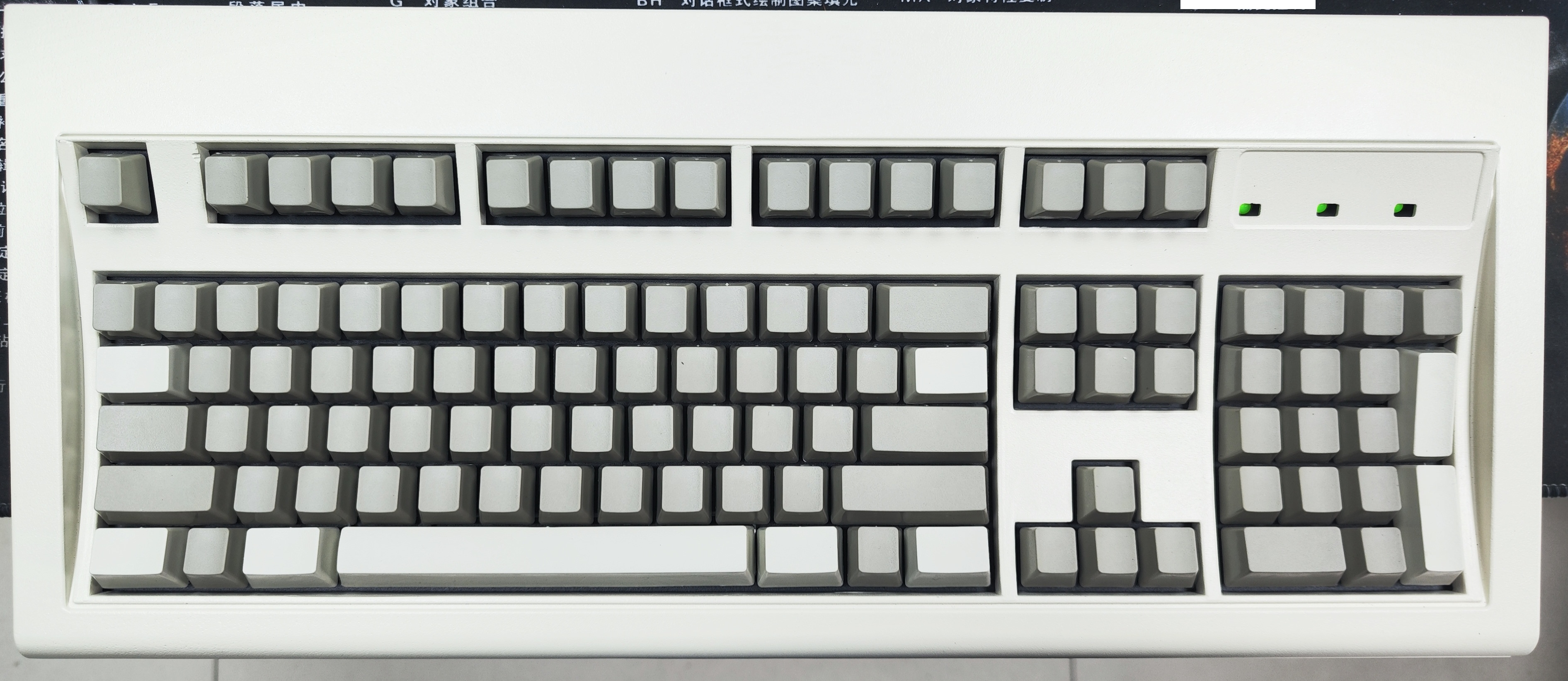

The first F104 with a sample Model M classic style die cast aluminum powdercoated case has been completed! Photos below. The sample case has some casting issues which you can see in the photo. The factory is looking to correct these issues before proceeding to production.
I like the texture of the sample cases (more photos of the texture are in some prior posts).
Please disregard the 5 incorrect 1.5U key and 2U Vertical colors (should be pebble instead of pearl).

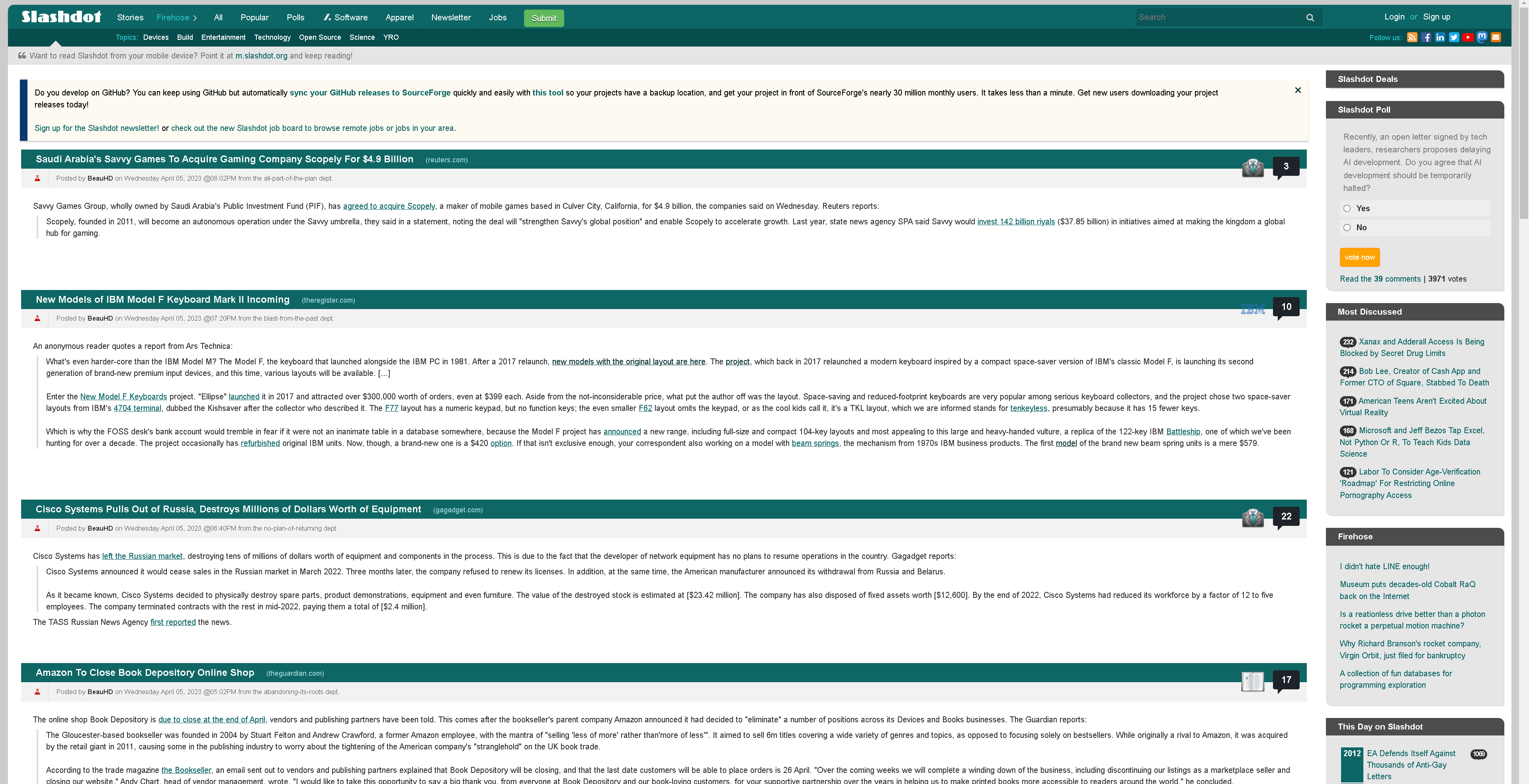

The new project has made it onto the homepage of slashdot!
https://hardware.slashdot.org/story/23/ ... i-incoming
dcopellino wrote: 05 Apr 2023, 17:30 Here follows an article issued ON the Italian WIRED.
Thanks for sharing this link.

Slashdot still even looks the same as it did back when I last read it. Well sized for browsing on a PowerBook. :lol:

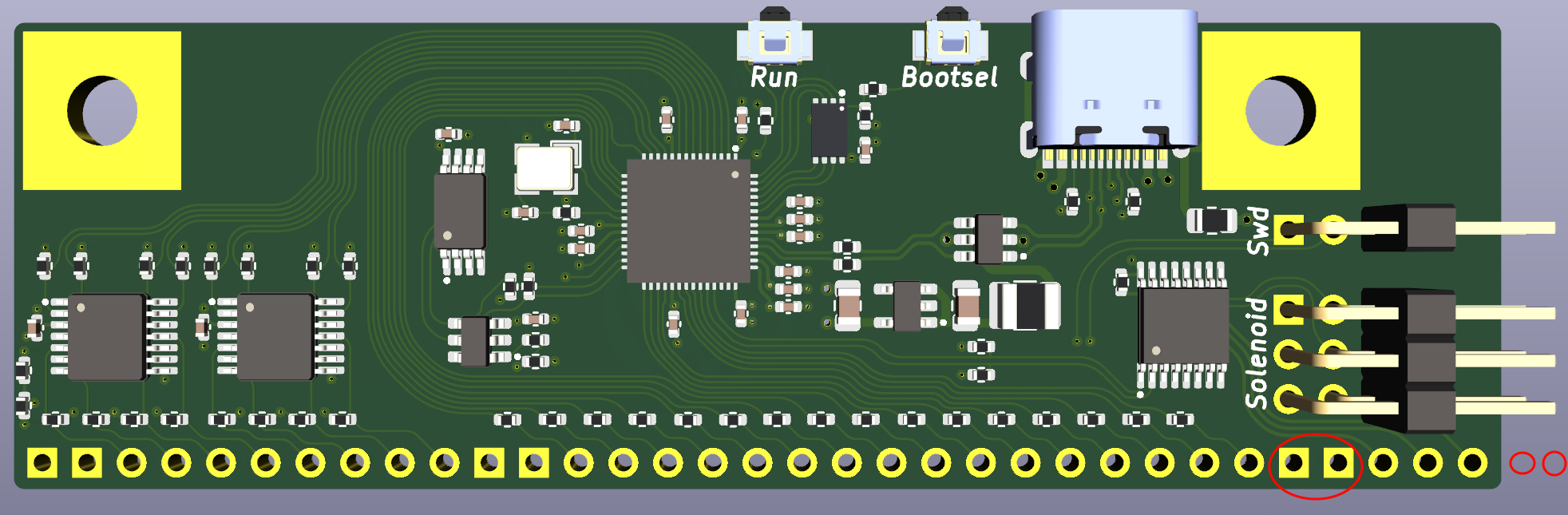

Leyden Jar controller update: forum member Rico has posted an update on the Leyden Jar controller project below. This project uses the RP2040 chip and these controllers will hopefully power the current F122 production round and other boards in the future, once my current stock of ATMEGAs is depleted. I have tested the controller on the beam spring Round 2 prototype and all keys work perfectly so far. Rico plans to add 2 more columns to the project.
One way to add them is to change the two right side ground holes to 2 columns as shown in the attachment (I have circled these two holes). This way, the controller does not become too wide that it does not function with the current new Model F and Beam Spring keyboards. These columns will be ignored for all firmware except F122. For all other keyboards, the holes are connected to ground on the capacitive PCBs. Another option is to widen the controller to add 2 holes as also pictured in the attachment. It would be one or the other, not both changes.
https://www.keebtalk.com/t/the-leyden-j ... s/17489/18
