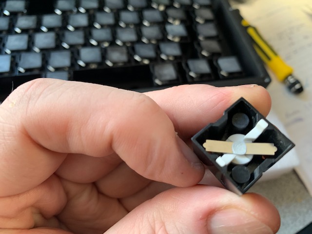

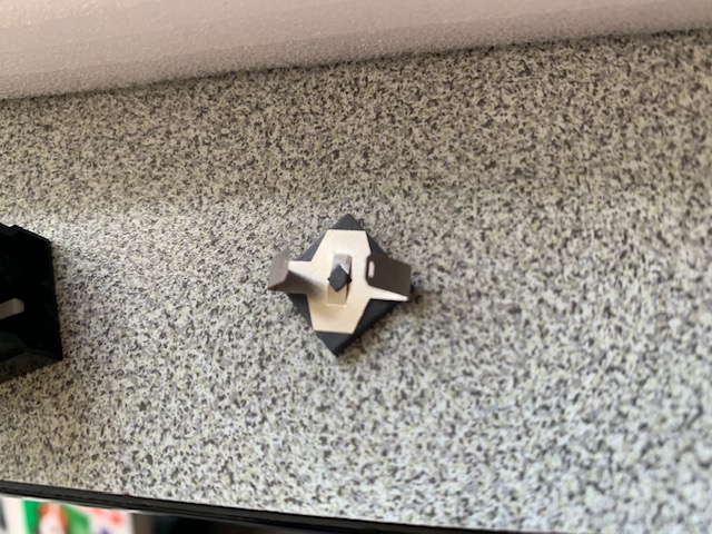

I just setup my Round 1, 104 Beam spring (seen here
https://www.modelfkeyboards.com/product ... -keyboard/
First question:
When pressing the u key or the h key I'll often get the other key as pressed also. Also I'm seeing quite a few spurious u key presses
so I suspect sensitivy on the U key is too high. Are these spurious key presses something I need a question qmk firmware to fix? What causes this?
Second question -
For anyone who has adjusted the individual beam modules to get them to reliably click I'd like to ask how do you get them reassembled?
The biggest challenge I'm running into is that after gently taking the bottom base off and after I've adjusted the "ears" of the metal-spring base plate how do I get the module reassembled?
I spent all of Sunday afternoon and I only managed to reassemble one. In the end, because I had ordered the repair kit I just swapped modules.
It seems maybe I either need four or five hands or some sort of custom jig. I need to hold the module upside down, and depress it and then use two tiny rods or paper clips to gently push up on the beam so that I could lower the base plate back onto the module.so that the beam slot into the ears
Using ascii art, this is the base plate and it's ears. At the top of each ear is a very small horizontal slot
/_________\
[base of plate]
The beam (of the beam spring) which is inside the plastic barrel. Note, you have to super careful to not bend the beam too much.
I see how the beam has two triangular points that then have to fit into each ear's slot, but the ears don't want to spread enough to allow the beam to fit in. I've tried doing one ear and then the other but almost always the other end pops out.
So any suggestions?

I've attached pictures of the beam and then the base plate so you can see the ears and the slots, and then just 2 pics keyboard as a whole

bleair glad your keyboard arrived! Did you review the step by step beam spring setup video in the manual? At least one of the questions you are asking on how to reattach the flyplate without one side falling out is definitely in the setup video (hint: tape and paper clips are involved!).
There is no need for multiple folks helping out or for a custom jig.

In this videoEllipse wrote: 03 Apr 2023, 06:37 Important note: the project's YouTube channel seems to have been erroneously deleted. I sent a message to YouTube support. Some previously posted video links may not be working. I have mirrored some of the videos here for the time being: https://www.youtube.com/@Brand_New_Model_F_Keyboards
https://www.youtube.com/watch?v=RqZCgUF8RWk
I think the key is to look at time 5:20? I think with the paper clip going from under and through you can hook first the point closer to your left hand, then with paper clip to lift the beam you can very gently bring the flyplate toward the other corner (and your right hand)...
maybe? I've gotten one reattched after an hour of trying... I think I'm still missing something here.

bleair yep that's one of the examples, shown at 5 min 20 seconds. As shown in the video a few times it should take a few seconds once you get the hang of it. There is a small square slot in the metal part for beam flipper that receives the end of the metal part for beam barrel as described in that video. It is a matter of locking that in on one side while using the paper clip to help push up the metal part for beam barrel. Attached is IBM's official instructions as well as a video from another forum member which some may prefer.
