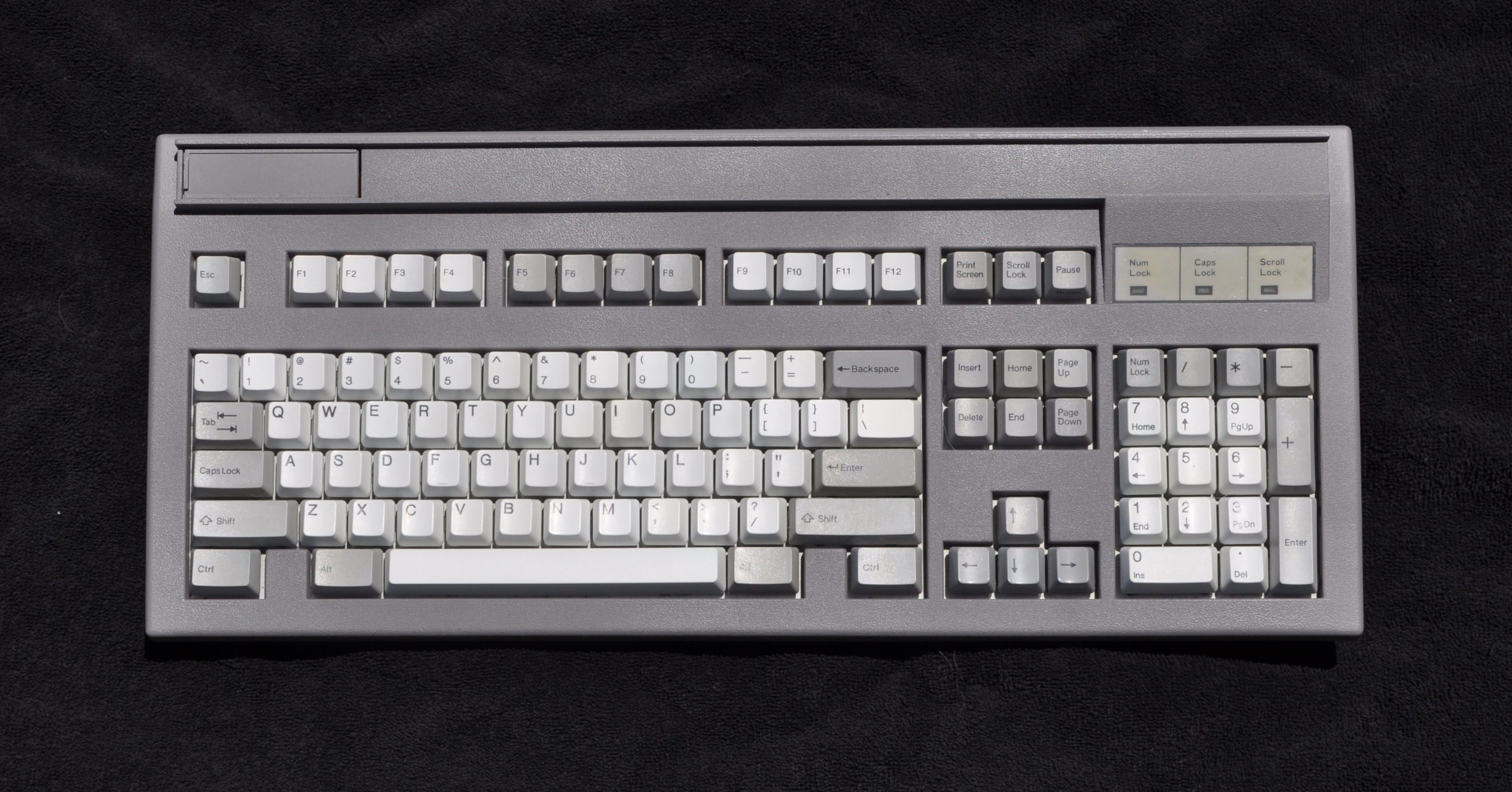

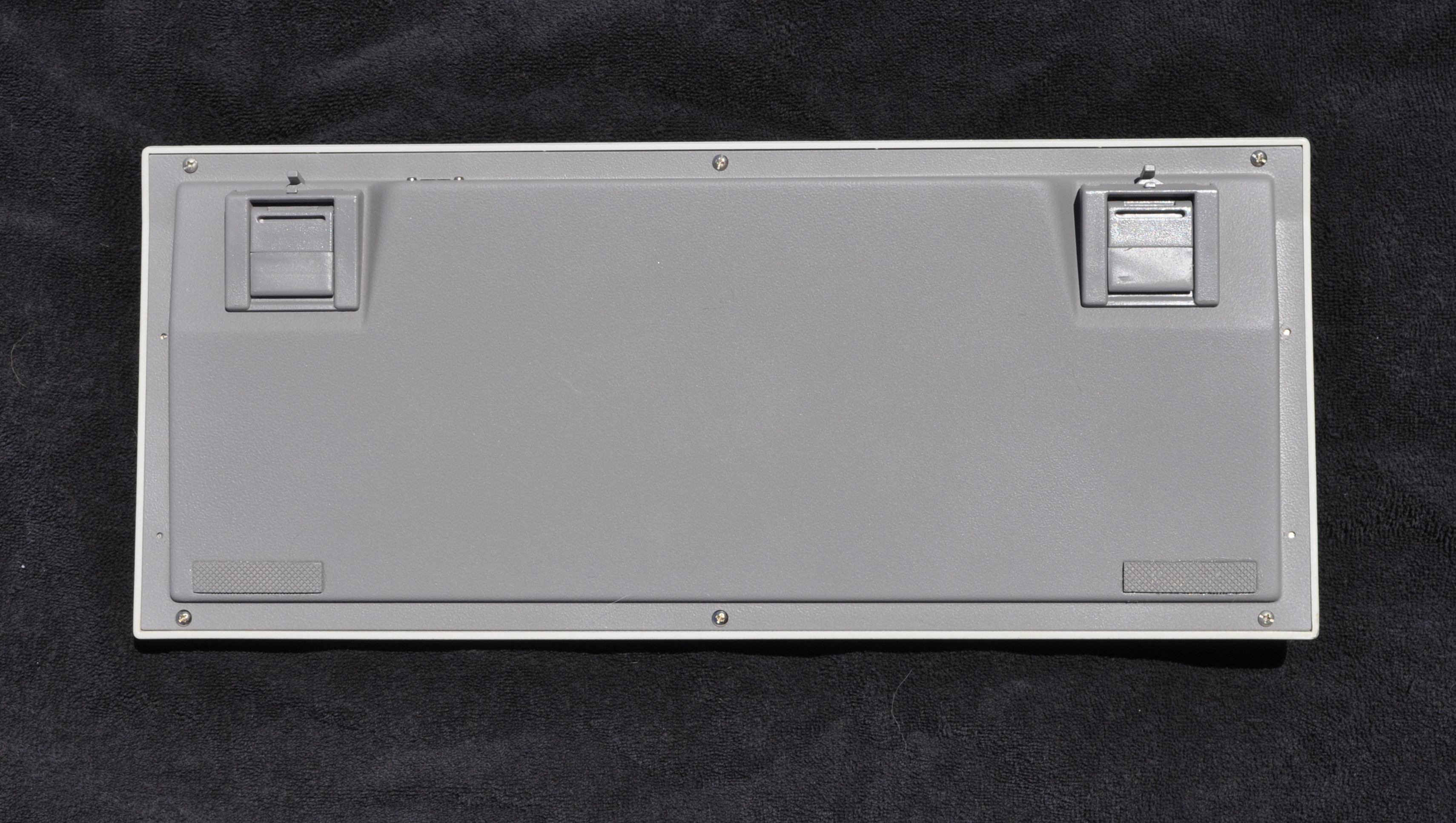

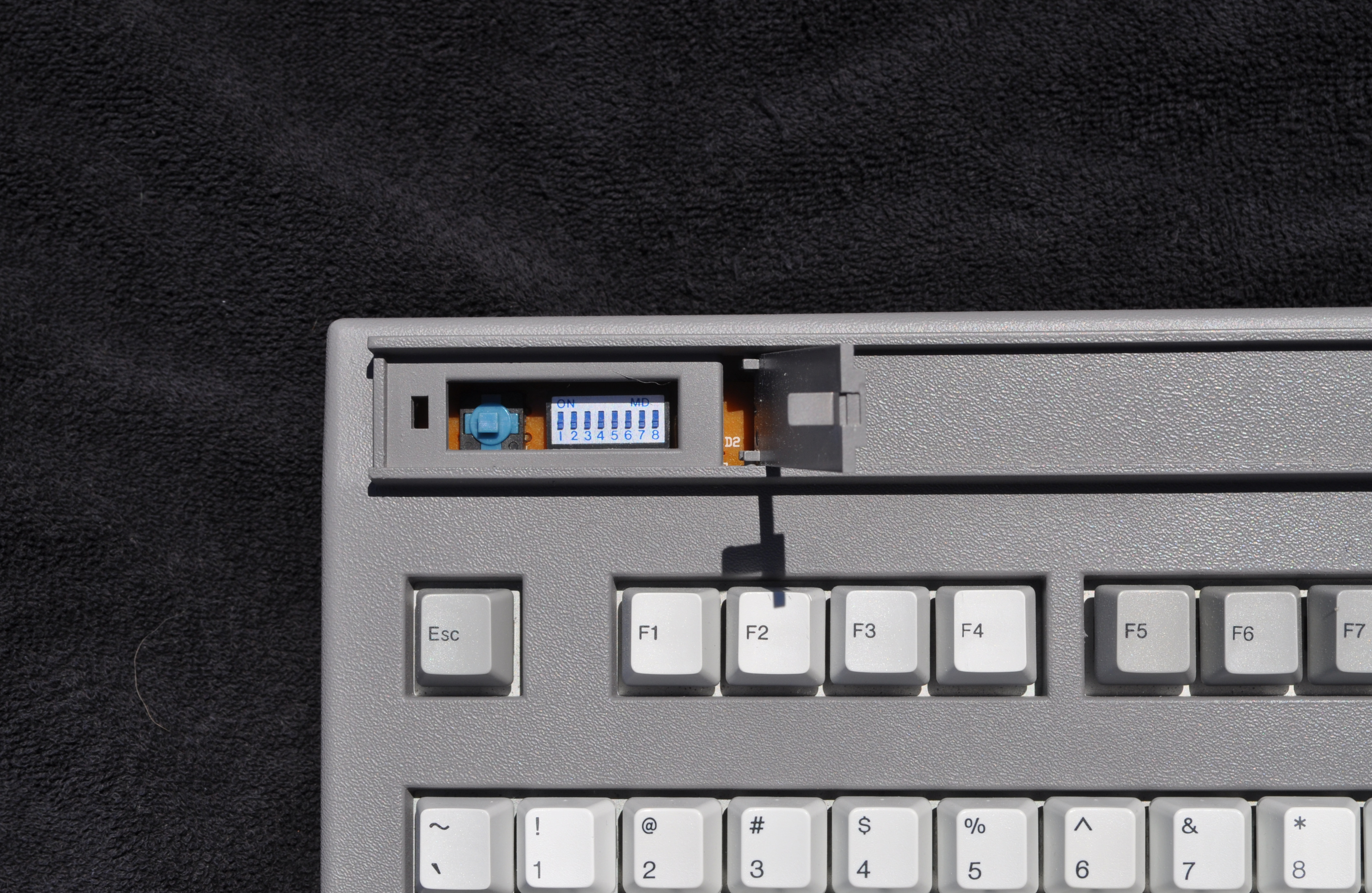

hellothere
09 Jul 2023, 01:18
Finally finished the 101.
FullTop - Copy.jpg (1.15 MiB) Viewed 43066 times
FullBottom - Copy.jpg (1.23 MiB) Viewed 43066 times
DIP - Copy.jpg (2.15 MiB) Viewed 43066 times
BottomCaseInternal - Copy.jpg (967.25 KiB) Viewed 43066 times
Yes, it's now "badgeless." The 101 has a sticker instead of a plastic badge. It's now pretty much destroyed. I also moved the bottom case sticker into the inside of the case.
I'd like a darker grey lock lights sticker, but I can't have everything. Where would I put it?
Polecat
09 Jul 2023, 03:57
hellothere wrote: 09 Jul 2023, 01:18 Finally finished the 101.
Very nice. I like the idea of keeping the sticker with it, and inside is good for anyone who cares enough to look. I've put hand written labels inside several of my custom jobs, as much to remember what I did as to let the next owner know after I'm dead and gone.
inozenz
09 Jul 2023, 10:41
oh this grey actually works great on this keyboard. some of the paint jobs dont compliment the keycaps but yours do :O good job
09 Jul 2023, 15:18
Quite classy indeed.
Subtle harmony with the slate mods, while the pearly white alphas really pop. Even complements the legend colour. Nicely done.
