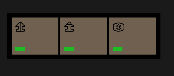

For those interested in a "non-English" overlay (more neutral). This is the template sent, with the proper "atomic mushroom cloud". Numlock is a crypto "1" and Caps Lock is a crypto capital "i". Scroll Lock is more obvious.
An idea: The overlay could be sold in a small bundle with the proper 1,75u Caps Lock, 1u Scroll Lock, and 1u Numlock.
- Overlay ISO 9995-7
- overlay01.png (3.38 KiB) Viewed 55904 times

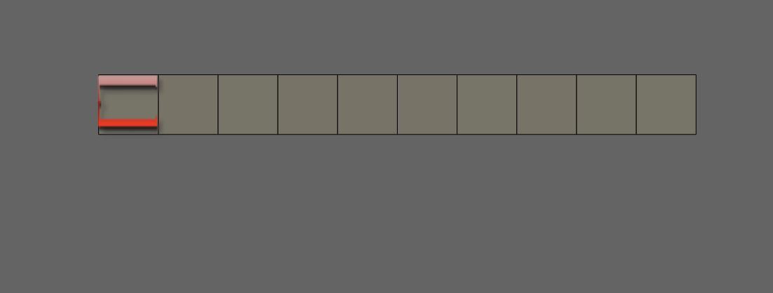

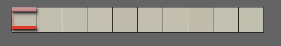

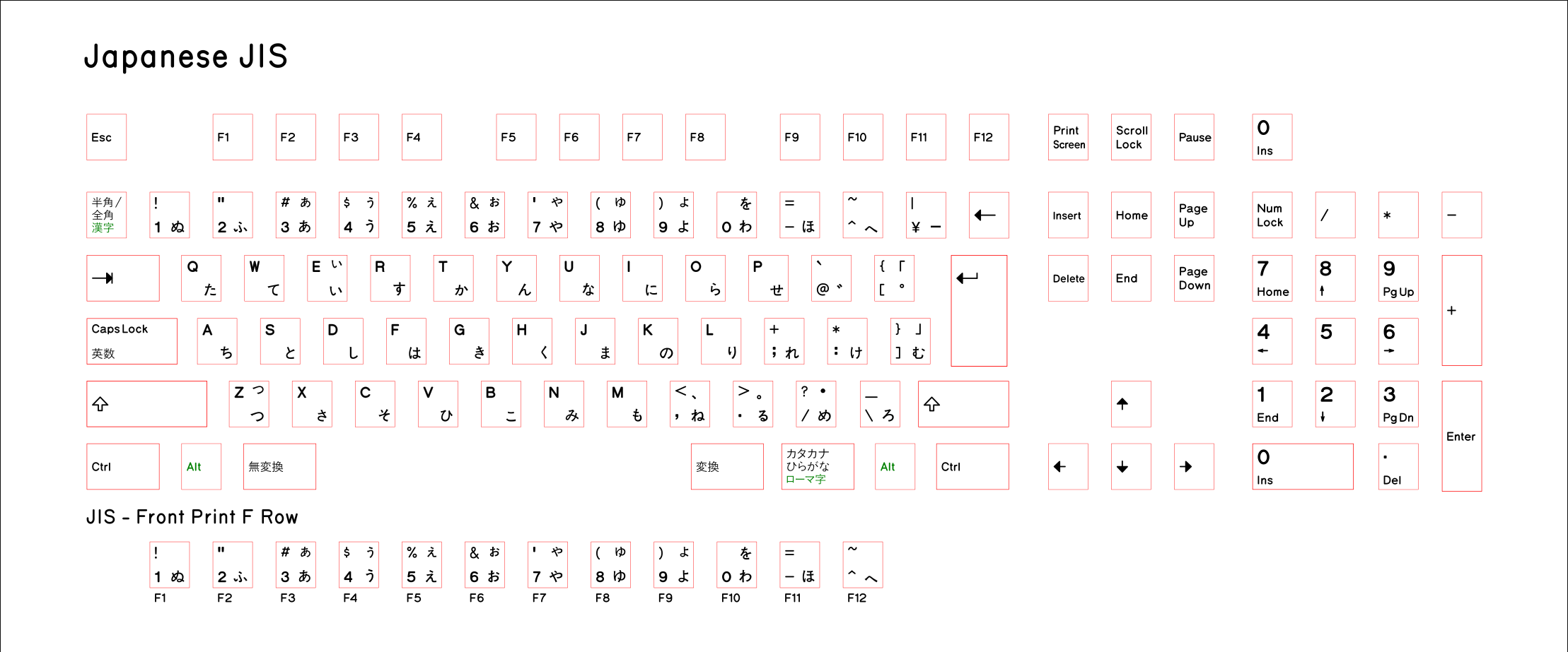

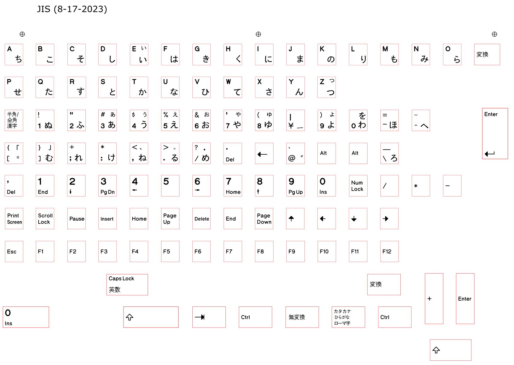

JIS New Production Key Set:
After a number of requests, I have decided to proceed with making the JIS sets. Previously these sets, as well as the APL sets, were Unicomp sets. APL will remain Unicomp (unless someone wants to make the template as was done for the couple recent new layout submissions). I will be making the JIS front print option (not shown below in my draft).
Can folks please check to correct my JIS mistakes and let me know what to fix before sending to the factory? The first image shows what I updated, and the second image shows what Zed was working on (Zed is taking a well-deserved rest from the key set designs). All text will be black - no green text as shown in the Zed draft.

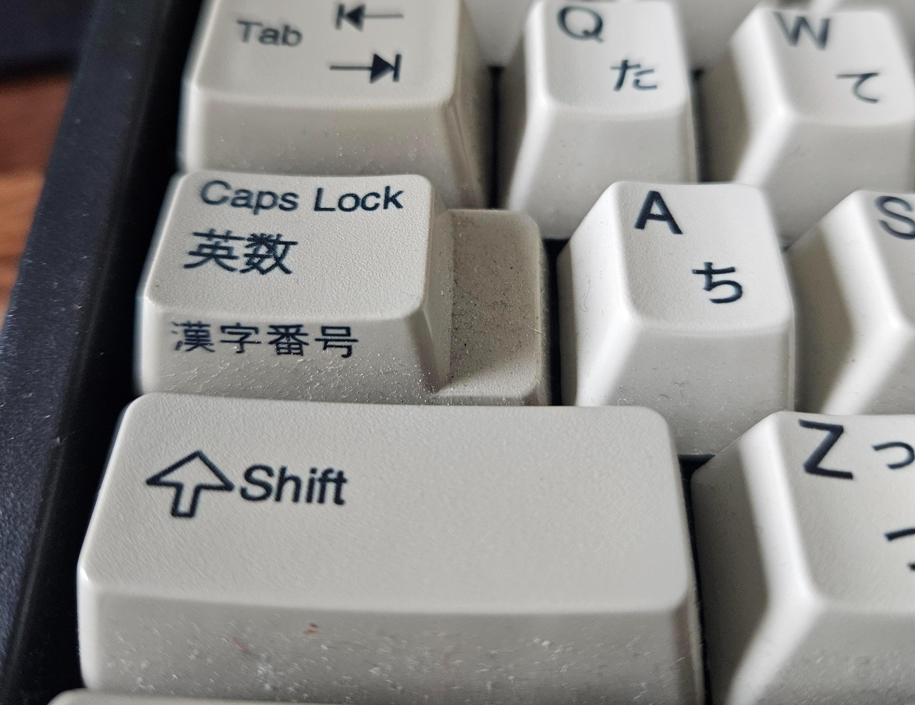

It's really exciting to see XT quality JIS keycaps. Thank you for hard work Ellipse and Zed!
I've noticed a couple of minor things, which I think ultimately come down to style preference. But all in all no mistakes.
Caps Lock: Some of the old Japanese IBM and newer unicomp keyboards have "漢字番号" written on the front. Newer keyboards tend to omit this though.

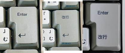

Heres an image from my Unicomp: Backspace: Most JIS keyboards backspace is stylised as:
The rest I assume is just me misreading the template.
The 半角/全角 漢字 key in the top left by Tab: "漢字" is usually printed on the front. Same thing with "ローマ字" on the カタカナ/ひらがな ローマ字 key in the bottom right.
The =-ほ and _\ろ keys: It's probably just the font but it kind of looks like the - and _ are mixed up?

Ellipse
Thanks for the feedback sebkaide
Here are my notes:
I have updated the =-ほ and _\ろ keys in the above post to fix the issue. I moved up the small dash on the =- key and used the em dash for the other key.
Caps Lock - what do folks think about adding it as a third line or appending a / and the text to the second line? As a general note any front printing is moved to the top of the key for all key sets. I say we should add as much as is commonly found on JIS sets but to stay with IBM/Lexmark/Unicomp style JIS and not vintage JIS.
Backspace - Zed thought of keeping the key consistent with the icon 1U backspace keys of other sets (a change from the original) but what does everyone think? I did leave the enter writing on the ISO Enter key though Zed thought it should be icon only to be consistent.
Zed indicated that the extra tab text is for very old style JIS boards only and that Unicomp and IBM/Lexmark boards omit this text. What is the general consensus on this text for JIS users?
Here are my notes:

With the JIS keycaps: I think if front printing ends up being moved to the top of the key then I think it's probably best to omit the text.
Do any of the sets currently have 3 lines of text? I'd imagine it getting a little crowded.
半角/全角: Looking at some of the IBM/Unicomp keyboards, it's probably a 50/50 split if "漢字" is included. My Unicomp doesn't include it. If it's not possible to include all three lines without crowding or shrinking the text I think its worth leaving it at just "半角/全角".
カタカナ ひらがな: I think the inclusion of ローマ字 as a third line would be ideal even if the text has to be shrunk a little. But still not the end of the world if it ends up not fitting.
Caps lock: As far as I know the "漢字番号" functionality only existed on IBM's version of DOS. I imagine it's on the Unicomp keyboards for historical reasons. I think it's safe to remove it.
Backspace: I think keeping it consistent with the other XT caps is best. Probably the closest to a Japanese model f would be the IBM Pingmaster, which has a 1U arrow icon backspace as well.
Enter key: Japanese IBM is pretty over the place with it. I'm personally pretty fond of the "改行" with arrow. But ultimately it probably makes sense keep it icon only for consistency.
Ellipse
Thanks; I updated the ISO Enter key to Icon only.
No other sets have 3 lines but Zed seemed to think it was ok to do so and important to include all 3 lines, based on talks with others on making the JIS layout. The modifier key text height is about 1/3 of the key so 3 lines could fit without shrinking things.
