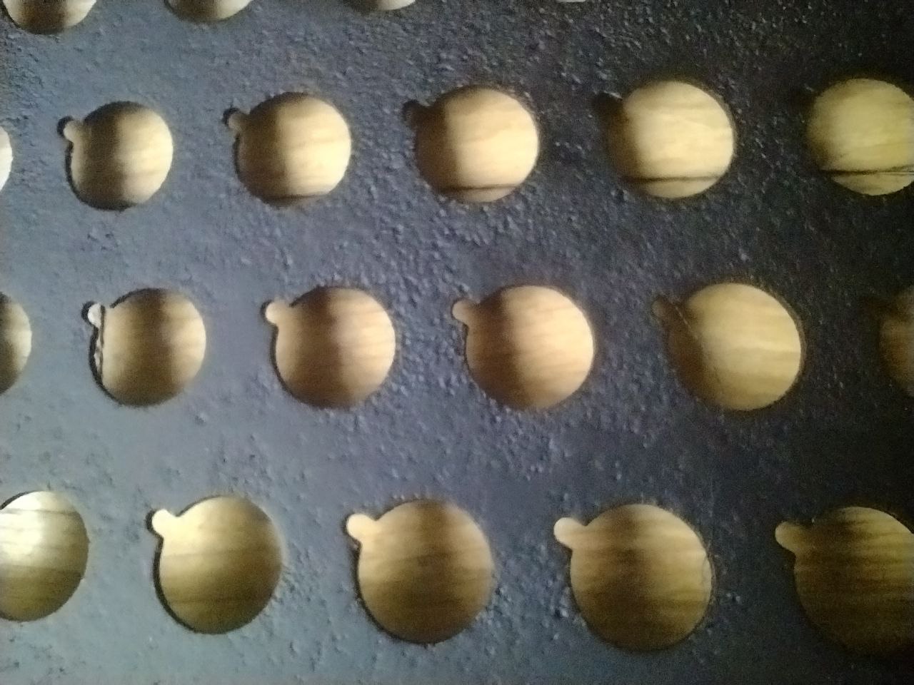

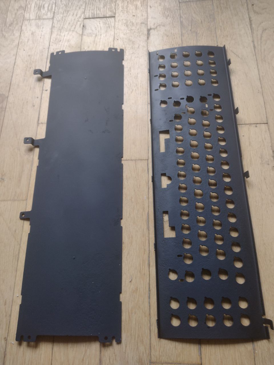

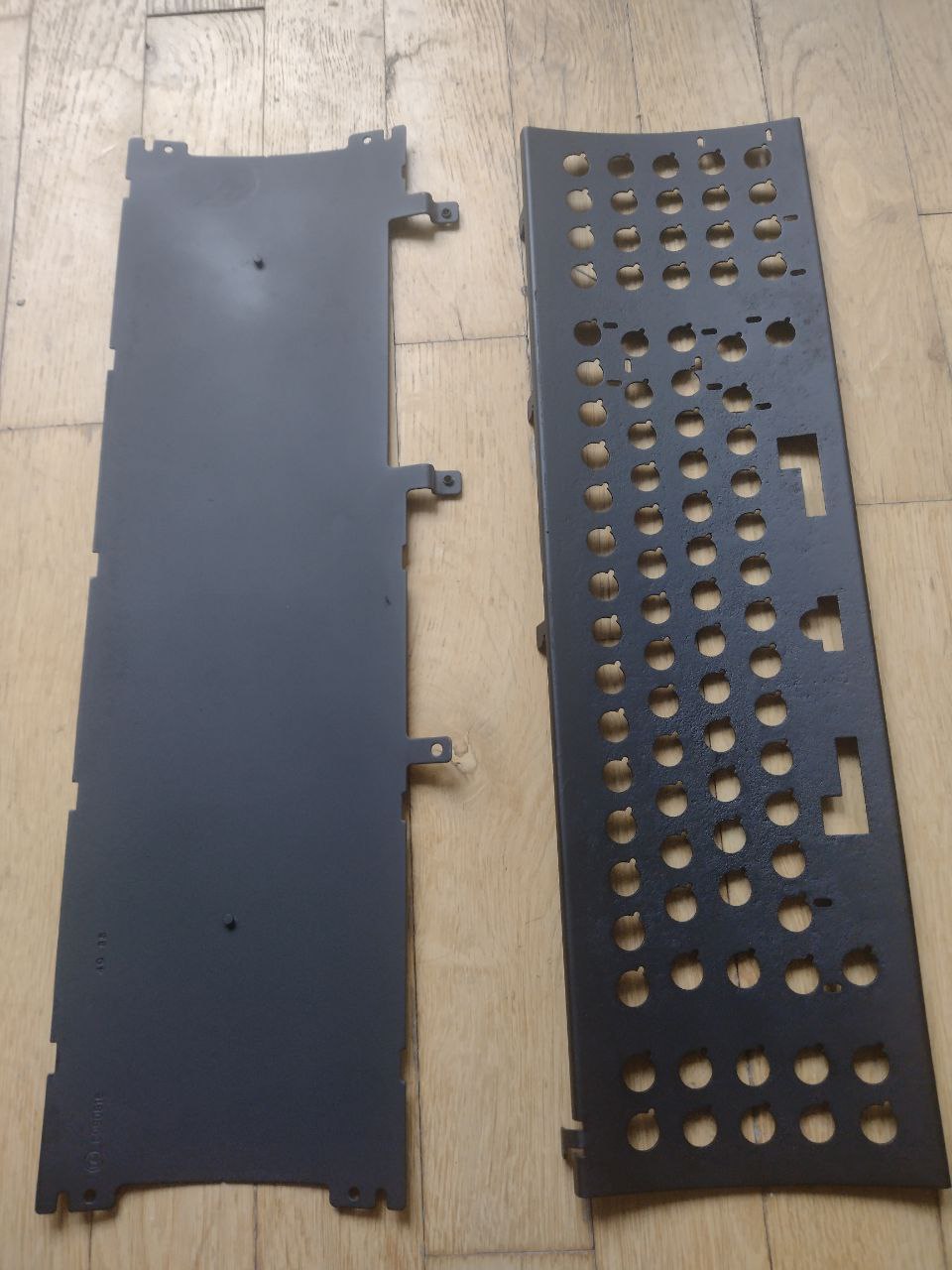

To start off, since the last update, barrel and bottom plate was completely derusted, following that, two layers of anti-corrosive primer on both sides followed by some matte black paint, the end result:
photo_2022-11-30_10-12-09 (2).jpg (140.52 KiB) Viewed 6531 times
Considering what these started out as, it turned out quite nicely, I mean sure if you look close you can see the surface of the moon but I kinda like it, its not anything that will ultimately change the keyboard performance, and its a reminder where it came from.

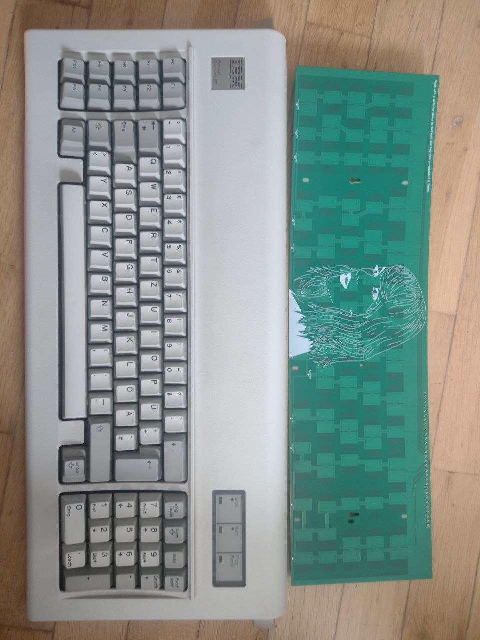

So over night the project went from dead to orders being placed for a pack of PCBs and a xwhatsit pandrew controller, a few weeks go by, things fall into place, the replacement foam was rediscovered in a box somewhere and the end result is:
An ISO modded AT with a custom controller and PCB, Schneiderin Schnell types again!
It turns out I was very wrong about the M vs F springs however, with the entire numpad cluster being brand new flippers and springs from modelFkeyboards, they are much nicer than my replacements and feel way closer to the original, potentially a full swap is in order down the line.

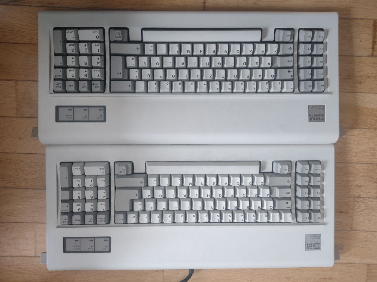

Now, that is not the end of this story, call it cosmic karma or whatever you will for rescuing this rusted out basket case, but 1 week after putting together Schneiderin Schnell, something else popped up locally for an undisclosed but criminally low price:
photo_2023-11-09_12-13-41 (2).jpg (162.38 KiB) Viewed 5489 times
The second one gets no name, or modification, because other than a bit of rust on the top plate and rotten foam, which is normal, its in very good shape mechanically and cosmetically, it will get its own restoration at some point, but for now its definately not a prio.
