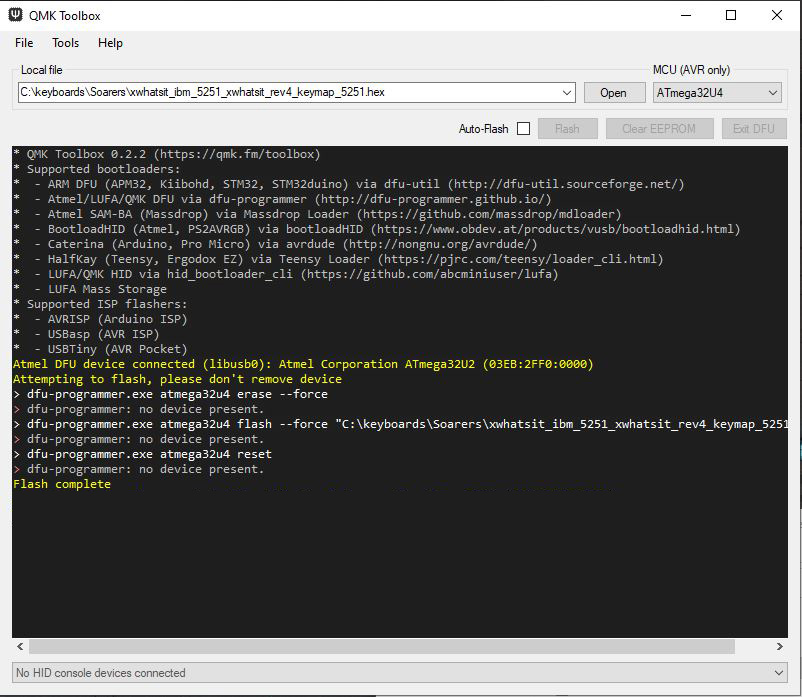

So I followed the steps, but I don't think QMK Toolbox is detecting the keyboard. After several attempts at flashing it says "Flash Complete", but the keyboard is totally unresponsive. I don't think it recognizes the bootloader. (Note the buttons are greyed out, but that's because I plugged in a working keyboard.)

Click the MCU drop-down menu at the top right of the window and select 32u2 to match your hardware.
Annoyingly, QMK Toolbox doesn't just try *all the ways* with ATmega, which it really should.
In fact: looking at your screenshot, it was perfectly aware this was a 32u2 yet tried and failed to talk to it in 32u4 like an idiot. If it can see what it is, this is very poor behaviour. I'll go file a bug.

I did that, and while it said "Flash Successful" the keyboard is acting even crazier now, to the point where I can't open folders or start programs even if I plug in a working keyboard. I need to shut down and restart in order to have a working computer again

Well at least the flashing worked. Sounds like it thinks a modifier key is being held down or something similar. You probably have the wrong firmware flashed to it. Make sure you've selected the correct controller and board type in the QMK configurator and try flashing that instead.
Try Universal instead of Rev4

I managed to plug the keyboard into my laptop without making the computer go nuts. Other USB keyboards work when I plug them into it, but no keys register when I plug in the 5251 (I use Switch Hitter as a diagnostic tool). When I look at Device Manager it recognizes the 5251 as a "HID Compliant Consumer Control Device".

What firmware is it running now?
Xwhatsit’s hardware always has that fallback reset switch to force it into DFU for a reflash. A particular advantage of QMK is its support for Pandrew’s “util” for checking signal levels, which is what I’d give a shot in your case.
