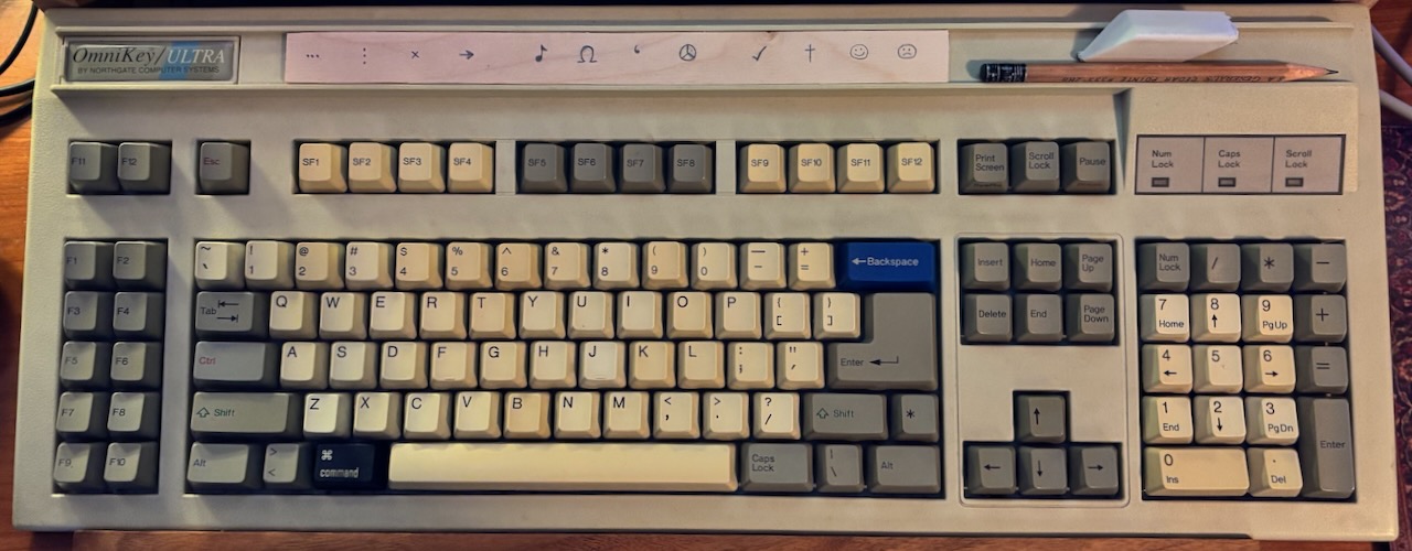

Hi All,
I have a Northgate Omnikey Ultra "Gen 4" keyboard that is notionally programmable. However it has either been "misprogrammed" or else the chip is dead/semi-dead, meaning various silly things like "D key makes an S, G key makes an E, R key makes "Up", etc, etc.
My questions are:
(1) Does anyone have a link or copy of programming software that will work with Windows 7+? (I found a dead link out there somewhere, but so far haven't found a live one)
(2) Does anyone know a way to at least "factory reset" the Gen4?

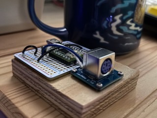

I couldn't let it rest, so I constructed this little friend out of a Teensy 2.0 and a PS/2 breakout board.
I flashed it with some custom code to dump PS/2 commands using the Arduino ps2dev library. I connected the device's USB to Computer 1 and opened up the Serial Monitor in Arduino IDE.
Then, I powered down Computer 2, connected my PS/2 Pal to its PS/2 port, and booted up FreeDOS 1.3. Luckily, FreeDOS does have some limited support for USB keyboards, so I was still able to operate it.

Armed with this knowledge, I was finally able to reprogram my Hasu's PS/2 to USB adapter to issue this command to my Inverted-T Ultra at startup. Here's the modification to tmk/tmk_keyboard:
diff --git a/converter/ps2_usb/matrix.c b/converter/ps2_usb/matrix.c
index c441a89b..3df20f5f 100644
--- a/converter/ps2_usb/matrix.c
+++ b/converter/ps2_usb/matrix.c
@@ -64,6 +64,9 @@ static uint8_t matrix[MATRIX_ROWS];
 #define PRINT_SCREEN   (0xFC)
 #define PAUSE          (0xFE)
+// Set Special Function Keys for Northgate Omnikey Keyboards
+#define SFSET          (0xE9)
 static bool is_modified = false;
@@ -75,6 +78,12 @@ void matrix_init(void)
     // initialize matrix state: all keys off
     for (uint8_t i=0; i < MATRIX_ROWS; i++) matrix[i] = 0x00;
+    // Initialize Omnikey
+    _delay_ms(500);
+    ps2_host_send(SFSET);
+    ps2_host_send(1);  // SFSET S
+            // asks the Special Function keys to emit shift-Fn
     return;
The half-second delay does appear to be necessary.

After giving up on a few approaches, I ended up sawing a 2cm wide (tall?) strip of craft wood. It fit snugly in the Ultra's top channel, and even left room for a pencil and eraser with which to keep the legend up to date! :)
F-key overlay.jpeg (542.96 KiB) Viewed 10965 times
With my firmware mod in place, I was able to map the special function keys using xkb on Ubuntu. Here is what I did, in case anyone would ever like to reproduce this:
First, you'll want an alternate method to access your machine in case you screw anything up and can't type any more! The easiest way to do this is probably to enable remote ssh access.
Next, locate your xkb keyboard symbol file. In my case, it was /usr/share/X11/xkb/symbols/us
If you're using X11 (Ubuntu 20 and earlier, except 17 I think?), make a backup and use sudo to edit this file in place.
If you're using Wayland (Ubuntu 21 and later, and also maybe 17?), you'll need to copy the keyboard symbol file to ~/.config/xkb/symbols/ and edit it there. (The location could be different, if you've set XDG_HOME_CONFIG to something else)
Here was what I added inside xkb_symbols "basic":
key <FK01> { [ F1, U2026 ] }; # horizontal ellipsis
key <FK02> { [ F2, U22EE ] }; # vertical ellipsis
key <FK03> { [ F3, U00D7 ] }; # multiplication sign
key <FK04> { [ F4, U2192 ] }; # rightwards arrow
key <FK05> { [ F5, U266A ] }; # eighth note
key <FK06> { [ F6, U2126 ] }; # Ohm
key <FK07> { [ F7, U02BB ] }; # okina
key <FK08> { [ F8, U262E ] }; # peace symbol
key <FK09> { [ F9, U2713 ] }; # check mark
key <FK10> { [ F10, U2020 ] }; # dagger
key <FK11> { [ F11, U263A ] }; # smiley face
key <FK12> { [ F12, U2639 ] }; # frowning face
Where the left side of each line is the key to remap, the first item within the brackets is the unshifted target (in this case, the same key), and the second item within the brackets is the shifted target (in this case, the hexadecimal index of a unicode character.)
Everything after the number sign is a comment.
This worked great, with the caveat that unicode characters bearing hex indices of greater than 4 digits caused serious problems. My workaround was not to use any :)
When I went to configure this once again for my Mac Mini, I also made the unwelcome discovery that my tmk_keyboard firmware edit doesn't seem to work on macOS, for some reason. I tried increasing the initial delay, to no avail.
If I perform SFSET manually using the orange button and Pause key on the Ultra, I am able to map the special function keys in macOS using ~/Library/KeyBindings/DefaultKeyBinding.dict
Incidentally, I have tested the firmware mod successfully on Windows 10. But I'm not sure how to map the special function keys there without installing custom software.
