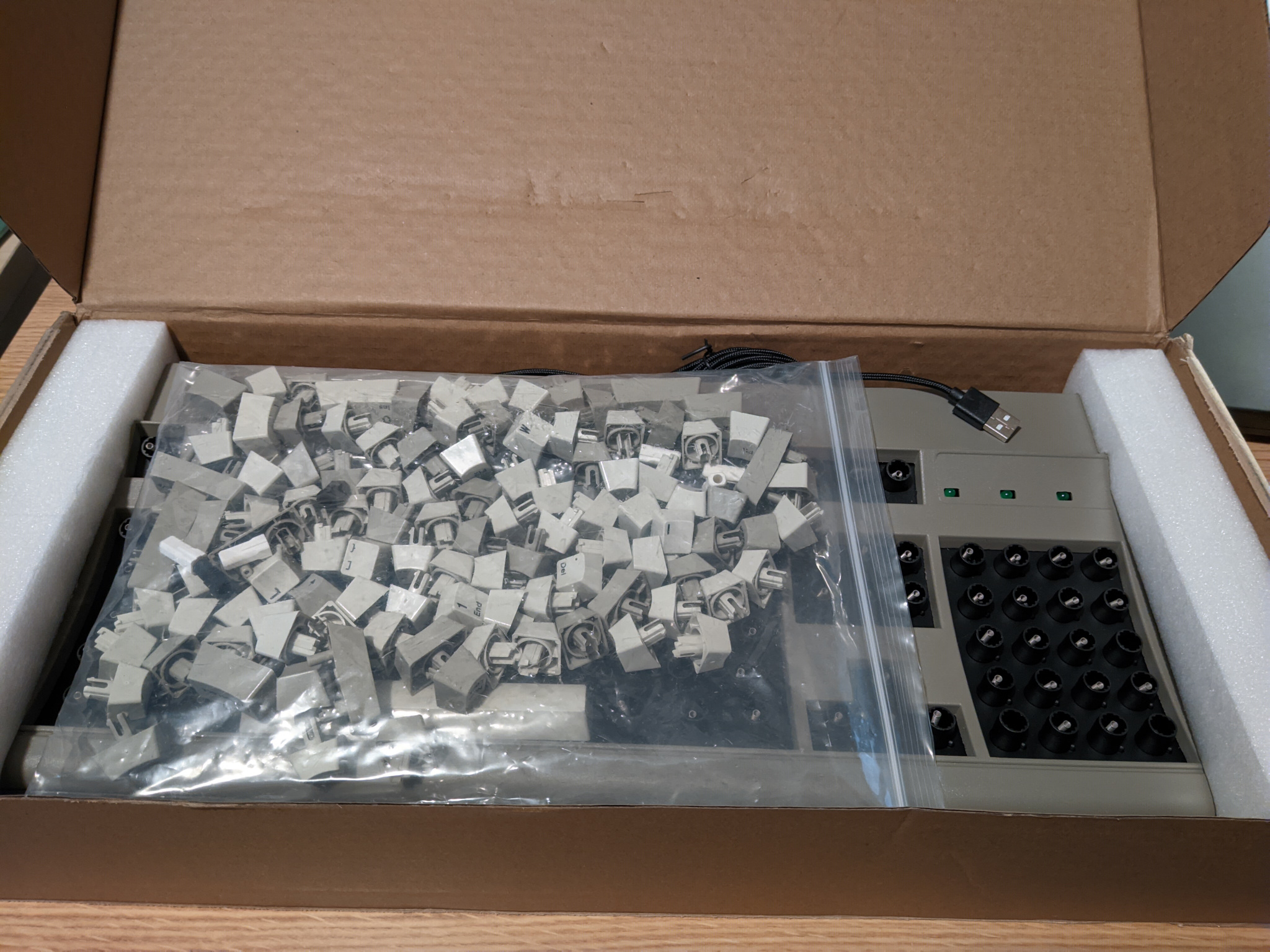

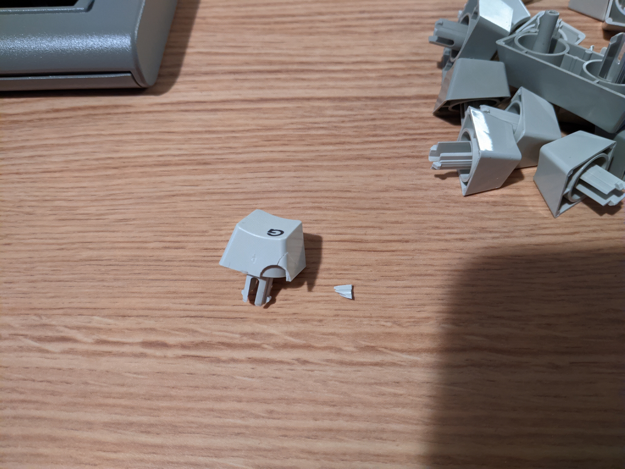

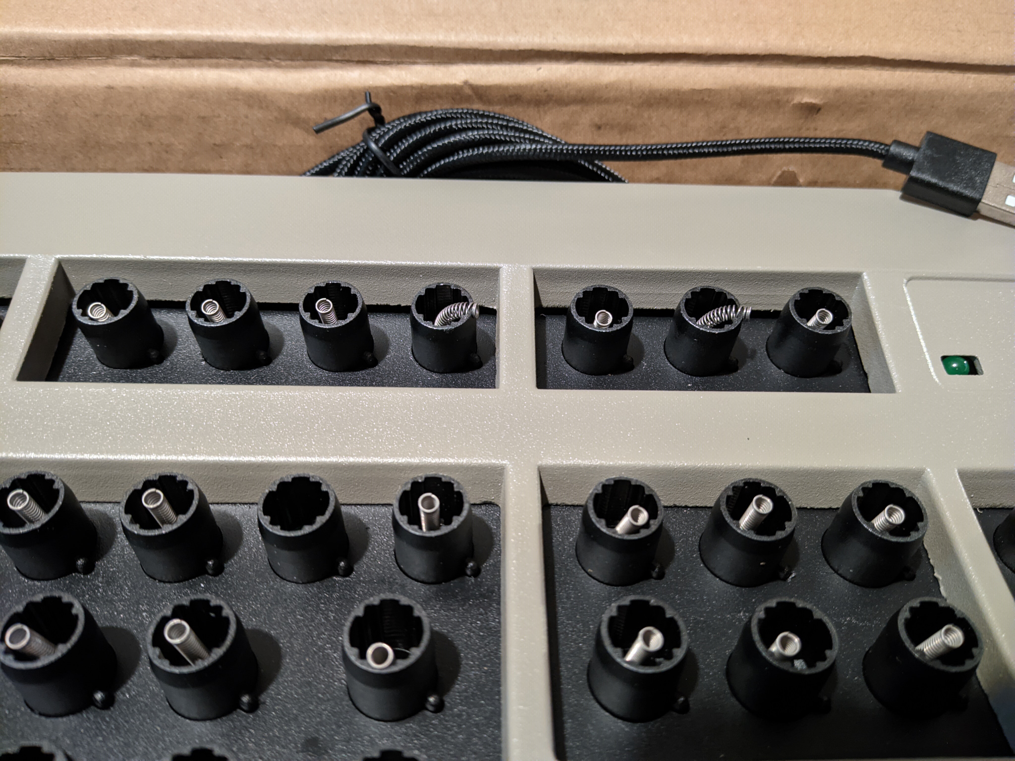

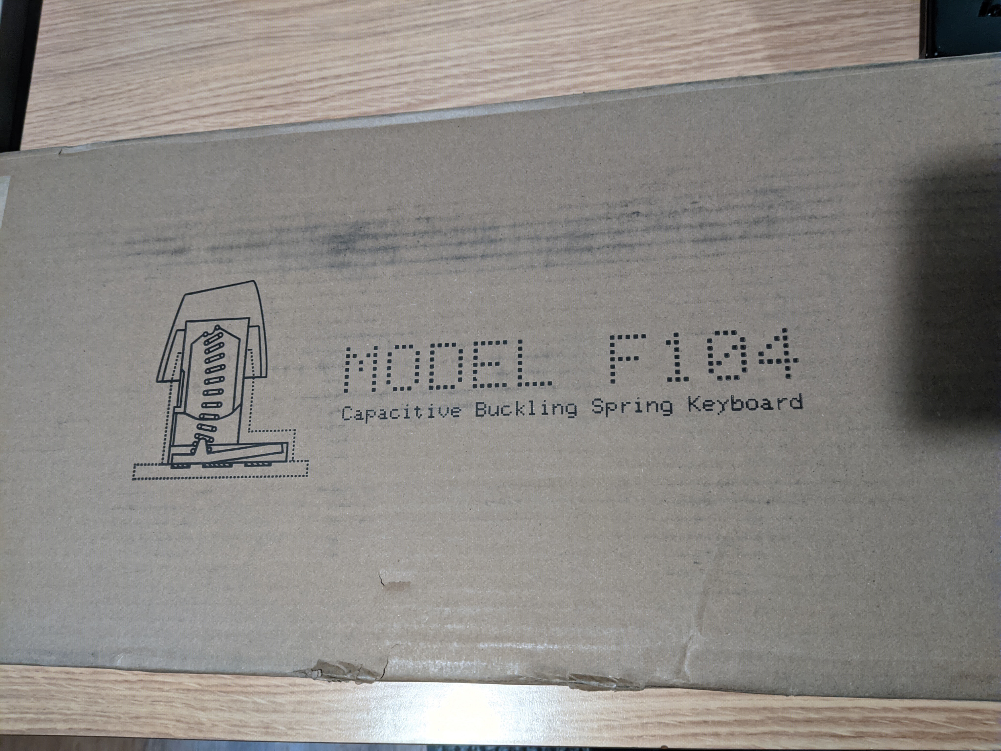

Oelmuvun
01 Nov 2024, 02:26
My F104 came in yesterday!
Surprisingly the box showed up in pretty reasonable shape externally, I was expecting a lot worse.
Despite two springs being bent over their barrels and one keycap somehow smashed a bit, everything popped together and worked straight away. I didn't have to troubleshoot any springs, nor were any missing.
I did spend a bit of time pulling hair in the terminal until I found the link for pilcher's guide to building the pandrew utility on Fedora. Thanks for that, it was a lifesaver, especially when I had not realized that the blank key between R-Alt and R-Ctrl was the Fn key and needed a way to test it. I am really tempted to split the R-Shift and move Fn up beside it so I can get R-Win back, but I want to enjoy this for a bit before I start causing problems.
As far as using the F104 goes I haven't really had a whole lot of time to properly sit down with it, but it feels just like my Model F 'XT' and 'AT' switches.... Except in a useful layout! I always liked the Model F switches when using my IBM 5150 more than the Model M despite the increased noise, and I certainly like the Model M more than Cherry MX Blue switches w/ Black springs.
Big thanks to Ellipse and everyone involved in the firmware and such for these boards!

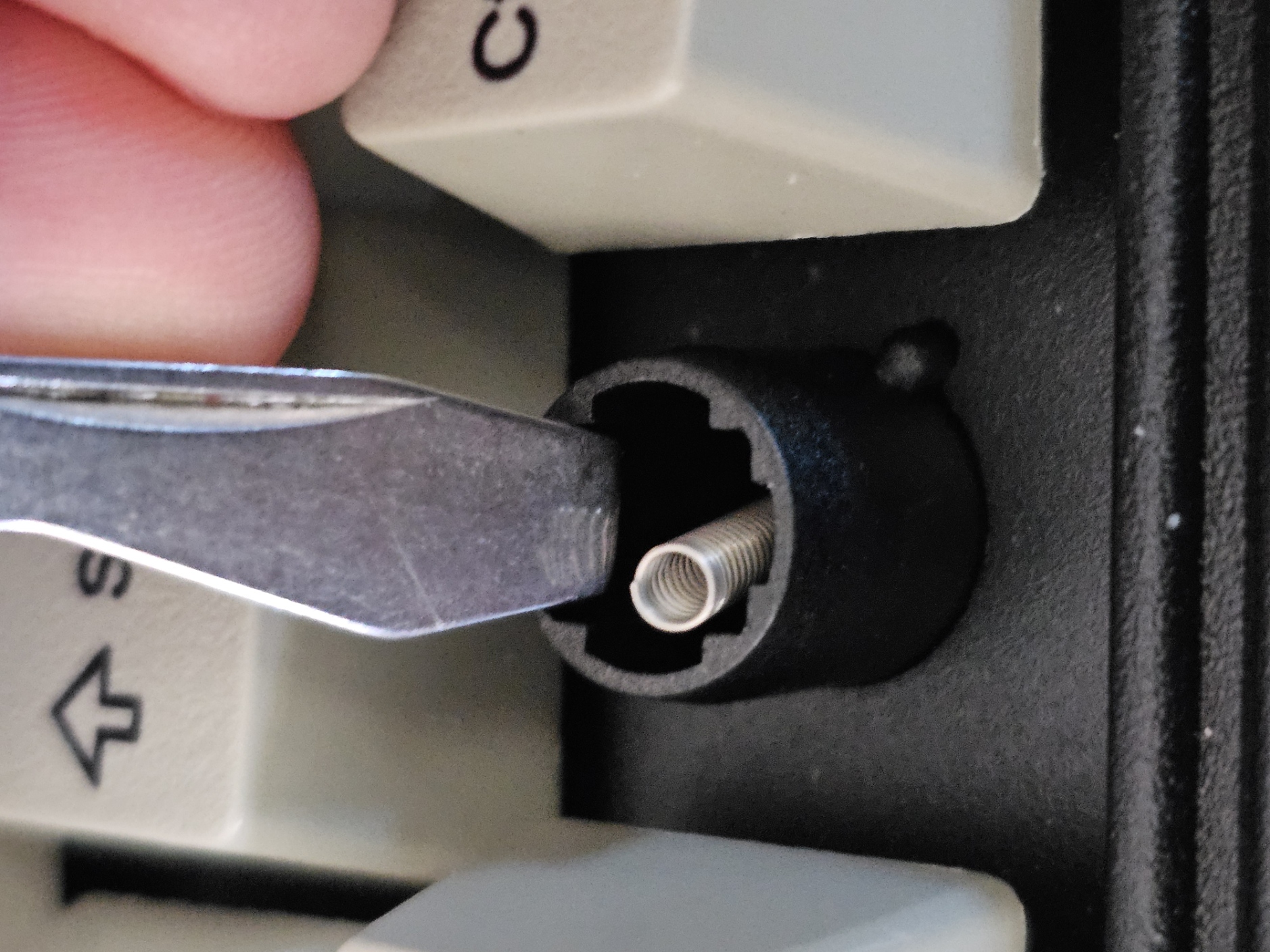

YALE70 wrote: 23 Oct 2024, 00:51 Secondly, I started noticing some prevalent off-center binding/scratchiness on a some of the unstabilized keys after a little over a week of use. I noticed there was a bit of light colored debris around the corner edges of the barrels from the keycap stem rubbing against them, and they did feel a bit sharp. I resolved this by just gently smoothing the corner edges of the barrels with the side of a flathead screwdriver blade. I don't know if this would've eventually worked itself out with more use/breaking-in but I haven't had the issue reoccur on any of the previously affected keys since doing that.
I have the same issue. It's only affecting the tab and caps-lock keys, but I map caps to ctrl and spend most of my time in a terminal, so those two keys get used a lot.
My experience is that it doesn't improve with time. If anything mine have gotten worse. I just tried wiping a little dialetric grease on the stem of one of the keys. It has helped for now, but I don't expect it to last given how the scratchiness is from the stem scraping along the top edge of the barrel. I expect the grease will be scraped off in short order.
I'm surprised that the key above enter which I have (mapped to backspace) doesn't have the same issue. It gets just as much use as tab (if not more) and it's just fine.
You don't sell stepped keys, do you Ellipse? I think that'd solve my problem by forcing me to press the keys in their centre. Or I could try replacing the barrel but I don't really feel like pulling my whole keyboard apart.

resonator you may want to burnish the back of the key stem and/or try the wiggle method for these keys. In my testing I have been unable to reproduce the issue you are describing. I do not think it is an issue with the key contacting the top of the barrel but instead a limitation of the Model F design with a good amount of plastic surface area sliding against each other (the barrel and key). The 1.75U key is the largest non-stabilized Model F key and all Model F keys require slightly more force closer to the edges to actuate, unless the key has a nice old style wire stabilizer. This is true on my original Model F and Model M keyboards as well. You may want to also consider foam padding/o ring/etc. inside the key if this continues to be a bother. Filing down the barrel top 0.5mm may also help, but it is not recommended as the key would bottom by contacting the PCB with additional force.

resonator wrote: 03 Nov 2024, 22:58My experience is that it doesn't improve with time. If anything mine have gotten worse. I just tried wiping a little dialetric grease on the stem of one of the keys. It has helped for now, but I don't expect it to last given how the scratchiness is from the stem scraping along the top edge of the barrel. I expect the grease will be scraped off in short order.
I solved this on my F62 by polishing the keycap stems a bit on a 5000 grit sharpening stone (for knife sharpening). For me it was the arrow shape on the sides that was noticeably rough and with sharp edges. I had more than a few keys that were pretty scratchy when pressed off-center, including some 1U keys. They're now a lot smoother and while I haven't exactly analyzed it too much I kind of feel that they've gotten smoother over time as well. I did try some grease on one key but just like you said it doesn't really work over time so I would advise against it.
I also carefully squeezed some of the stems together to make them a bit more narrow, but I'd advise extreme caution in doing this as my Tab key stem didn't flex at all - it just snapped clean off with a little bit of pressure. I'm not sure if it's a manufacturing defect as all the other keys are perfectly bendable, it's just the Tab key that was brittle. It gave me a reason to order some colored modifiers from Unicomp though which I think looks nicer (and since the break was so clean I could mend it with epoxy).

I've tried some experiments. I first confirmed that using another keycap was fine, which it was. I inspected both keycaps to find any subtle differences but nothing stood out so I started trying things.
The first was burnishing the back of the stem. I used the handle of some stainless steel scissors which I had at hand. It made no difference.
Then I tried the wiggle method. No difference.
Next I tried to smooth the back of the stem on some 1500g sandpaper. No difference.
Then I tried smoothing the chamfer on the back edge of the stem. No difference.
Then I tried smoothing the triangular bumps on the edge. No difference.
And then I tried to spread the stem... and it broke. It didn't break off, but it cracked. It still worked but it didn't make a difference.
So I've swapped in the other keycaps. They have the wrong legends but they work nicely. I think I'll need to order some more caps.

YALE70 wrote: 06 Nov 2024, 19:20 Give my screwdriver trick with the barrels a shot and let me know if that makes a difference for you.
I gave it a try, but it's not the answer. The edge of the barrel was very smooth to begin with. The replacement keys I swapped in yesterday are much smoother in feel, but they make a slight hiss sound as they're pressed. The sound that the screwdriver made while I was burnishing the edge was the same, so I'm confident that the sound that I'm hearing is due to rubbing in that area. Also, very few of my other keys have this scratchy sound. It's interesting that the worst are 'E' and 'F'. Those are the keys my left hand relaxes on, and it's also the hand I use to find the home keys. I expect they see a lot of lateral movement compared to the other keys.
I tried burnishing the back of the replacement keys to see if that improved things. It actually made them worse, but I suspect not from the burnishing but because the stem was narrowed. I'm suspicious that the wiggle method will actually make this problem worse, not better, but I can't say anything for sure since I've not actually fixed any keys yet.
I then swapped the smooth delete (above enter HHKB style) with the scratchy tab. The delete key was worse in the tab position and the tab key was better in the delete position, but neither key was perfect. This tells me that the issue is cause by a combination of barrel and key. That also explains why the replacement keys weren't perfect in the tab and ctrl (capslock) positions, but were much better.

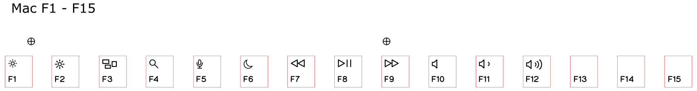

Here is the Apple/Mac F1-F15 set, updated as requested to be similar to the latest Mac design:
Apple-Mac F1-F15.PNG (33.37 KiB) Viewed 146379 times

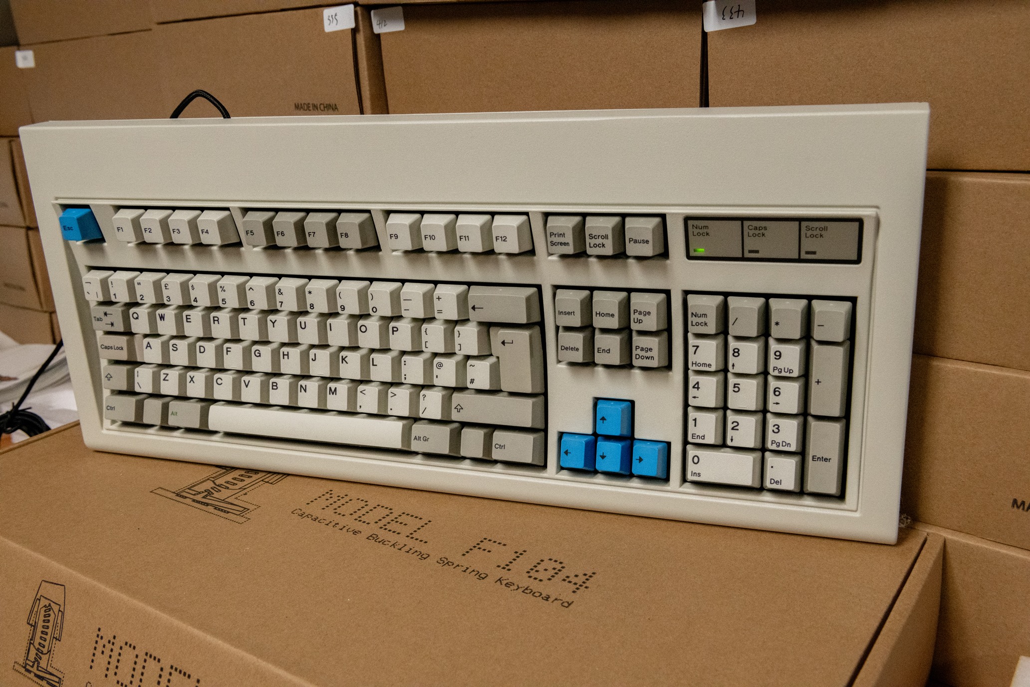

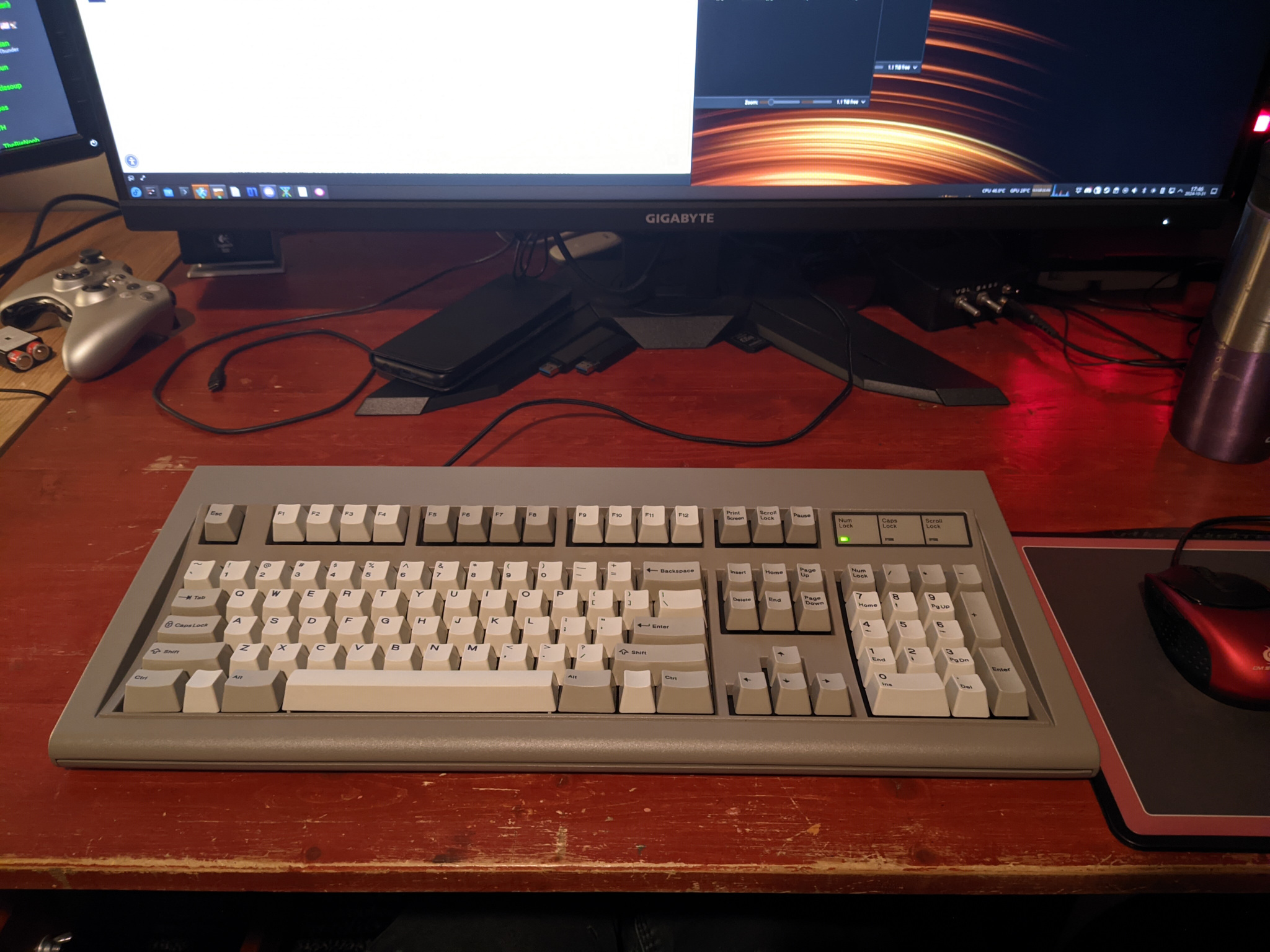

Hurrah, got my F104!
Mostly good news, I still need to fiddle with some things a bit more, I think. Not really sure what to do exactly with one of my extra ` keys. I'd make it a dedicated compose key, but sadly that cap is 1.5U only. Maybe I can put a sticker on a blank cap, I just need to get the sticker first…
Ellipse
12 Nov 2024, 20:39
Glad your keyboard arrived safely RainehDaze! That is a nice custom setup with the spring logo keys and HHKB style layout!

The Chyrosran22 keyboard has now shipped! Below is a photo of this keyboard. Chyros has a beige UK ISO F104 keyboard with a solenoid, some keys from the Mopar Blue addon set, stepped Caps Lock, and the Model M-specific add-on keys Tab, Print Screen, and Pause/Break.

Current factory set Fn keys:
Hold down Fn+Spacebar+
T–>Toggle the Solenoid On/Off Any key HPT_TOG
+= Increase Solenoid dwell time HPT_DWLI
-_ Decrease Solenoid dwell time HPT_DWLD
E–>EEPROM Reset
R–>Reset (enter bootloader)
D–>Debug
Hold down the keys Fn+
Esc–>Power
F1–>Brightness Down
F2–>Brightness Up
F6–>Media Stop
F7–>Media Prev
F8–>Media Play
F9–>Media Next
F10–>Media Mute
F11–>Vol Down
F12–>Vol Up
Print Screen–>Eject
