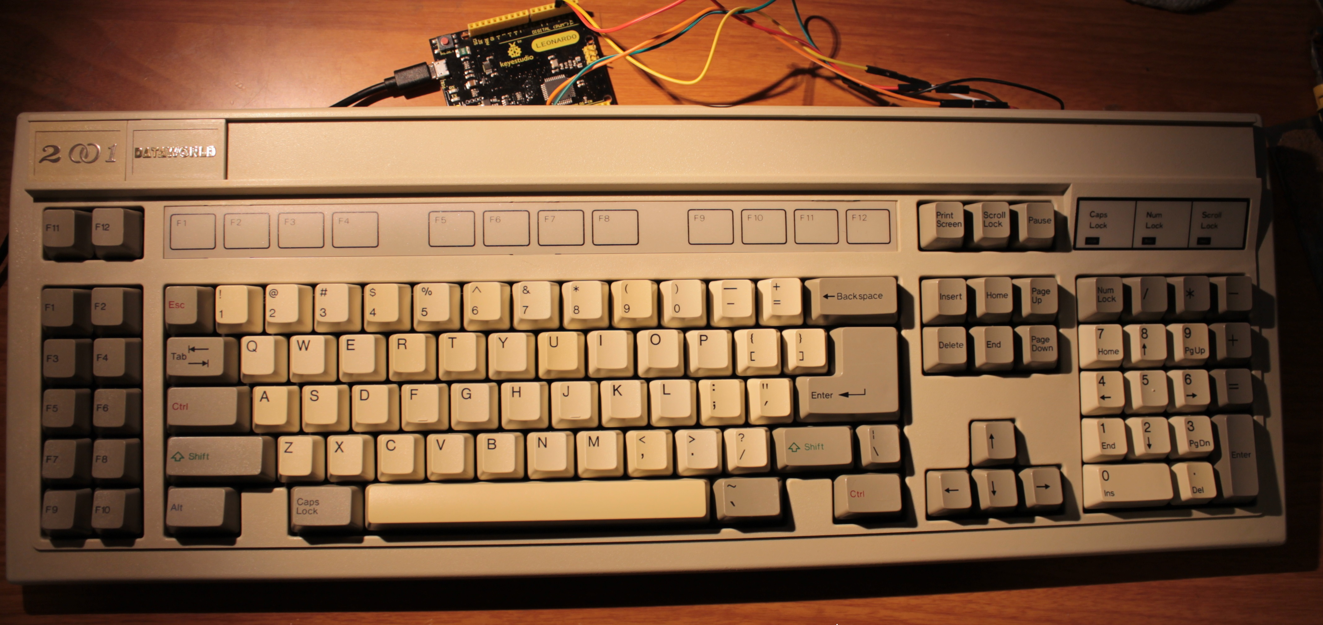

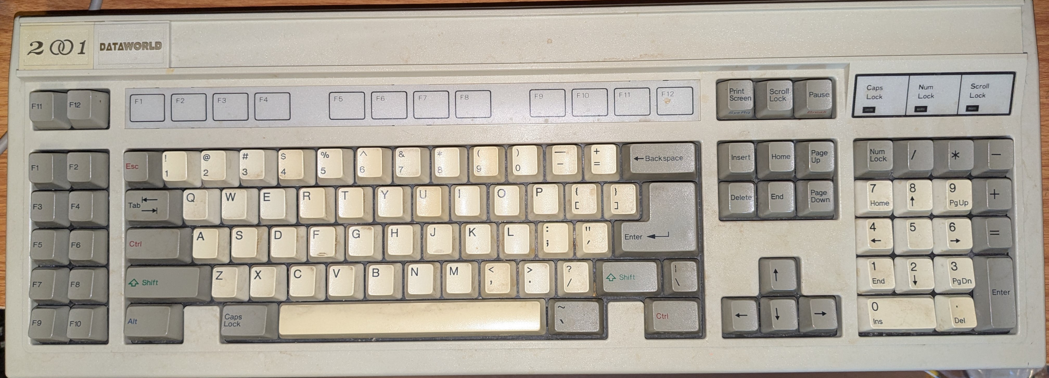

I "inherited" (read: found in a closet) this beauty from my dad, who bought it some 34 years ago. White Alps
. Wasn't nearly as clean when I got it, though. Also, my first mechanical keyboard!

Wow, nice! Looks like a rebadged Gen1 Northgate 102. It sure isn't like any Focus FK-2001 (which used that style badge) that I've ever seen. Any labels on the bottom side that would tell us more?
Just the serial number, the inside says both "Omni-102" and "Omni/101A," along with a Focus sticker stating it was "OK" and manufactured in 1990/7/4.
- Polecat
Thank you. The reason I'm asking is because there are some mystery Gen1 102 keyboards that seem to have been built in 1990, after Northgate came out with the Gen2 models. Those seem to have had no Northgate labels or branding, and were probably sold under another brand name. The serial numbers on these do not use the normal Northgate format. Instead they have a 7 digit serial number beginning with 100, 101, or 102.
Yours is the first one of these (assuming it *is* one of these) I've seen with any kind of badging, and I'm wondering if the Dataworld and 2001 badges came there, or were added later? I've been trying to solve the mystery of how these were branded and sold for some time now.
joshstevens wrote: 22 Dec 2024, 05:20 Just the serial number, the inside says both "Omni-102" and "Omni/101A," along with a Focus sticker stating it was "OK" and manufactured in 1990/7/4.

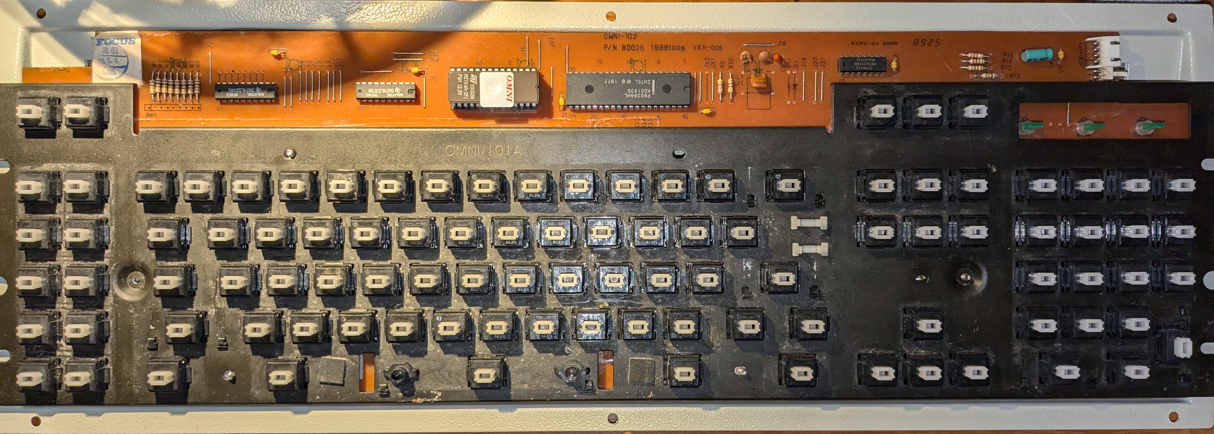

Here's the bare PCB, in case you can make any sense of it. I've cleaned it after this image, thankfully! The Dataworld badge can come off, but the 2001 is either just on there or glued on very tight.
- Polecat
Thanks again. The PC board is the same as the gold label 102 models. I have one of the generic ones myself, also with a Focus label inside. But mine, along with the others I've seen, has no branding at all, just a blank recess where a badge would normally go. No sign of glue or removal marks. One seller of a blank example said his came that way. I have 6 of these on record out of almost 900 Northgates in the database.
Here's an old post with a photo of the bottom side of a generic model. (second photo) This style label is sometimes seen on non-U.S. Focus keyboards, and the serial number falls into one of the Focus formats. We know Focus built the Gen1 Northgates, but these generic 102 boards are still a mystery.

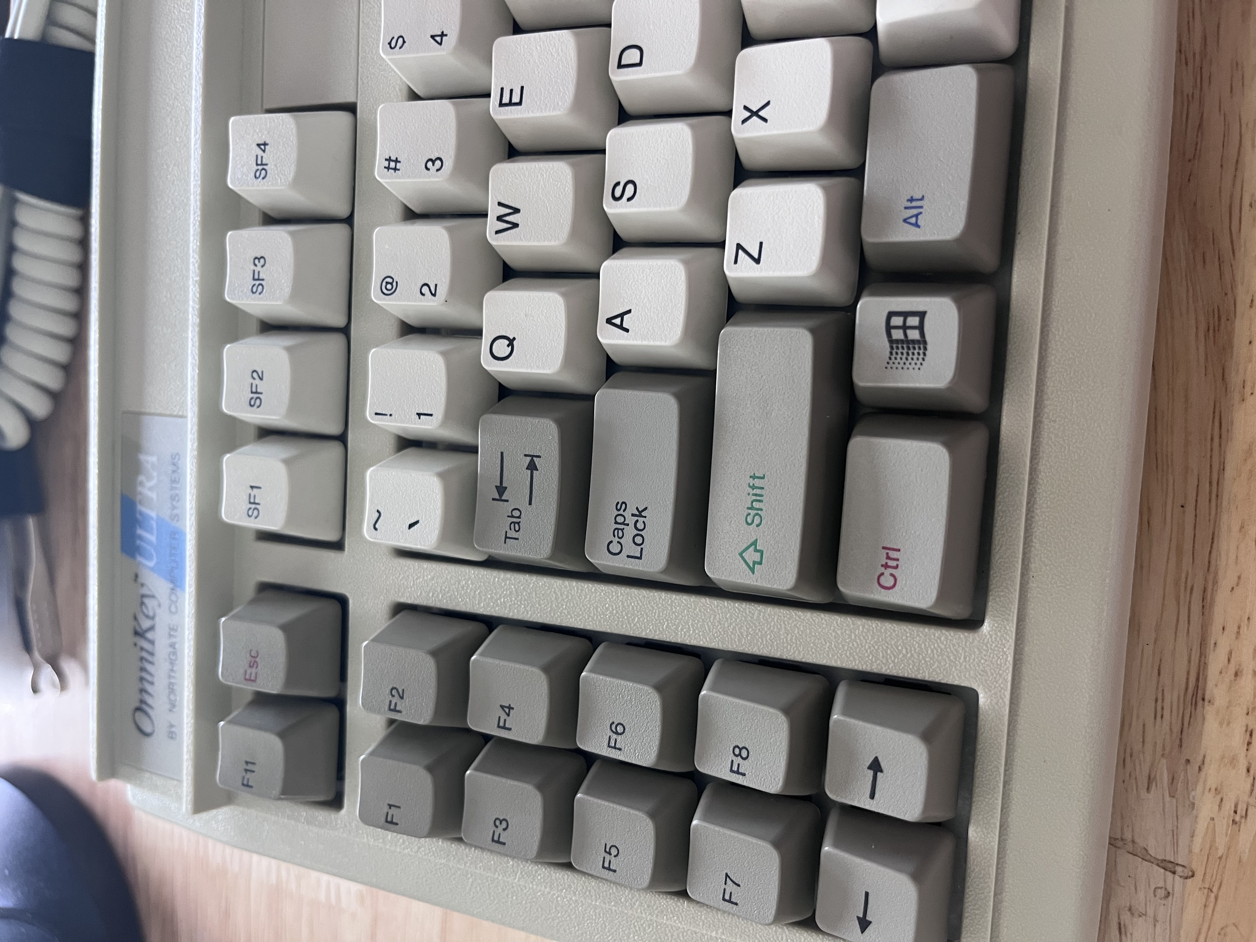

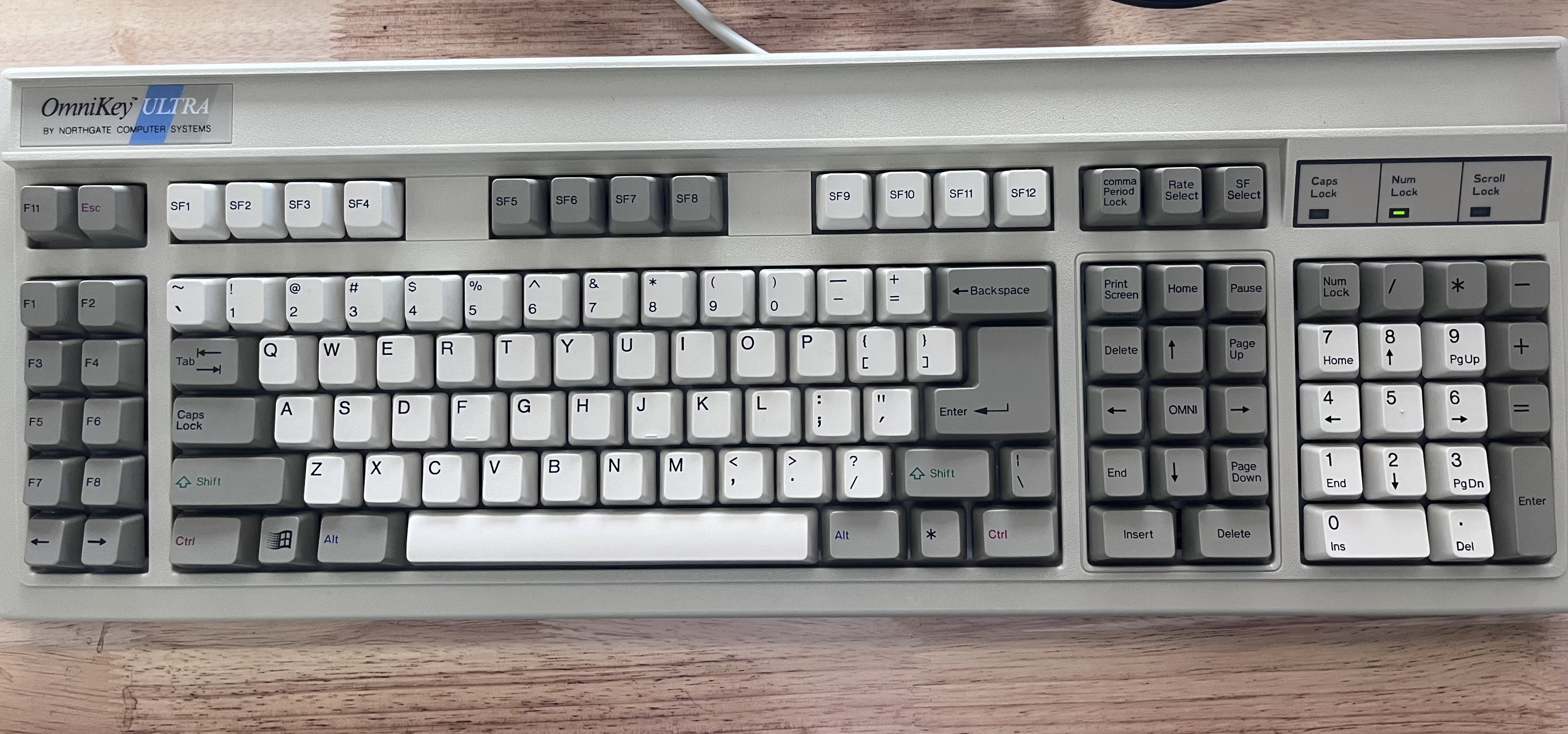

Wanted to show off my Omnikey Ultra with remapped keys. I recently purchased for a comparatively low price and was shocked at how pristine it was (other than an F1 key switch which had completely shattered and replaced from a donor) I pulled the implanted keycaps off an Omnikey 101P I am in the process of restoring (hence the windows key). As this is now my daily driver, I wanted it to be as functional as possible.

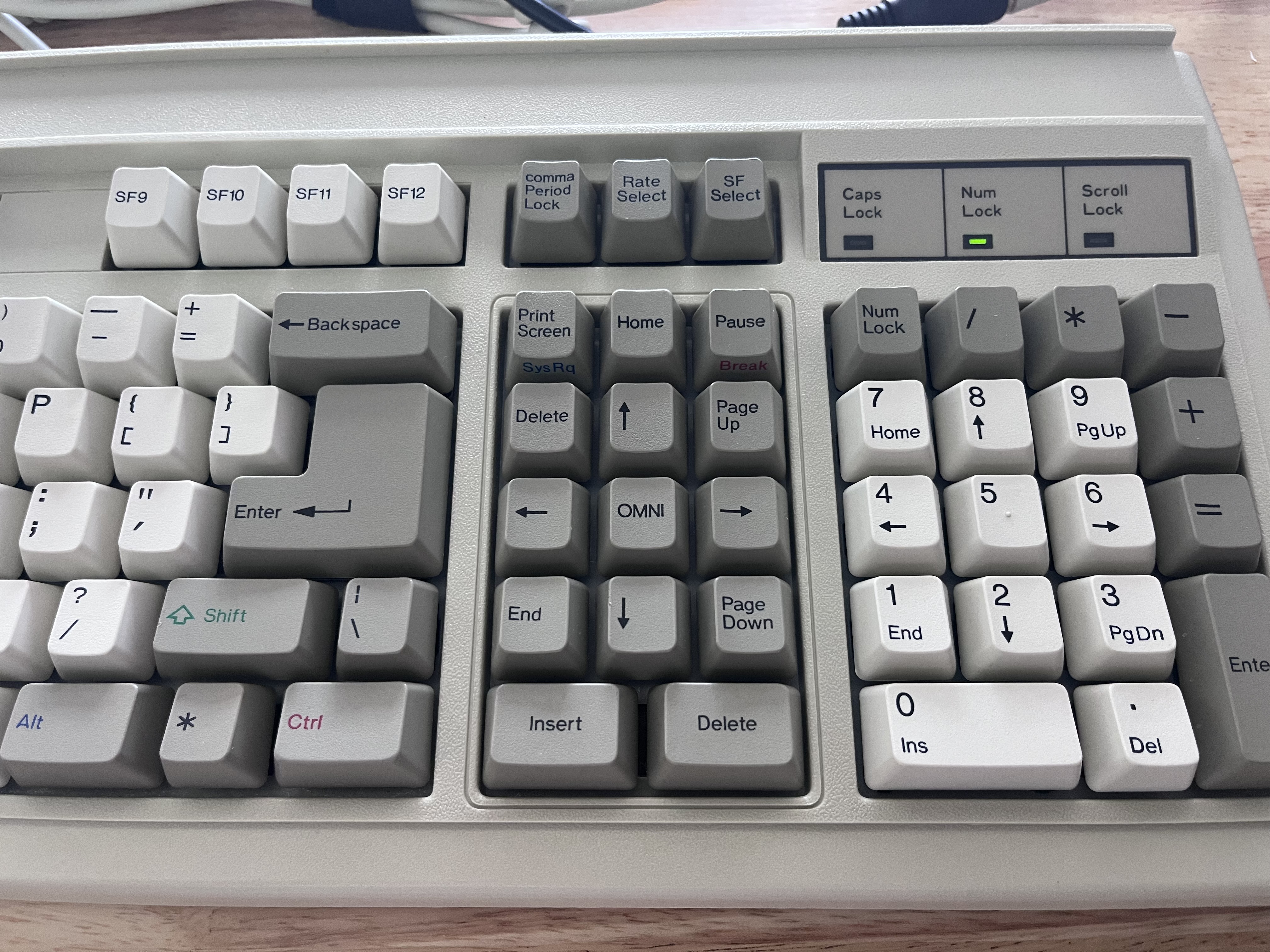

What does the OMNI key on the ULTRA "F" model do in Windows?
I've made a replacement PCB for the gen 2 OmniKey's that replaces the existing controller PCB, which is a separate PCB from the key matrix on the gen 2 boards, and supports USB-C and runs QMK/VIA. I'm trying to replicate how the original FW worked as much as I can in QMK.
So there's that OMNI key in the middle of the nav pad. In AT code set 2, it sends the untranslated scan codes e0 73, which is translated to e0 4c. There's a typo in the manuals, where the code it listed as 72 instead of 73. In both the gen2 and gen3 manuals, they never fixed it.
The code e0 4c is the extended key prefix, e0, followed by the code for num pad "5". That totally make sense, as all the new nav keys in AT protocol generated a scan code of e0 + the code for the matching num pad key. IBM did that for software compatibility.
So what does anything from the last forty years do with the scan code e0 4c? IIRC, it never did anything in DOS. Some games saw it as num pad 5 and some just didn't see it at all.
The Linux atkbd driver maps that code to 112, which is a key named "Macro". Which is an odd choice, as I don't think many keyboards actually had such a key. Xorg doesn't have any key assigned to that by default, so it becomes "NoSymbol".
There's no keycode in USB HID that is named "Macro" and the Linux USB HID driver doesn't have any code which it will map to 112/macro. So there's no way to replicate the Linux AT keyboard behavior in USB with default settings. But Linux lets you add custom mappings for vendor specific USB HID codes and this can be used to make it appear as Macro. The keyboard hwdb file has a whole bunch of custom mappings, mostly for laptops, and none of them make use of key 112/"macro".
So the best I could come up with, for Linux, was to give the OMNI key the custom USB HID code of 7 00 cc. That's in the vendor reserved range, so it doesn't map to anything by default. I picked 0xcc because the AT code was extended prefix + 0x4c, and the atkbd driver adds 0x80 for extended keys, so it was 0x4c + 0x80 = 0xcc in the atkbd driver. A custom hwdb entry can then map it to Macro so it acts like it did in the AT interface.
But what does Windows do? I don't use Window myself. I found a link to an old MS document in the TMK docs and it lists every possible AT code set 2 key, including e0 4c, and it that code is "UNASSIGNED" in the USB HID column. So my guess is it does nothing in Windows?
