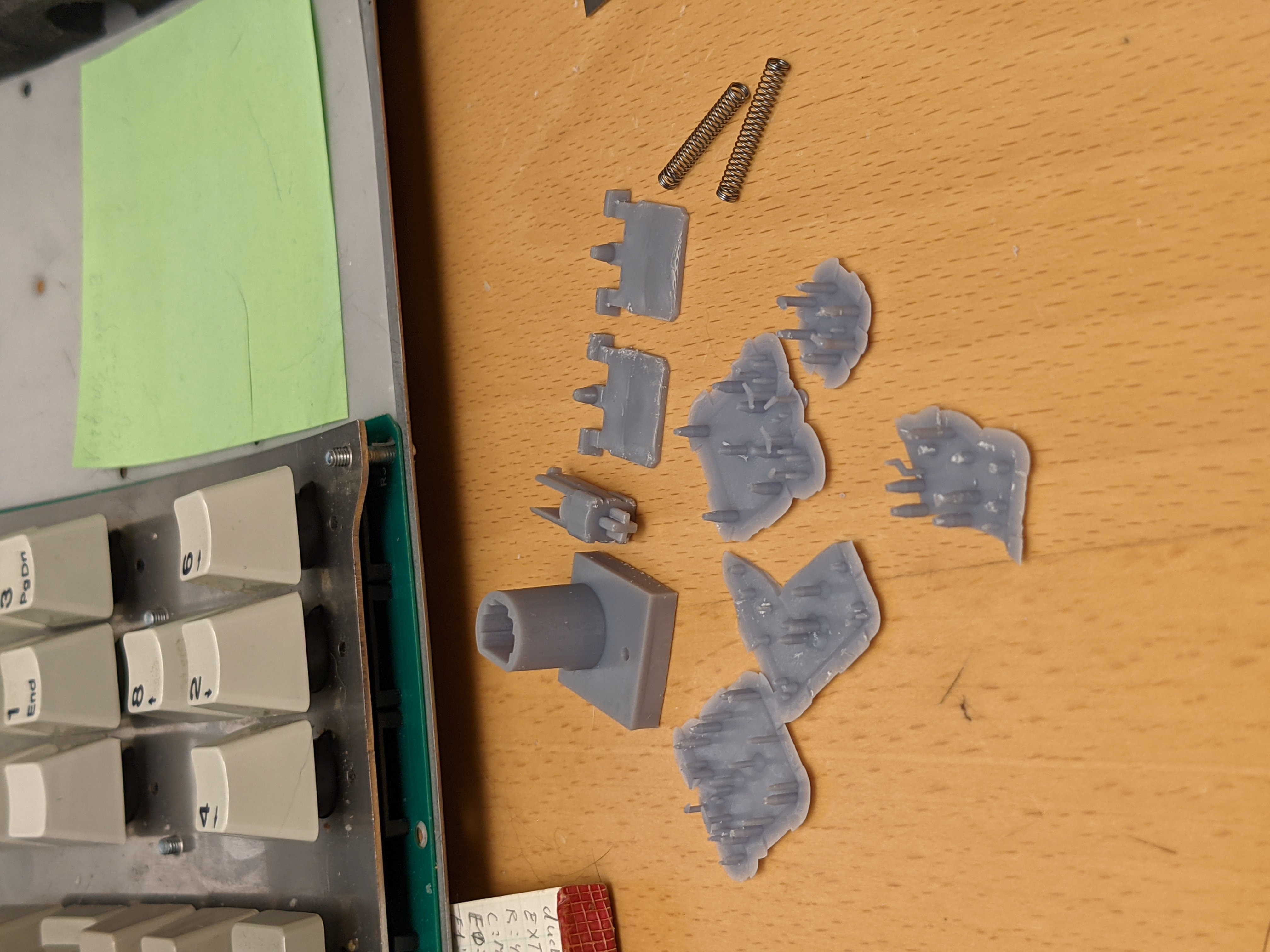

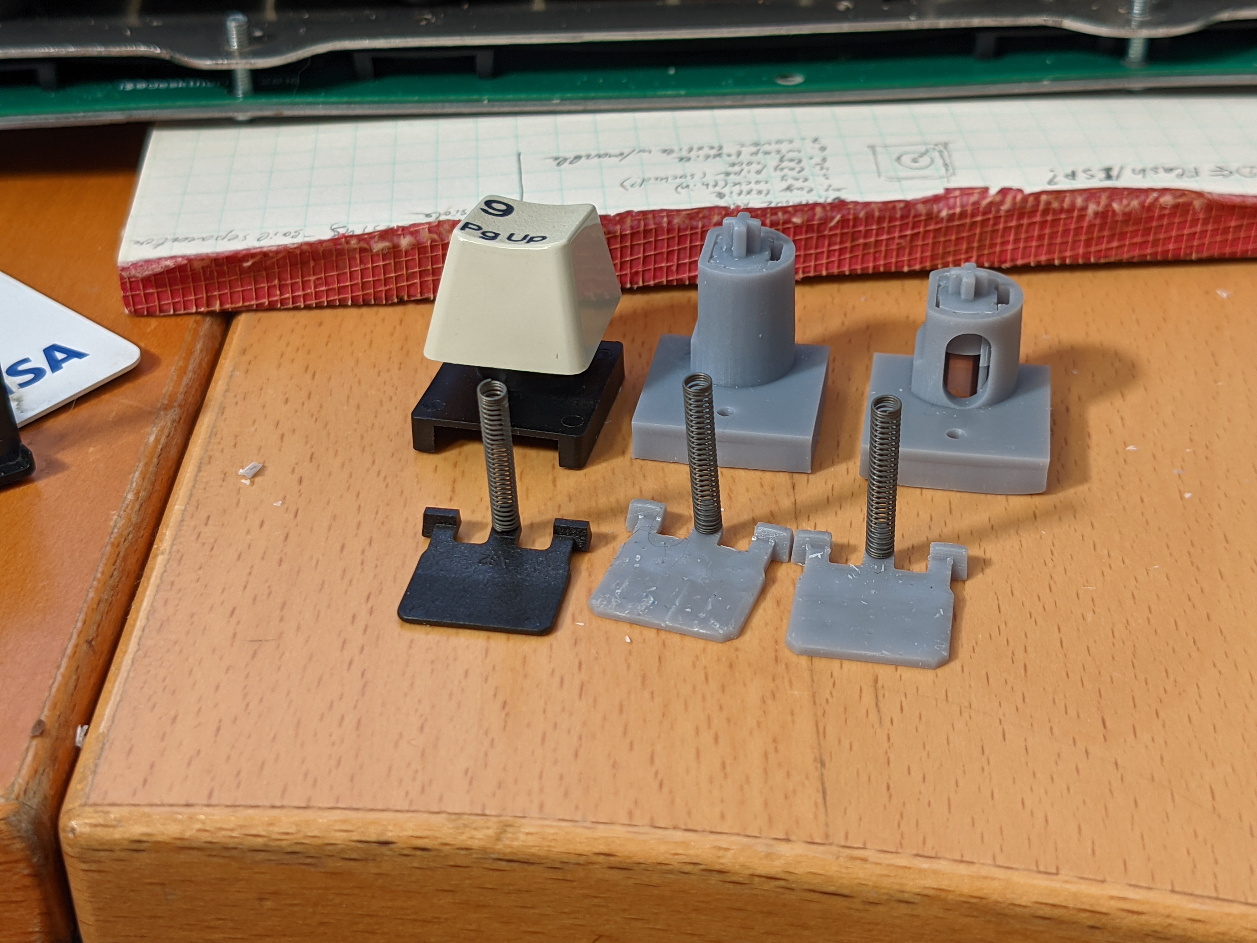

Current issue list:
  1. Stem barely fits into the barrel. It does fit into OG barrel pretty OK - not too wobbly, not too tight - but it's too tight with printed barrel.
    This is likely overexposure (I accidentally printed with 2.0s exposure, not 1.9s that I found ideal yesterday).
    Also, due to layers perpendicular to Z-axis, printed-stem-on-printed-barrel produces funny buzzing sound. There _is_ some binding, but surprisingly little.
  2. It clicks. Once. Doesn't return to original position.
    It does return to original position with printed stem. Sound and feel are pretty close to original, less pingy.
    It also kind of returns to original position with printed flippers - they do go up, but sound after the first click becomes pretty quiet AND it looks like the spring doesn't "unbuckle" into straight configuration.
    So it looks like it's both spring upper point is little bit too low, and spring lower point is a little bit too high.
  3. spring holders are a bit too large, had to file some plastic off. Could also be overexposure.
  4. Unlike Cheap Chinese Copies, one doesn't need to pay attention how stem is inserted into the barrel - the spring finds it's way onto the in-barrel catch automatically. I'm quite proud of solving that.
Turns out I don't even need rafts - landing bare supports onto build plate should be enough (they will be held in place by elephant's foot) - but I need a bit more supports to prevent sagging of large overhangs.
Also, I already bought some transclusent ABS-like resin, but I just understood I can simply cut windows into model instead - it's not injection molding, I can cut windows wherever I please _before_ printing, not after. Transclusent stuff should definitely help bringing more light in though.
Not sure if I should preserve those first prototypes for some museum - or even for the future shop LOL. "One in Stock! Brand New in Box FSF Barrel And Flipper Prototypes, part 101 or 102"

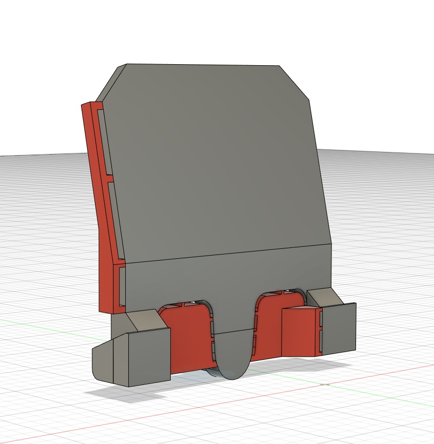

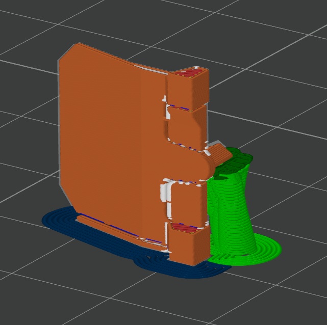

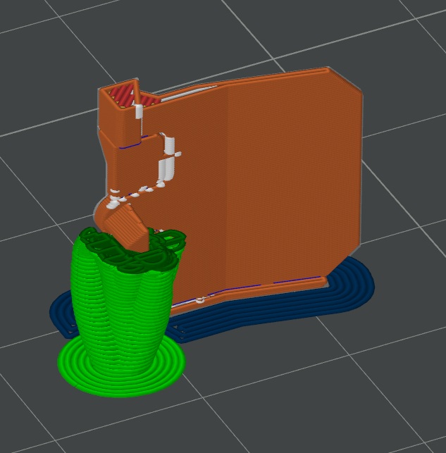

It looks to me that you can modify the flipper model so that it is printable in vertical position without support. Align the two side-tabs and the spring holder to one plane which will be touching the build plate when printing. Print vertically. This way you can also print much more tabs at once.
You can cut about 20% (along the cylinder axis) from the cylindrical spring holder so that you can put it on the build plate with this cut. Modify the side tabs so that they end in the same plane as the cylindrical spring holder cut.
You can print at least 30° overhang quite easily. 0° overhang being vertical. Using this overhang should be enough to get the axis of ration at the proper places even when the side tabs and the spring holder pin are modified.

vvp wrote: 01 Feb 2025, 12:29 It looks to me that you can modify the flipper model so that it is printable in vertical position without support.
That's easy - just rotating the model 90 degrees will do. Some supports will still be needed (because 0.35mm will be squashed and elephant-footed, and I want to actually use the final model for the injection molding without gross modifications), but way less plastic will be wasted. However, I'm not at the stage of mass printing yet (and hopefully never be - injection molding is just better), and printing the flipper bottom parallel to XY plane has it's advantages (like, it's actually flat when printed, not micro-grooved. I'll try to print a copy in vertical position as a part of the next batch - not yet gotten there between oncologist visit and other errands).

I accidentally silent buckling spring. Sadly, it's LINEAR.
Turns out, tactility turns out to be generated by flipper dropping on PCB and vibrating the hell out of the whole mechanism.
You may notice there's a window where the spring SUPPOSEDLY hits the barrel. SURPRISE, that doesn't affect the sound that much - OG flipper clicks quite loudly, 7-degree and 5-degree flippers barely produce any sound. So, the "spring hits the barrel makes model F loud" hypothesis can be safely retired.
As you can also see, I was able to chop 3mm off the barrel and stem. This still makes the barrel 15mm high, 3.4mm higher than MX switch - meaning, in turn, that using existing MX keyboard cases will not be possible without shortening the spring.

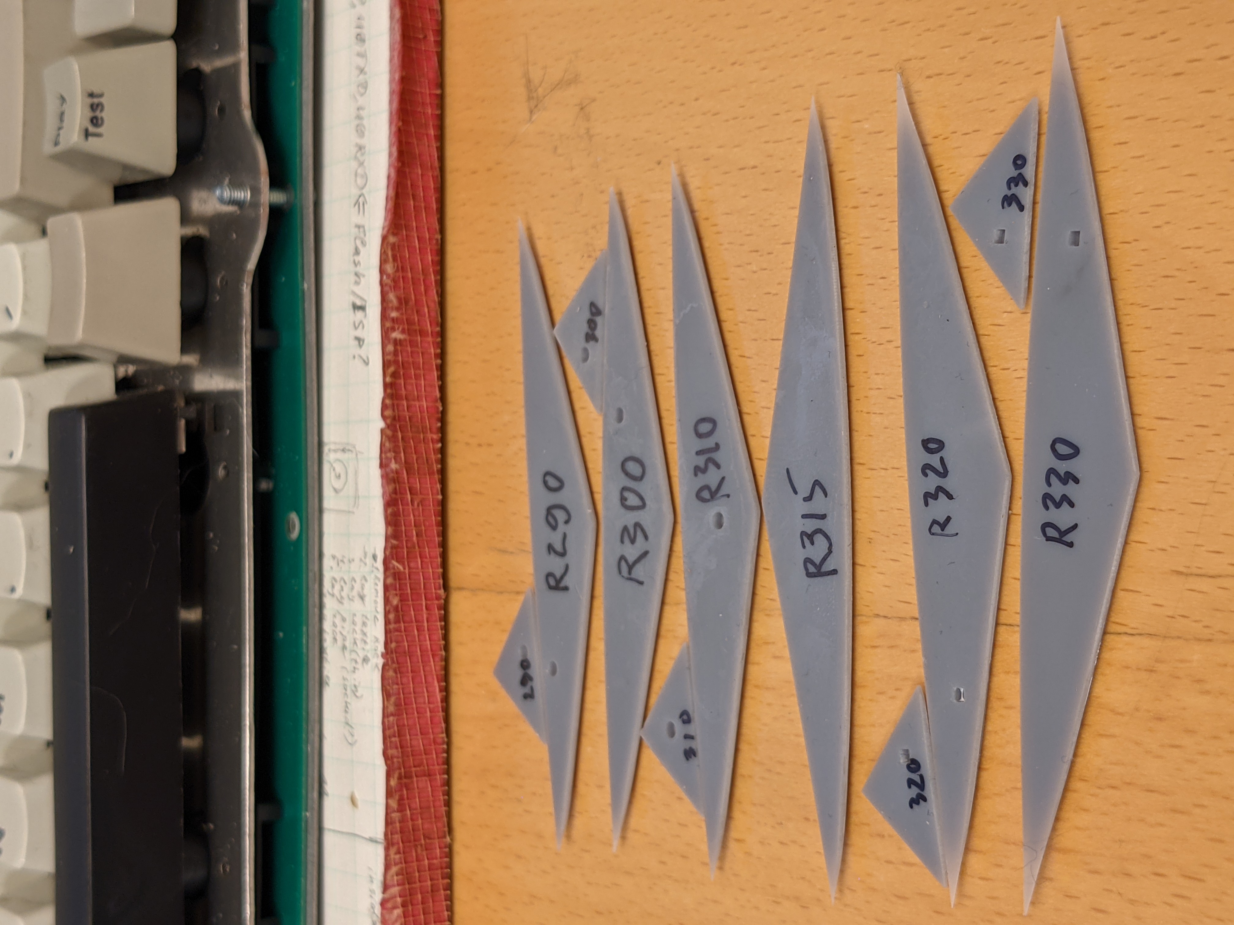

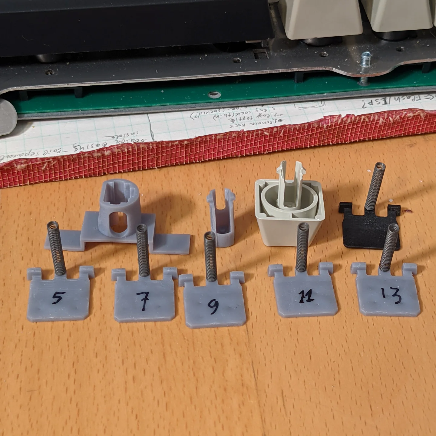

Batch 3 was ruined by washing in the hot water on internet advice. So here's batch 4:
numbers are elevation at rest, in degrees.
5 is whisper-quiet, but also almost linear feel. The spring is buckling, don't get me wrong, but almost imperceptible, even with original barrel+stem. Rarely: flipper goes down before spring buckles.
7 is the weirdest of them all - flipper frequently goes down before the spring buckles. Also very quiet.
9 tends to stick pressed.
11 - half as loud on downstroke, upstroke is still silent.
13 - probably 75% loud, upstroke probably half as loud (but still quieter than downstroke - originals are louder on upstroke if you're not MASHING it)
Looks like I need to look more closely to the feet part - looks like even 0.1mm difference in spring height matters.
Almost dialed in interchangeability of barrels and stems with IBM barrels/stems - not that they'll be used together, mostly to be able to tell they'll actually fit together.
Also, in light of the barrelgate, looked more closely on model M barrels from Unicomp. They definitely put some effort into not having parting lines where stem can contact them!

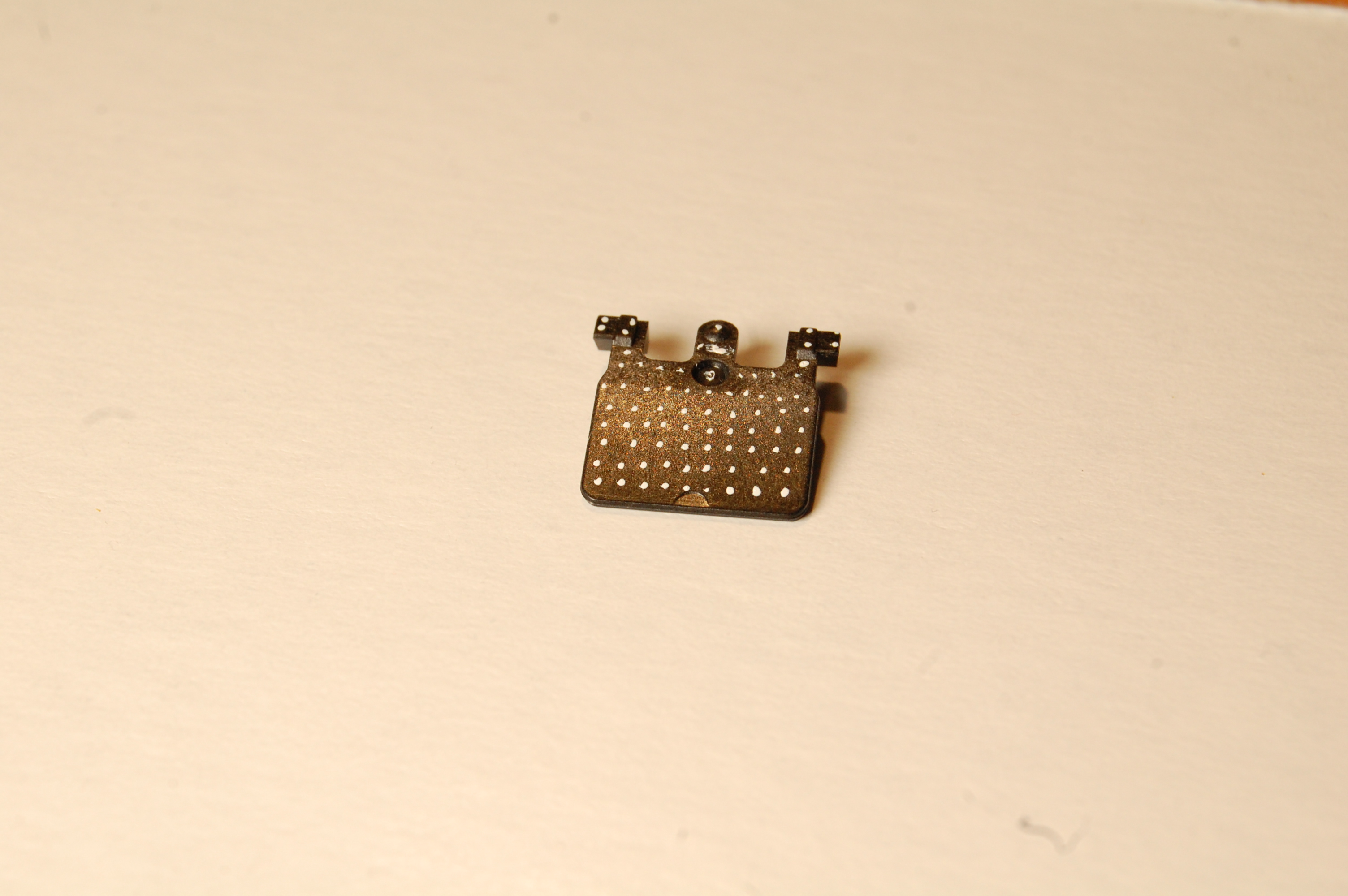

I must report success !!

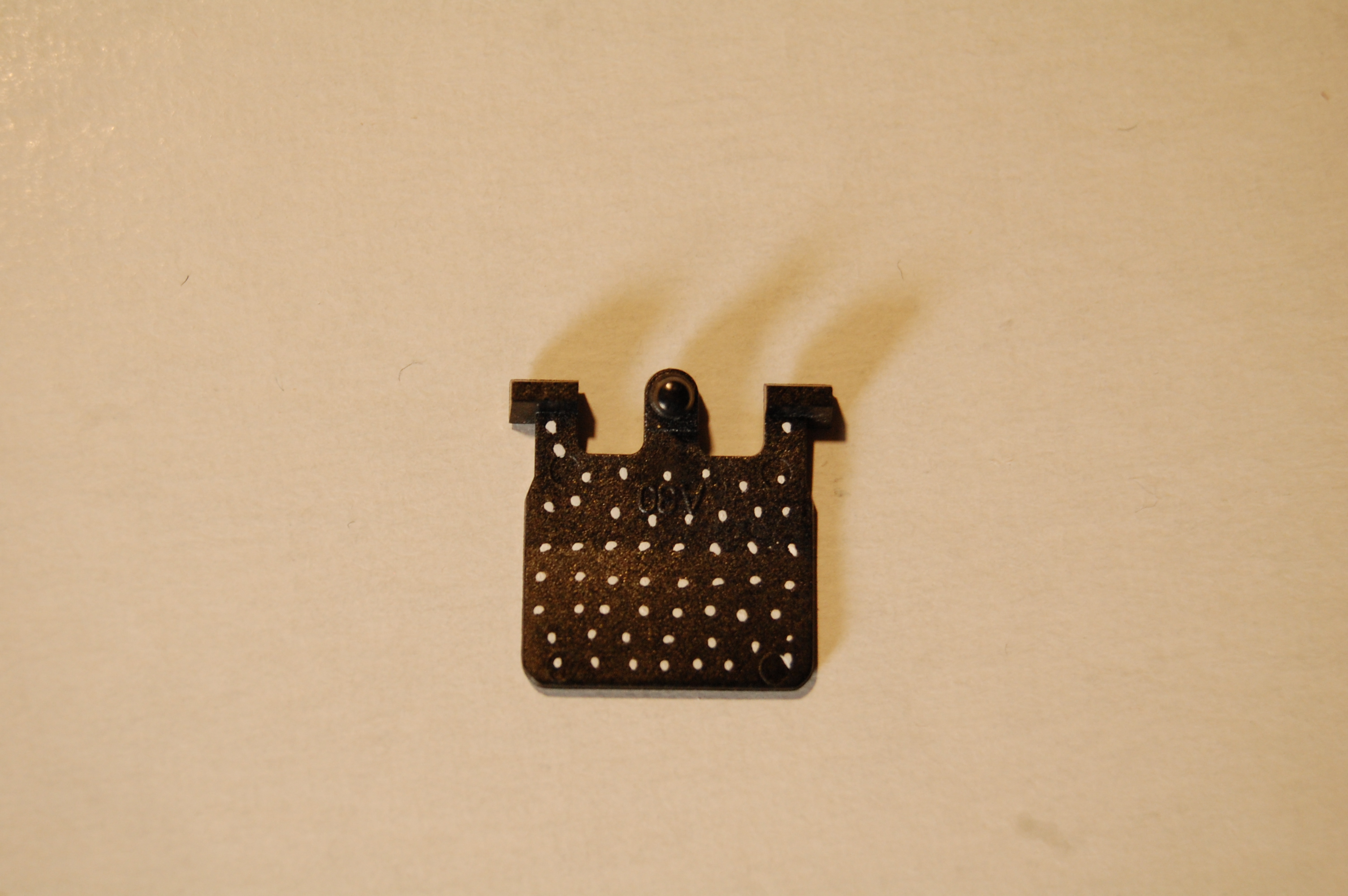

I have been silently working on the 3d printed flippers using the conductive filament which I bought in amazon: EONO Electrically Conductive PLA Filament
Flipper 11.jpg (122.26 KiB) Viewed 17197 times

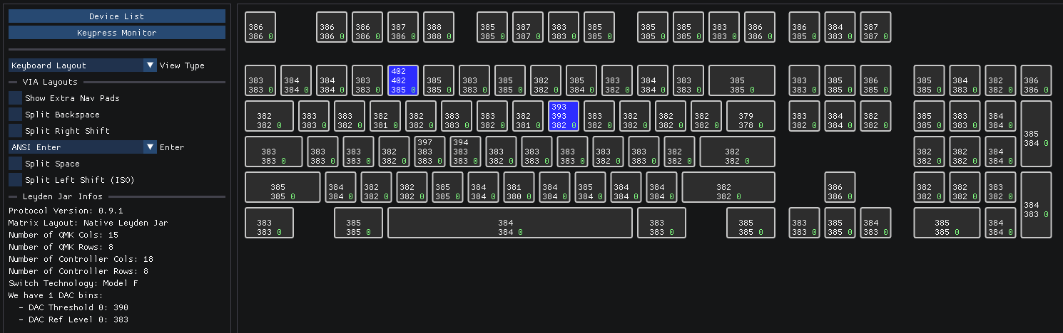

This is literally the first text which I am typing using a regular model m, using the FEXT PCB, a Leiden Jar and my 3d printed flippers using conductive filament.
The keyboard which I have used has a particularly bad barrel plate. This was a very bad decision as it has taken me long to ensure that all the keys register properly. I believe that now that we know that it can flippers can be 3d printed, the next step is to replace the original ones which I am using in my FSSK :)
These flippers are less conductive than the original ones. I had to reduce the threshold in the Leyden Jar firmware. I am typing with activation offset of 7 (instead of the 20 which I have been using with my "regular" FSSK.

Printing the complete keyboard was less than 3 hours.
I had print the flippers lying on one side, to ensure that the spring pressure is done along with the layers, so it does not break. In order to print efficiently, I designed my own support in the 3d model.

idollar wrote: 14 Feb 2025, 01:29 These flippers are less conductive than the original ones. I had to reduce the threshold in the Leyden Jar firmware. I am typing with activation offset of 7 (instead of the 20 which I have been using with my "regular" FSSK.
Congratulations! I specially approve of the extra step you took to print the spring support across the layers, not in parallel.
The "less conductive" part might be because OG flippers underside is actually not flat - it's a cylinder with some huge radius (I tried to figure out that radius from photogrammetry, but the photogrammetry effort failed miserably, so I'll try to deduce that radius from plain old photographs and counting pixels.), and your model appears to have a flat bottom.
Flat bottom over curved plate will result in a PCB contact patch being one or two narrow bands instead of a theoretically large rectangle with curved flipper.
There's no good way to compare - if you compare on a PCB laying flat on the table, printed flipper should get ahead, if inside actual keyboard - OG flippers should get ahead, and there's really no way to put them into "apples to apples" situation.

There's a thing called "3D pen" - which is basically handheld FDM printer extruder with a manually operated filament feeder. Should be ideal for this - with less burning plastic smell at least :)
idollar wrote: 14 Feb 2025, 08:16 The "less conductive" part might be because OG flippers underside is actually not flat
I wish to retract this. Spent couple hours today trying to make a high-res photo - which I actually made, see below - only to find out that that cylinder radius is HUGE and only noticeable in how light reflects from the bottom of the flipper, actual non-flatness is like 0.01mm over the flipper area
While I was writing this down, it occured to me that I actually have a resin 3d-printer with supposedly 16x24um horizontal resolution and so I can just print curvature gauges (because I have some idea about said curvature radius being around 300mm) and measure by simply putting two parts together and looking at it at magnification (being old sucks, damn presbiopia). Sure, not NIST-traceable, but should be good enough.
idollar wrote: 14 Feb 2025, 08:16 The resulting part is less conductive. It is a fact.
Original flippers are not conductive at all. Their surface resistance is >20MOhm/mm, that's well within insulator territory (I have a megohmmeter, but it's currently broken, so I can't currently measure more than 20MOhm.). Your filament is advertised at 7 ohms/cm - you can check actual resistance by sticking multimeter probes into it 1cm apart (and if it displays "O.L" - 1mm apart).
Lower levels might be because flipper's bottom surface isn't smooth enough - which can be rectified by sanding OR just sliding the flipper over the flat part of the iron at "wool" setting (careful about melting flipper legs and burning fingers!) - probably wrapping the flipper in tracing paper to prevent it sticking to the iron and melting completely.

This isn't really much of a problem with 3d-printing flipers for oneself. May be even considered a benefit, when stuff is too easy people don't value it that much :)
Seriously though - I would consider reducing cross-section of the points where support touches the part itself, and reducing overhangs - say, by making the part "v"-shaped where it contacts the support. Supports don't have to be thick, especially in FDM world.
PS: photogrammetry attempts made me semi-ruin one flipper (I think I'll be able to clean it, but..)

This is a set of convex and concave curvature gauges, R290 to R330. R315 is there because value calculated from the whole backplate gave me R315.
Turns out, the keyboard part (R2 to R6) is R310, and the upper part is >R330, may be >R400 - at least on my model M backplate. I have XT, AT and F122 backplates, but my lifting restrictions currently prevent me from accessing those. Expect more results in about two weeks.
Flipper also seems to be most closely matching R310 - so R310 is the golden value I guess (NOTE: that R310 arc must include the pivot point too!)

DMA wrote: 19 Feb 2025, 05:18 Turns out, the keyboard part (R2 to R6) is R310, and the upper part is >R330, may be >R400 - at least on my model M backplate. I have XT, AT and F122 backplates, but my lifting restrictions currently prevent me from accessing those. Expect more results in about two weeks.
Very clever movement DMA! Thanks for the information.

OK, I've got to measuring my fleet of Fs.
XT: R290
AT: R290
F122: bottom plate R290 (or slightly smaller), top plate even smaller than R290. NOTE: F122 is the only one that doesn't close with barrels not populated. So this is likely on purpose, to create more pressure in the middle of the plate.
Special guest: IBM 79F0167 AKA 5576-A01 AKA "Brother buckling spring".
flat in R1-R2 area, R290 in R3-R6 area. It _really_ looks like the bend starts under the center of the barrel of the TAB key. JDM is, as always, superior to everything else. It's, like, double-superior, because the bottom part of the case is curved inside to match the backplate, so that backplate rests on 3 "east-west" keyboard-wide rails.
