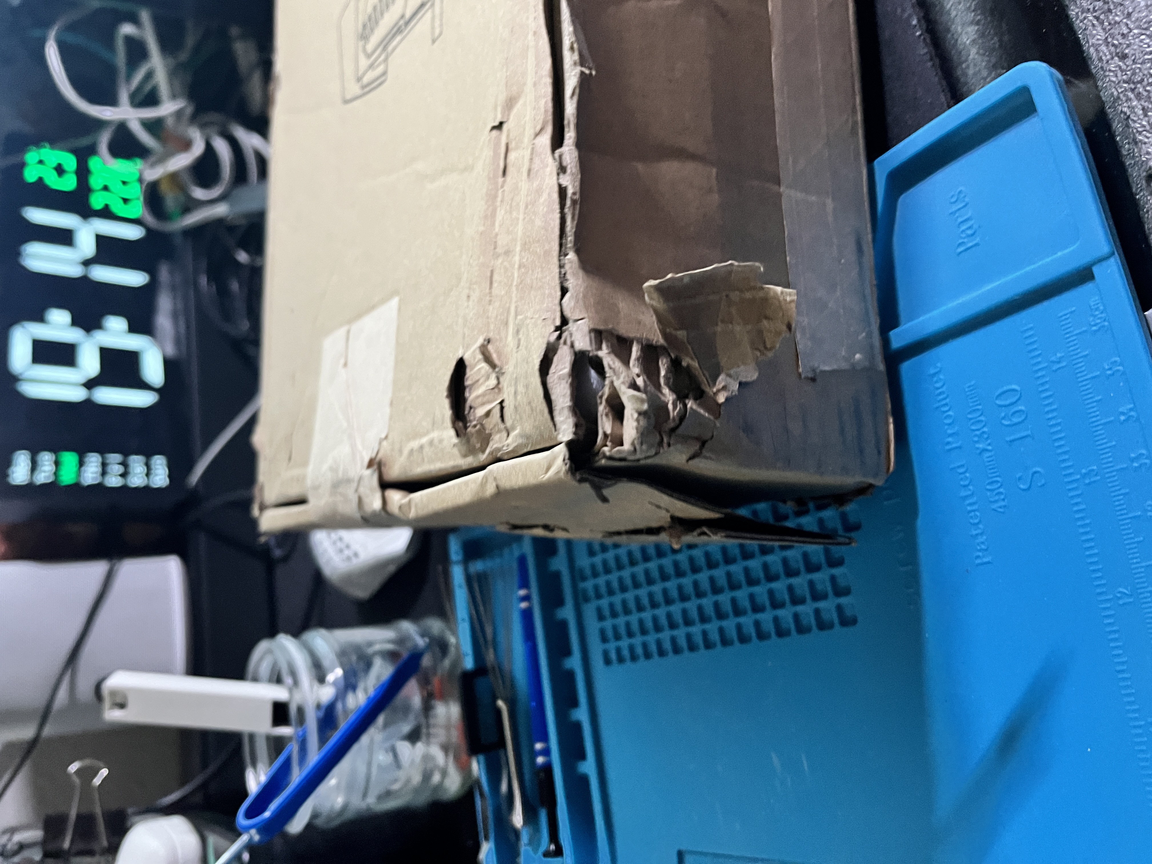

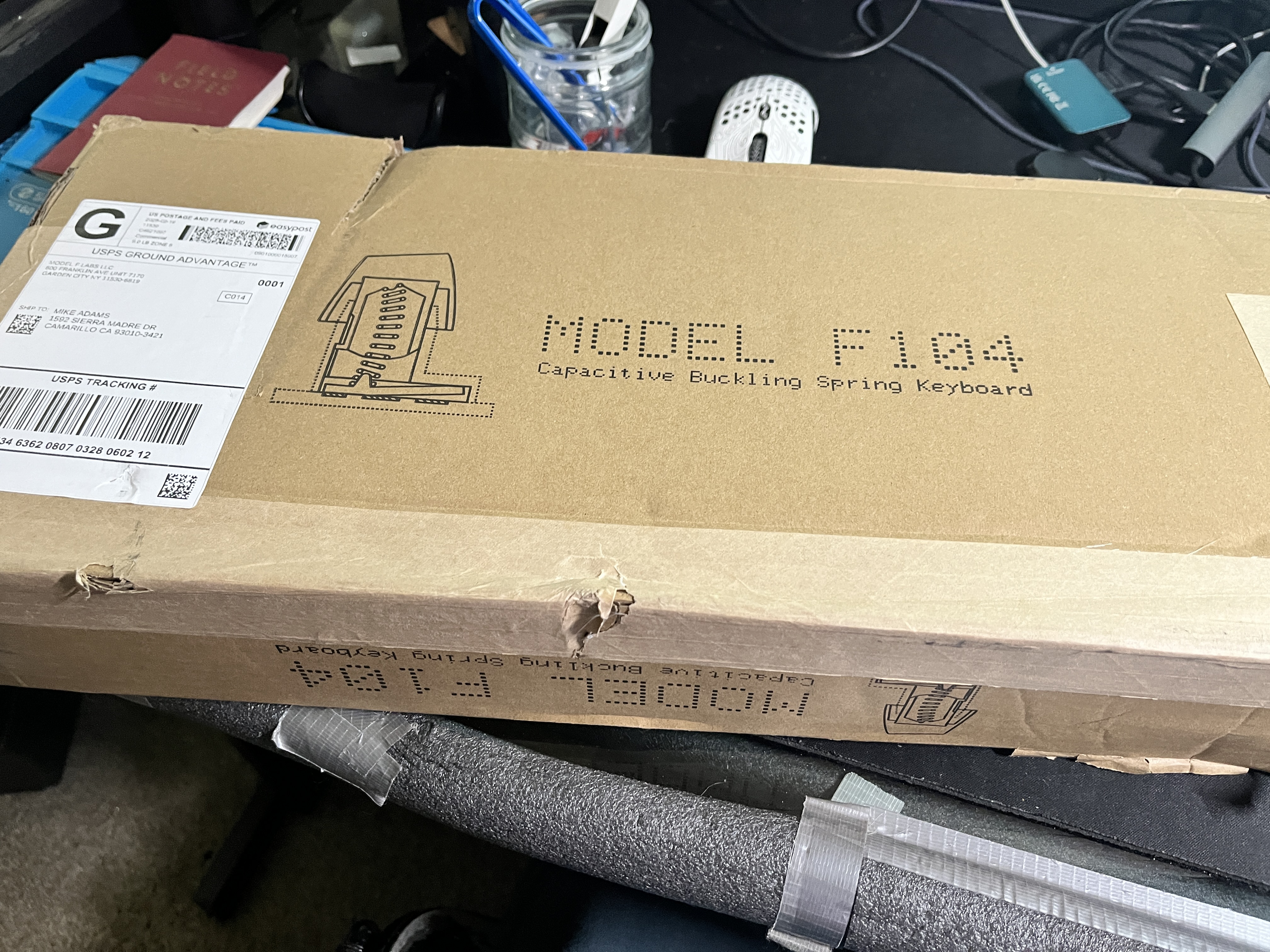

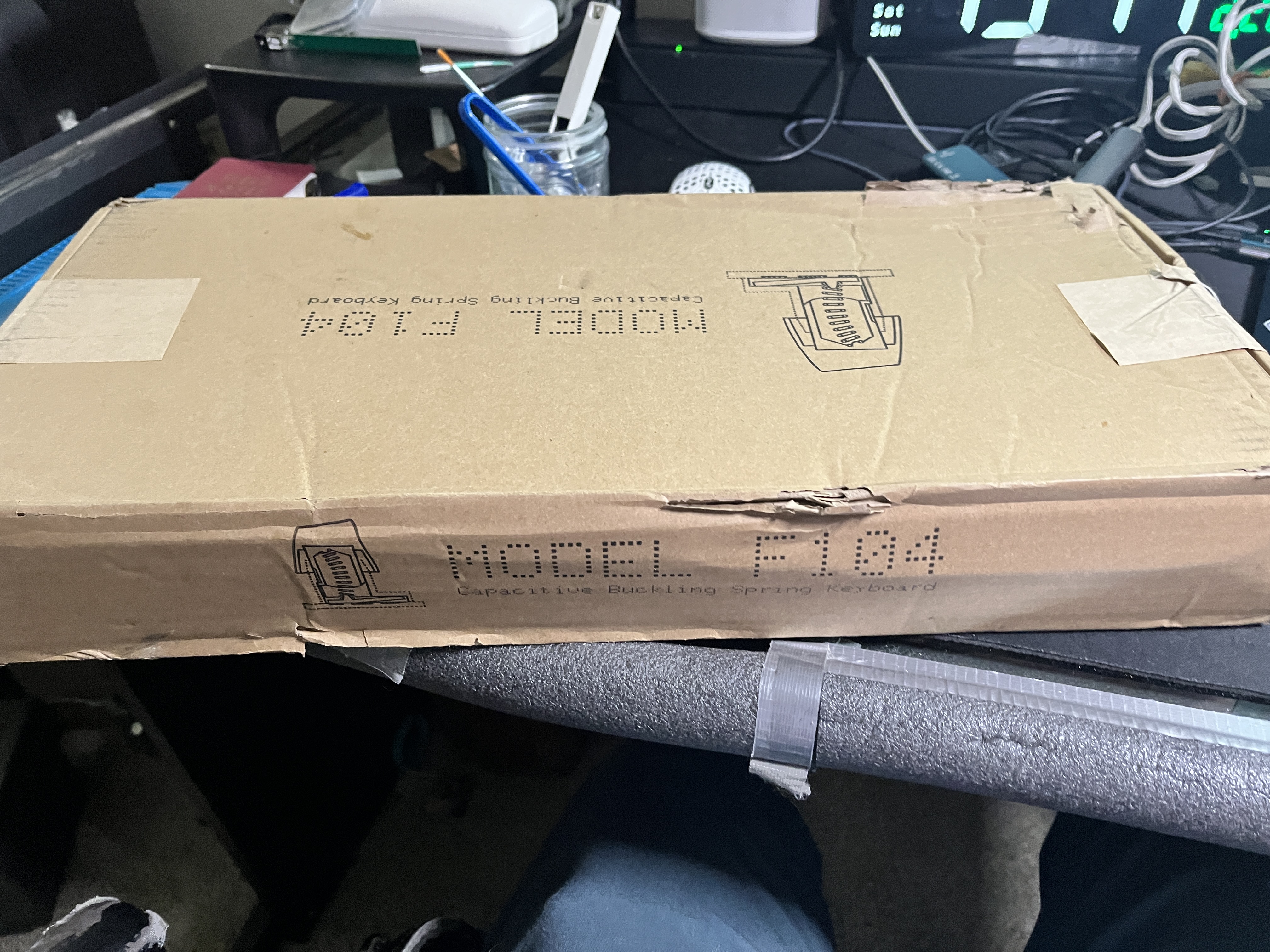

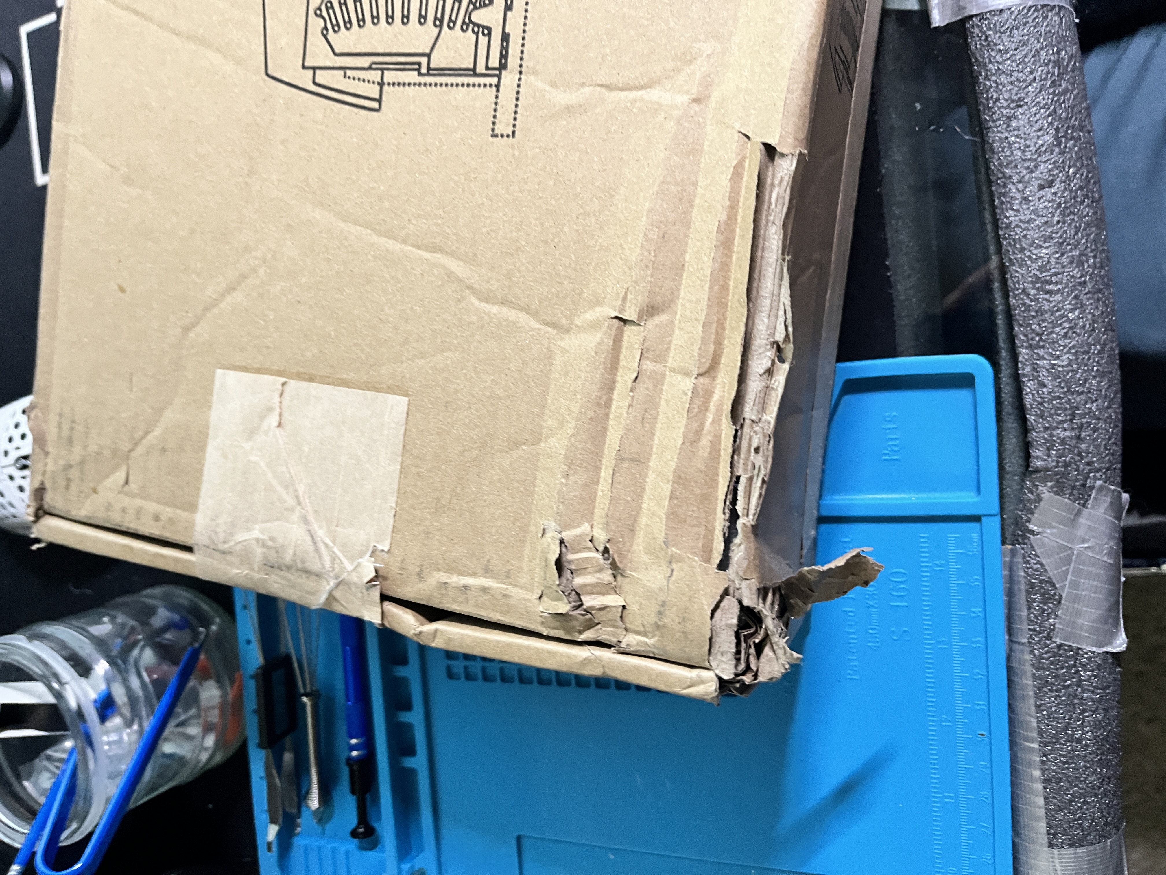

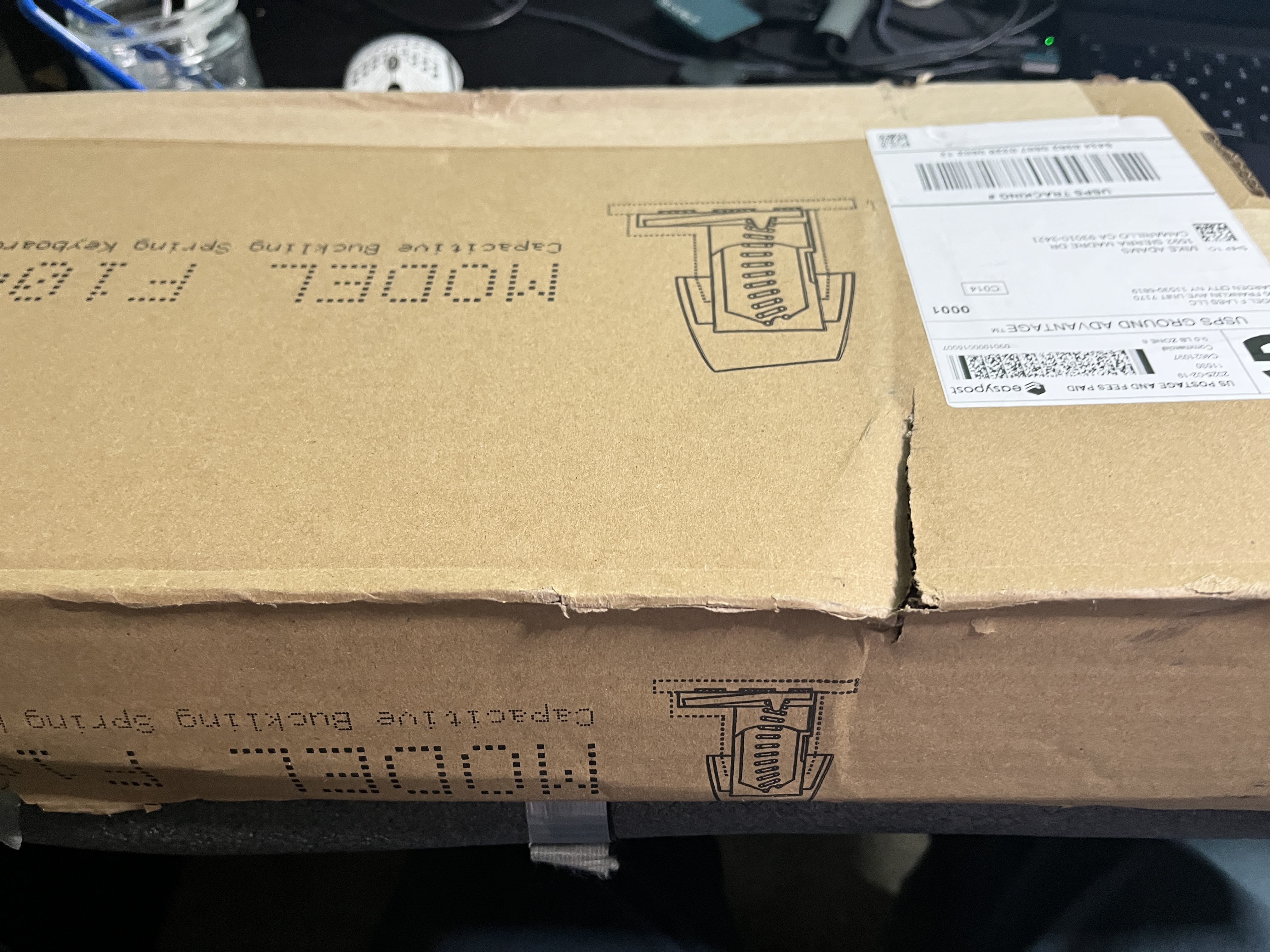

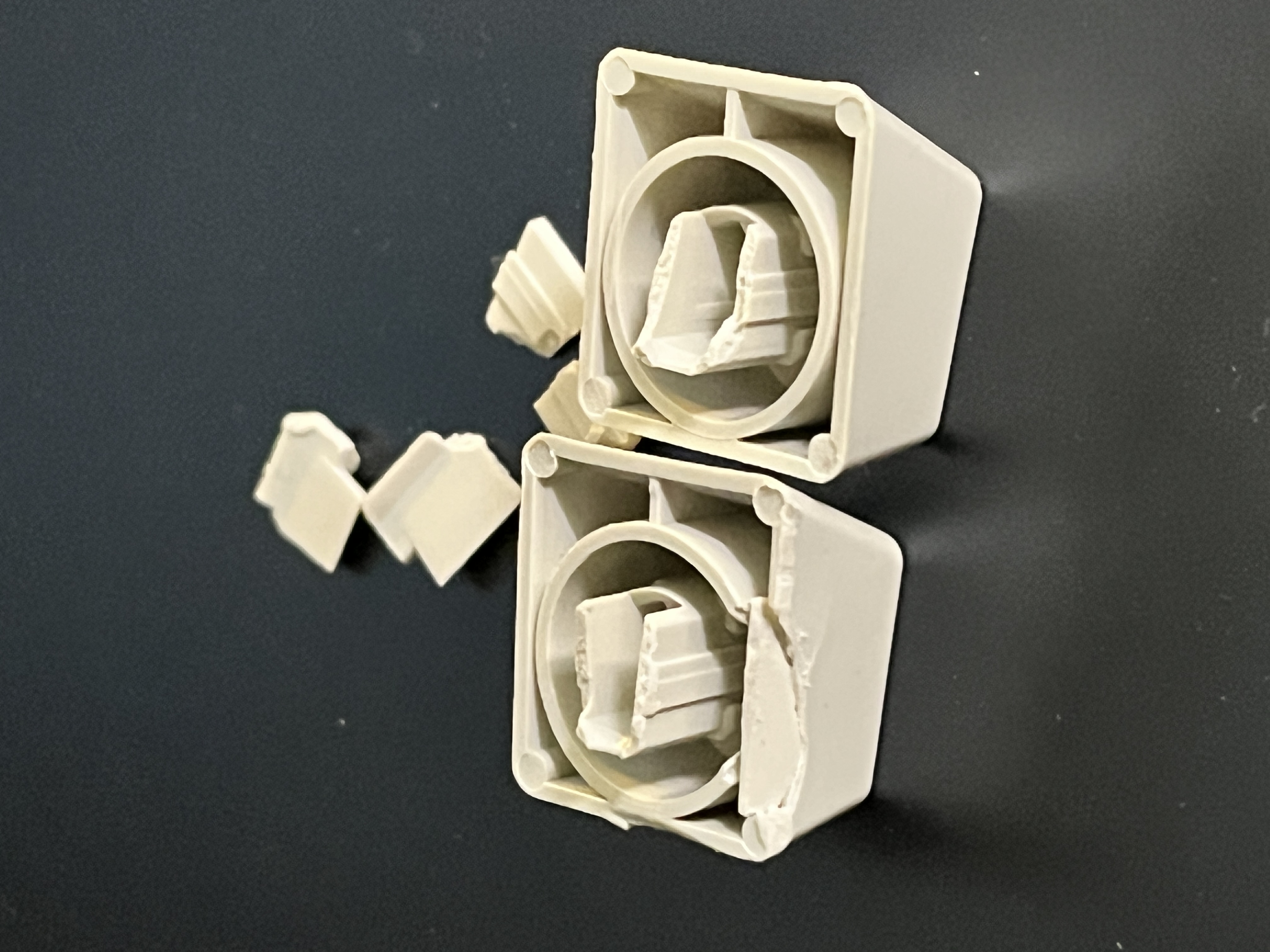

still don't have a working board and at this point I believe I need a replacement. so any suggestions? or did I just buy the brooklyn bridge? is that too much to ask>??? This is how it showed up and remember it was raining like crazy even in CA. Also I realized that when I purchased it was suppose to come with flippers and springs and on top of those I bought the kit. Website is now changed but thats what it said at the time of order. This is has been and is getting more and more ridiculous I just want to zen out in clicky nirvana.
- IMG_3162.jpeg (1.48 MiB) Viewed 1209 times
- IMG_3155.jpeg (3.65 MiB) Viewed 1209 times
- IMG_3151.jpeg (2.96 MiB) Viewed 1209 times
- IMG_3153.jpeg (3.36 MiB) Viewed 1209 times
- IMG_3150.jpeg (3.35 MiB) Viewed 1209 times
- IMG_3149.jpeg (2.62 MiB) Viewed 1209 times
Ellipse
Hello,
When we last spoke you asked me to wait for you to submit an order for additional parts which you noted that you'd definitely be ordering, and I would be mailing you free replacements for anything that was damaged in that same shipment. I checked my emails and received no such order from you that I can see. If this is a mistake and you did in fact place an order please follow up with me over email.
I will send you an email follow up from the last email I received from you, back in March, so that you can reply to me from there.
Please rest assured that I will send you free replacement parts, but you asked me to wait before I mailed them since you were going to send in an order.
Yes, unfortunately some of these boxes of the new Model M style cases got damaged. I have taken in the feedback and the factory is using a completely different box design for future keyboards.
