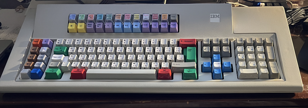

I have three 'workstations', one at my stereo, one at my home office desk, and one in my Sprinter van, the latter two being the most used 'workstations'. The computer is a laptop that plugs into one of two docks, one in the van and one in the office- the stereo is in the office and the same dock feeds both keyboard/screen/mouse setups.
For the office desk and van setups I use an IBM M122 Type I, with a custom key layout. I am in the process of working with Unicomp to produce a card or board that will allow the use of a similar keyboard at the stereo setup. Its a very custom layout, picture of which is uploaded.
I have been wanting to replace the office desk setup with a Model F battleship. The question is whether that unit would be an IBM or a Model F projects unit. I am a little unusual in that I truly love the layout of the original Battleship design, including and especially the cross nav. I am also absolutely used to my location for the escape key (which is labeled 'Panic' on the top left of the side F-bank).
I have talked to Joe, I think on here, about his opinion of his board versus the IBM unit, and of course he prefers the Model F project board. He mentions several advantages, including its metal construction (which I don't see as anything other than nuetral; metal and good quality plastic both have their merits), its younger age (which I certainly see as a plus when it comes to electronics), and it not needing a converter, all of which are true. I also think he prefers that for two additional solid reasons: 1) He wants to sell me a board (which I don't see as him being in the wrong), and 2) pictures of his IBM Model F Battleships show that he clearly prefers T-navs.
He has also told me that there are sensing arrays that would permit the activation of a cross nav, which is why this isn't quite a deal breaker, even though the only way to really do this would involve machining out an additional 3 keys worth of holes, and leave two unused key holes (or assign those keys to something else). This does not address the issue that it is still materially different than the layout of an IBM unit, including function key angles, locations, and so forth. I suspect I could get used to having two different layouts in regular use, but I consider it less than ideal.
But there is another issue I face when it comes to IBM F122s- they don't seem to exist in functional condition for sale at the moment; there is one on eBay that has rust issues, a connector issue, and is stated not to work, for $275 + shipping. Since I would probably need to replace its controller card at the very least, and still have no proof of its ability to repair, this seems like a risky proposition, to say the least.
Does anyone have a line on a working F122? Barring that, should I keep my search up- and possibly lose the opportunity to obtain a Model F projects Battleship- or settle for a Model F Projects board? Has anyone on here had the chance to play with both?

Machine came in yesterday. I was nervous. I unpacked it- it was beautifully packed- to find a keyboard in truly excellent condition. I took it up to my home work station, unplugged my 1988 M122, found my DIN240 Tinkerboy converter (my home M122 is a 2145, so it uses DIN180), plugged that into the keyboard, hooked up my laptop to the dock, and turned stuff on.
Nothing. I was panicky; but it turned out I never plugged the converter into my USB hub :P
And except for one key, all keys registered well, and felt magical. Spacebar was perfect. But... the O key didn't register. Didn't sound right, either. Pulled it off a few times, played with the springs, reseated it, etc. Thought I fixed it. I swapped the keys for my custom keyset, which was a bit harder than swapping keys on an M (more first try failures) but not too bad. I simply swapped the caps on two-piecers. Had to add a few insert stabilisers because more keys were bar stabilised on the F, but that worked fine, too.
Except the O key still acts weird. If I leave the key for a while, it won't work. If I am typing a lot, it will start registering more and more often until it registers fine. The sound is off, sort of missing the 'plink', unless I hold it down for a bit, and it plinks softly finally. After me typing a bunch, though, it starts sounding and working fine.
My thought is I'd be fine if I replaced the spring/barrel/flipper on that one key, but I am wondering if regular use of the keyboard will just solve it over time. I didn't fully disassemble it- prefer to avoid that if at all possible - but everything was otherworldly clean- no keyboard cheese at all.

A dodgy flipper, eh?
viewtopic.php?t=8052
You'll likely need to open it up and take a good look. I wouldn't be surprised if you found a break like this. Those flipper hinges are easily the weakest part of Model Fs in my experience (as the crumbly foam at least stays in place).
Opening them is nothing to be feared. They’re quite nice inside, actually. Fs are much more serviceable than Ms.
The hard part is finding spare parts.

If you open it up have the new foam ready. You're going to need it. Best to just get it replaced either way if you want to daily it.

Should I be looking for used parts, or are the repros Joe is selling workable?
23 Dec 2025, 17:29
I've no idea about Ellipse's bits in OG IBM hardware. Tbh, I suspect Wobbled is right about what you can expect to actually get from him, unless he likes your YouTube channel.
Where are you in the world? I've a few spares. I am, however, in the misty, mystical, interdimensional realm of Scotland. 🏴󠁧󠁢󠁳󠁣󠁴󠁿
Oh, and (Peter?) Falkenroth may be right about the foam. I've been lucky, my Kishsaver and my AT were good enough to retain, but foam can aye be crummmmbly.

But foam and the flipper/springs/barrels are a lot simpler than the keyboards.

Muirium there have been dozens of orders of folks repairing their original XT, AT and F122 boards with the project's new parts (foam and flippers/springs) and I have received zero complaints about issues.
I like to check up on folks who reach out to me having bought a board several years before and the vast majority note that outside of some small adjustments to the springs and keys and maybe a firmware flash, no other maintenance was required.

If you are comparing a new and original Model F, you will have to tinker more with the original for sure, including replacing the controller or setting up an adapter, replacing the foam since it is likely crumbly by now, cleaning every keycap and barrel and also the plates, etc. So far there are not many postings complaining about the new F122. Many postings refer to the 5 year old F62/F77 inventory which is still being sold as that old stock remains, compared to the later generation boards (compact F62/F77, Model M Style, etc.)

Thanks for your clarification Green Maned Lion. Yes they should all work, however with the caveat disclosed on the barrel page: https://www.modelfkeyboards.com/product/extra-barrel/
You may be looking too much into what folks do with their new Model F keyboards in the rare event of additional setup steps needed. The manual is comprehensive and includes steps to adjust everything that could possibly happen. The vast majority of folks will only need to adjust a few springs to set up their new Model F keyboard as they are installing the keys. Someone made an excellent point that because these keyboards are so heavy, the G forces experienced during shipping are much higher and more things are likely to fall out of place compared to a relatively lightweight plastic case keyboard like any Model M. These other keyboards often weigh just a couple pounds, not 8 to 10 pounds. In my experience the lighter Model F boards that have gone out (the ultra compact models) appear to have a lower proportion of feedback, which may support that other user's point.
