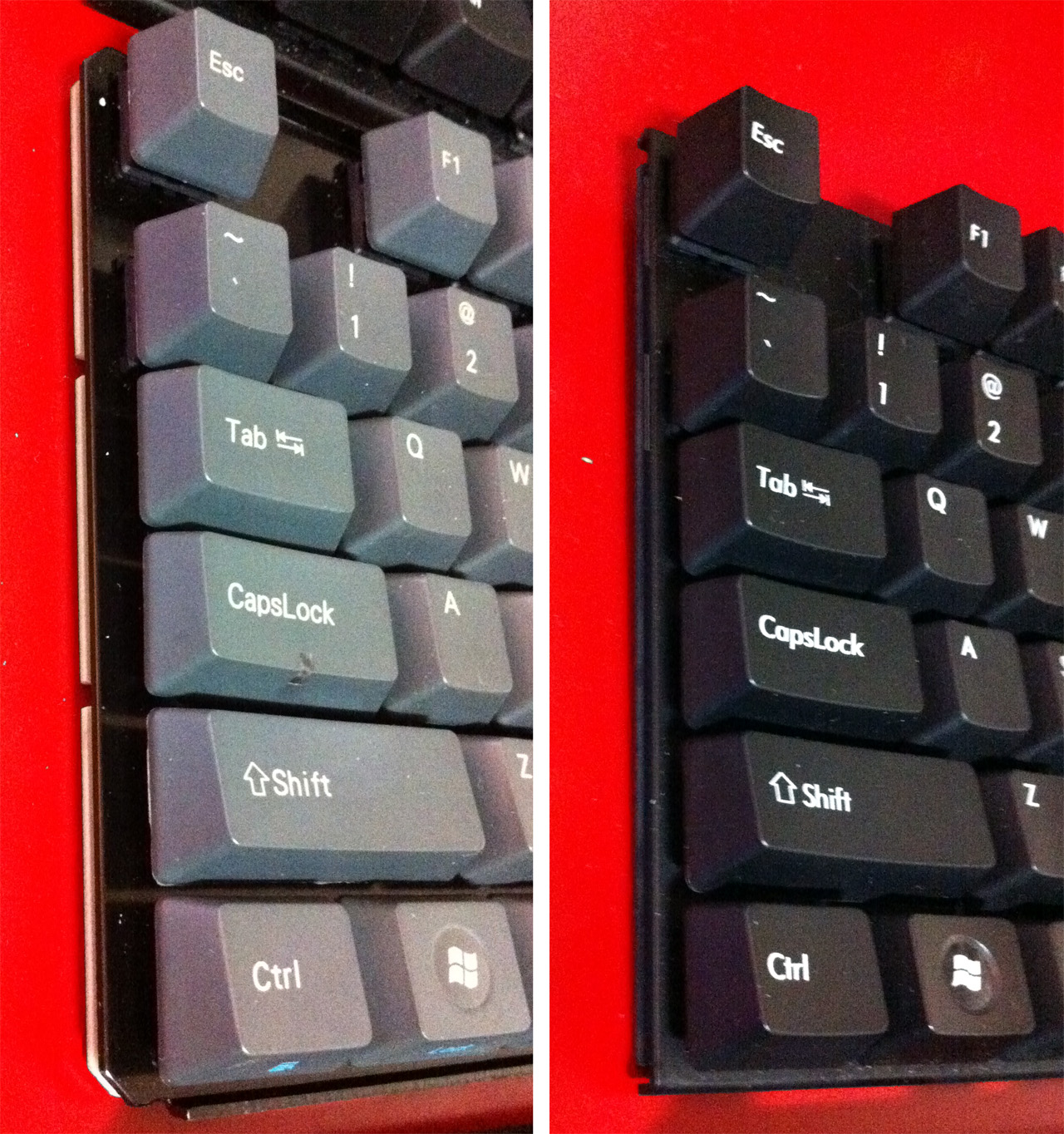

I heard the new Leopold 700R was designed to reduce the pinging/ringing sound. I noticed that the metal plate was bent outward allowing the plate to be pressed against the upper casing (A similar design is used in Realforce). There may be other factors that affects sound such as thicker caps(thickness of caps measured at 1.3mm compared to 1mm~0.8mm of Filco).
source: http://www.kbdmania.net/xe/3561140
700R left, Filco right.jpg (569.98 KiB) Viewed 15257 times
I haven't experienced the effectiveness of the design in reducing the sound myself. However, I observe two things in Korean forums:
1. I don't hear much complaint about pinging sound in 700R when I hear complaints in Groove(Korean version of CM storm; produced by Costar; effectively same as Filco). Both were introduced in the market about the same time.
2. I see forum posts that 700R has much less pinging/ringing sound when compared with Filco. The posts were from people who own the two boards.
So I am inclined to think new design was an effective fix and there is a way to reduce ping sound.
