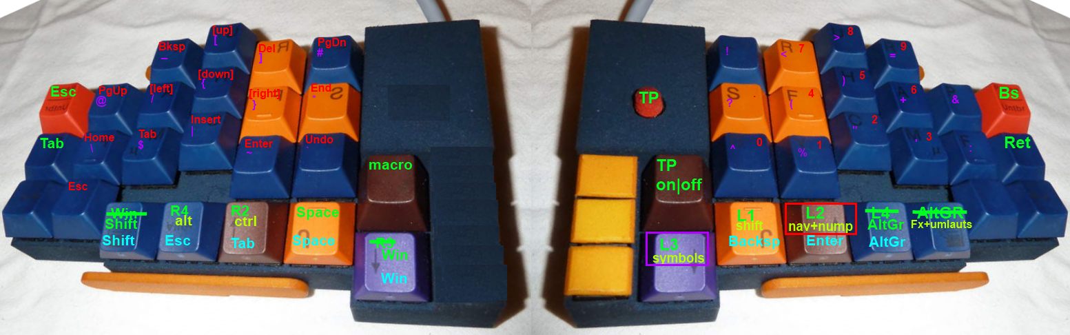

off wrote:Towards the center meaning between the two halves and not the center of each half I take it
Correct - but just to make sure I typed for a while with a flat setup, and rotating the halves a little (pushing the outsides about 1 or 2cm further away from me) it was also comfortable.
off wrote: So about that MacroMode key... that makes it seem to me that it is a key you hit only to actually program a macro, not to run one, correct? Then where do the runnable macros end up at (what mode of execution do you have for them)?
Also, what does R3 do?
The macros come from Teensys eeprom where they are currently stored by a separate program, and replayed with MacroMode+key, I mainly use it for random password strings or to auto-logon to windows by also replaying Ctrl-Alt-Del before part of the longer pw. Prior to switching to Pentatdactyl I also utilized things like copy text - new tab - paste - return, for example, but the dedicated keyboard mode is far superior. Since I obviously posted an older layout above I'll try to display it again, but without the staggering - I definately need to find a better display program, but hopes this serves its purpose
----- Thumb & MKT ----
                        Macro    TP
LShft LAlt LCtrl Space                  Mod1 Mod3 AltGr Fx
 -     Esc  Tab  Space                  BkSp Ret  -     -
                        LWin     Mod2
------ Layer 0 & Mod1 ( letters shifted)
K  U  Q  .: J     V  G  C  L  F
H  I  E  A  O     D  T  R  N  S
X  Y  -_ ,; /\    B  P  W  M  Z
----- M2 / special ---
@ _ [ ] #   ! < > = &
----- M3 / MoveNum ---
PgUp BkSp  Up  Del  PgDo   ß 7 8 9 ä Ä
Pos1 Left Down Righ End    . 4 5 6 ö Ö
Esc  Tab  Ins  Ret  Undo   0 1 2 3 ü Ü
As you can see plenty of keys are not in use yet or duplicates, so 2x5x3 keys x4 layers is already plenty, not even considering the thumbrow nor the outer columns.

suka wrote:Prior to switching to Pentatdactyl I also utilized things like copy text - new tab - paste - return, for example, but the dedicated keyboard mode is far superior.
I'm not so sure you'll have keys left over after cutting off the outer collums actually.. there are a few duplicates though.
And ofcourse, if you were to skip the thumb-buttons, there would be no more layers, limiting even more. But you seem to have dumped the F-keys (and moved the umlauts to the numpad layer, not visualized in my image since umlauts are not universal; some languages use way more 'signed characters' and some way less), hence giving you a full 5x3x2 space for new keys, so I do see what you're getting at.
As was probably evident from my personal initial sketch, I too believe in layering and small keyboards being fully sufficient.
How do you like it so far to have to shift back and forth to utilize the numpad as you would on a normal board (like in a calculator), annoying or natural?
What does MKT (from 'Thumb & MKT') stand for btw?
And indeed, I too could use a better way of quickly sketching up and visualizing layouts, and editing them afterwards.
This Pentadactyl I haven't checked out, this 'dedicated keyboard mode' is a feature of that?
suka's current split keyboard layout layers.jpg (109.04 KiB) Viewed 6528 times

All Fn-keys are available, just very seldomly needed. What I plan on implementing in regard to the umlauts and other accented characters is a compose mode, where based on several key presses a different one is generated (eg Compose - u - " will create ü). Have used it with the neo windows drivers and found it very useful, it's just that I get along too fine with the way it is now that I hardly think of this feature.
The integrated numpad is great and selecting it (among all the other layers) with the right thumb has become very natural to me, especially since the same layers right hand side with the navigation controls is also often needed. What I would like to try, though, is aranging the numbers according to Benford's law, thus moving the most often used digits 0-4 on the home row.
MKT was my initial name for the duplicate use of the modifiers: ModeKeyToggle (either Mode or Key)
Pentadactyl is an extension to Firefox that makes everything accesible to key shortcuts, employing a vi-like command and navigation mode to enable really powerful features. Together with the i3 tiling windowmanager it has greatly reduced my use of either mouse or trackpoint, which is really nice once you get used to it. Definately worth a try, especially if you're already changing about everything else in your machine interaction for the sake of ergonomics ...
Nice picture you created by the way 8-)
