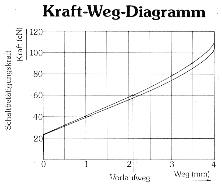

What I don't like about MY is that they get stiffer the further you push the key down. They don't follow Hooke's Law due to the construction with the leaf spring, so they aren't linear, but feel rather exponential (of course they aren't, but they feel as if they were). Have a look at a force diagram and you will see.
Edit: Just wanted to look for a diagram over at the Cherry Corp Wiki at GH. Apparently this wiki has been nuked as well.
Edit2: Found it:
Doesn't look like much, but feels really awful imho.

Yeah, look at that 100g bottoming point!
Hooke's Law FTW!

One of those switches that feel worse than the force chart would indicate.

A few reasons why people don't like Cherry MY are found in the force chart. One thing that has not been mentioned is that the initial resistance is too low. On a Cherry MX, you can rest your fingers on the keys without moving a key at all -- and you can't do that on a Cherry MY board.

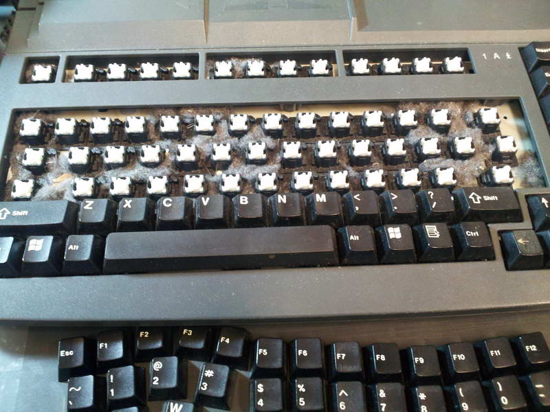

Do you mean MY? I don't think the friction is an issue for MY switches. If it were, the board must have been used a lot in dusty environment.
I bought some used G81-7000 boards for doubleshot caps, and it worked relatively fine in this state.
2012-06-05 04.45.01_resize.jpg (89.25 KiB) Viewed 10952 times
