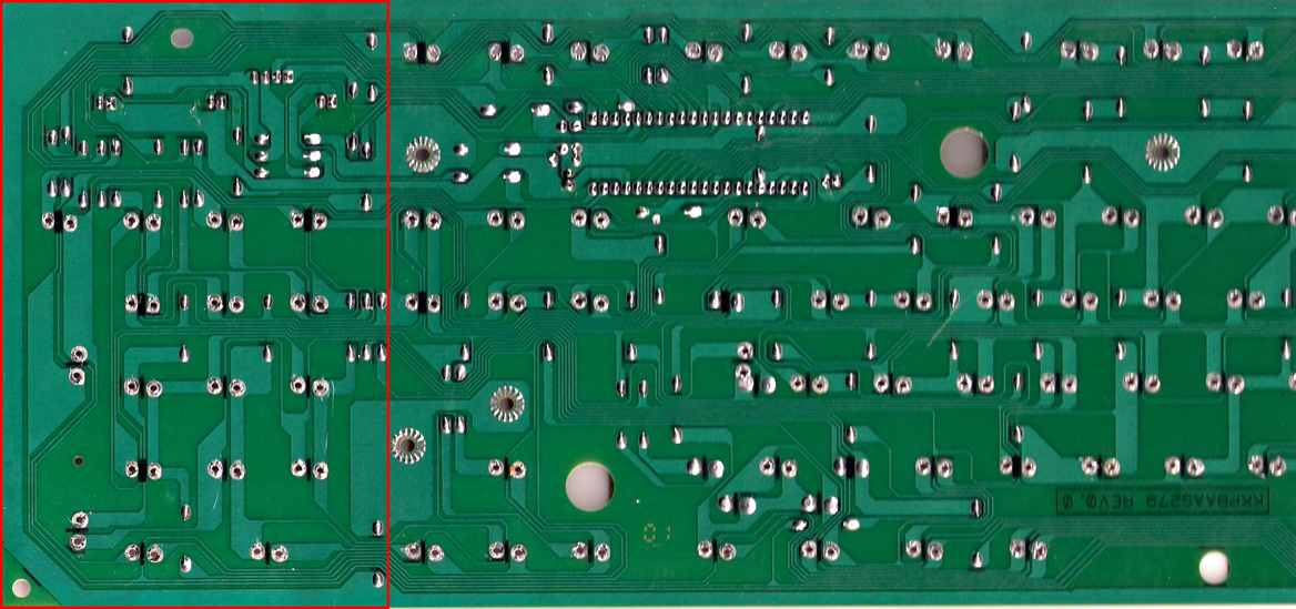

I would like to make my own tenkeyless out of a full sized keyboard. I've got some Dell AT102W keyboards and I wanna make one tenkeyless. Why? Because I feel like doing it and it seems like fun! :D
I've seen the model M mini mod on geekhack before but it's not on there anymore so I've got no reference.
My question is: how and where do I start? I doesn't seem likely that I can just cut the board and get it over with (seems obvious).
Do I have to look where every line is going and reconnect them again? If so, with what tools should I do this? If not, send me on my way oh mighty electronic warriors and mod-o-maniacs.

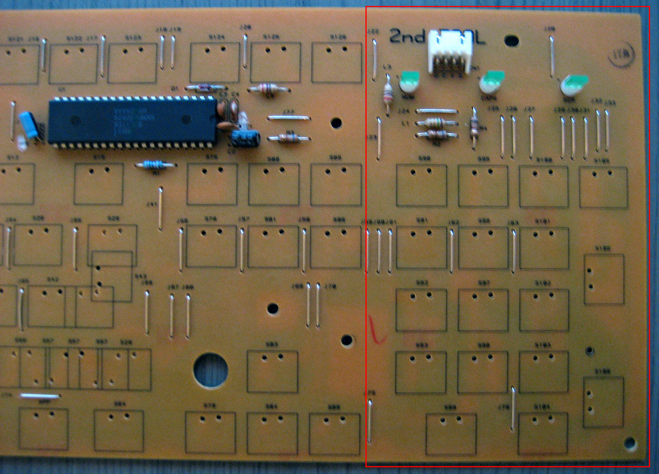

I've included images of the section I would like to remove. Problem is that the cable connector, leds and stuff are also located there. I'd appreciate anything to get me on my way. I've had several basic electronics courses but hacking was never covered :p
[attachment=0]PCB_Pic_front.jpg[/attachment

Paranoid wrote:Do I have to look where every line is going and reconnect them again?
You will have to trace each line, yes. You don't have to reconnect lines from the controller that has switches only on the part that you cut off.

Check how the PCB is secured in the case. Theres no sense in just cutting where you want keys to be removed as the PCB may then be too small and flatter on the right side, ie because its just laying on 2 small bumps of the lower case. Cherry PCBs are sometimes secured by clamping between upper and lower case half.
Look where to cut the case. You might find it helpful to do winkled cuts instead of one straight line ie you can keep the case's corner which are hard to remodel by that. Also as much fixation points you'll keep the better.
2. the PCB.
As soon as you know where you'll cut the case look at the PCB. You can use a CD Marker to draw a line on the PCB backside. Each lead the marker crosses (that is cut later) you have to check whether it has some use. On your PCB you do have some massive ground leads, the ones on the numpad you can likely collect into one solid on the left side. You can ignore leads that are just going to numpad keys, but you'll have to jumper wire leads that are running from a random key on the left around the numpad to the controller, as in "a walk around the block".
3. the functions.
You can use the same method (trace and jumper/resolder) for the connector, most likely its easier to just solder the cable flat on the contact points instead of reposition the connector. If you don't want to mess with theory, just reposition the resistors to the appropriate solder points...Same goes with the LED's, if you feel the need to keep the 2 of them - maybe reposition into the according switch if that s possible (cherry is ofc)

Looks like a relative simple board without the diodes and stuff....
If i were you id number all the pins on the controller (with a little marker right on the pcb)
I would then (with the multi-meter set to measure continuity aka 'diode' ) measure to what two controller pins every switch is connected to and write the two numbers down in the switch square.
Hack the board in half and check if every switch trace is still connected to the controller like before (which will probably not be the case) and place replacement traces made from some old wire accordingly.
