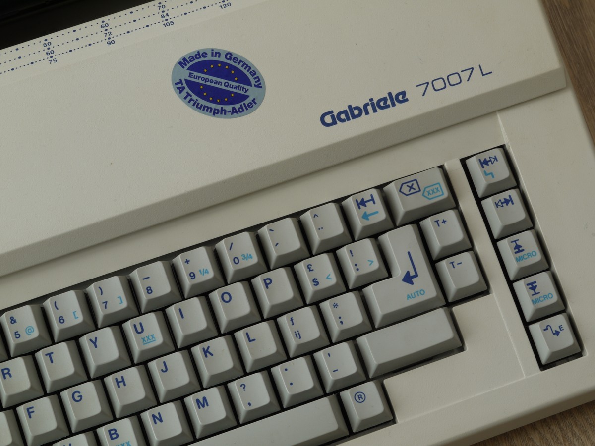

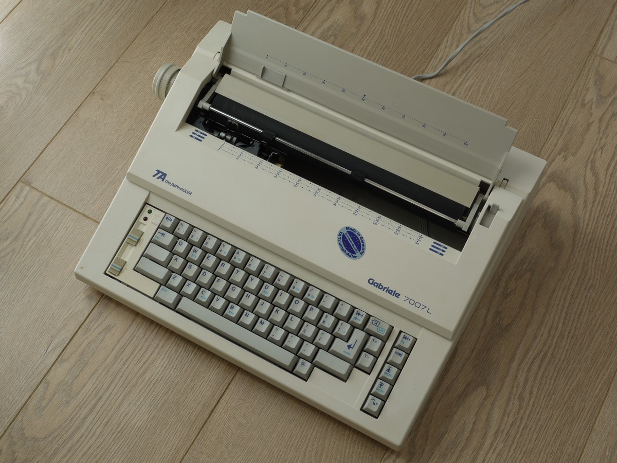

I've recently found a Triumph+Adler Gabriele 7007L electric typewriter in a shed on a garden party and I just knew that the caps had to be Cherry MX compatible. And gorgeous caps they were: thick PBT dye-subbed ones. Dark blue lettering on light grey with light blue alternative legends.
The space bar wouldn't fit on modern keyboards and the modifier keys of a typewriter obviously are different from computer keyboards. Besides that, the key spacing seems to be different so there is a slightly larger gap between the keys. Furthermore, the caps are in genuine Dutch layout :)
Gabriele 7007L (Dutch)

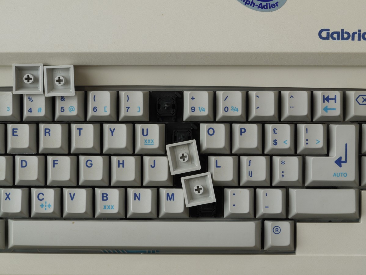

Close up
Close up
Thick caps.<br />MY-like switches but with higher resistance.
Thick caps.

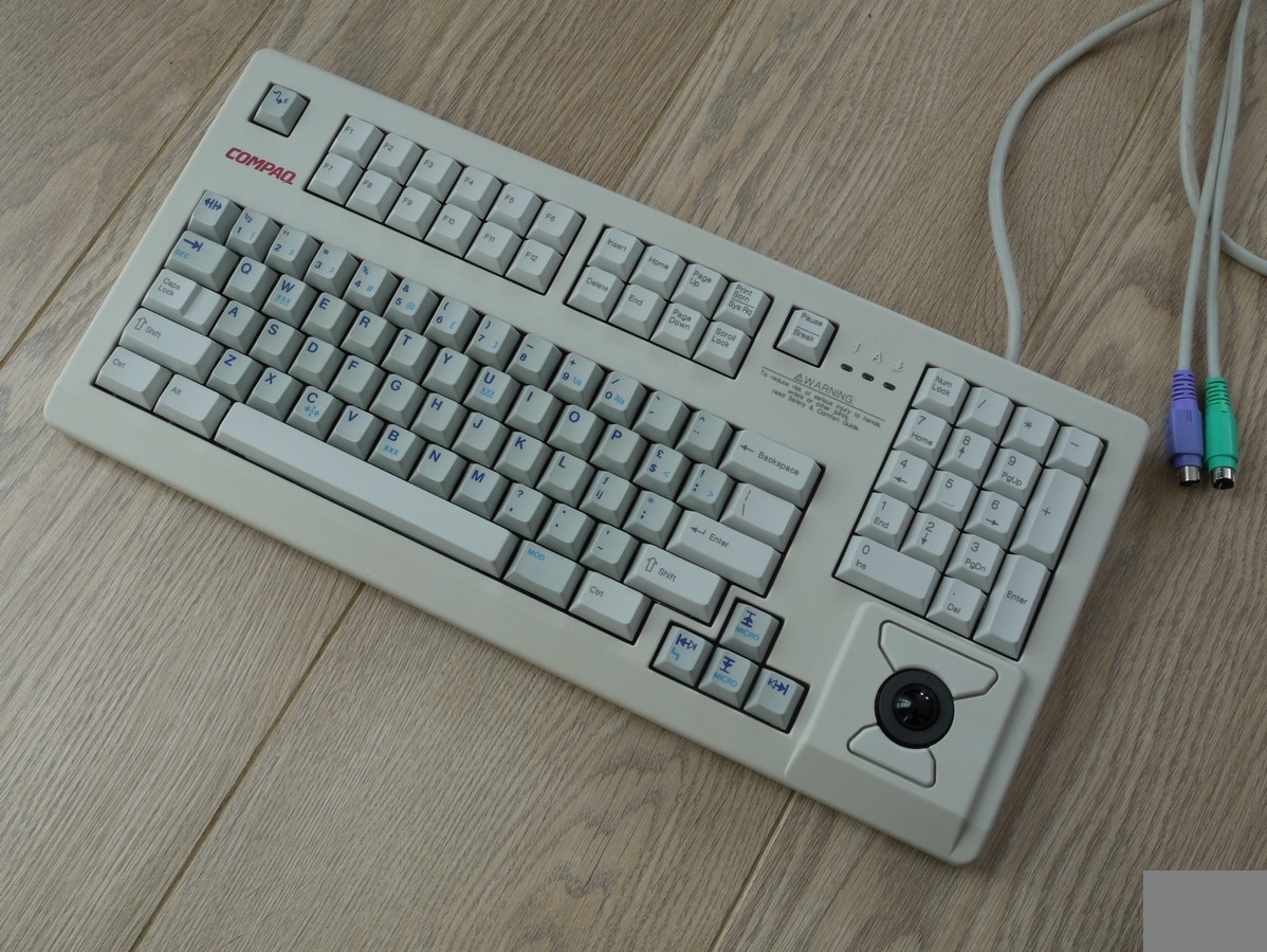

Here's how they look on a MX11800 board. There might be keyboards that look prettier and have better matching colour schemes but this was the best fit available to me.
Caps on MX11800
Caps on MX11800

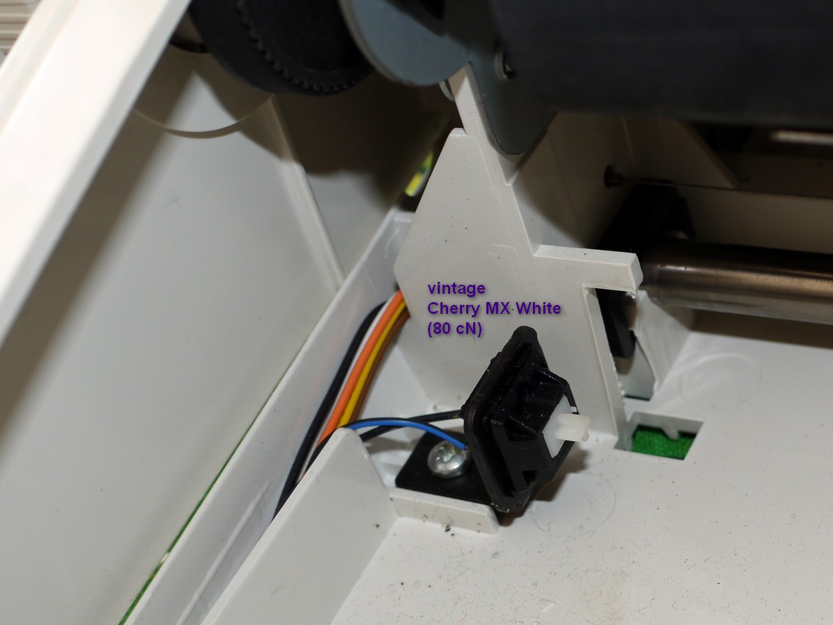

A Cherry surprise hidden in the guts of the typewriter: A vintage MX White (80 cN).
Surprise!
Surprise!

Can the two keycaps below the tab cap be used to replace Caps and ANSI Shift ? What is the purpose of the white mx switch ?

The blank 1.75 u key can replace a center-stemmed CapsLock but the 2.25 u blanks won't fit on the left Cherry ANSI shift mounts. They do have three mounting points but the outer two are separated by ~26.1 mm while normal ANSI left shift mounting points are separated by 23.8 mm. Some weird imperial measures for sure (23.8 mm is very close to 15/16 inch). But there is hope: it should be possible to mount them on costar stabilizers if you shorten the ends of the stabilizing bar a bit.

The MX switch is getting activated if the typewheel sledge hits the left side of the typewriter after pressing carriage return.
