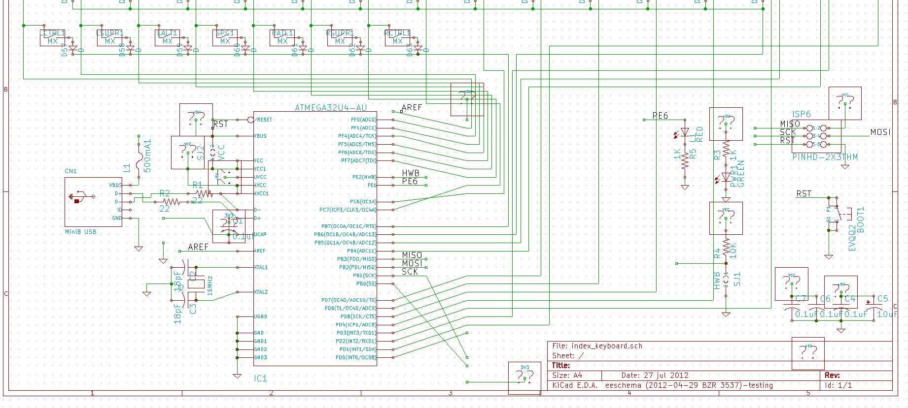

Here's the updated project files with both the breakout board and the cherry switches.
Can someone please look over the schematic? I know nothing about pcb design and I'm pretty much doing this for the first time.

I had a quick look and it looks quite right, but don't take my word for anything... Also I don't have all the standard libraries installed so some components only show up as boxes with question marks in them. It would help if you kept all library files you are using in the project library. And remove all other library files, KiCAD get so grumpy when it doesn't find them all =) (And you also don't need to spill your username and OS..)
  • There are still some wires that look like they end up in the middle of nowhere. And I think it is customary to only use vertical and horizontal wires with 90° bends, for a good reason...
  • You can tie HWB to ground, through a resistor. It only needs to be grounded for the chip to call the bootloader on reset. That is unless you want to use that pin for something else. Then you need to have a jumper or button tying it down, while resetting.
  • Keyboard LEDs?
  • You can use the pins connecting to the ISP interface for other tasks in general use (that is the whole idea..)
  • 3.3 volts? Are you going to want to use that, otherwise you can design that whole part away as well.
Sorry about that, I literally just did what u told me to do in the geekhack forum and just connected the wires from the cherry switches to the microcontroller.
I do want to be able to reset the microcontroller so I can be able to reprogram it. Is that what you mean?
bpiphany wrote:
  • Keyboard LEDs?
I don't want any keyboard LEDs, except for the microcontroller so I can see visual feedback when I'm reprogramming the microcontroller.
Oh really? Well, I want the ISP pins there so I can reprogram the microcontroller.
I don't believe so, I just want a USB keyboard where I can connect an ICSP in order to program it.
Thanks for all the help bpiphany (formally PrinsValium), I know it must be very hard to stay patient with me. I talked to you before about designing a pcb on geekhack after looking at your symmetric stagger keyboard and pcb diy guide.
bpiphany
27 Jul 2012, 08:06
HA, don't worry I'm quite patient, and I like to teach and help out =D I am no electrical engineer myself, but I think it looks tidier and easier to follow when everything is laid out straight. For quick and dirty prototyping there are of course no rules...
When you press reset the controller looks at the HWB pin. If it is high the controller only restarts the program (I think, never did that actually), and if it is low the controller starts running from the memory address where the bootloader is located.
The bootloader is used to transfer files via the USB port. The other way to program the controller is to use a serial programmer and the ISP interface (in system programming), this is also good if you for some reason want to change the fuse bits since this can't be done via the bootloader. (There is parallel programming as well, but I have never used that.)
You don't even need to disconnect the unit to be able to program it using the ISP programmer. The programmer just jumps in and takes over. The rest of the design may get very confused while the programmer is talking to the chip perhaps, if you've got anything listening on those wires.. But that shouldn't be a problem here.
You may want to square off your matrix a bit, dropping the two rightmost columns since they only have 3 switches in total, and put those switches somewhere else.
The absolute path to the library files are stored, so your windows username shows up there =) By the way you still need to tell KiCAD where your library files are at, under "Preferenced->Library". There you will also see which "standard" libraries that are included. The power connections are from one of them, and I don't have them installed. So those also still do not render...
Generally I recommend taking a look into the files with a text editor, they are not too complicated and it reveals a little of how things work under the hood. Also it is possible to quickly copy and paste together your own library files including only what you need. They are pretty forgiving on white spaces also, spaces or tabs doesn't matter, neither does the number of newlines.

I think it looks pretty good, the library paths still are messed up, but let's not focus on that =)
You probably don't want to connect the unused D0, D1 pins directly to ground. Even if you are not going to use them. If they are accidentally set to high output that would probably be bad. Leave them floating or have a 1k-10k resistor in series.
And, really, use some of the free pins for some switch mounted LEDs. It won't hurt you to have them there if you ever want them. Actually why not use every free pin for this purpose, or come up with some other use for them. No reason leaving IO-pins unused =)
Generally, try to make sure why every single component is there, and understand it's purpose. Ask questions if you can't figure it out. Why are C4-C7 there for instance?

I think for the DIP-switches, you really only need to connect one of the sides to GND, and use pull-up resistors on the pin you connect to the other side. That way you will know which way the DIP is switched, and it gives you double the number of DIPs =) And I don't think it is a very good idea to use the AREF as an I/O-pin...
That 500mA fuse is probably pretty unnecessary, and tie HWB to GND through a 1k resistor straight away, if you are not planning on using it for anything.. You can lose the power indication LED without shedding any tears, but I still think other indication LEDs are useful =P

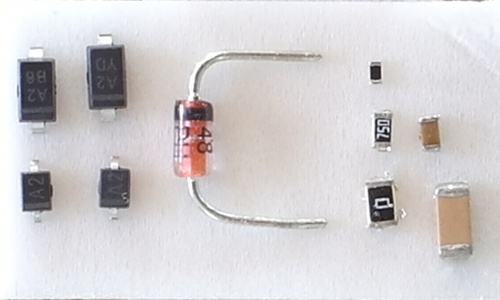

There are internal pull-up resistors inside the ATmega32u4, so you won't need any extra. You could do extra holes for through hole diodes, but really SOD-123 ones are quite large.
Unfortunately I didn't add anything for reference in this photo.
Top left SOD-123, Bottom left SOD-323, middle DO-35, Top right 0402, middle right 0603.
