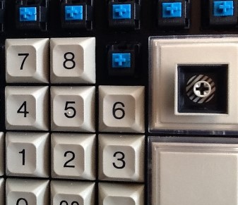

That Epsom numpad has the exact same caps that I got with a Jarltech matrix POS keyboard. It had exactly the same numeric and relegendable keycaps, with plate-mounted MX blues. Those mounts look distinctively Cherry MX to me.
norolim

subcat wrote: […]. I just keep finding unidentifiable stuff - this Epson thing particularly interested me because of the underside of those caps... http://auctions.c.yimg.jp/images.auctio ... x28847.jpg […]
scottc wrote: That Epsom numpad has the exact same caps that I got with a Jarltech matrix POS keyboard. It had exactly the same numeric and relegendable keycaps, with plate-mounted MX blues. Those mounts look distinctively Cherry MX to me.
I can confirm scottc's post.
These caps have been first documented by Ascaii:
photos-f62/my-new-daily-driver-i-m-in-l ... ove#p11544
and this is how they look like:
Jarltech numeric caps.jpg (28.9 KiB) Viewed 11441 times
