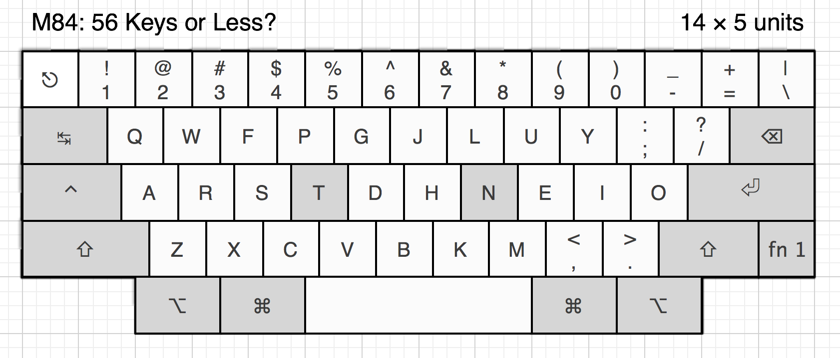

A little peek into what I'm designing: a 56 key sub-60% for use with Kile's wireless controller!
Screen Shot 2014-06-14 at 08.03.41 pm.png (88.62 KiB) Viewed 10331 times
Pardon the Colemak. I'm trying to shake off Qwerty in general, and want to make sure that I still have enough keys where I most need them!

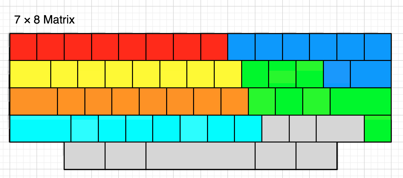

This is a bit of a strange layout: I took out a column from a standard 60%, while adding my usual HHKB bits. Kile's controller has just 15 pins, so the biggest matrix it can handle is 7*8=56 keys; when optimally routed. Speaking of which, I'd be looking at a PCB with a matrix something like this!
Screen Shot 2014-06-14 at 08.17.33 pm.png (36.73 KiB) Viewed 10331 times
Maybe not the easiest thing for Matteo's workshop…
56 is a few less keys than ideal. The smaller you go, the more you need your function keys, and I have only one on this design. So it's far from final. Though it does look pleasing to the eye at least.
Anyway, I could lose a row instead and go small like Neo's THKB or the JD40. That would mean less demanding PCB work, too. Now just imagine this in a wood case and running off a little battery!

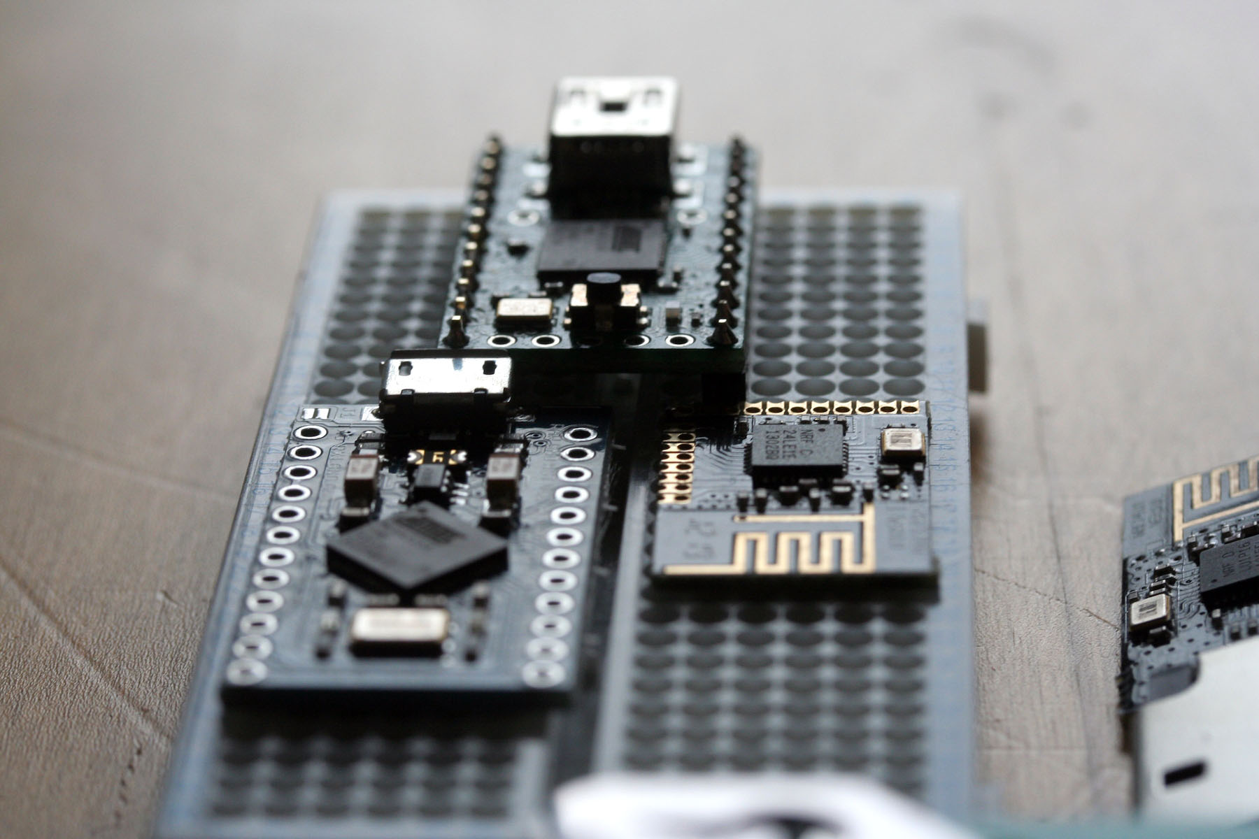

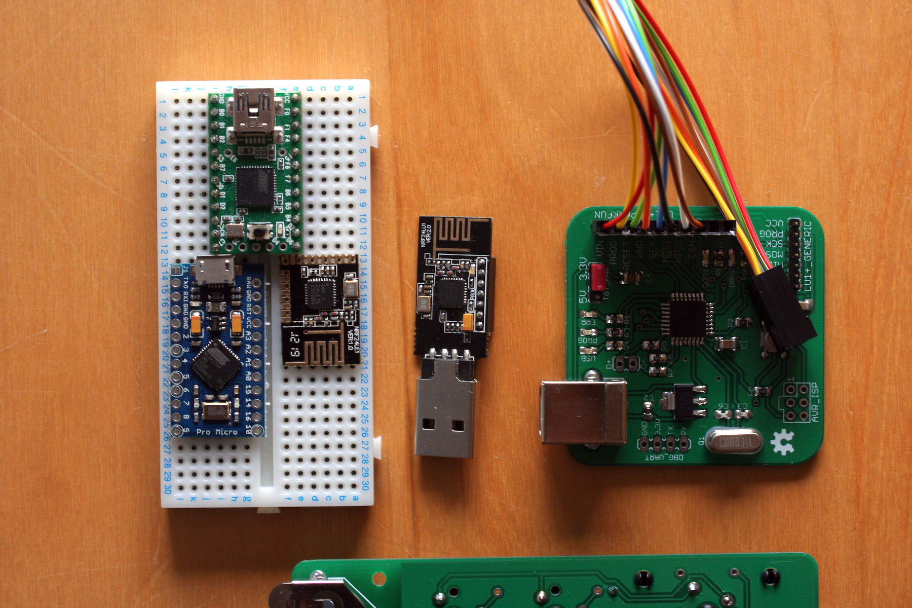

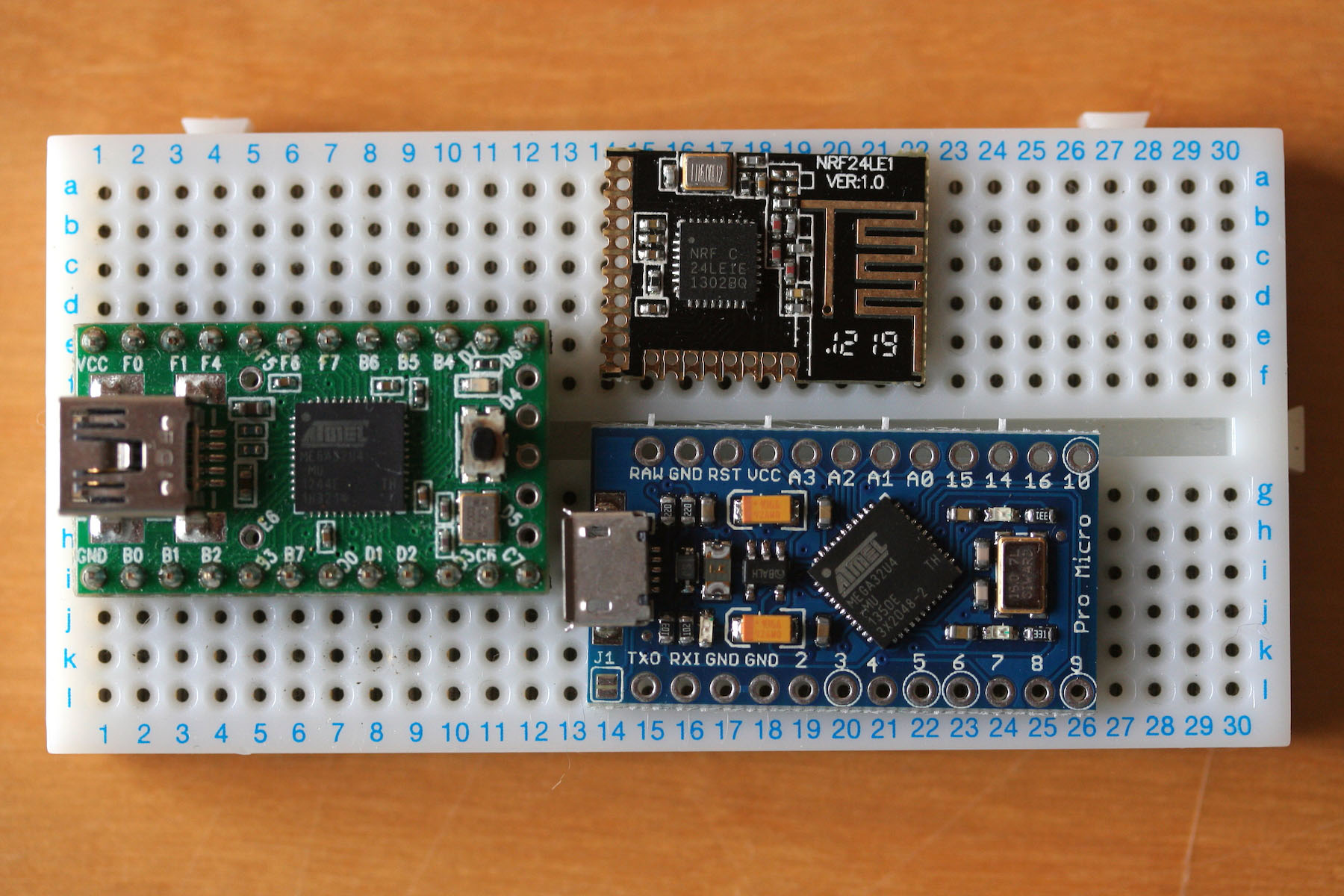

No, the limit is simply the available pins on the controller. Here's the hardware in question, alongside a Teensy 2 and Leonardo clone:

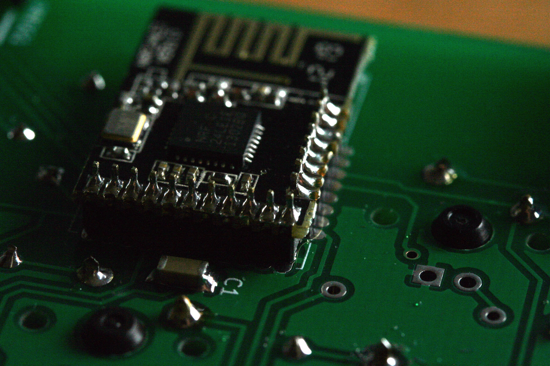

Note the integrated antenna. The whole thing is very flat:
Those tiny pins are going to be a bugger to install, I just know it!

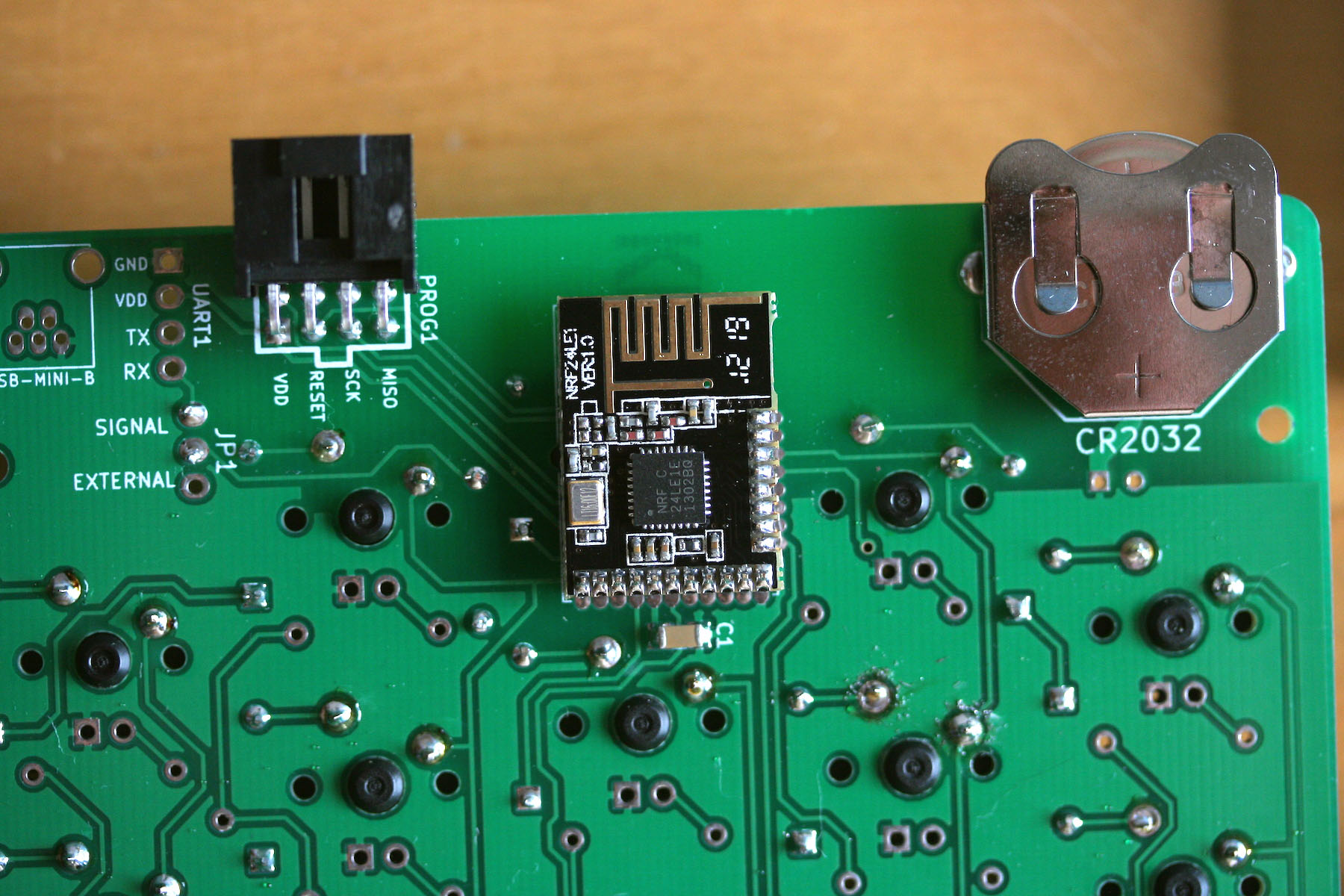

Here's the other one in action on the OneHand. Note the CR2302 battery, which is enough for many months use.
And how it attaches to the OneHand PCB:

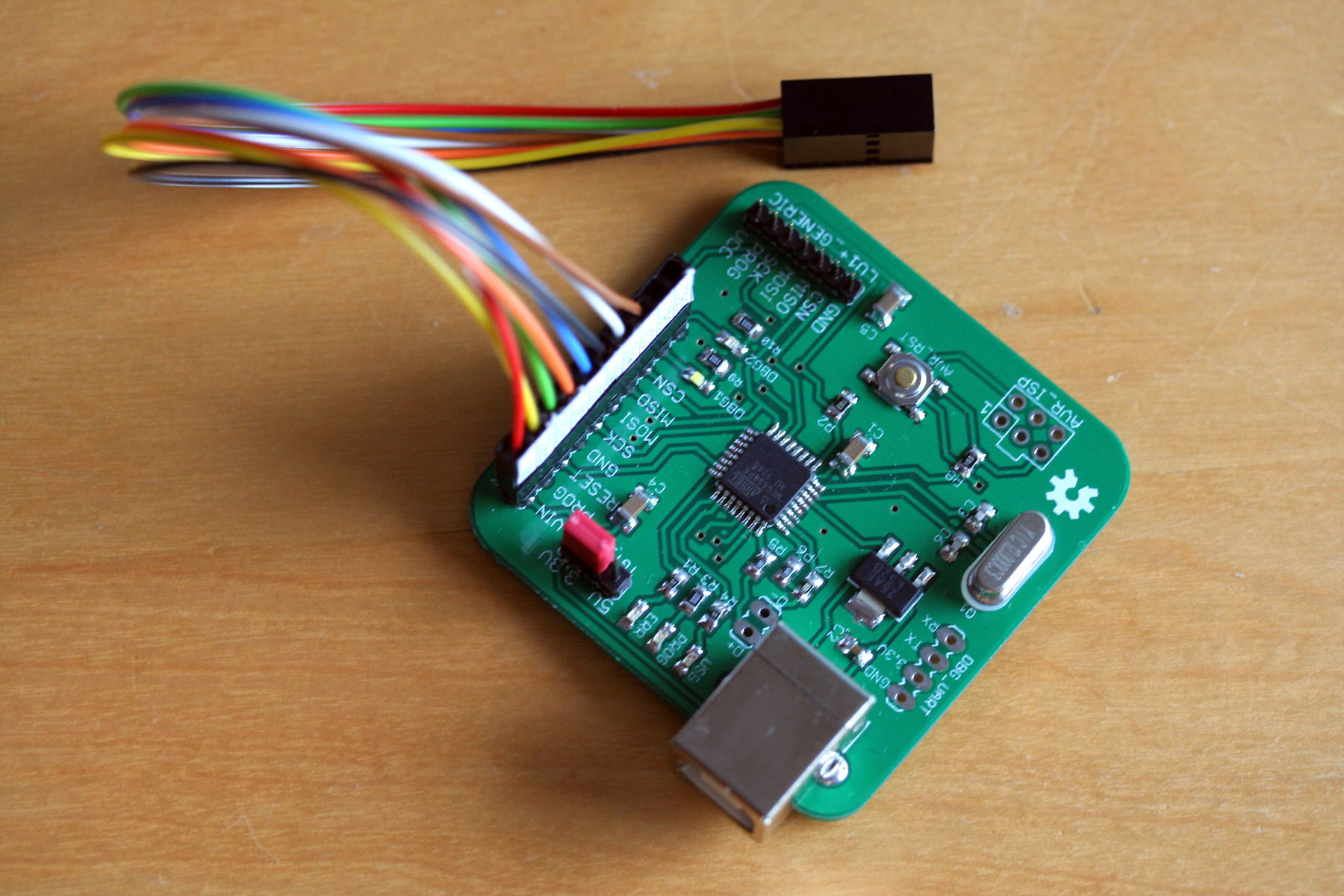

Programming is trickier without a USB port right on the board. Here's Kile's solution: a programmer board.
