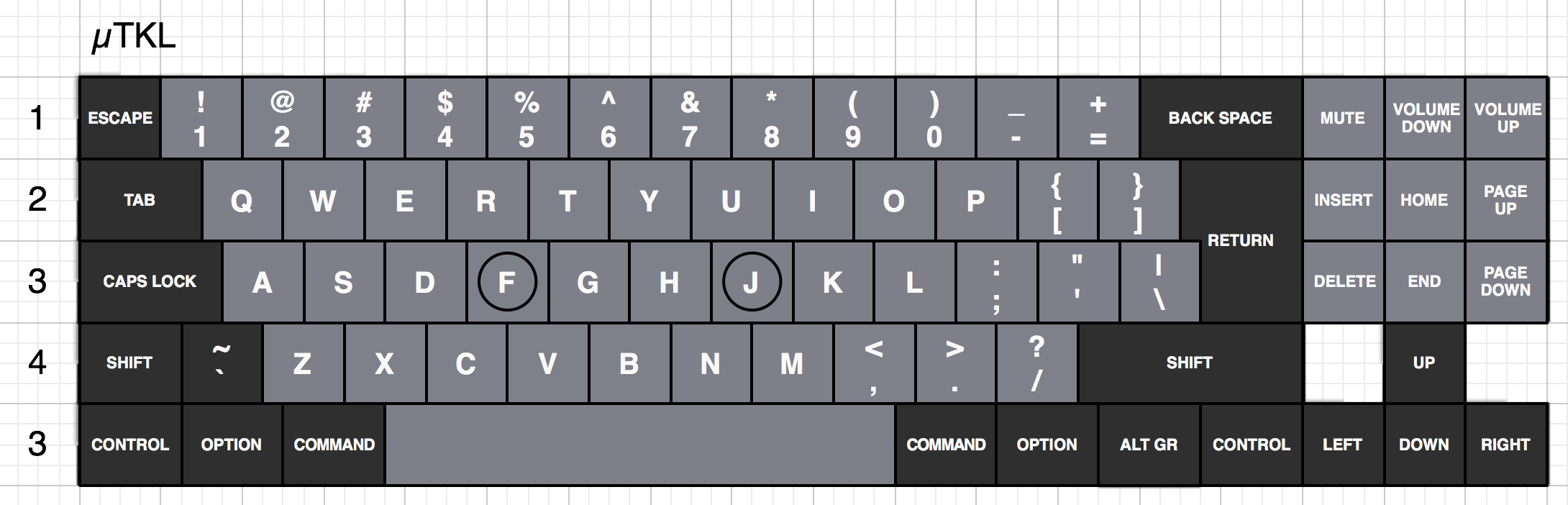

I have a cut down µTKL design I'm working on, that I can share. Top features: No function row, HHKB Fn key and Backspace, compatible with Round 5 and Matt's DSA sets, and a strictly minimalist case. You've all seen my Shiny 60%, you know the kind of thing I'm going for.
I'm also exploring a second design using those small space bars available in Round 5. Or even a Matias switch build, if Matteo's confident enough to try.
-[°_°]-

I've some diagramming to do then! I'll do a symmetric version too, ماء, as I'd like to see if it's possible with Round 5 caps. But standard stagger is what I have in mind, really. I think symmetric stagger would be a better idea for a fully split keyboard, for me at least.

But you're quite right of course: HHKB backspace and short shift aren't for everyone. I'll see what I can do with my µTKL: the minimalist's choice.

Seeing as we're in ISO love tonight: here's the ISO variant µTKL in progress:
I'm thinking of a solid wall of keys again. Note the navigation six-pack above the cursor keys: it's a square of 9. Because it's a numpad on the function layer, and 3 macro keys on the default.
Re: Matt's number-row-less layout; I was wondering when you'd go 4 row! I have considered it for the TKL. But then I'd lose row 1, and it's my favourite profile of Round 5 caps.
