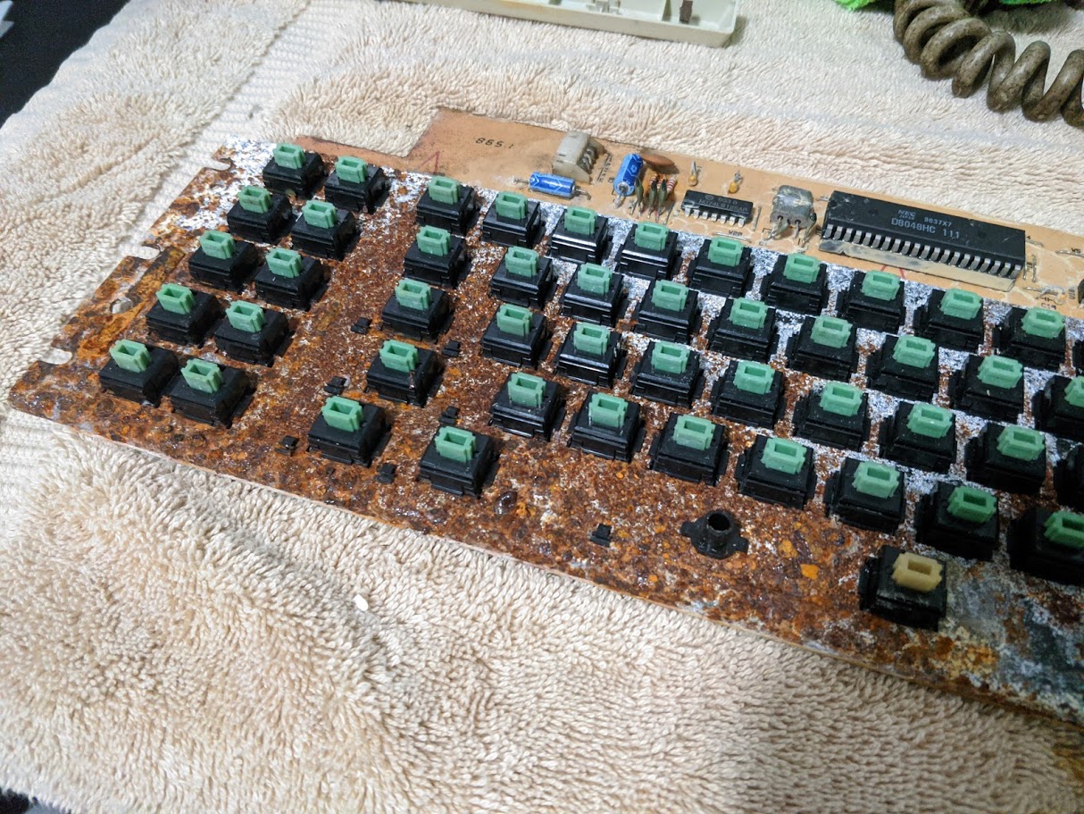

idk man I had pretty good luck using it on some green Alps that came from this board:

That's interesting and great. I assume green ALPS are 1st gen (material of the stem is the same as Blue/Orange ones, and not the newer smoother material used for pine White ones) and also they were factory-lubed, correct? How did you clean them, and how did you apply the lube? Can you give some pointers? Do you have any new-like ones to compare them to? How smooth are the presses on the corners of the keys?kelvinhall05 wrote: 01 Dec 2020, 15:31 idk man I had pretty good luck using it on some green Alps that came from this board:You did put way too much on your first ones lol. I'm guessing you then put too little on your second batch or used it on dirty switches because the ones I posted above were absolutely terrible when I got the board but are nice and smooth now.Spoiler:
kelvinhall05
- Location: Canada
- Main mouse: MX Master 3
I ran them through an ultrasonic several times, then lubed sliders and housings (I probably should've tested different methods on different keys but oh well). They are very smooth although I probably could've used a bit less lube or just lubed the housing. I have some extremely good condition green Alps in a Sharp PA1000H and they feel very similar and I'd attribute the difference in feel to my shit lubing skills.NeK wrote: 01 Dec 2020, 16:06That's interesting and great. I assume green ALPS are 1st gen (material of the stem is the same as Blue/Orange ones, and not the newer smoother material used for pine White ones) and also they were factory-lubed, correct? How did you clean them, and how did you apply the lube? Can you give some pointers? Do you have any new-like ones to compare them to? How smooth are the presses on the corners of the keys?kelvinhall05 wrote: 01 Dec 2020, 15:31 idk man I had pretty good luck using it on some green Alps that came from this board:You did put way too much on your first ones lol. I'm guessing you then put too little on your second batch or used it on dirty switches because the ones I posted above were absolutely terrible when I got the board but are nice and smooth now.Spoiler:
Some of the keys bind a bit when I press the corners of the keycaps but for the most part it's fine and I can't get them to bind when typing normally. Again, I think this can be attributed to my lubing technique.

They have been sitting untouched for about three weeks now because most of the switchplates are dead (stupidly didn't check before reassembling). They are certainly better than when I first lubed them. I think with a better lube job they wouldn't bind.NeK wrote: 01 Dec 2020, 16:34Thanks, really nice to hear. Though I remain abit not thrilled about the corner-binding issues (it is what I care most about). How long did you let them "cure" for? And have you let them totally untouched during that time, no presses or fiddling with them at all? And something last, how good or bad were they after you ultrasonic'ed them?kelvinhall05 wrote: 01 Dec 2020, 16:13I ran them through an ultrasonic several times, then lubed sliders and housings (I probably should've tested different methods on different keys but oh well). They are very smooth although I probably could've used a bit less lube or just lubed the housing. I have some extremely good condition green Alps in a Sharp PA1000H and they feel very similar and I'd attribute the difference in feel to my shit lubing skills.NeK wrote: 01 Dec 2020, 16:06
They were pretty scratchy after cleaning. Think MX red. Little worse.

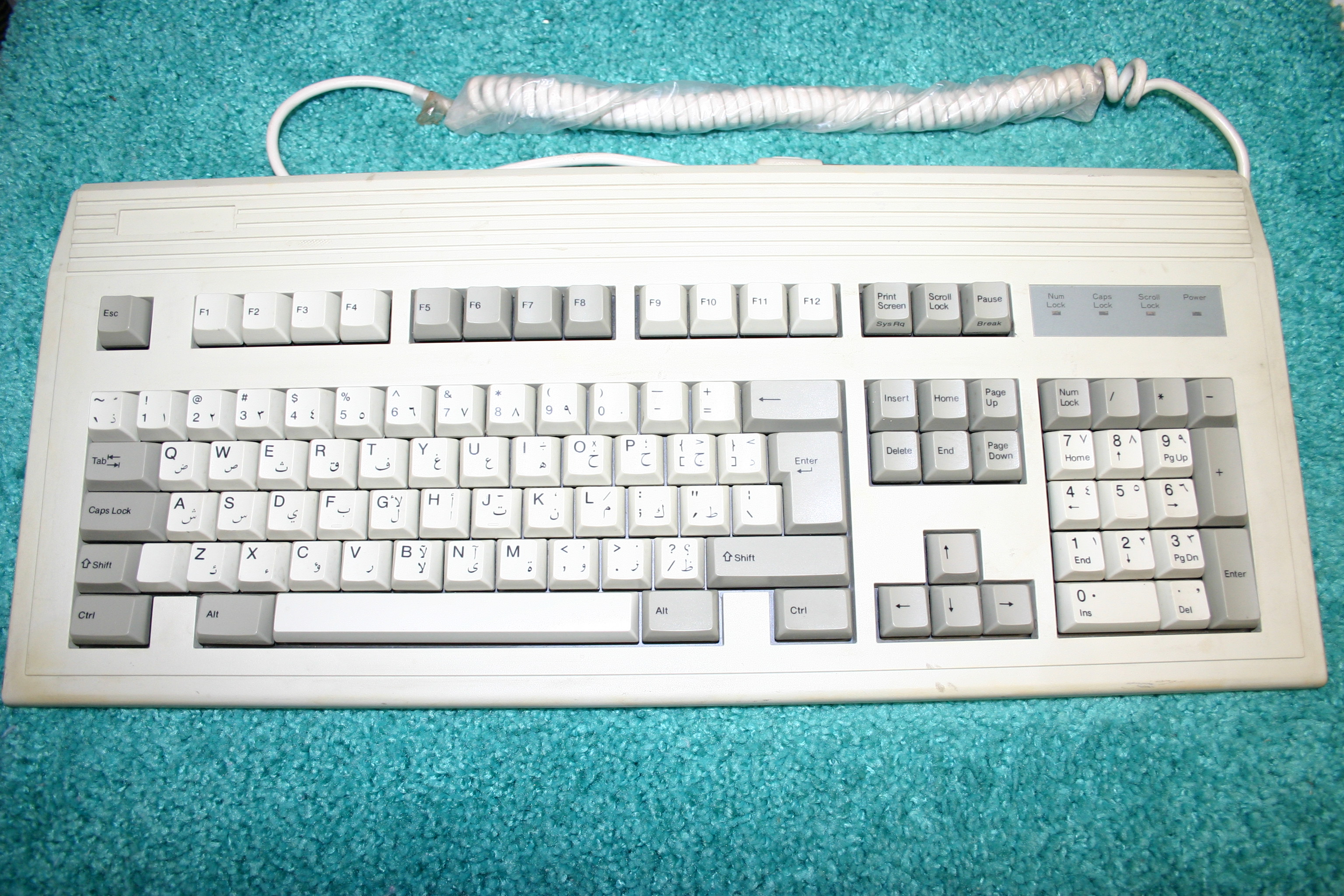

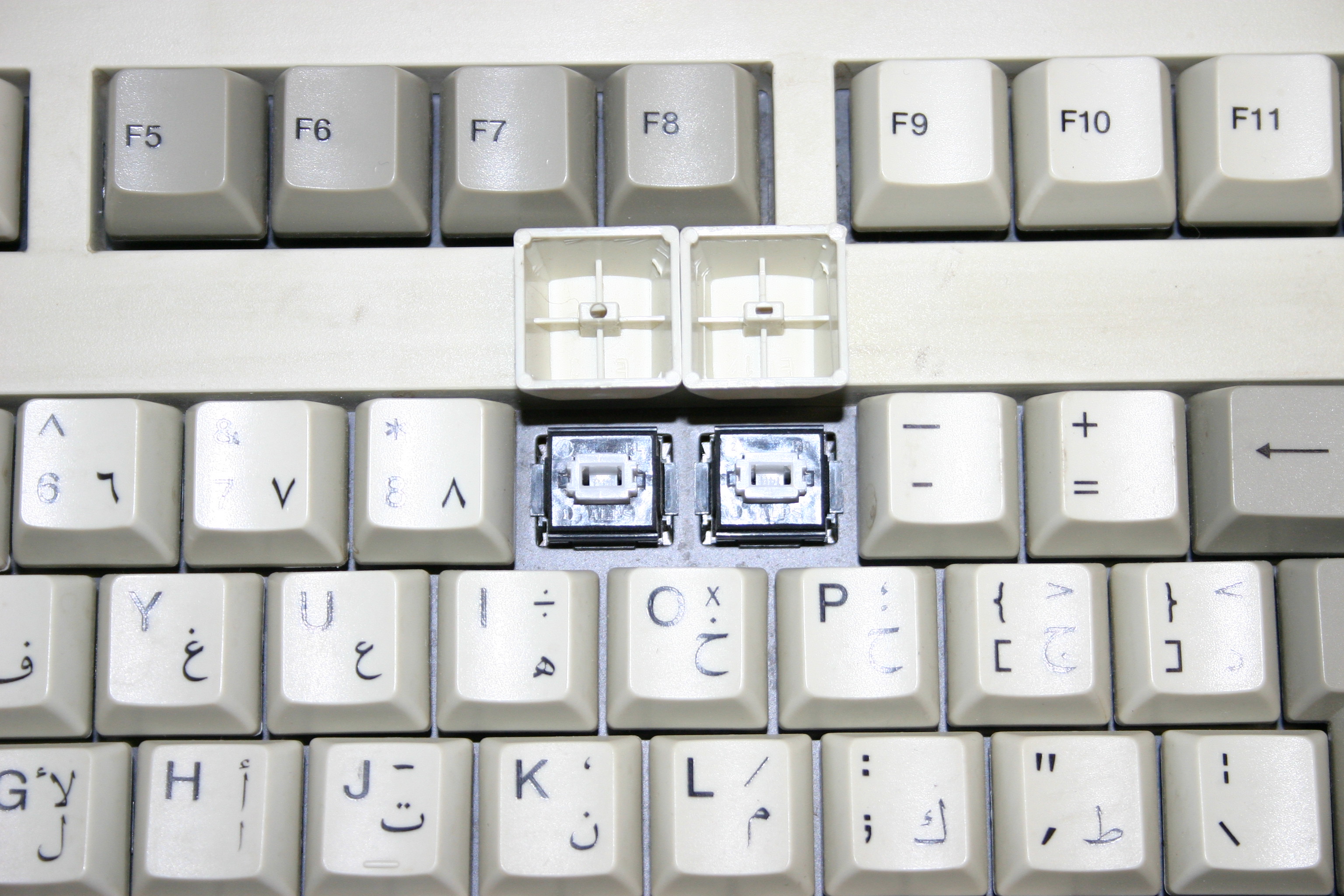

Egypt has very high temperatures with a humid environment. That could easily explain the issue with the switches, as the plastic of the stems deteriorated under those conditions, even if stored in a box and never being used.Polecat wrote: 12 Dec 2020, 22:30 My subjective chart is binary, as a keyboard is a binary device.
1. Ready to use, with no issues.
0. Nope or noper. Don't bother with cleaning, lubing, or other fiddling about. Yank out, toss in the trash, replace with #1.
Note that this is specific to Alps switches, since that's what I've been typing on for the past thirty years. I've had incredibly good luck buying used Alps keyboards, with one notable exception - a Costar CSK-2102 with (early) white Alps I got recently, from the ebay seller in Egypt. It's immaculately clean inside (as in never been used), with zero shine on the caps, but squeaks and binds so badly that it's completely unusable. No matter, it's nothing some switches from a parts donor won't cure, the value to me is the case and keycaps.I would like to know why these switches are so terrible though.
In any case, if you are going to throw it away, just send it over to me, I dont mind restoring it!
- Polecat
Funny, I buy an Alps keyboard and throw the switches away. Like Domino's Pizza, where you throw away the pizza and eat the box. But I just couldn't pass this one up.NeK wrote: 13 Dec 2020, 00:24
In any case, if you are going to throw it away, just send it over to me, I dont mind restoring it!![]()
I'll bet you're right. I knew Egypt was hot, but I didn't realize it was humid there. When I remove the switches I'll pop open a couple to see if there's any obvios damage before I toss them in the trash...uh...or send them to you.

Wow those symbols on some caps are cool, please throw away (= send them to me) the J and the R with the happy face!!!Polecat wrote: 13 Dec 2020, 01:02 I'll bet you're right. I knew Egypt was hot, but I didn't realize it was humid there. When I remove the switches I'll pop open a couple to see if there's any obvios damage before I toss them in the trash...uh...or send them to you.![]()
