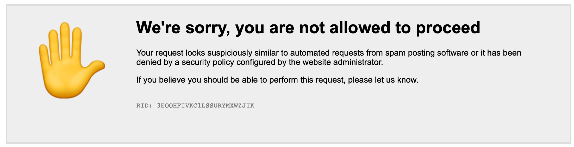

Hi
I am trying to download it, but I am getting the following error:
Screen Shot 2020-11-16 at 7.38.23 AM.png (180.67 KiB) Viewed 10081 times
Thanks
J
darkcruix
16 Nov 2020, 19:08
shampoo wrote: 16 Nov 2020, 13:38 Hi
Thanks
J
I have a relatively tight setting on the access rights. Can you give me your public IP (e.g. navigate to whatsmyip.com) and PM me your IP. I can then update the configuration.

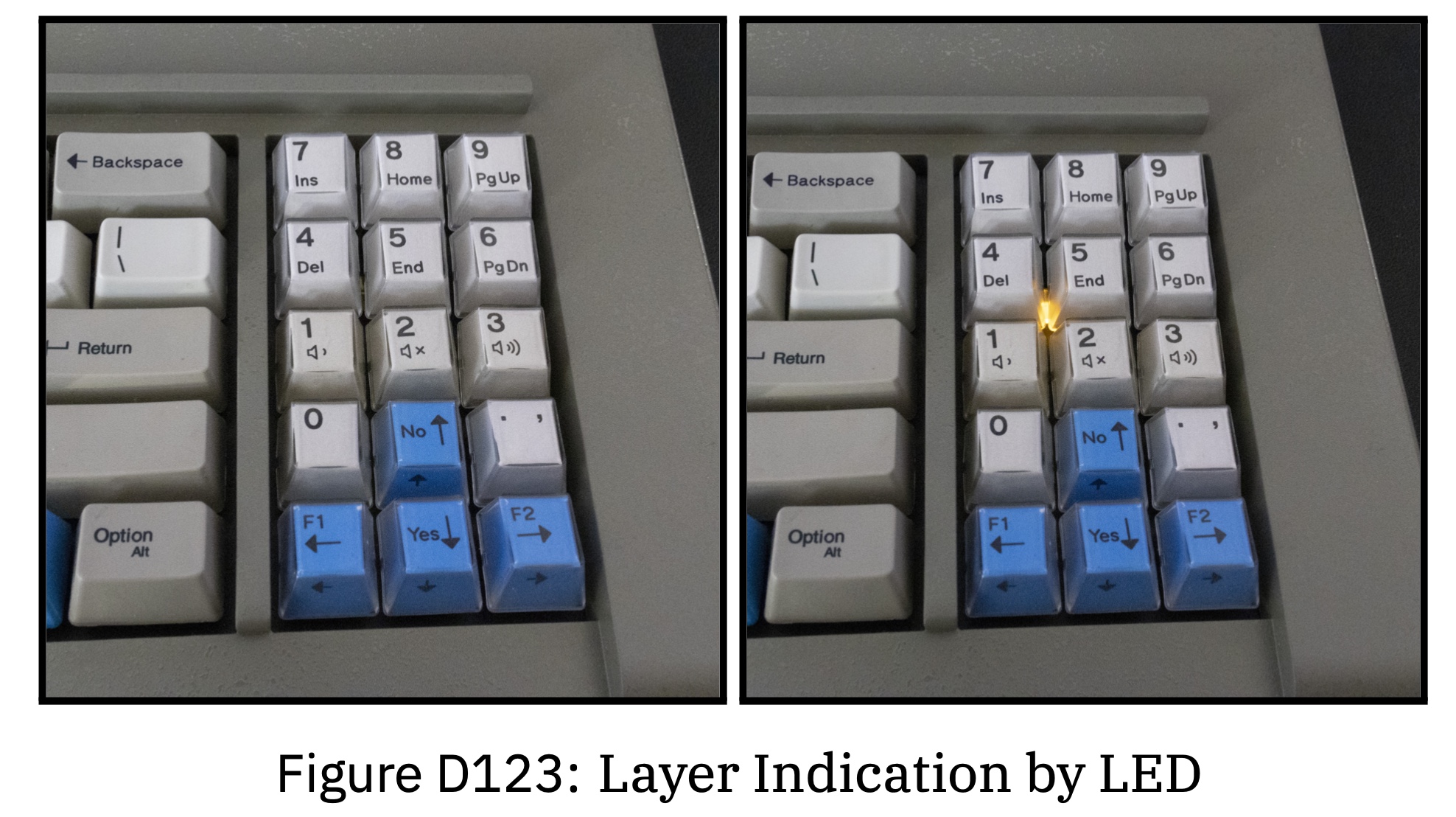

darkcruix
30 Dec 2020, 14:45
Added another 10 new pages around Cleaning and Lock Lights in version 0.5.20.
I spent some time in getting the Layer indication via LED implemented in QMK with some nice outcome (IMHO).
Download the latest version (0.5.20) from here:
https://www.bucklingspring.com/technica ... downloads/

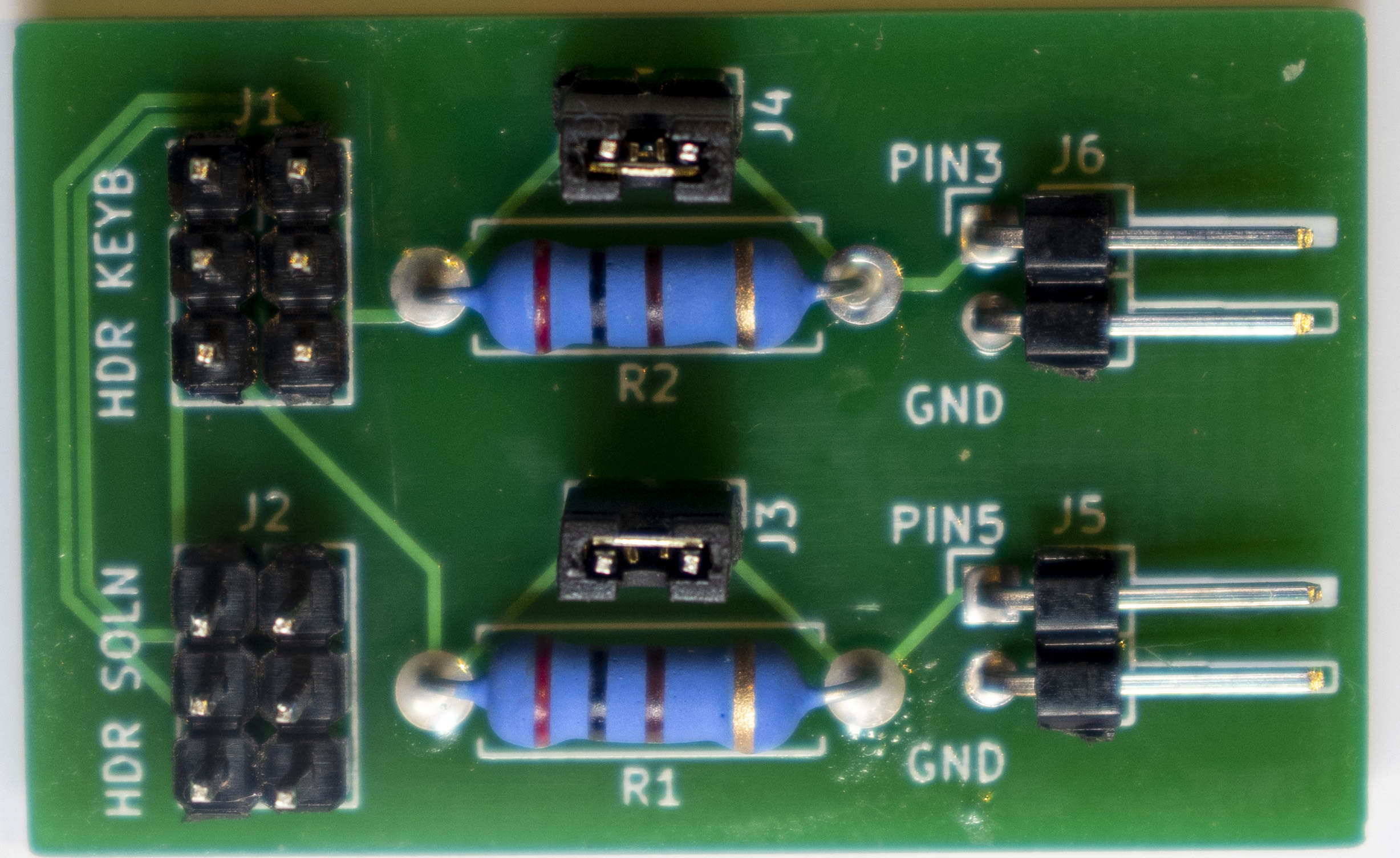

darkcruix
11 Jan 2021, 13:01
Added more info around cleaning and more about Lock Lights in version 0.5.21.
I also showed the first iteration of the LED breakout board to the documentation:
Download the latest version (0.5.21) from here:

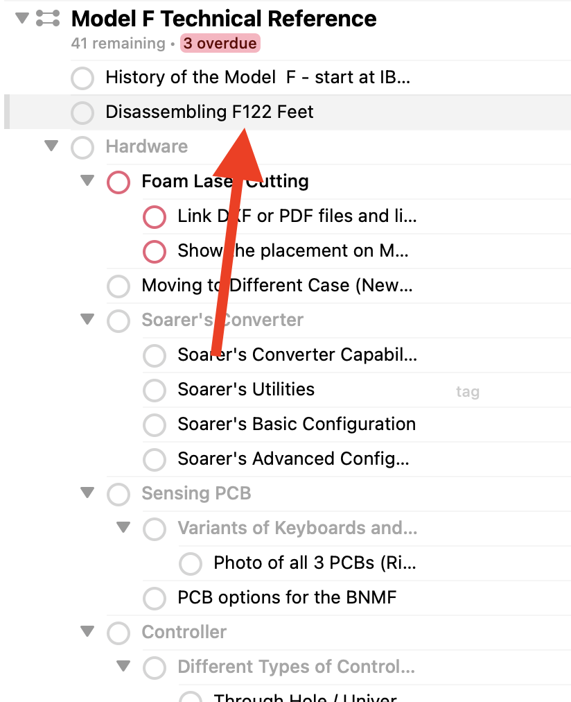

John Doe
12 Jan 2021, 10:16
A 411Mb size pdf file, impressive work.
plus: should be there tricks added about how to disassemble the legs from f122/unsavers?
darkcruix
12 Jan 2021, 10:38
Thanks so much guys ... there is still some work to be done, but keep the ideas coming. For the serial table, I think an online database would be better suited. I have an idea to make the bucklingspring.com web page more versatile in the future. Sharktastic has a great DB already btw.
Disassembling the legs of F122 and similar ... great idea!!!! I just added it to the list of tasks ....

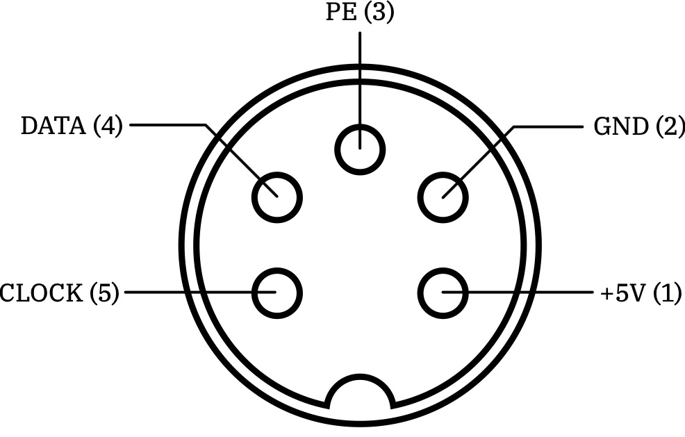

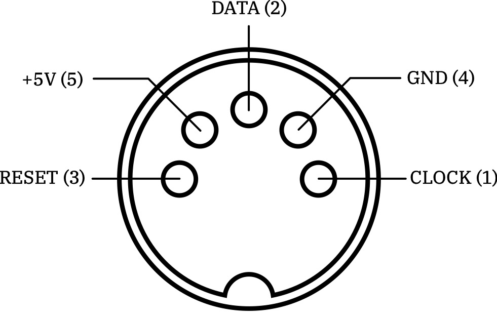

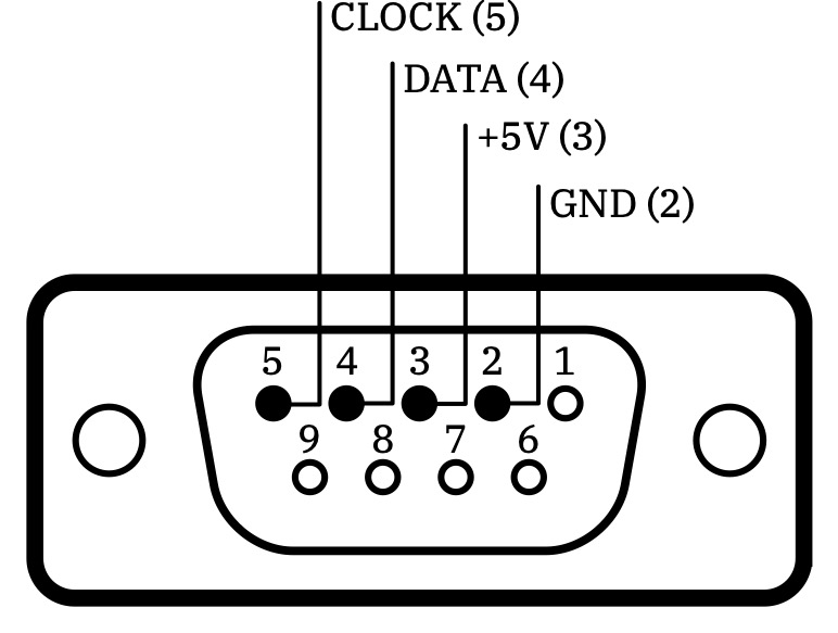

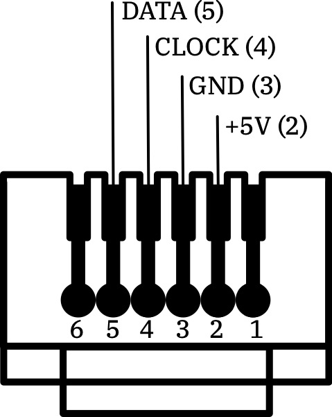

01 Feb 2021, 21:18
I am building a quick overview about the connectors (male) for the various Model F Models. I found some different answers online, so I wanted to cross check, if I am correct with the below graphical representation:
XT/AT jack:
F122 jack:
4704 jack:
Portable PC jack:

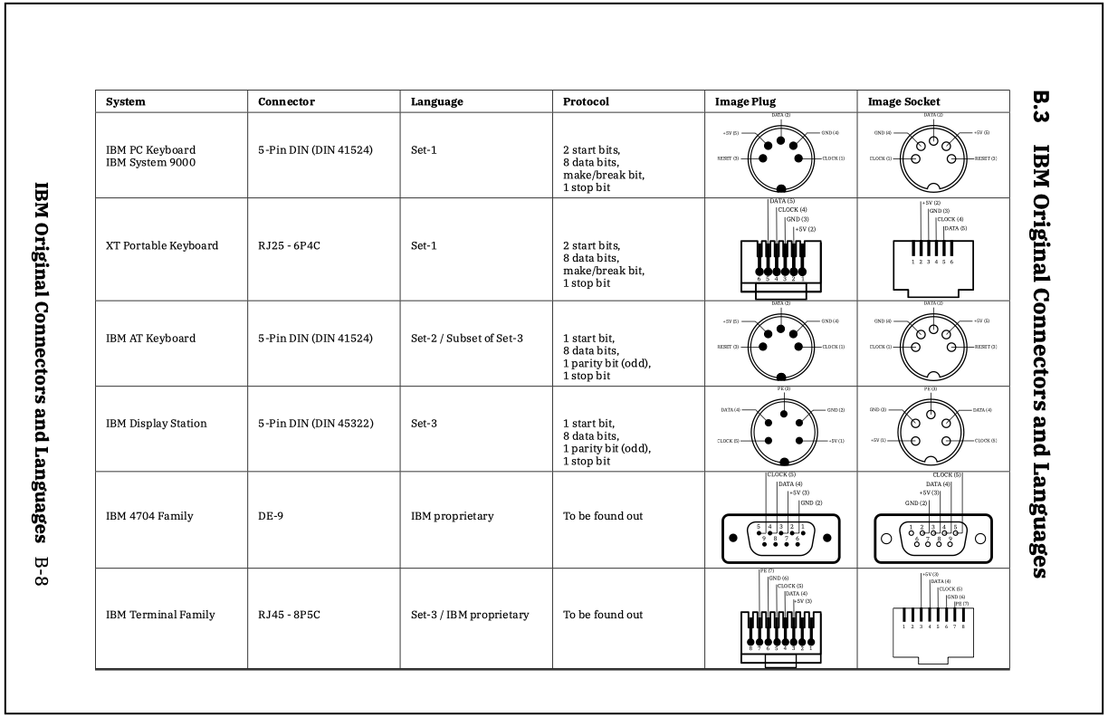

darkcruix
06 Feb 2021, 23:15
As part of the Model F Technical Manual Project, I am working on a table that contains the connectors, protocols and language sets of the variants. I have collected most of the data, but I can't figure out the details for some models, like our beloved 4704 Models. What I have so far is shown below, I would like to understand the protocol of the 4704 with its original controller. I hope someone can help.
ModelFManual.pdf
(252.63 KiB) Downloaded 189 times

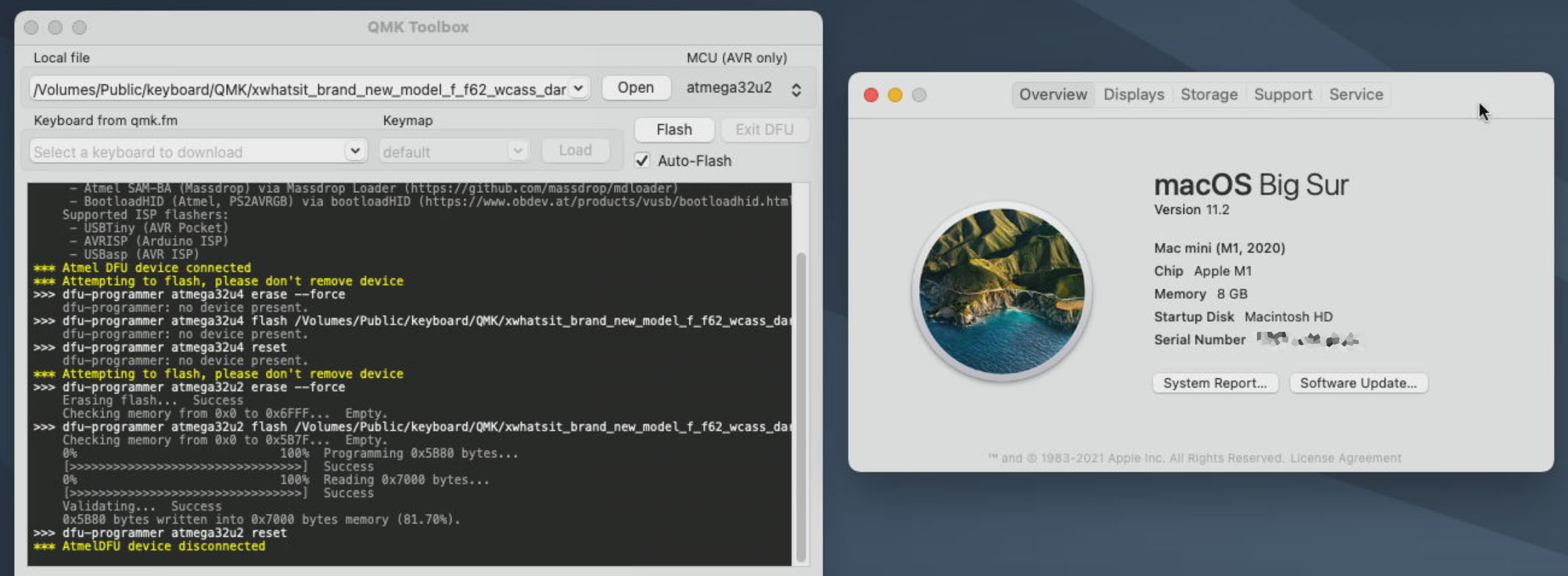

shampoo
07 Feb 2021, 01:52
I have a silly question, and I think I know the answer, but is there a way to pull the firmware off the controller ? My HD crashed and I hadn't backed up my firmware..
Thanks
shampoo
07 Feb 2021, 01:55
Oh, and there is one thing that people may want to know, but currently, there is no way to install the qmk firmware on a M1 (ARM) Mac. The only known way was using brew and qmk/qmk/qmk is not currently installing on the M1 using brew. The maintainers are aware..
darkcruix
07 Feb 2021, 19:05
darkcruix wrote: 06 Feb 2021, 23:15 As part of the Model F Technical Manual Project, I am working on a table that contains the connectors, protocols and language sets of the variants. I have collected most of the data, but I can't figure out the details for some models, like our beloved 4704 Models. What I have so far is shown below, I would like to understand the protocol of the 4704 with its original controller. I hope someone can help.
ModelFManual.pdf
I have incorporated the info into the Appendix as I feel it is something that people would search and like to have in a single location. The excerpt of the Appendix has been attached here. As always, the Technical Reference is worked on constantly and can be downloaded from: https://www.bucklingspring.com
ModelFManual.pdf
(275.64 KiB) Downloaded 222 times
darkcruix
07 Feb 2021, 19:26
shampoo wrote: 07 Feb 2021, 01:55 Oh, and there is one thing that people may want to know, but currently, there is no way to install the qmk firmware on a M1 (ARM) Mac. The only known way was using brew and qmk/qmk/qmk is not currently installing on the M1 using brew. The maintainers are aware..
I checked it against my M1 Mac mini, as I was flashing my keyboard using the QMK Toolbox in Rosetta without issues. But you're right, a native CLI qmk isn't available. Thanks for letting me know.
shampoo
11 Feb 2021, 18:12
Hi
They are working on getting qmk installed for M1 natively, but honestly, I think it's going to take a while. So, best to get it installed using Rosetta. Here is how I did it:
First, install brew but as X86:
arch -x86_64 /bin/bash -c "$(curl -fsSL https://raw.githubusercontent.com/Homeb ... install.sh)"
Then install qmk
arch -x86_64 brew install qmk/qmk/qmk
Then for qmk setup:
arch -x86_64 qmk setup -H /where/you/want
