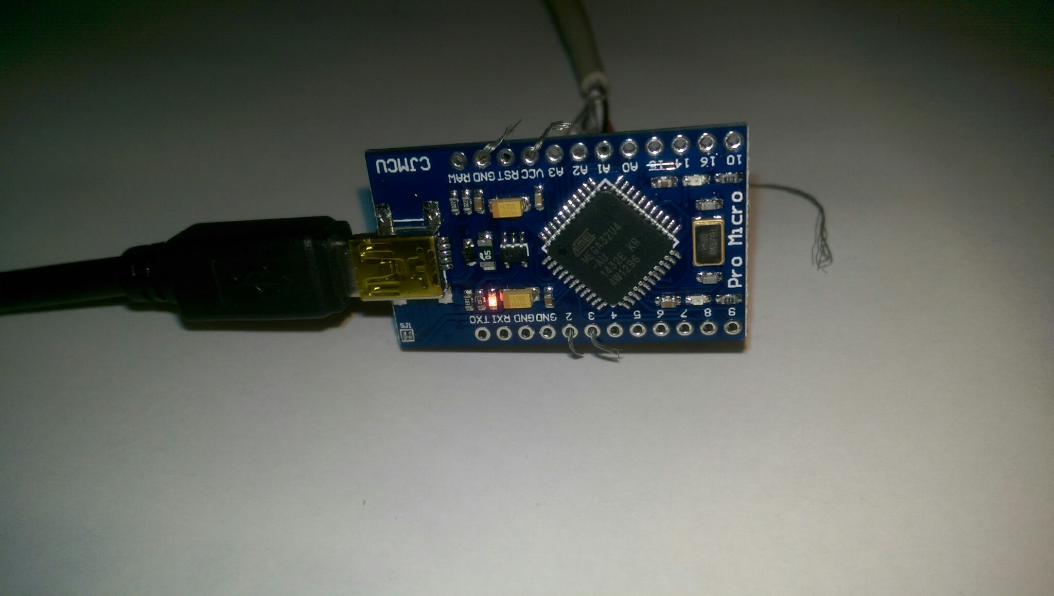

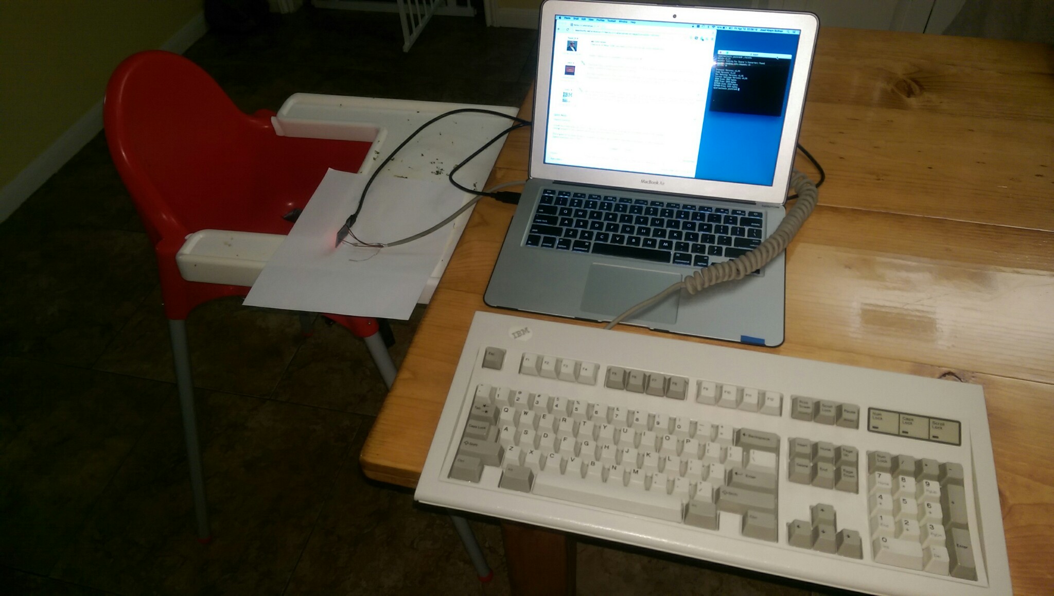

11 Apr 2015, 05:14
Well, I'm typing this post on a Model M 1391401 connected through a Sparkfun Pro Micro running Soarer's Converter. I did all the programming on my Mac.
The directions with Soarer's Converter are appropriate. I happened to have a spare SDL cable sitting around and these are my pinouts:
Red - VCC
Brown - PD1 - "2" on the Pro Micro
Black - GND
White - PD0 - "3" on the Pro Micro
Installing CrossPack from http://www.obdev.at/products/crosspack/index.html worked for me. This is the command I used for flashing:
avrdude -p atmega32u4 -P /dev/cu.usbmodem1421 -c avr109 -U flash:w:Soarer_a t2usb_v1.12_atmega32u4.hex
Shorting RST and GND twice in succession put the Pro Micro in bootloader mode. The tools work just fine and detect a Soarer's Converter.
It took me a little under two hours to figure all of this out, including: installing the (non-helpful) Arduino IDE, reading through a bunch of docs, determining pinouts, and some other trial and error.
This is great for my Model Ms and AT keyboards but doesn't get me ADB or other obscure protocols. For this I'll play with Soarer's Controller and/or TMK. This was just a "hello world" for getting started.
