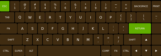

BrownFox layout is an mx mini with the bottom row 1,25-1,25-1,25-6,25-1.5-1.5-1-1-1 and without the 2° row?
Backspace is 1u?

pasph wrote:BrownFox layout is an mx mini with the bottom row 1,25-1,25-1,25-6,25-1.5-1.5-1-1-1?
mx mini with 1.5, 1, 1.5, 6, 1.5, 1.5, 1, 1, 1
but also what you suggest would be feasible.
Edit:
brownfox
pasph
05 Jun 2013, 19:43
your layout is really beautiful but
6 spacebar not really that standard
1 backspace?

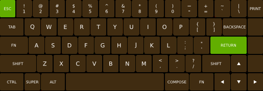

-[°_°]-
05 Jun 2013, 19:45
pasph wrote:your layout is really beautiful but
1 backspace?
fortunately I have quite a few 6u spacebars after DSA retro :) but a more standard layout is feasible.
backspace can be 1u, 2u, or 1.5u in place of \| key
Edit:
this is a "standard" alternative

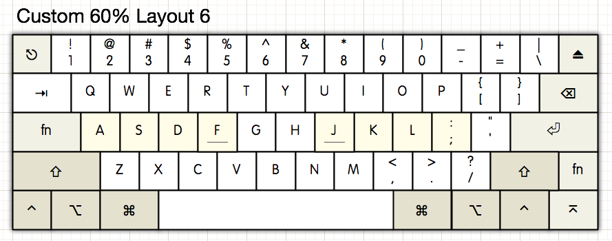

05 Jun 2013, 21:03
Good on you Pasph.
Right, this is my 6u space bar adaptation:
Custom 60% Layout 6
Custom 60% Layout 6
Picture 1.png (46.94 KiB) Viewed 9774 times
It's almost standard ANSI above row 1 except for the right hand shift, which is HHKB / Pure style with an extra 1u key to the right. Have you got the caps for this Matteo?
Are all the row 1 keys round profile on DSA or is it just the space bar? I can't tell from the PDF.
I'm going to get sneaky with function keys in the controller, instead.

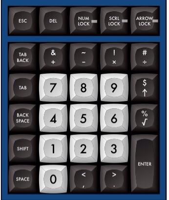

jpatters
05 Jun 2013, 23:02
I'd be interested in getting a plate cut for a numpad, if that would be possible in your run. I'm going to be using Matias switches, and I have no idea where to begin with the CAD drawing so that the holes are the right size. I'd also be potentially interested in doing a version for Honeywell hall effect switches.
Numpad
Numpad
05 Jun 2013, 23:29
If there's anyone who can use up a whole sheet, you're the guy!
From small numpads, great numboards grow.
-[°_°]-
05 Jun 2013, 23:37
Muirium wrote:Good on you Pasph.
this is doable, but if you want to go all blank you can't use dsa retro.
jpatters wrote:I'd be interested in getting a plate cut for a numpad, if that would be possible in your run. I'm going to be using Matias switches, and I have no idea where to begin with the CAD drawing so that the holes are the right size. I'd also be potentially interested in doing a version for Honeywell hall effect switches.
problem with Matias is that we need a 1mm sheet plate, so we would need some orders just for that.

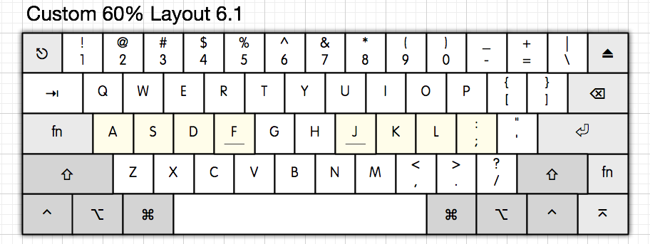

Confirmed layout for production!
Custom 60% Layout 6.1 Default Layer.png (48.65 KiB) Viewed 9702 times
Keeping it simple. Row 1 is 1.25 x 3. 6.25. 1.25 x 4.
Requires stabs for standard ANSI 6.25u space bar, standard ANSI left shift, and standard ANSI return.
Right shift is, of course, HHKB style. As is the top right corner, where there's two single keys instead of a standard 2u backspace.
One open Steely-style case and plate for this, thanks.
-[°_°]-
06 Jun 2013, 13:53
LOVELY design. Sweet like a pie.
06 Jun 2013, 13:55
Simple always winds up sweet.
Now I've finally stopped fiddling, you're safe to make it!

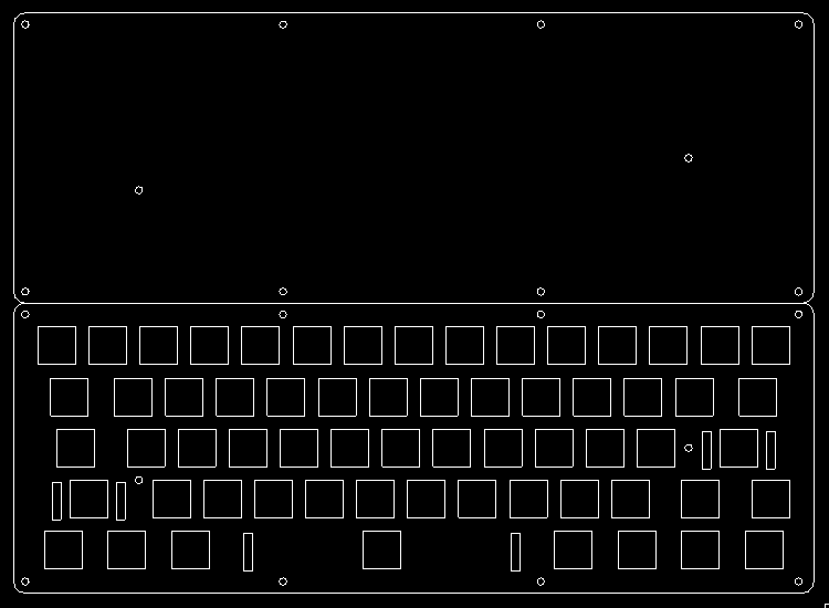

11 Jun 2013, 18:25
case is in production... :)
