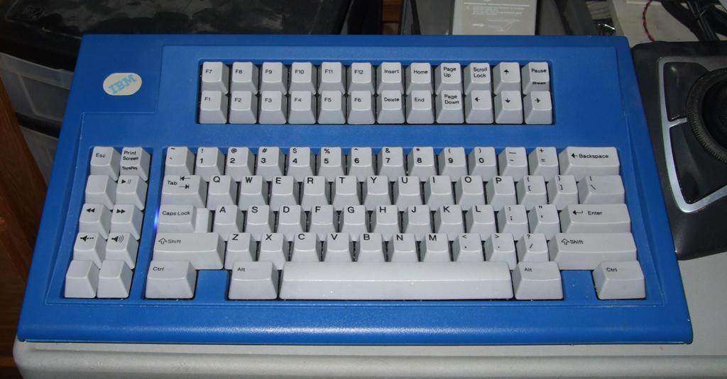

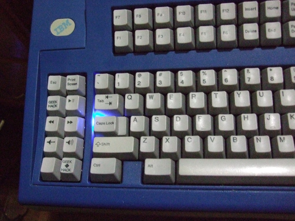

for my caps lock on my custom model M, i use under key cap lighting. a light pipe sends the LED light through a rivet hole. light spill out around the caps lock key. the light pipe is a tight fit and could be sealed to the barrel plate to maintain water tight seal.
As some of you know, taking pictures of LEDs is difficult. With flash, the LED light is washed out - without flash, the LED light is blinding. attached are one of each. IRL, it looks great.
And a side view ...
