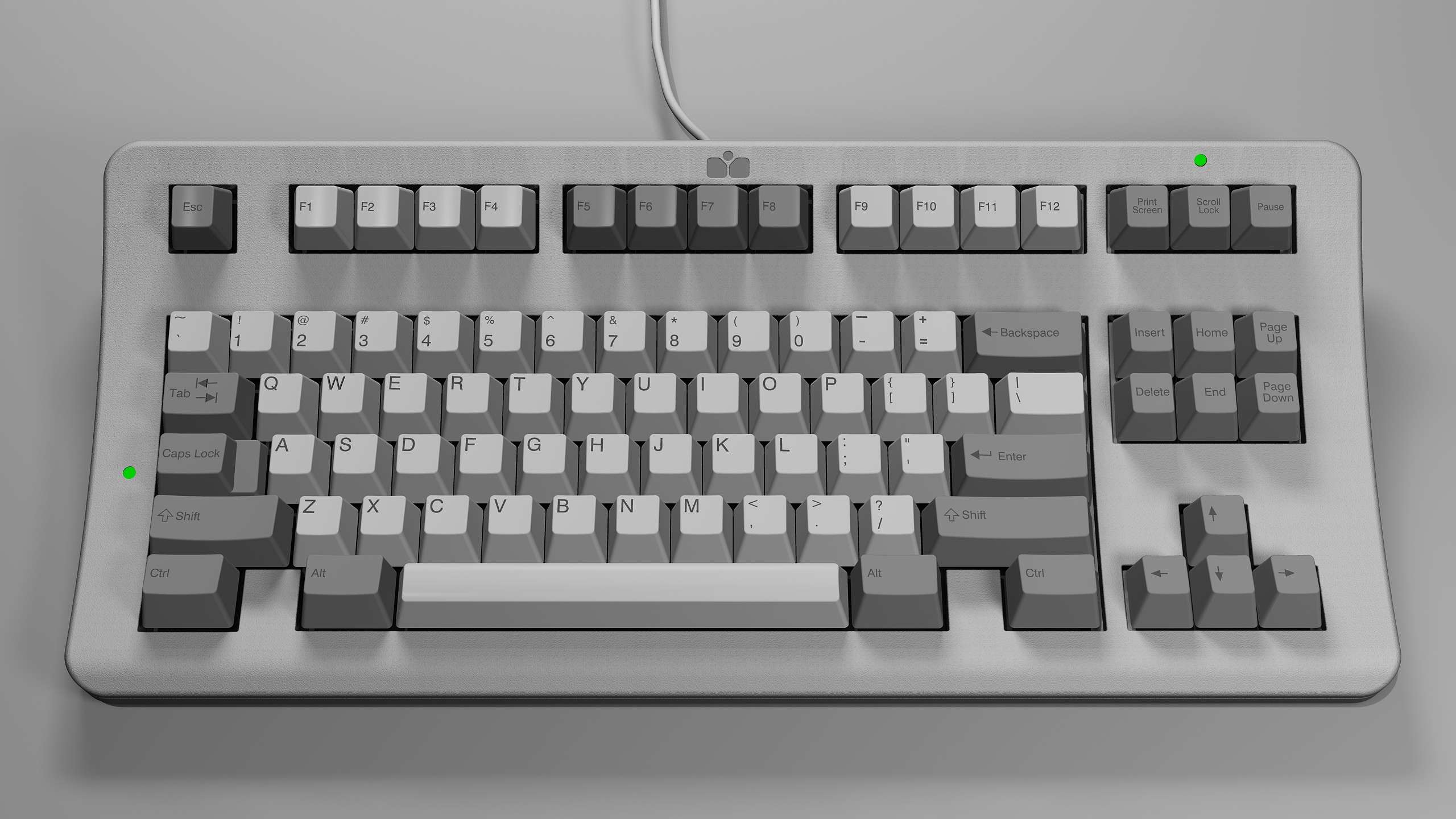

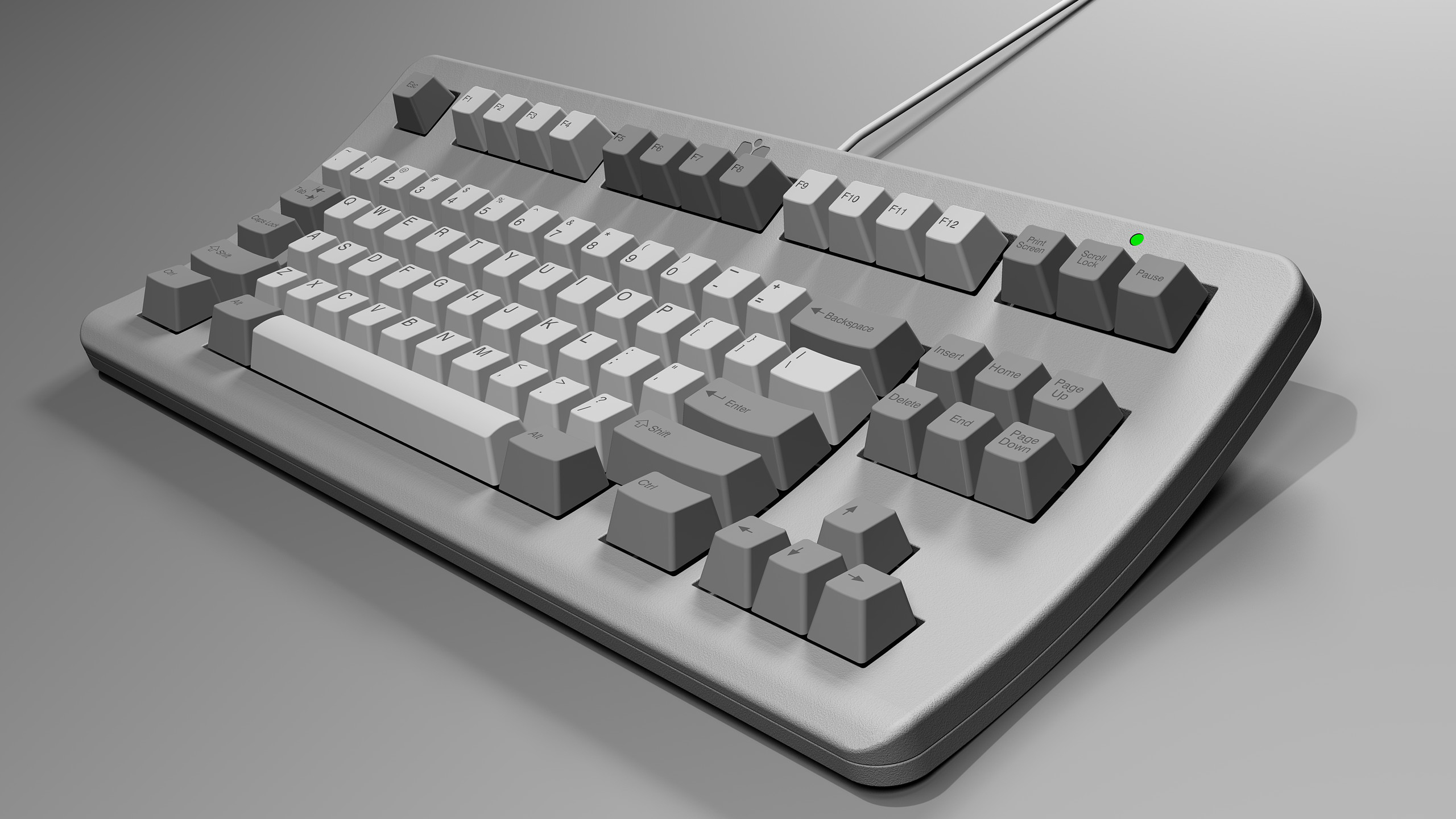

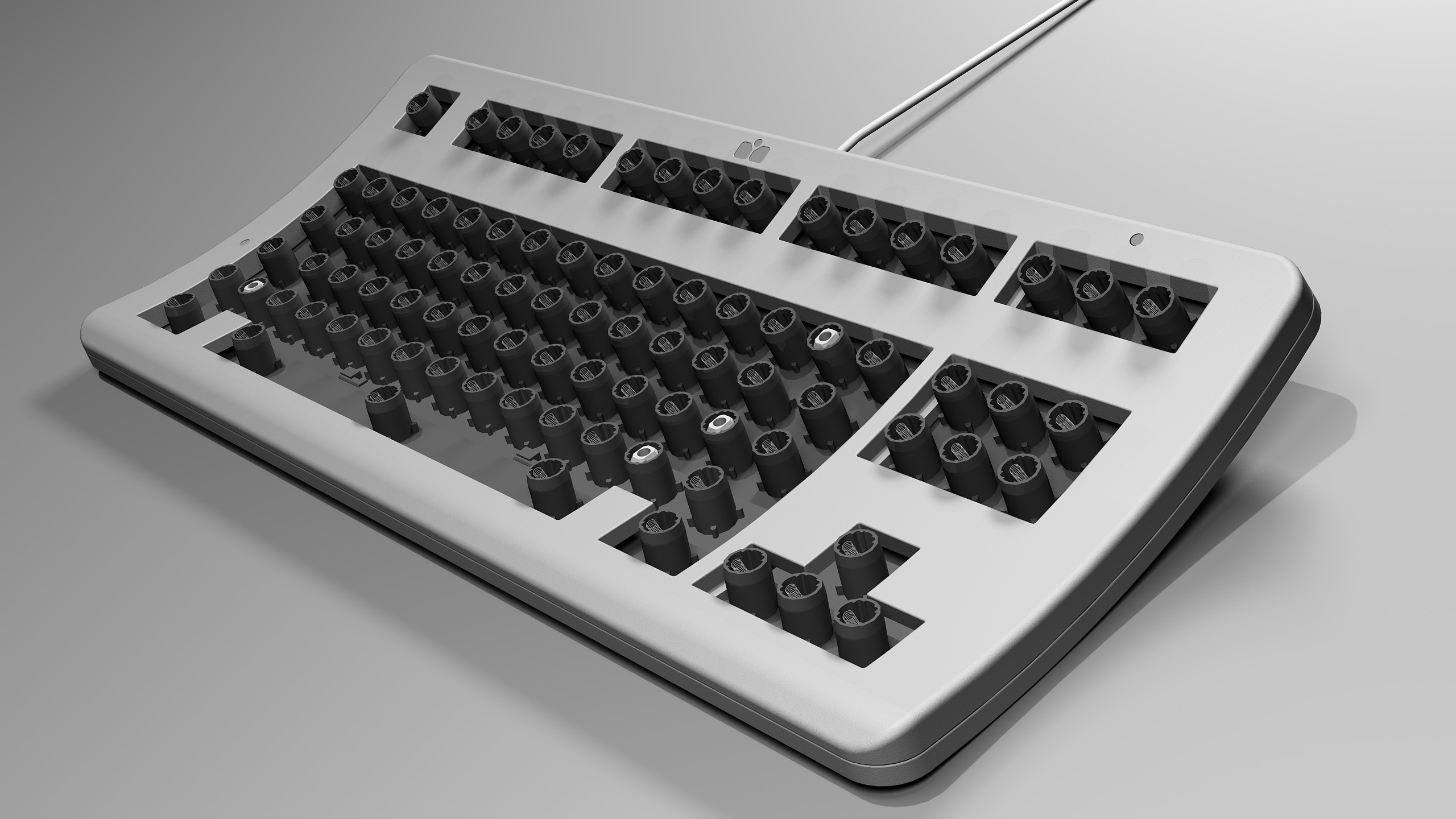

A proposal for a new SSK

great project M'er. thanks for sharing. Just for the sake of conversation... I would like to see a slimmer case with less wasted space on the sides and a function row closer to the alphas.

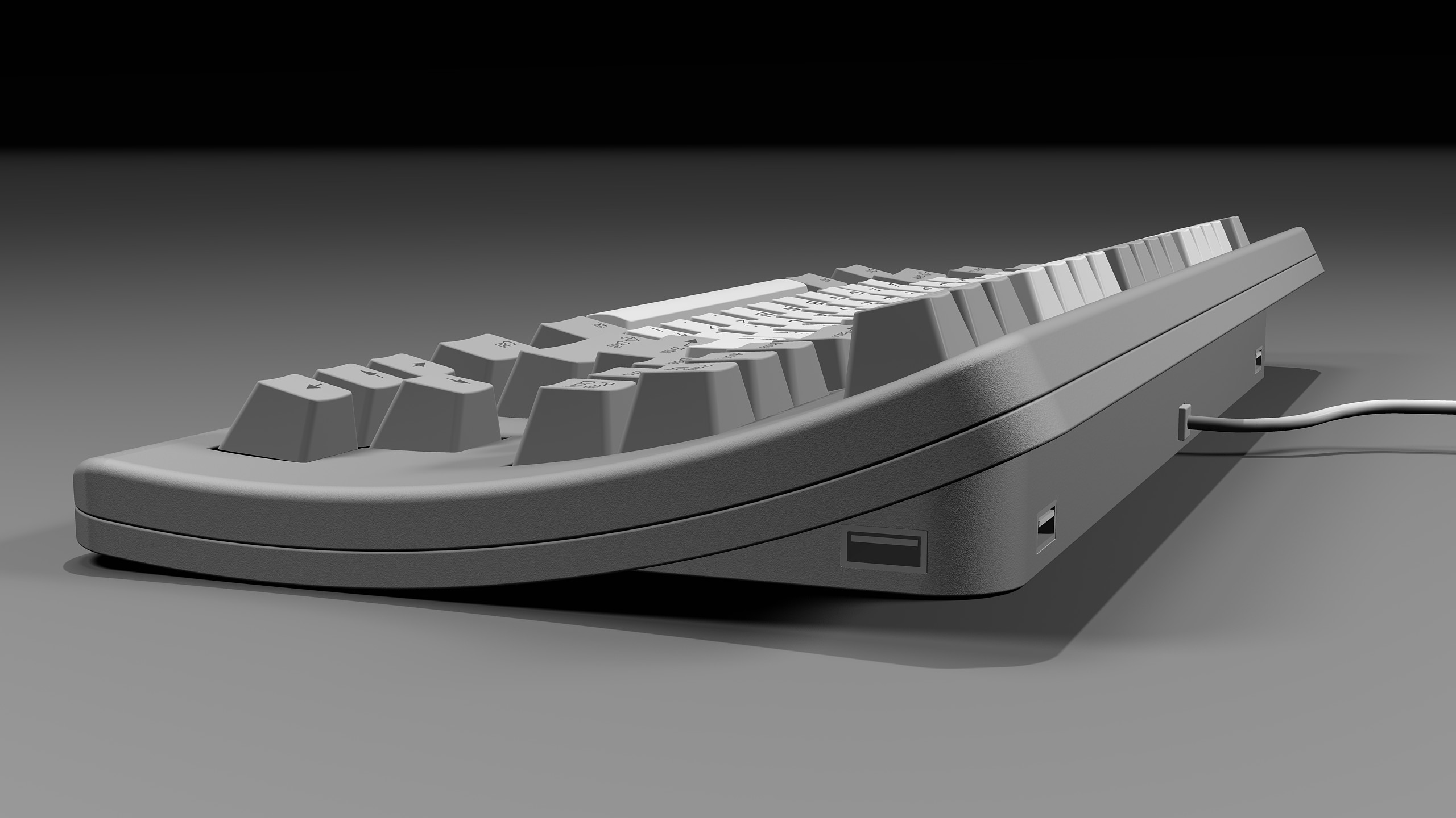

Also I do hate USB hubs on keyboards, but that's a personal thing. As you say, wireless would be bliss of course. Also the position of the caps lock LED doesn't drive me crazy.
- Daniel Beardsmore
- Main mouse: MS IMO 1.1
What's wrong with having integrated USB hubs? It gives you somewhere to connect additional keyboards without needing the bulk of an actual hub :-) (Though in the image, the positions are a little bit obscured from easy access.)
On the other hand, I use the Windows key extensively.
- matt3o
- -[°_°]-
- Location: Italy
- Main keyboard: WhiteFox
- Main mouse: Anywhere MX
- DT Pro Member: 0030
it's just a personal preference, I understand many likes USB ports on the keyboard but:
- a keyboard should do the keyboard, period
- 99% of the times the USB hubs on keyboards are badly implemented (low amperage)
- a well implemented hub on a keyboard would draw unnecessary power
- I have 2 usb ports on the front of the PC, half a dozen to the back, 4 on the monitor... (heck I don't need more)
- usb ports on keyboards tend to be ergonomically wrong (always on the wrong spot)
- CeeSA
- Location: Westerwald, Germany
- Main keyboard: Deck 82 modded
- Main mouse: MM711
- DT Pro Member: 0016
I like USB hubs in the LCD. Because there you got full power with their own power supply.
I would like to have a slimmer case like matt3o and detachable cable (with cable management).
At my wishlist would be a track point and a programmable controller.
- Location: Stockholm, Sweden
- DT Pro Member: 0011
I think that the case should also include:
- Detachable cable. Either (large) USB B, or micro USB B.
- Cable channel for routing the cable left, right or centre. I think that a cable channel for a Model M should allow the cable to come out at the classic position.
I think that I may have seen a Model M with a cable channel, but I am not sure - might have merely been a lookalike from another manufacturer.
I agree that a USB hub is not necessary. My monitor has a powered USB hub, and it has a power cable anyway while I don't want a power cable to my keyboard - I would prefer a single cable to the keyboard.
There are keyboards that instead of hubs have pass-through for USB, so that the single port can be adequately powered. Sometimes there is also passthrough for headset - I have not tried such a keyboard, but I find it interesting.
A cable on the side would be mostly in the way - remember the Macintosh keyboards did not have their ports on the side but actually on the back only facing sideways.
I think that the perfect width of a keyboard's case border is either 1/2 or 1 key-units, and uniform. The Unicomp "space saver" (not TKL) has 1/2 wide side and back borders and 1 unit front border. A uniform 1 unit border for both front, back and sides would be best for this keyboard, I think.
- Muirium
- µ
- DT Pro Member: µ
I like the Apple Extended II style of your sweeping case design. Anyone ever TKL mod one of those?
But I do wonder if there's enough space for the full buckling spring mechanisms. Have you worked on the inside too?

Another option for 6KRO/NKRO would be to let the back membrane be a semi-rigid PCB, like the one in the Model F, only with surface-mounted diodes on it. The diodes could be placed so that they are in spaces under the barrel plate and with matching holes in the top and middle membranes. Or, alternatively, surface-mounted on the back of the PCB.M'er Forever wrote:I would like to see NKRO (at least up to the 6KRO limit of USB protocol) and this could be provided by using capacitive switches like in the Model F (I believe, correct me if I'm wrong) and this would eliminate the challenge of mounting isolation diodes on the membrane circuit.

- SSK_new_4a.jpeg (370.02 KiB) Viewed 17798 times

It requires a diode for each switch.
- Daemon Raccoon
- Location: Flyover Country, United States
- Main keyboard: Model M SSK 1391472
- Main mouse: CST2545W-RC LTrac
Yep, the Model F needs no diodes achieve NKRO.

They did indeed. The Model M2. Here is a shot of its barrel frame:M'er Forever wrote:At one time IBM made a thinner version of the Model M, but I don't know much about it. I believe it used a low-profile version of the buckling-spring barrel frame, but need to confirm that.
M2's aren't generally as highly prized for their feel (let alone longevity) as classic Model Ms. But they are as compact as the buckling spring design ever got so far.
The way the Model F senses capacitance isn't by a membrane sandwich at all. It's more like a Topre keyboard: there are sensor pads which make no physical contact with the key mechanism, and whose capacitance is altered by the nearby presence of a metal component of the moving switch. The Model F uses a metal "flip plate" (where the F name comes from, while M is for membrane) instead of the plastic foot on a Model M's spring. F's feel better to me and many who have them because of that metal flip plate. It's movement feels tighter, and has a pleasing metallic effect on the click.
