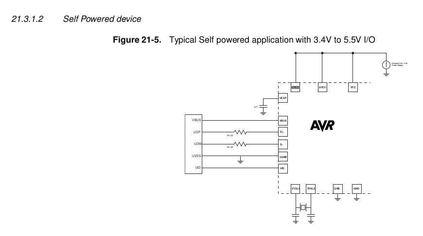

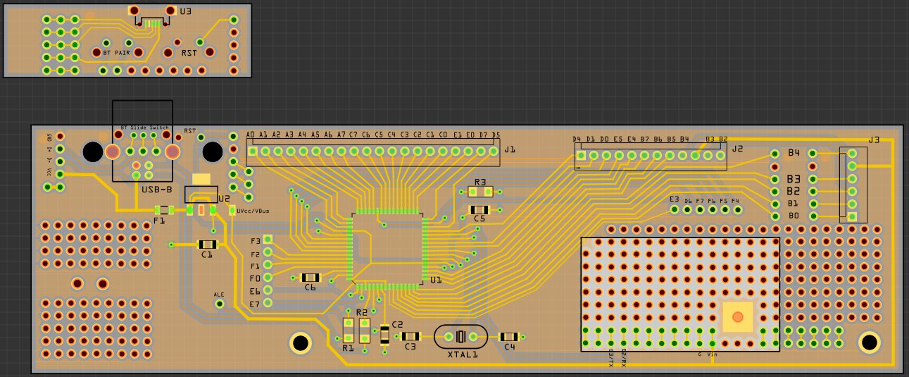

If nobody use VBUS function we can forget my VBUS concern. I think it is useful to someone and I used VBUSTI thourugh LUFA to initialize USB engine in proper timing(plug-in) in my Bluetooth Controller.
But I'm not insist that it is indispensable. I'm just reviewing PCB design, I for one don't have plan to use Bluetooth on Model M.
As datasheet indicates, VBUS pin is typically connected like this in self powered device.
phosphorglow
13 Mar 2015, 04:07

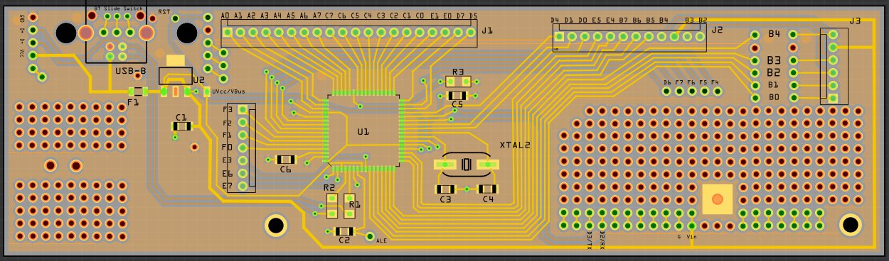

Excellent! Thanks everyone for your feedback, I think this most recent revision will suit the needs of just about everyone. You can tell it's getting serious now that there's a ground plane... ;P
Now there's some options to play around with regarding the voltage regulator and what paths to use based on different needs or preferences, even if they're remote.
Moved E3 D6 F7-4 to the right hand side. Not sure if I'm keeping E3 right there quite yet. No big deal.
Used some of the blank space on the left hand side for whatever.
Bluefruit EZKey vaguely placed with convenient traces in the event that it actually fits and works right there, if not, no big deal - wire it in and place it elsewhere.
This is about as "official" as Version 1.0 gets. Super excite.
Need to go through and double check all the ground fill vias and add in the copper fill for the top.
...I'm still thinking red PCB...

Impressive !
Let me add some possible improvements:
1.- I could not find a reset button. A real push button, optional. This would help in the possible debugging.
2.- The oscillator could be moved to the opposite edge to ensure that it does not hit the metal plate.
3.- It could be good to add an isp interface also.
chzel
13 Mar 2015, 08:24
I would move the xtal closer to the uC, it should improve reliability. Shuffle the tracks a bit and don't use vias, you have enough room, and the matrix tracks can be a bit longer to go around the xtal.

13 Mar 2015, 16:28
White might make sense Inside beige or industrial shells. I always like the barrels being white. But then again red is the best PCB colour in general.
Definitely needs an Oh Shit! button though. For reflashing / general unbricking.
phosphorglow
14 Mar 2015, 04:20
Thanks! :)
- Reset button: it's there next to the USB-B, and on the optional micro USB mini board. Both of which will be accessible with a paper clip. Or the same style switch with a longer actuator, depending on preference. The actuator is blue in the pictures, so that's probably deceiving.
- Crystal being moved: done! Thanks for bringing that up. I've been meaning to do it but didn't feel like fussing with it. Now it's surface mount with no vias. Technically it fit before without hitting the steel plate, but I like this way better now.
- ISP interface: technically it's there, but not as a single block connector. MISO/MOSI/SCLK, reset, Vcc and ground are all accessible.
- White solder mask... They're gorgeous. But red... Red just looks like it means business.
- Side notes: I moved R1 and R2 in such a way as to remove two vias which seems important for the USB data lines. Aaaaaand... There's another side note, and probably another note to the side of that. *stares off blankly for a few moments/minutes*
Oh. That's why. They were tangential. Right now I'm futzing about making sure the ground planes don't have dead spots and adding vias as necessary. The side-side note was about Fritzing. It's a really awesome program if you have no experience with other design suites, and really gets you acquainted with the flow of things. The parts editor and libraries need some time to evolve, but otherwise it's been rather intuitive. I'm having an easier time learning to use Eagle now, even though a lot of things are quite opposite.

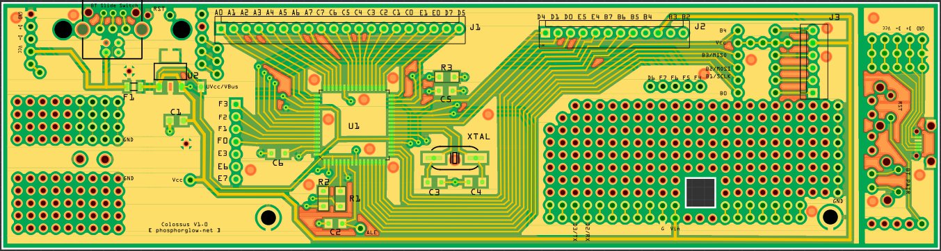

Updated layout:

So here's version 1.0 as submitted:

Of course, even after hours of staring I still found a few small errors which didn't show up until after they've been manufactured. They're small, but they annoy me.
- C1 is attached to the output of the voltage regulator. Really would have preferred for it to be before. Not a huge issue, and if it is I can cut the trace and run a small wire.
- For some reason I labeled a through hole attached to Ucap as ALE, which it most certainly is not.
That's it, I suppose. Version 1.0001 can happen eventually with fun changes.

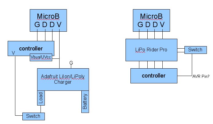

In the meanwhile, here's the idea I have in my head about the Lipo situation for both Adafruit LiIon/LiPoly and the Rider Pro:
I'm thinking this is the simplest setup for what we have?

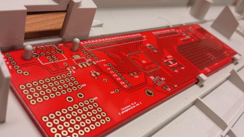

phosphorglow
26 Mar 2015, 00:52
HEEEEE! It's so pretty! Drills are perfect, fits like a glove, and the red is meeeeean! Mhuahah. The notch fits perfectly for the boards with the smaller controller. I'm cursing myself for not ordering the components one day earlier because I want to solder one oh so badly right now. Everything checks out with my ohmmeter too. I was worried that the mounting posts weren't going to line up that well, but I got it right on the spot. Weeeee!
Should have gone slightly thicker than 1mm, but whatever - it's perfectly fine and I know for the next time.

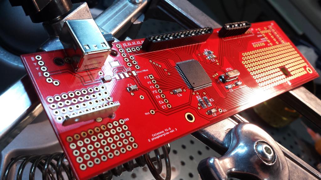

First one assembled and I'm using it in my SSK right now! Picture! Exclamation point!

I am impressed, very impressed !
I have not understood what software are you using ...was it explained before ? Am I missing something ?
