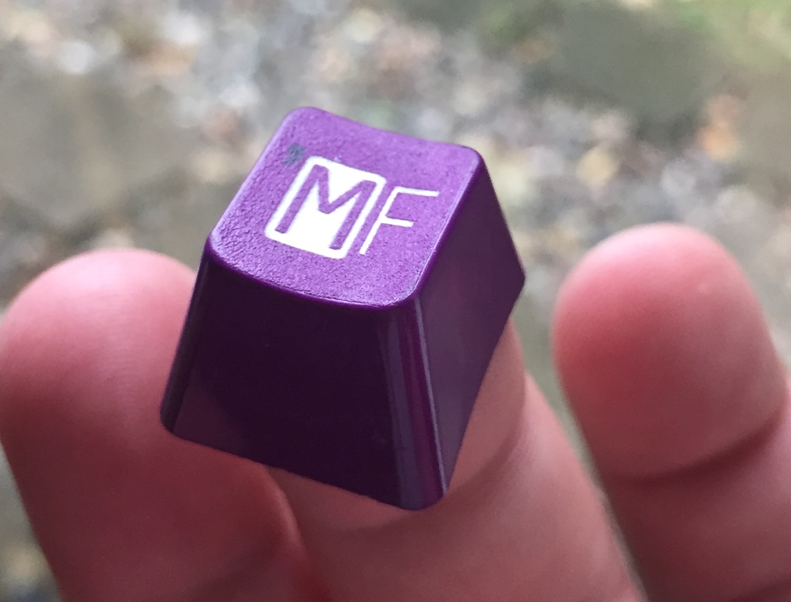

You could go three color with dye-laser-dye-laser. The background color would be the combination of the cap color plus both dyes; area hit with the first laser would just be the cap color plus second dye; area hit by the second laser would be just the cap color.
lot_lizard
24 Sep 2016, 18:01
E TwentyNine wrote: I'm wondering about the potentials here if there's a fill material of the right consistency that will also maintain a bond with the cap over a long period of time.
It would be a artistic/tricky endeavor, because you are double shotting in the reverse order. The only ways I could see a hobbyist do it would be using some vacuum sealer to put a membrane over the cap tops, and then come back and inject into the channels. Or something that was self leveling that you just injected free hand. If you used something that was isopropyl alcohol soluble, you could clean up excess pretty easy with either method. Certainly a lot of work regardless, but doable. I don't think durability would be an issue though no matter the approach.
To be honest though, I'm not sure it really buys you much over this method. If we could work out a process where we knew the dyes were durable that is. If that was solid, this method is certainly easier to net consistent crisp results in bulk.
Additional shot with natural lighting that captures color and texture better. It really does look nice in person

lot_lizard wrote: Additional shot with natural lighting that captures color and texture better. It really does look nice in person
Beautiful! Interesting how all that great PBT texturing is gone in the large lasered areas. Is there a setting that would randomize the cut depth per pulse? If so, maybe a final re-texturing pass would be good when removing larger contiguous areas.

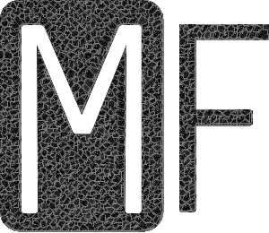

It really won't be a setting in the laser itself. You would accomplish that type of effect with something similar to the following (versus all black). The power of the laser at a given point is controlled by the level of darkness of the image it is attempting to engrave
E TwentyNine
24 Sep 2016, 20:55
lot_lizard wrote: The power of the laser at a given point is controlled by the level of darkness of the image it is attempting to engrave
Maybe someone could do a depth scan of a MF cap, convert that to a greyscale and use that as a mask.
Way, way, way overkill. But we are picky fuckers after all.

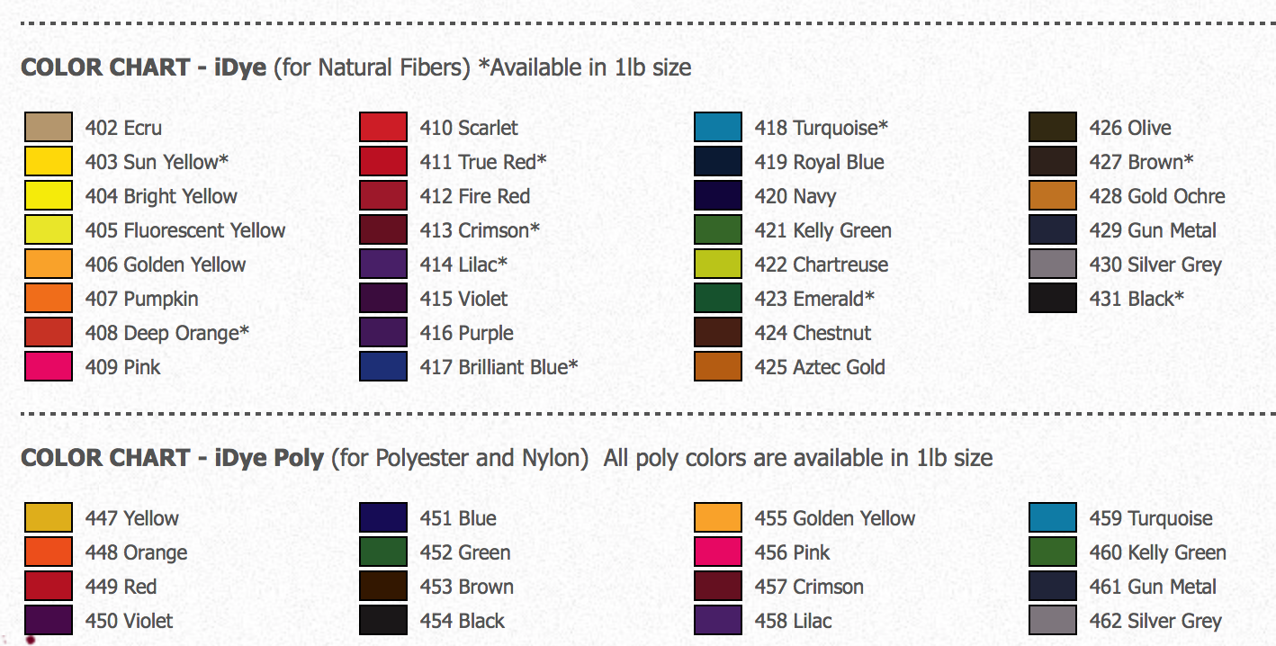

On this vein... Assume we only do a MF novelty cap this first time around for Phase 1 (trial effort) for maybe 1-2 bucks a pop. What color combinations would we like to see? I will start a vote after you kick out some options. I realize we could order even a single cap from Unicomp, but we have to go through the dye process. I would only want to dye caps in bulk. Yell out some combinations that are interesting from the following. I have my own ideas, but won't taint. I would be willing to deeply engrave any cap color later (not two tone). This is asking for color options where dyes are used.
Cap colors are the dye
Screen Shot 2016-09-24 at 2.28.16 PM.png (969.57 KiB) Viewed 7563 times
Font colors are the Unicomp key cap

The test caps were iDye Poly (Black and Violet) on vintage pearl (early 1990s M122). Cap starter color should be as light as possible; white should give the most predictable end result. I would suggest that we stick with the iDye Poly as PBT is more like Polyester or Nylon than cotton or wool. Longer time in the dye results in deeper, darker, longer lasting color. I don't remember how long these were in, but the reds in my signature were about an hour at about 90C.
lot_lizard
25 Sep 2016, 00:08
Based on feedback, I don't even think we need a vote. It sounds like everyone is comfortable with "brilliant white" as a cap font. And for the dyes... I would like to make available the following (agreed with WCass... these are the poly dyes)
  • 448 - Orange
  • 449 - Red
  • 450 - Violet
  • 452 - Green
  • 454 - Black
  • 462 - Silver Gray
The blue is the one that is a bit "messy". It is a color we are picky about (as humans). I am not sure if the 451 - Blue will be too Royal, and am afraid the 459 - Turquoise is a bit too "Caribbean". That is the one in the unknown. I plan to dye until no further pigment is available (saturation) for each.

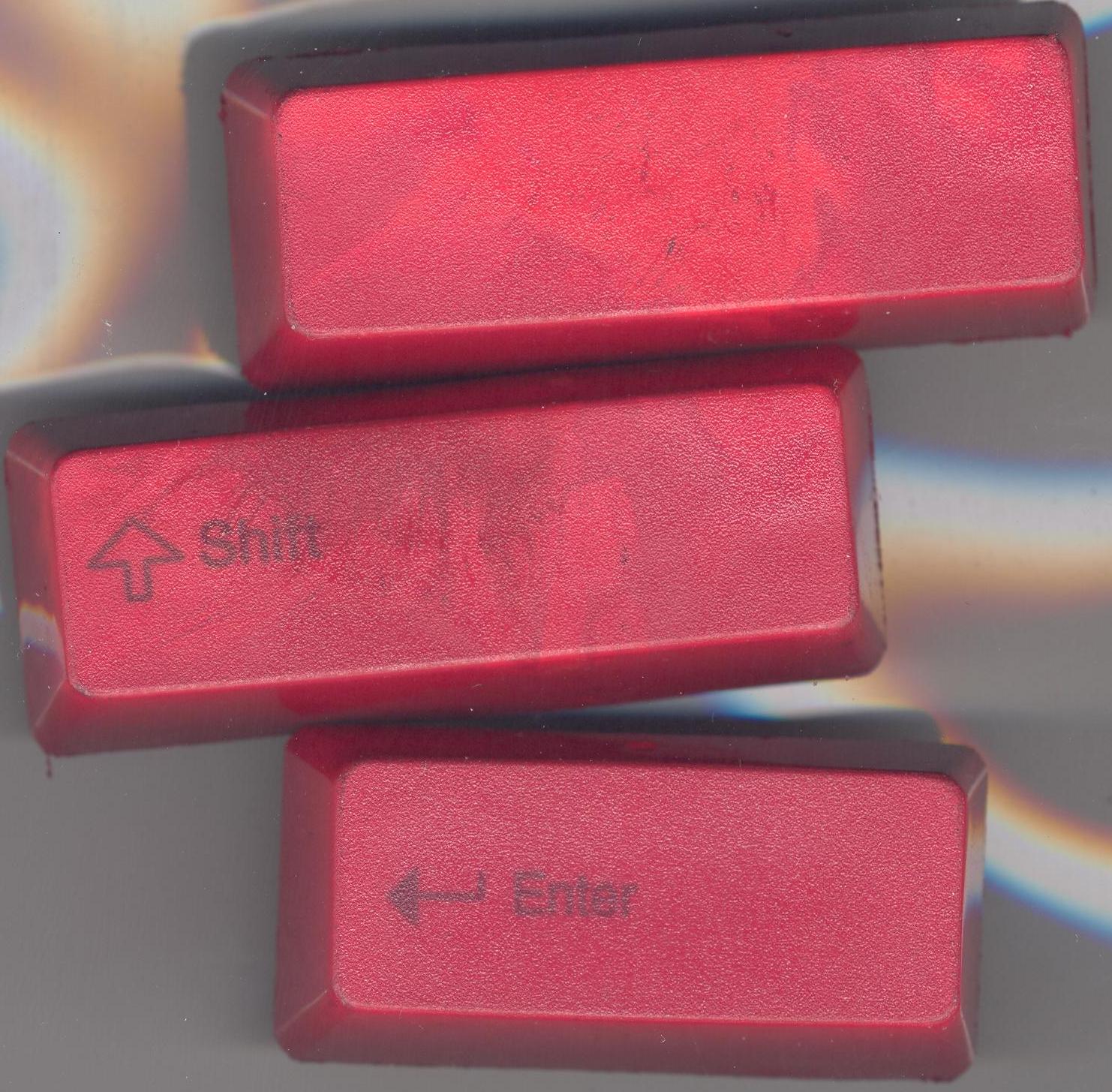

I dyed a set of printed bright white caps Red a while back and the color came out lighter than my 5 year old RIT dyed batch and was splotchy. I suspect Unicomp may have treated them with something that would wear off with use (maybe just mold release). You might want to rinse them with a stronger solvent than alcohol before dying. All three of these were in the same batch.

wcass wrote: I suspect Unicomp may have treated them with something that would wear off with use (maybe just mold release). You might want to rinse them with a stronger solvent than alcohol before dying. All three of these were in the same batch.
wow that is surprising. I might give them a full blown chemical bath in the parts cleaner then. I know it won't hurt PBT, and is more effective than any ultrasound cleaner

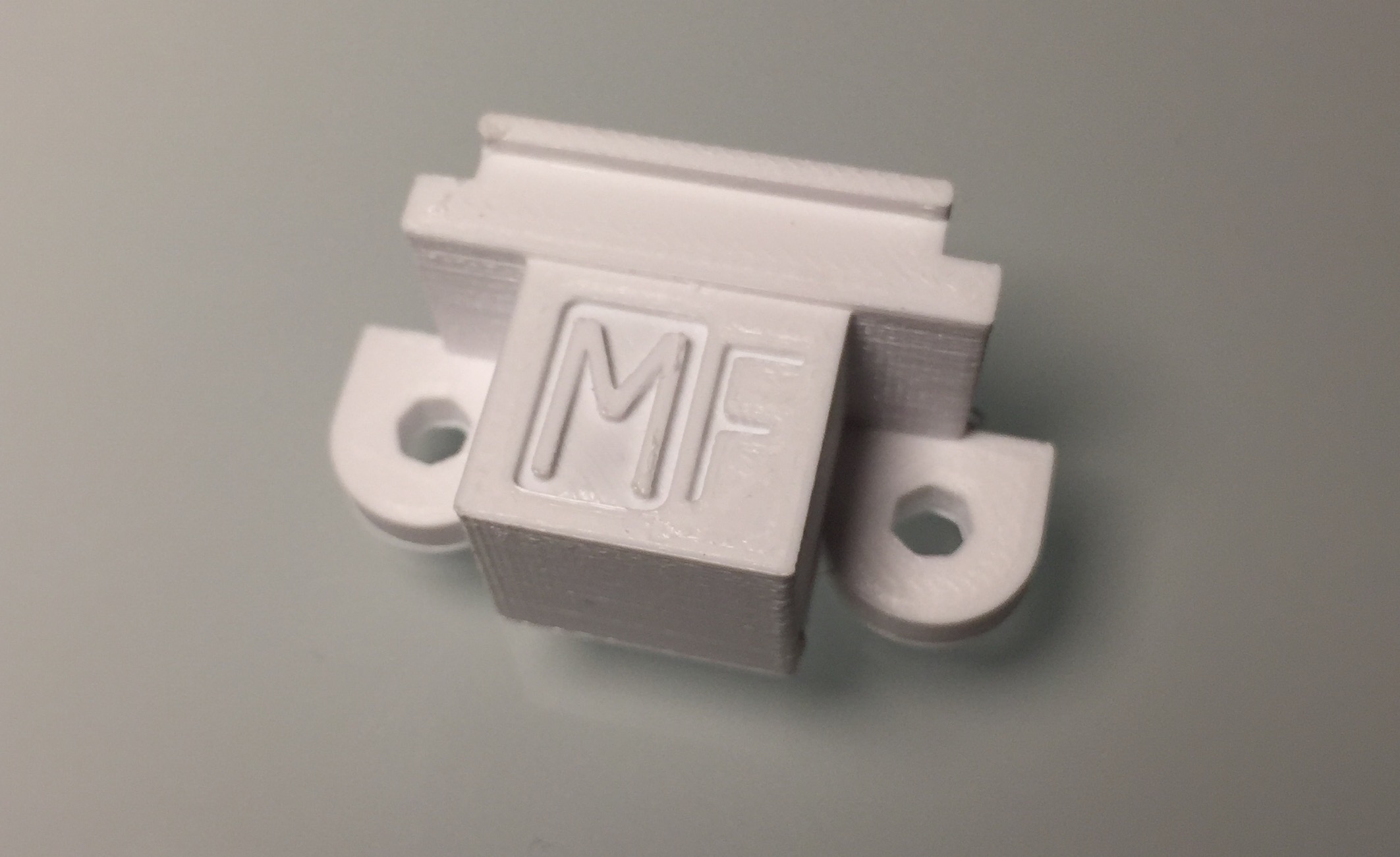

Finally dialed in the settings for the coplyester (thanks Wodan for the initial settings lead). I ended up reversing the image for the propaganda, and adjusting some speed/heat/fan settings, but the end result is really good (FINALLY). Let production begin. Thanks andrewjoy for the material tip. This filament (PET) is much more resilient than the PLA (though tougher off the spool to make "work")

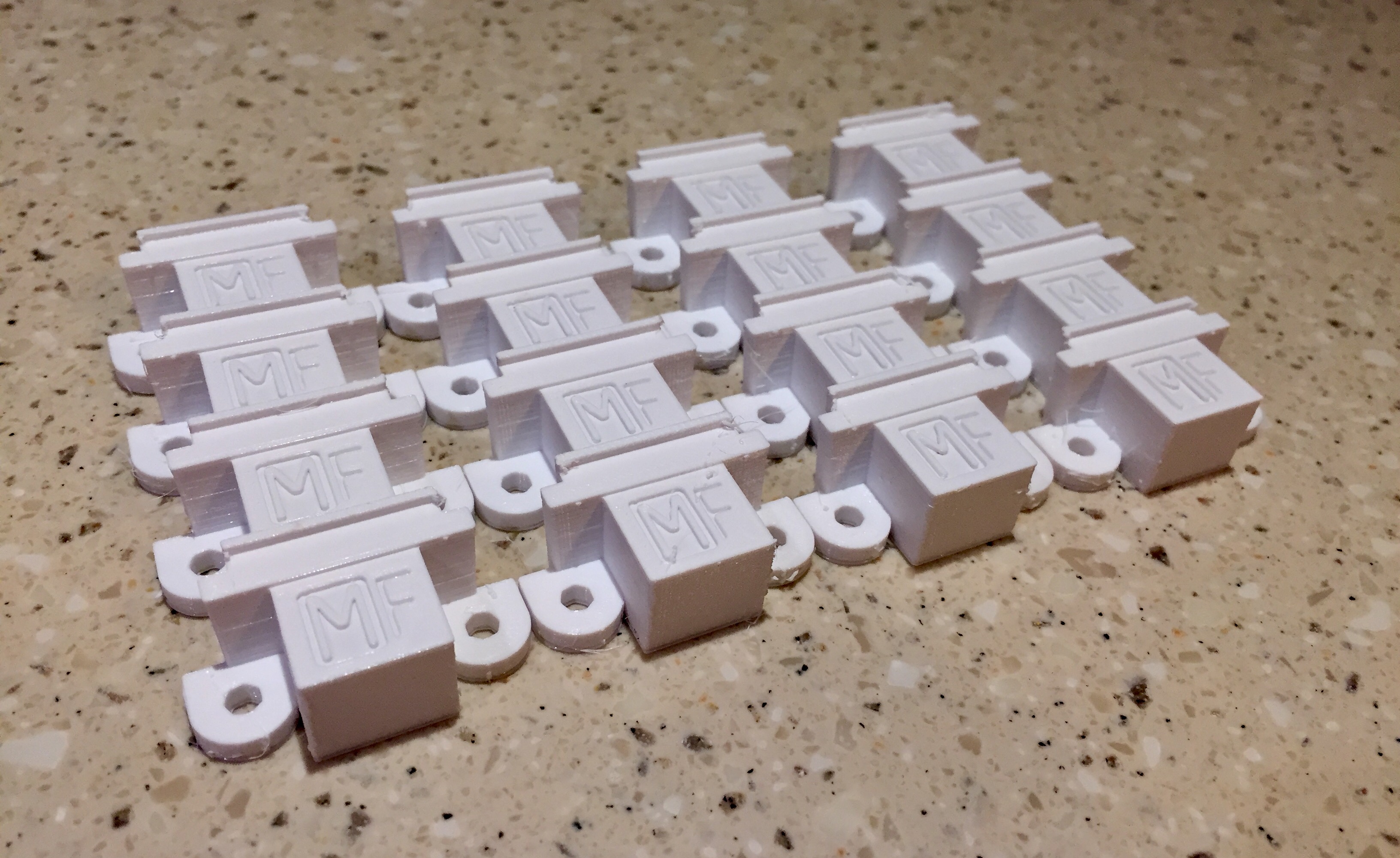

Work has gotten in the way of progress, but I did come home to our first batch run on the printer. Small cleanup all the way around on the pieces (was expected), but glad it wasn't an unattended plastic "ball of mess". I've ordered a few poly dyes, and have some test pieces to try color matching to the standard case (should be pretty easy) and the industrial case (expected to be difficult)
