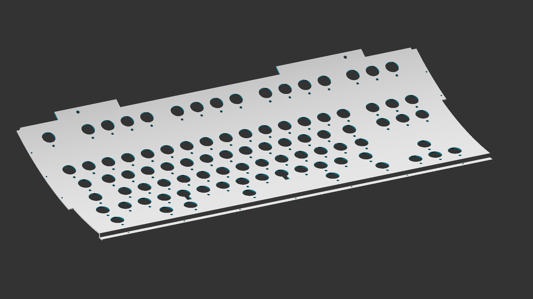

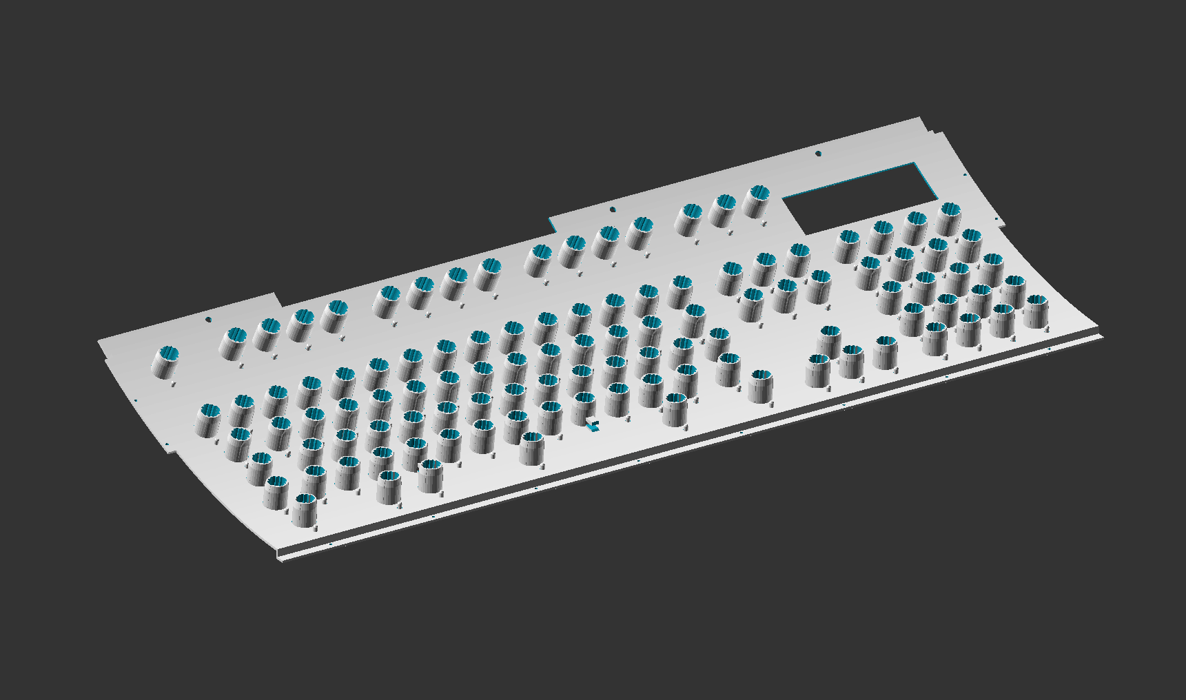

  • Top Plate
    Model M SSK 84-key top plate adapted to use F barrels from XT/Bigfoot (temporarily since I had on hand).  The stabilizer cutouts will make more sense as you continue
    Top plate from above

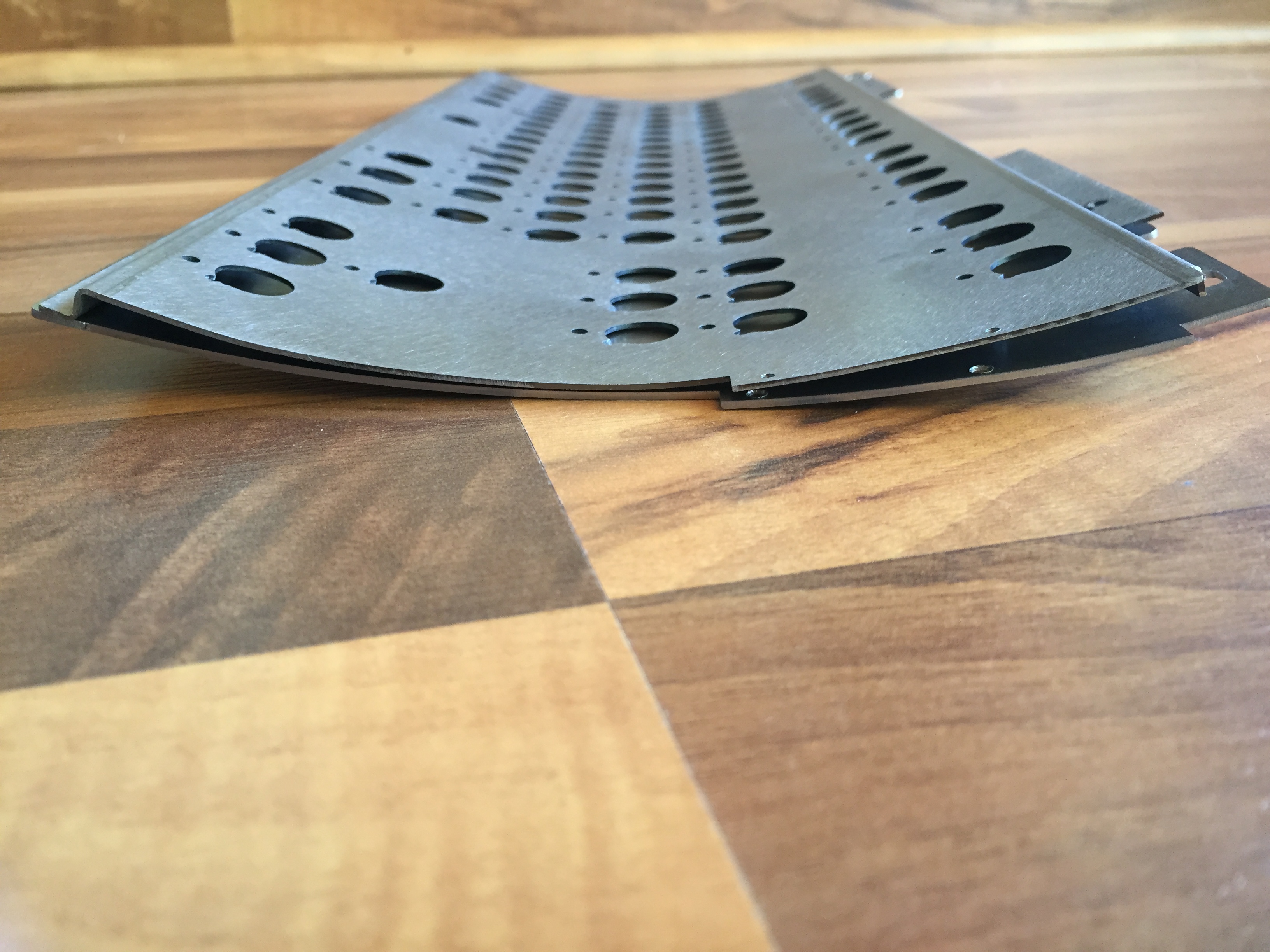

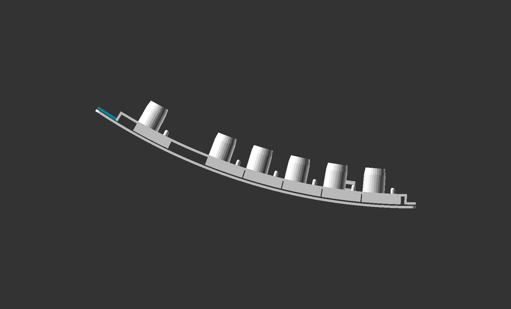

    Top plate side view.  The radial bend is 285mm, when matched with the bottom plate 300mm radial bend, the resulting assembly is ~295mm (matching the M)

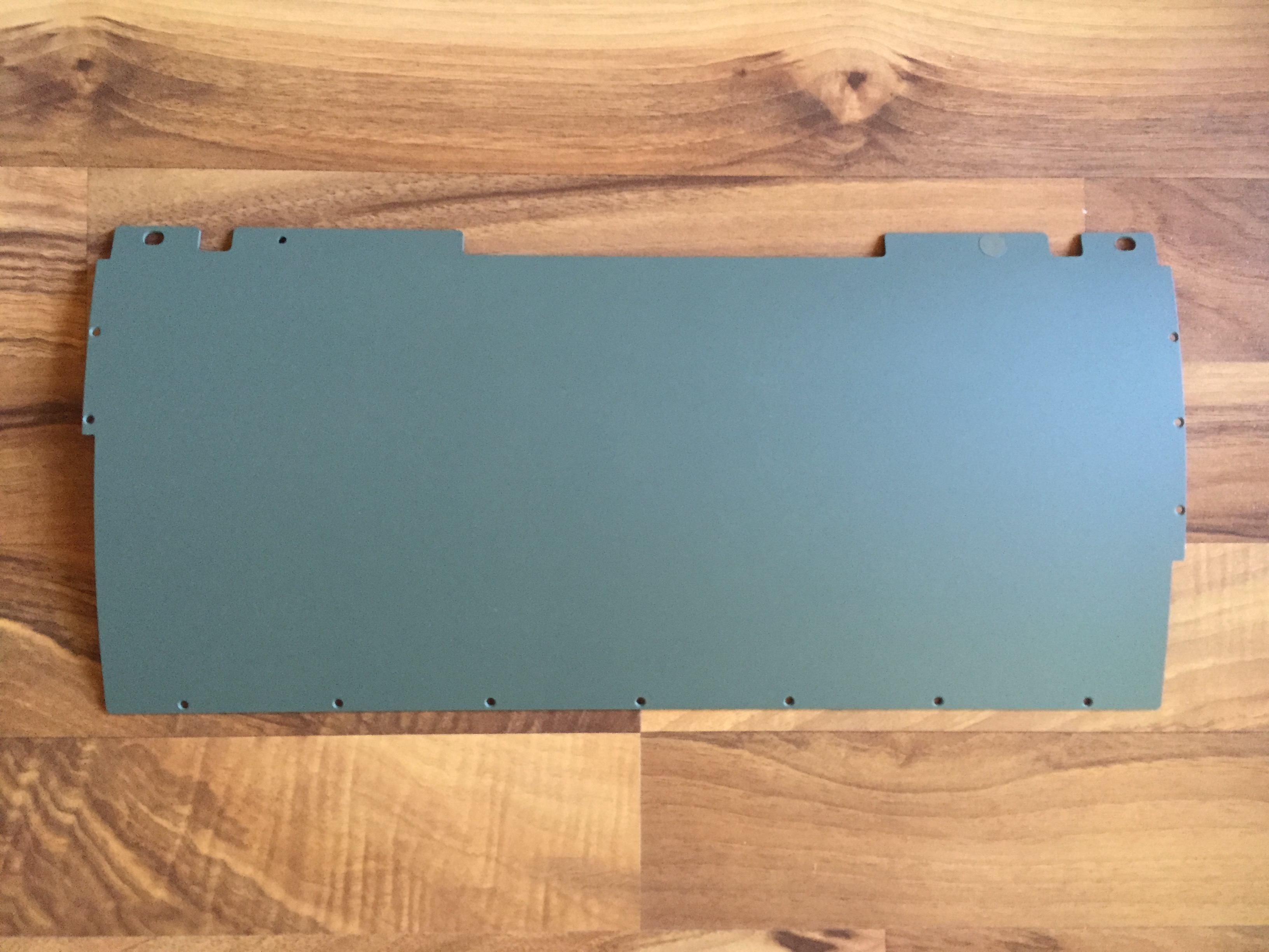

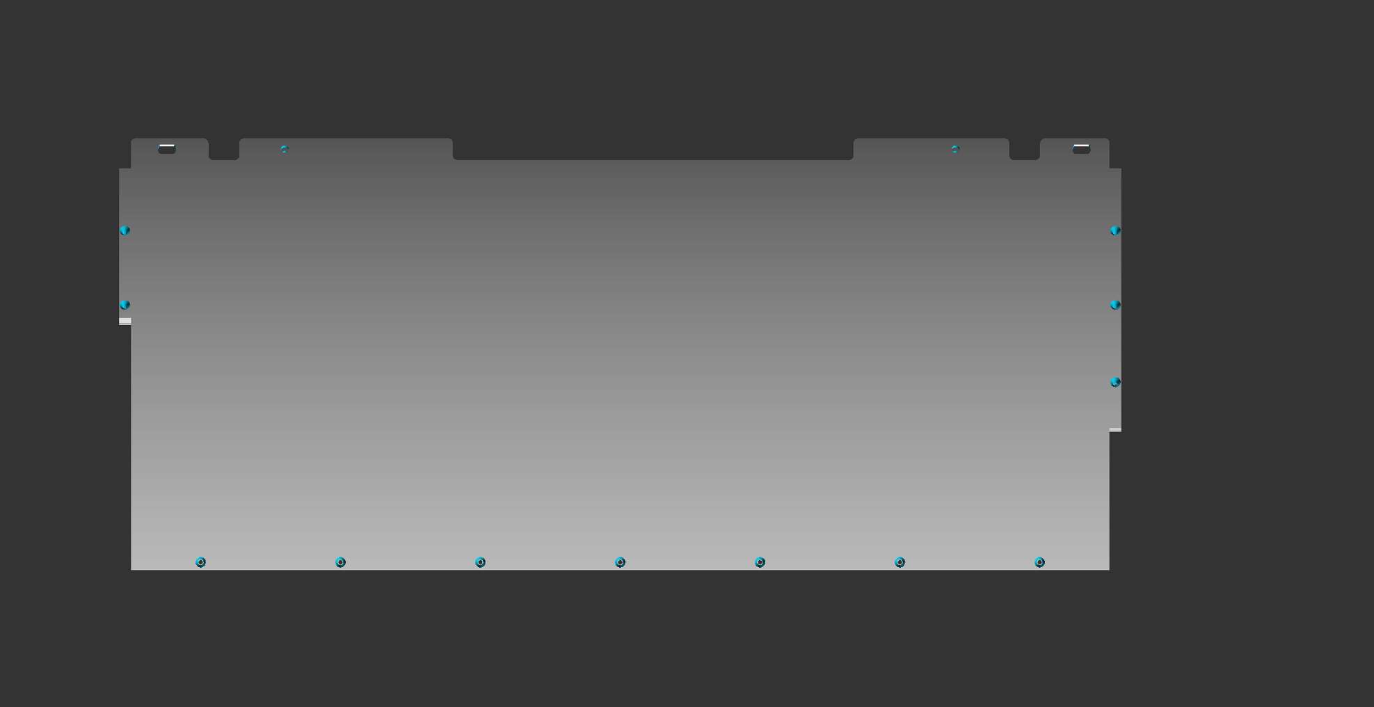

  • Back Plate
    Bottom Plate from below with counter-sunk M2 screws.  The new approach uses screws vs compression tabs like the F (which I have never liked)

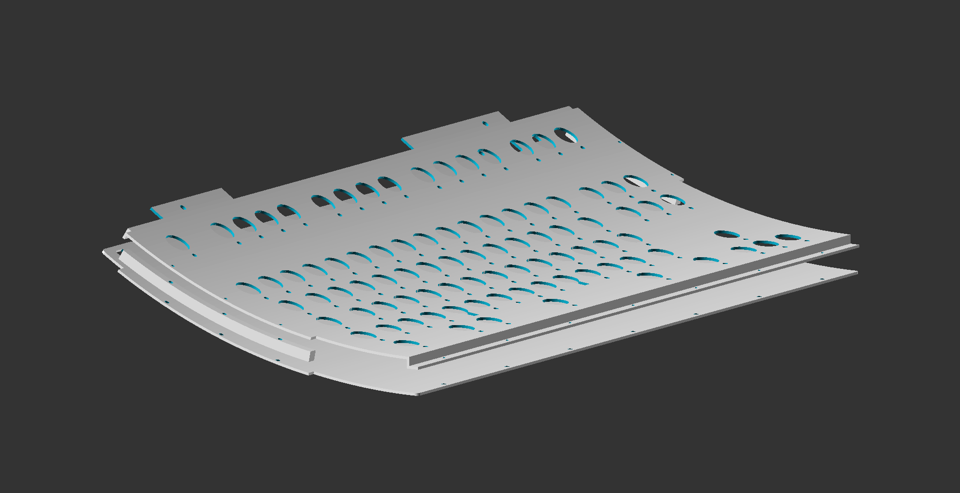

    Assembly with spacing added for visualization.  On the sides are spacers to help solidify the construction since there was space in the SSK shell for them, and bonding a radial arc is best done on the curved portions of the cylinder
    Assembly spaced from the side

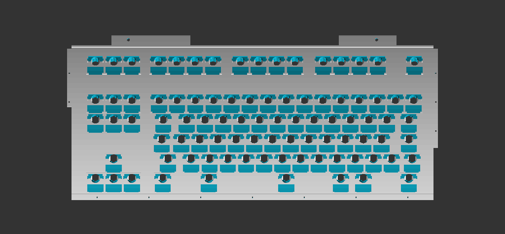

    Assembly merged with barrels test fitted.  The gap between the top and bottom plate represents the PCB.  Also, we talked about minimizing the form factor of the assembly.  Notice the gap at the top of the assembly between the plate and the top row of barrels.  If the PCB allows it, all of that could be regained
    Top with barrels inserted

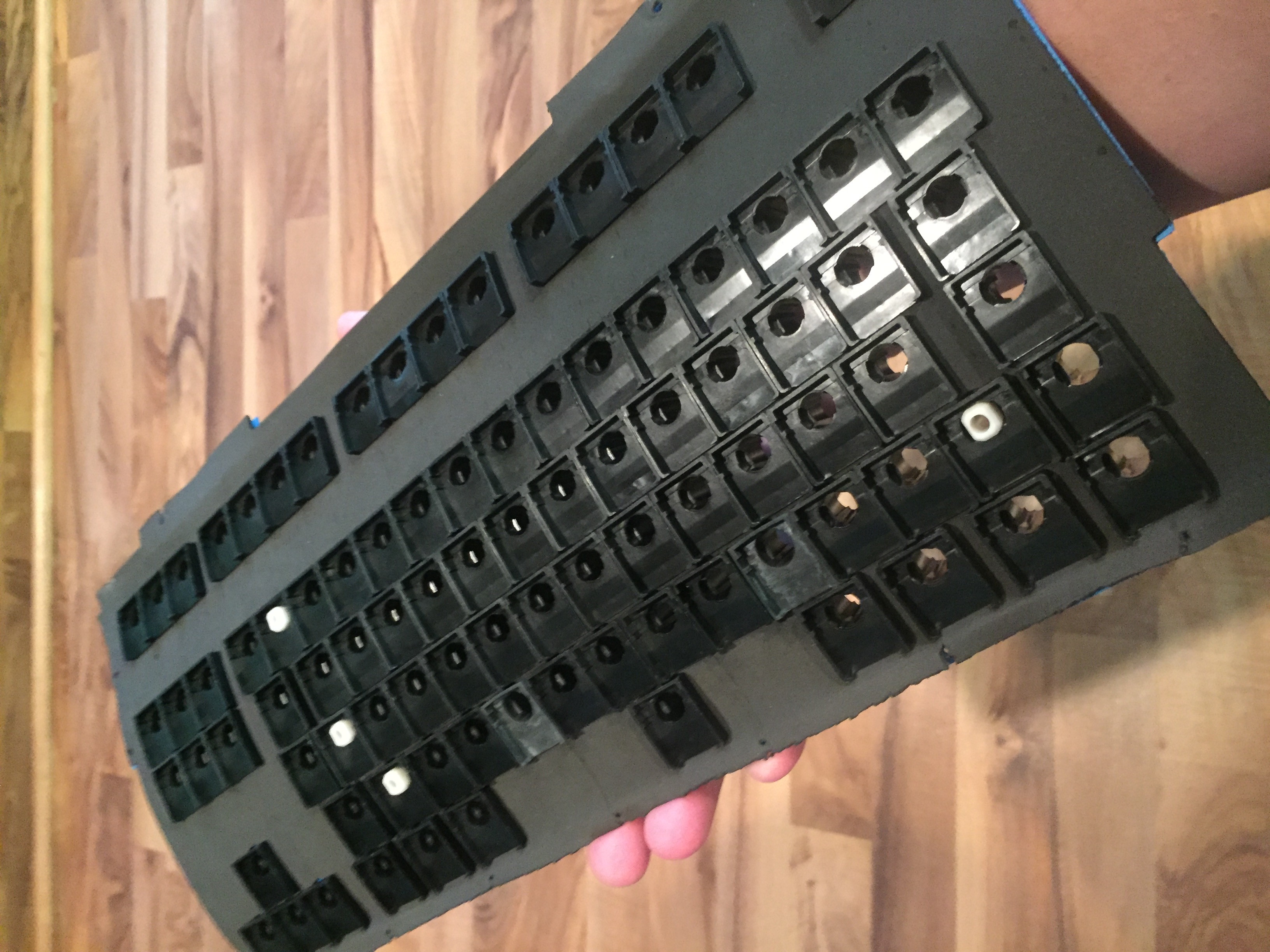

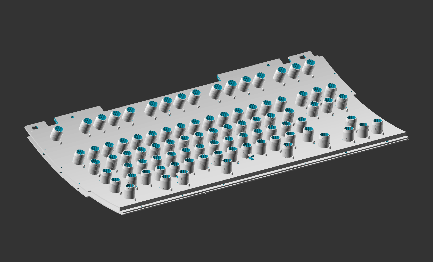

    Back side of the top plate with all barrels fitted
    Close up of the barrel fitting

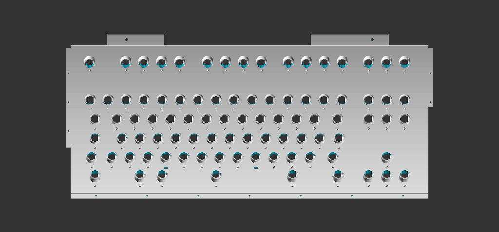

  • Barrel
    Barrel with spacebar stabilizer integrated.  This seemed like the most elegant solution (avoiding any spot welding in the manufacturing process, and allowing "easy" replacement should the need ever arise).  The clip itself has substantially more girth than the M or F stabilizer clips
    ImageAn example rendering of just the cutouts and stabilizer clip barrels
    Standard XT/Bigfoot barrel
    Barrel Bottom
    Barrel Bottom

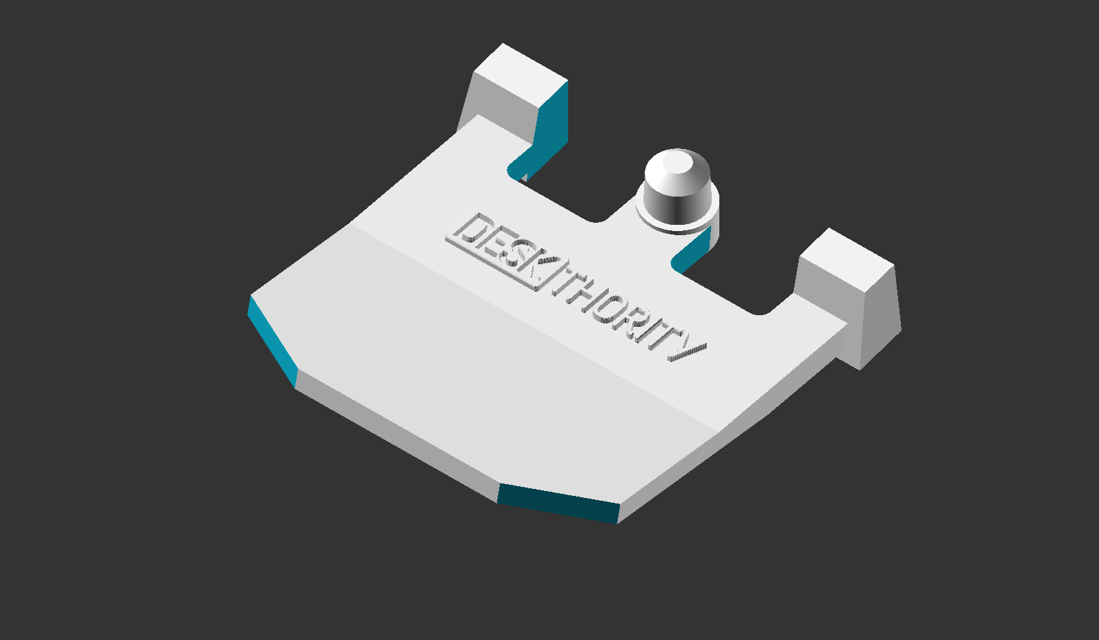

  • Flipper
    The real flipper doesn't have the DT logo, but added for fun at the moment
    ImageFlipper bottom
    ImageSide view of the flipper to note the two step angles

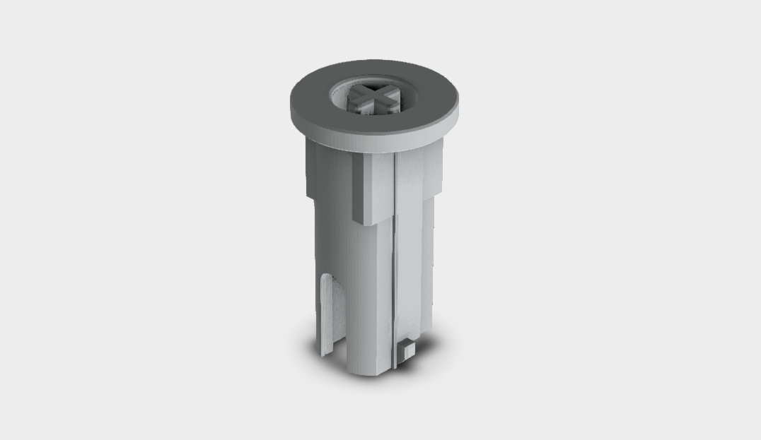

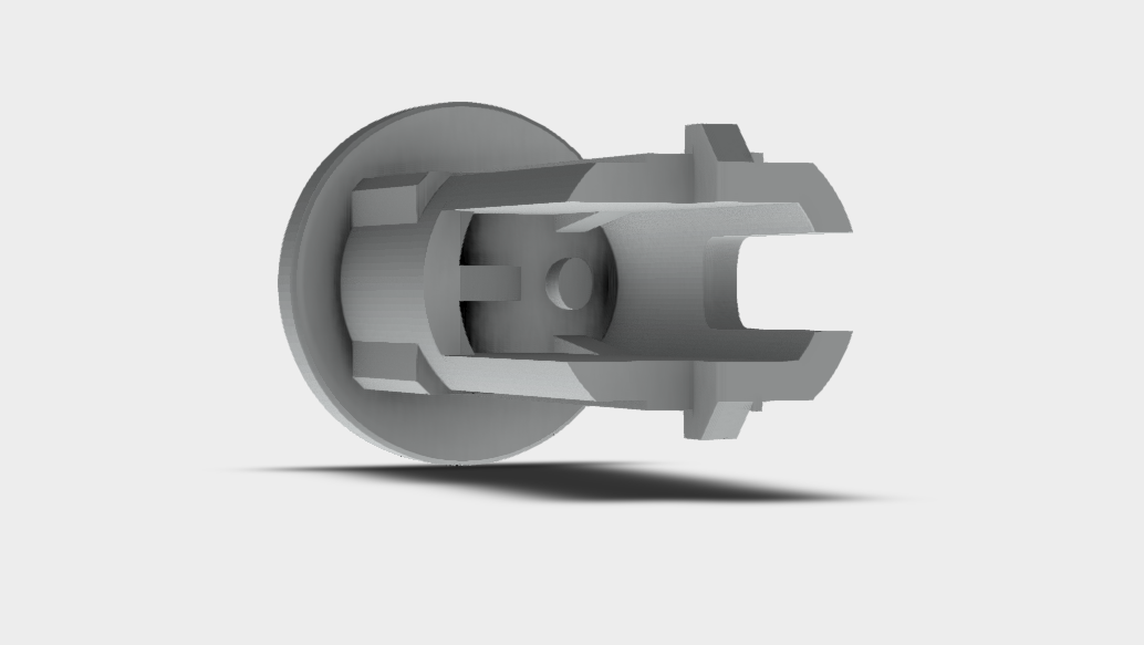

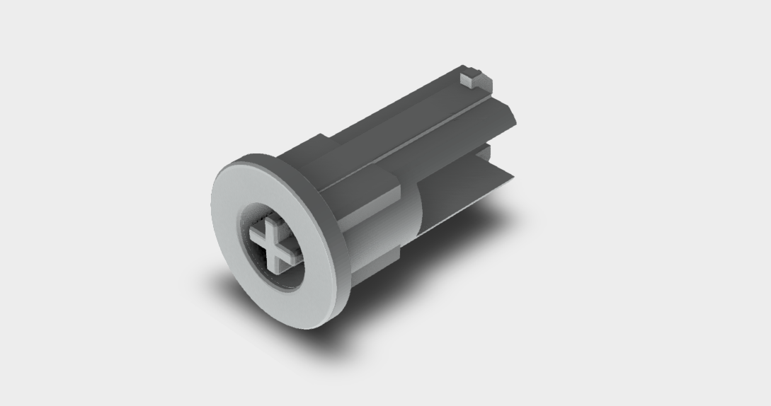

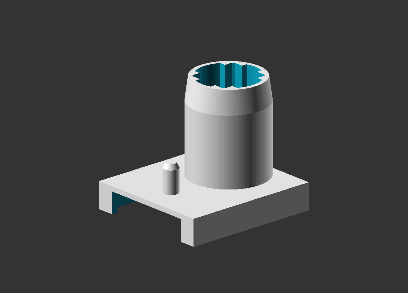

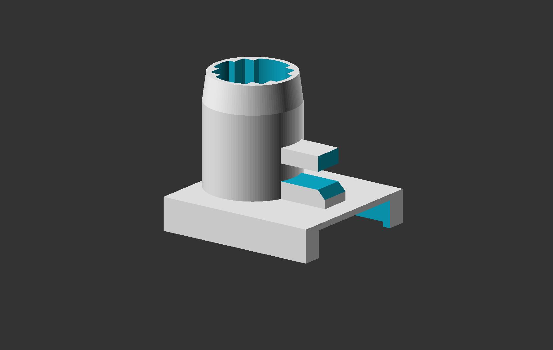

The following is the original rendering for the Cherry MX buckling spring adapter. I had originally put some of this in matt3o's buckling spring with a cherry on top thread, but would like to just keep track of the progress here, since I view it as another step in this larger goal. Apologies to those that have already seen.
More renderings of the same stem from different angles
Backside laying flat on the desk
Inside the buckling spring stem from the bottom

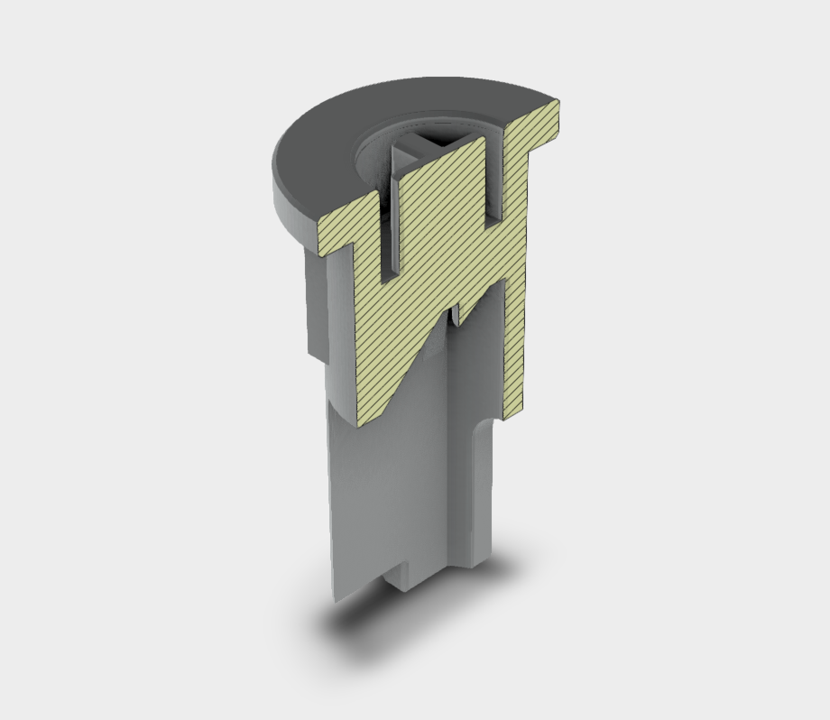

Cross Section to help visualize the mechanics

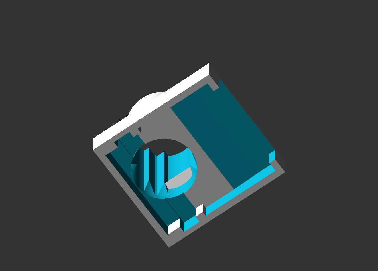

The above would account for all the standard keys, but there are 5 special keys (Spacebar, Capslock, Shift(s), etc) on the 84 key M, and 2 additional on the 101-key. I have ordered a Cherry board to take some measurements from (ironically I don't currently own a single Cherry key :) ), and will progress forward when that arrives.
But using the dimensions of the spacebar from our wiki, have constructed the spacebar adapter (by far the most complex) ahead of time. I am confident it will be very close, but will likely add a sleeve to take advantage of the spare barrel blank on the M (testing will tell for sure)
ImageFront looking upwardImageFront looking downwardImageProfile (the wire clips are there, but not rendered well by the visual)

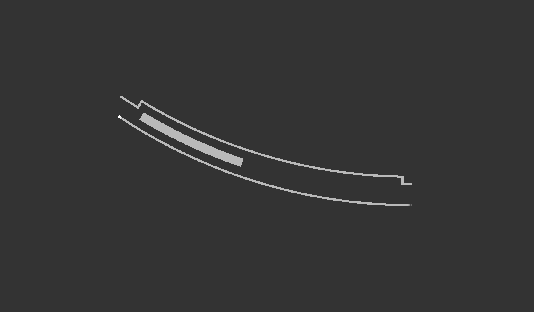

And the following shows the progression of how this cap profile "simulation" was constructed

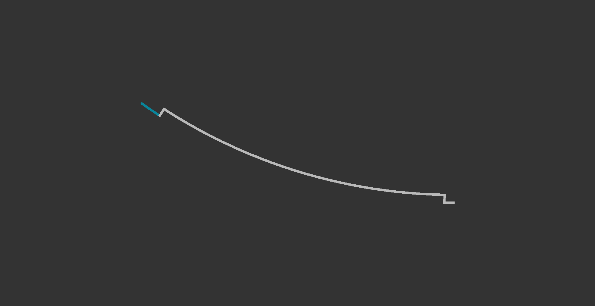

This is the original:
This is the original in relation to the IBM barrel assembly curve (300mm radial bend for the angle):
And this is the result of the two merged:
This would be the actual rotation of the backplate as it sits in the case. It is possible that Cherry boards sit on an incline in the case as well. I have no idea... don't own one:
And lastly, with IBM keycap profiles in Blue:

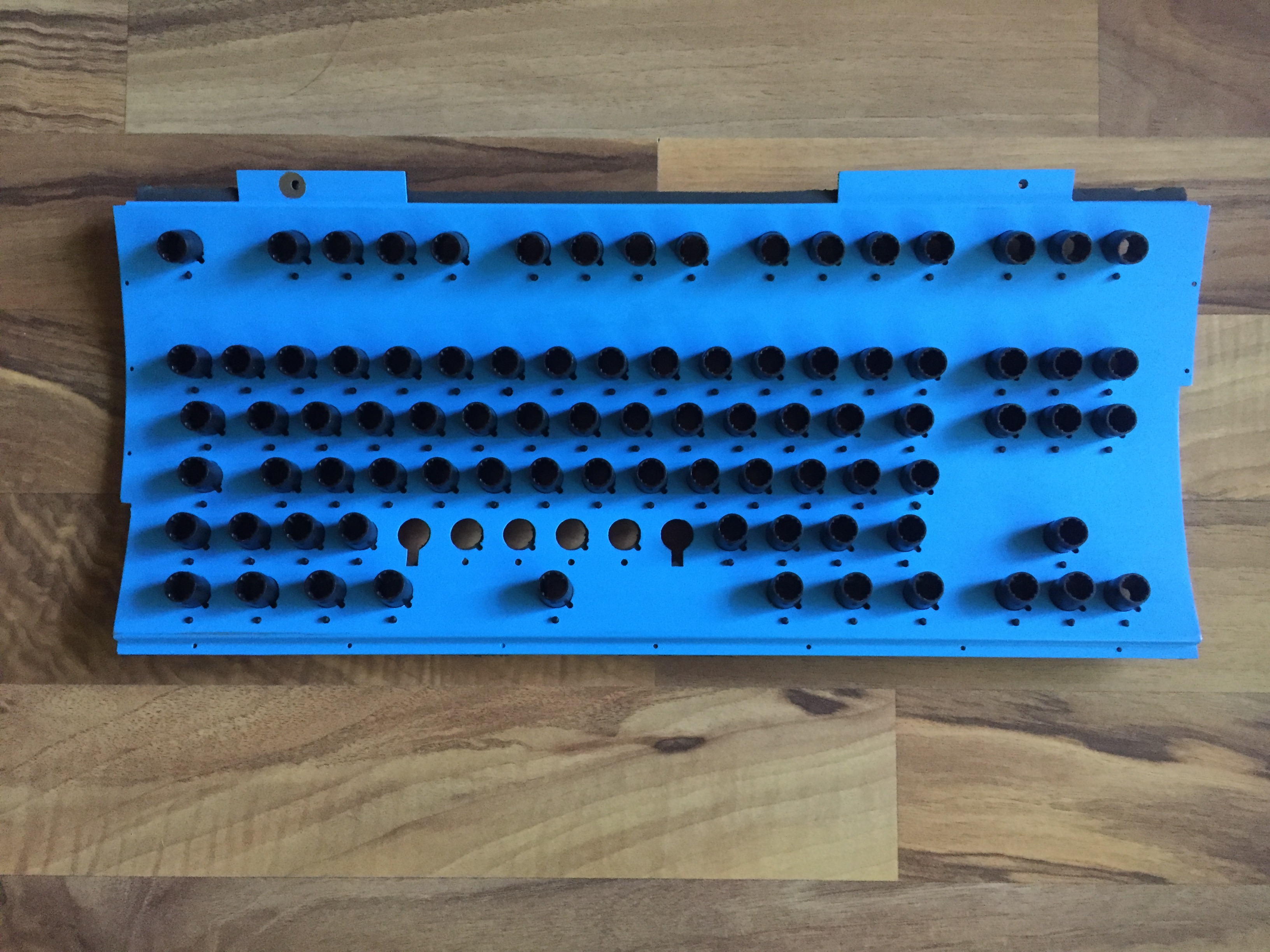

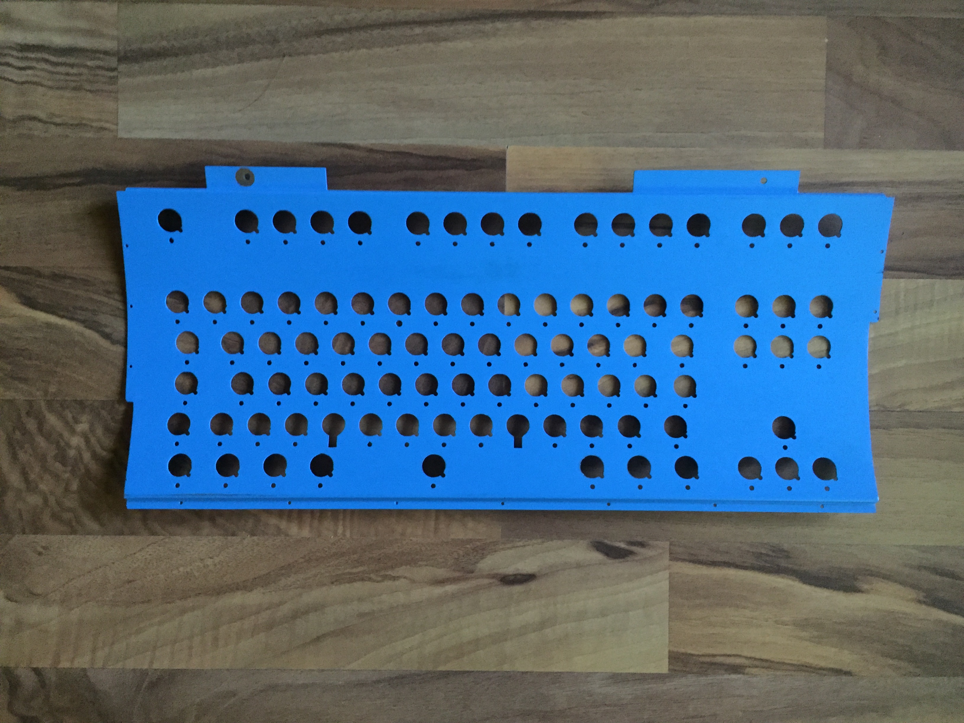

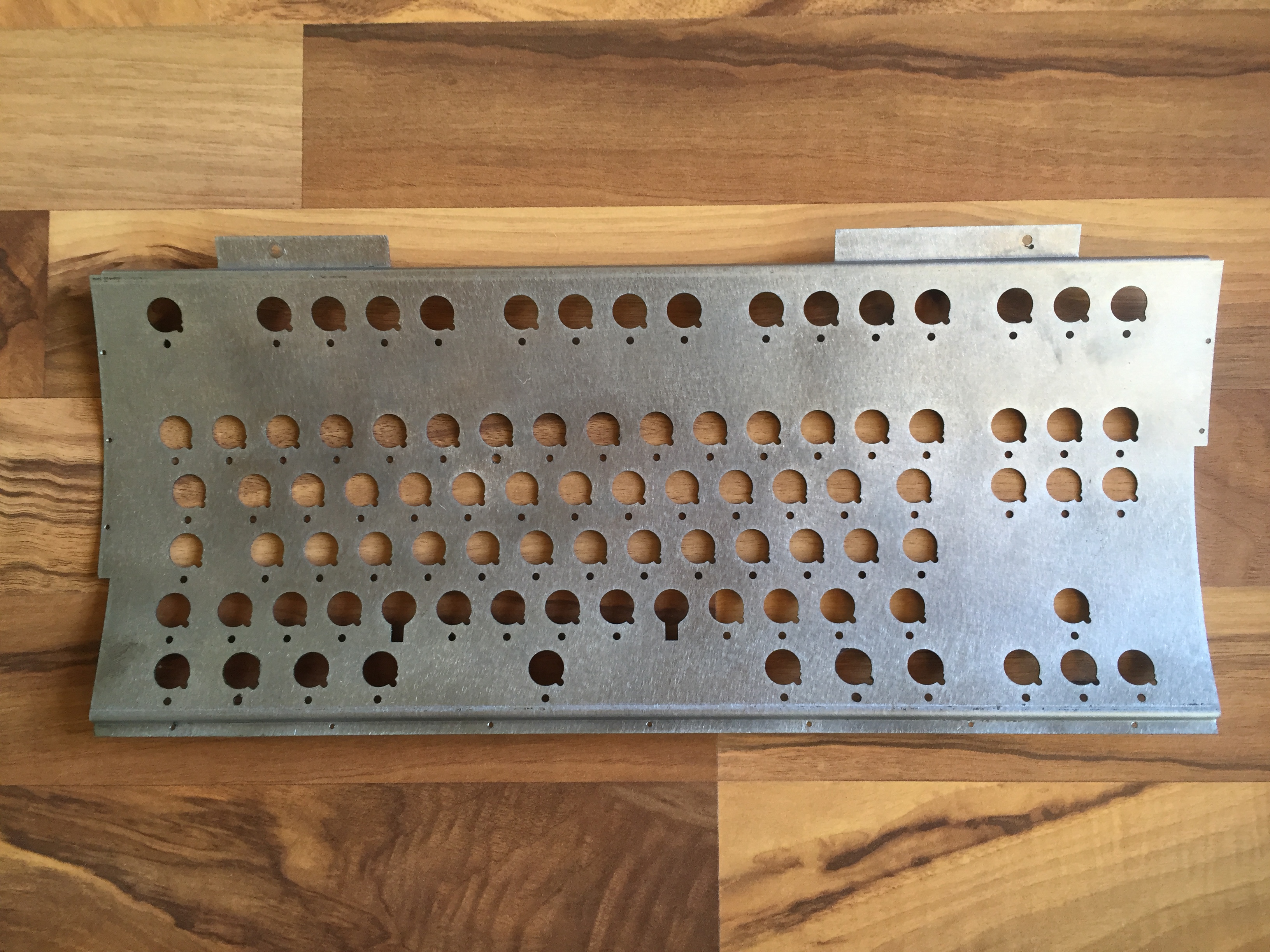

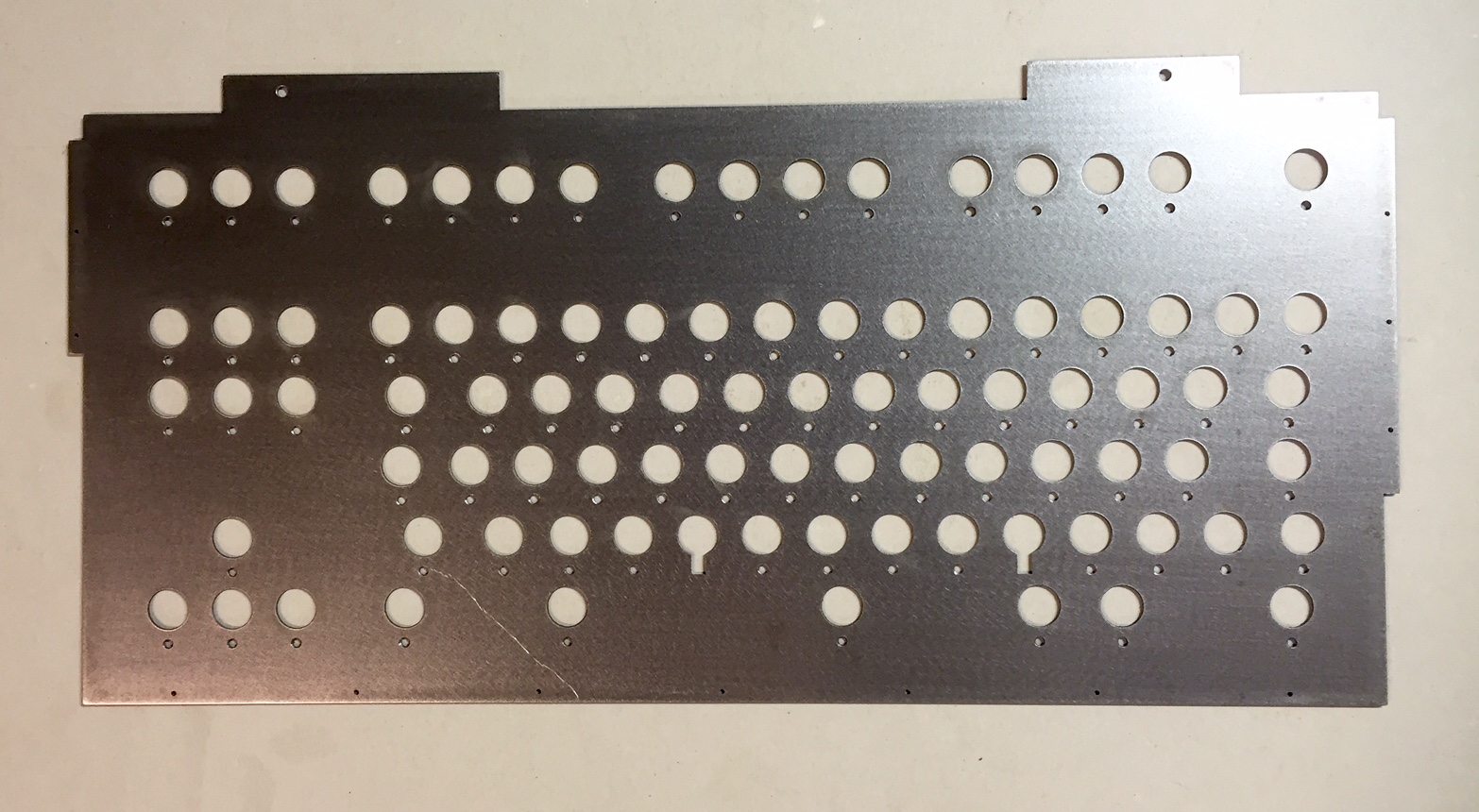

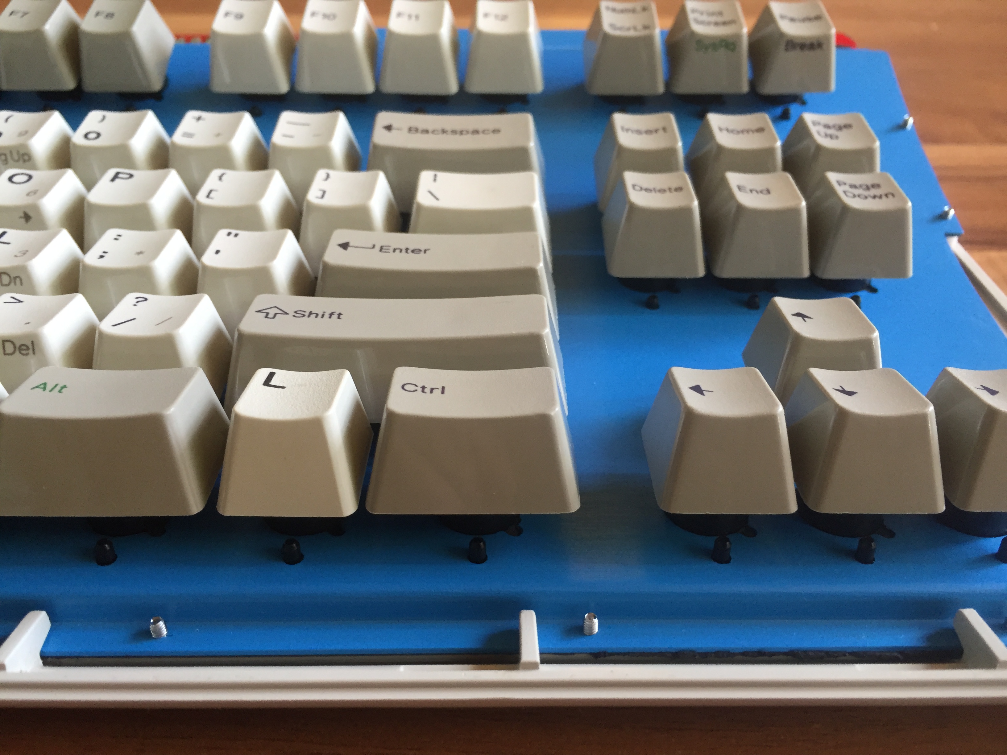

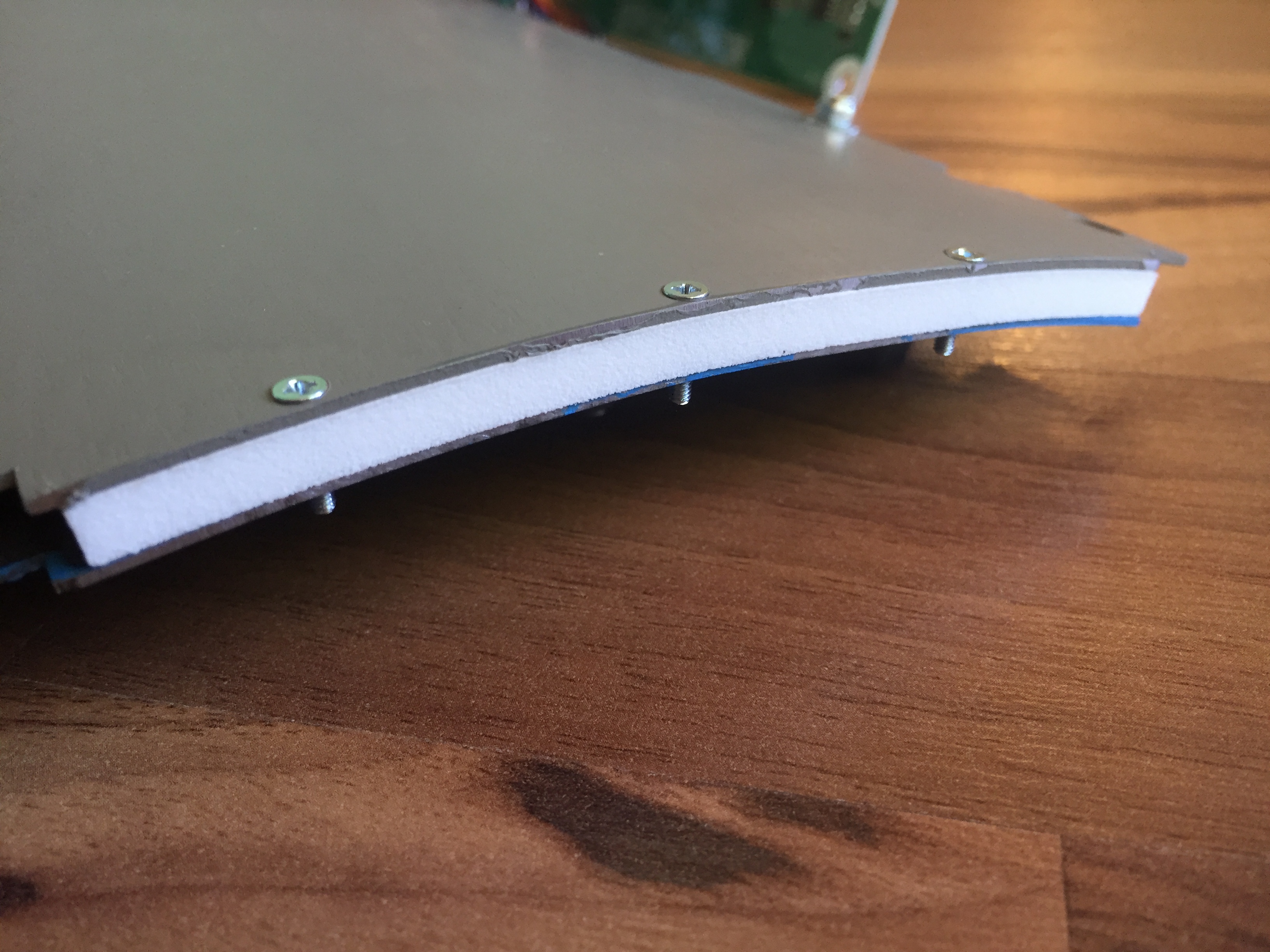

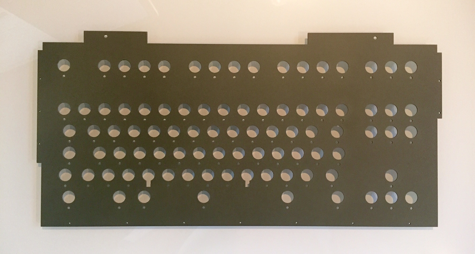

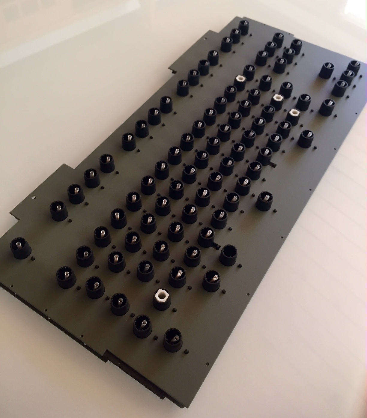

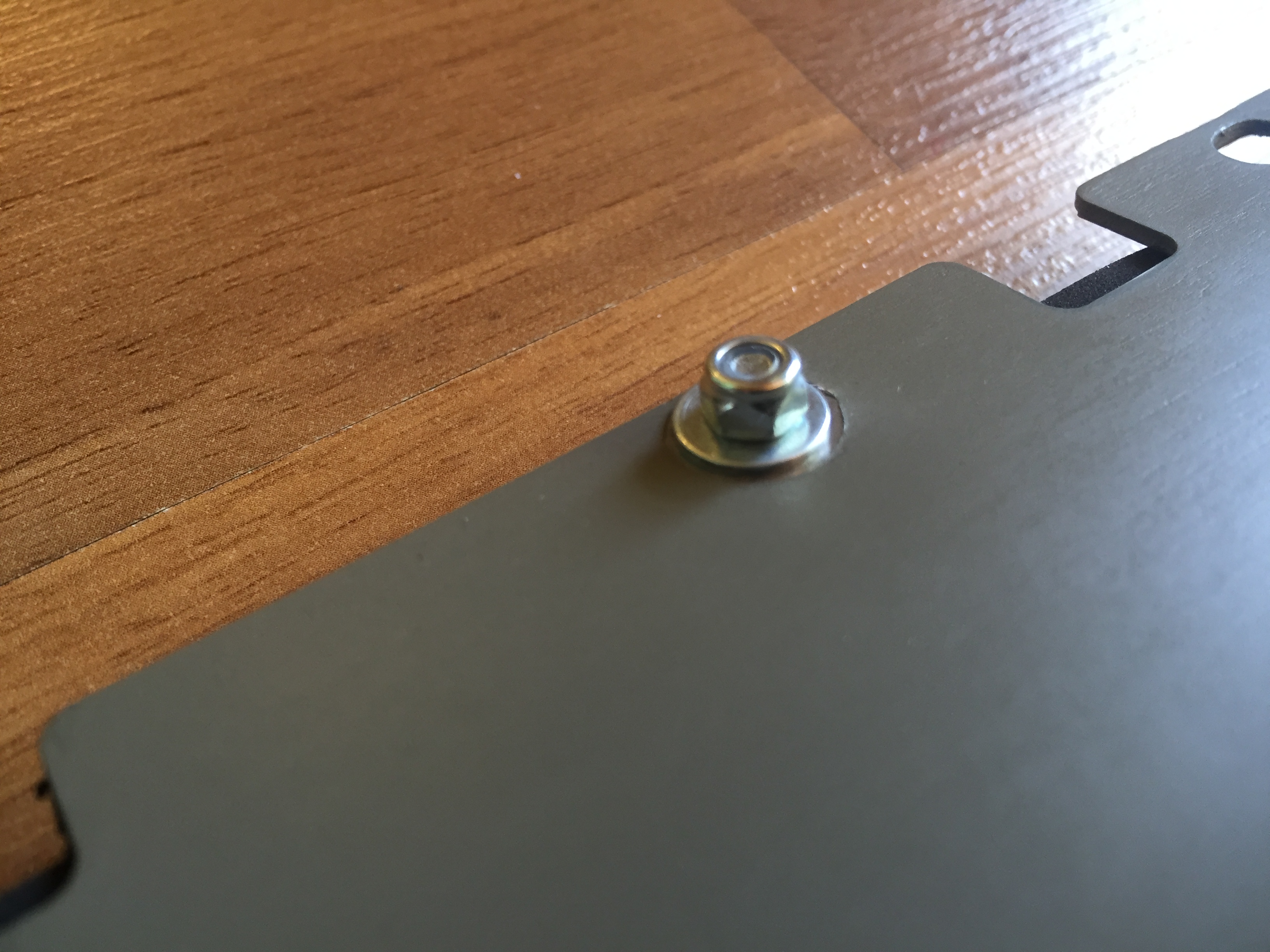

Cold Rolled Steel A366/1008 0.048 inch (~1.25mm) (18 gauge).  I planned on priming and painting, so I selected a higher carbon steel than stainless to provide higher "strength"
FullSizeRender (27).jpg (508.77 KiB) Viewed 101647 times

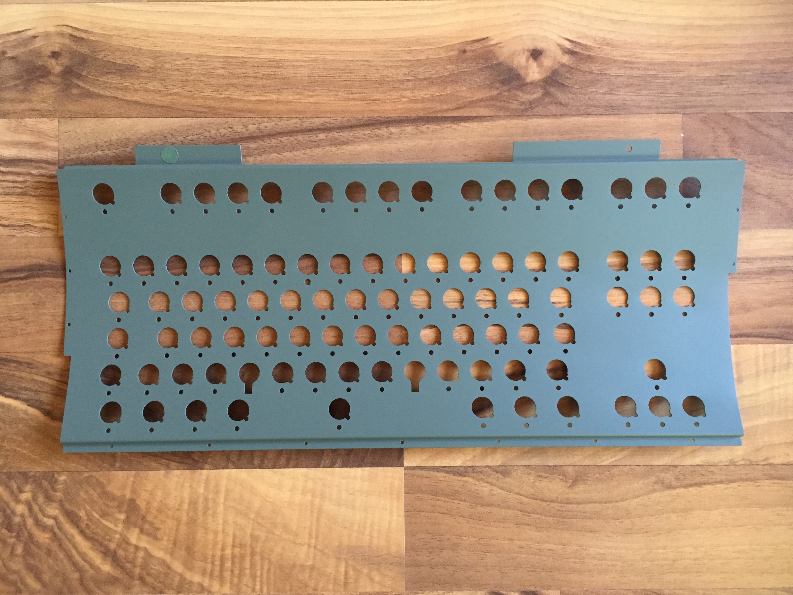

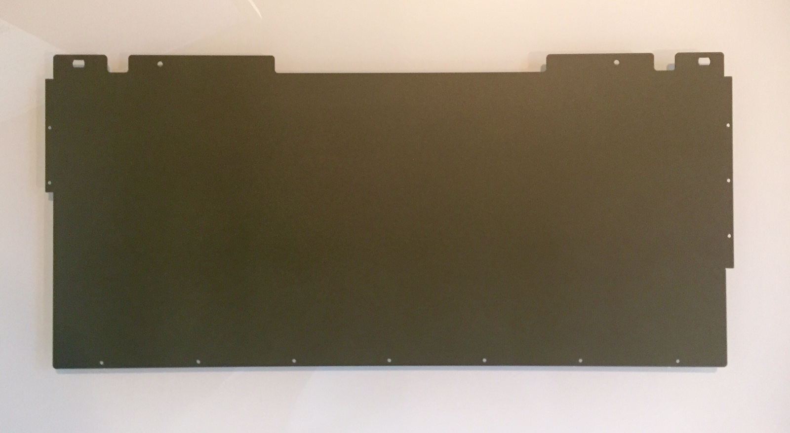

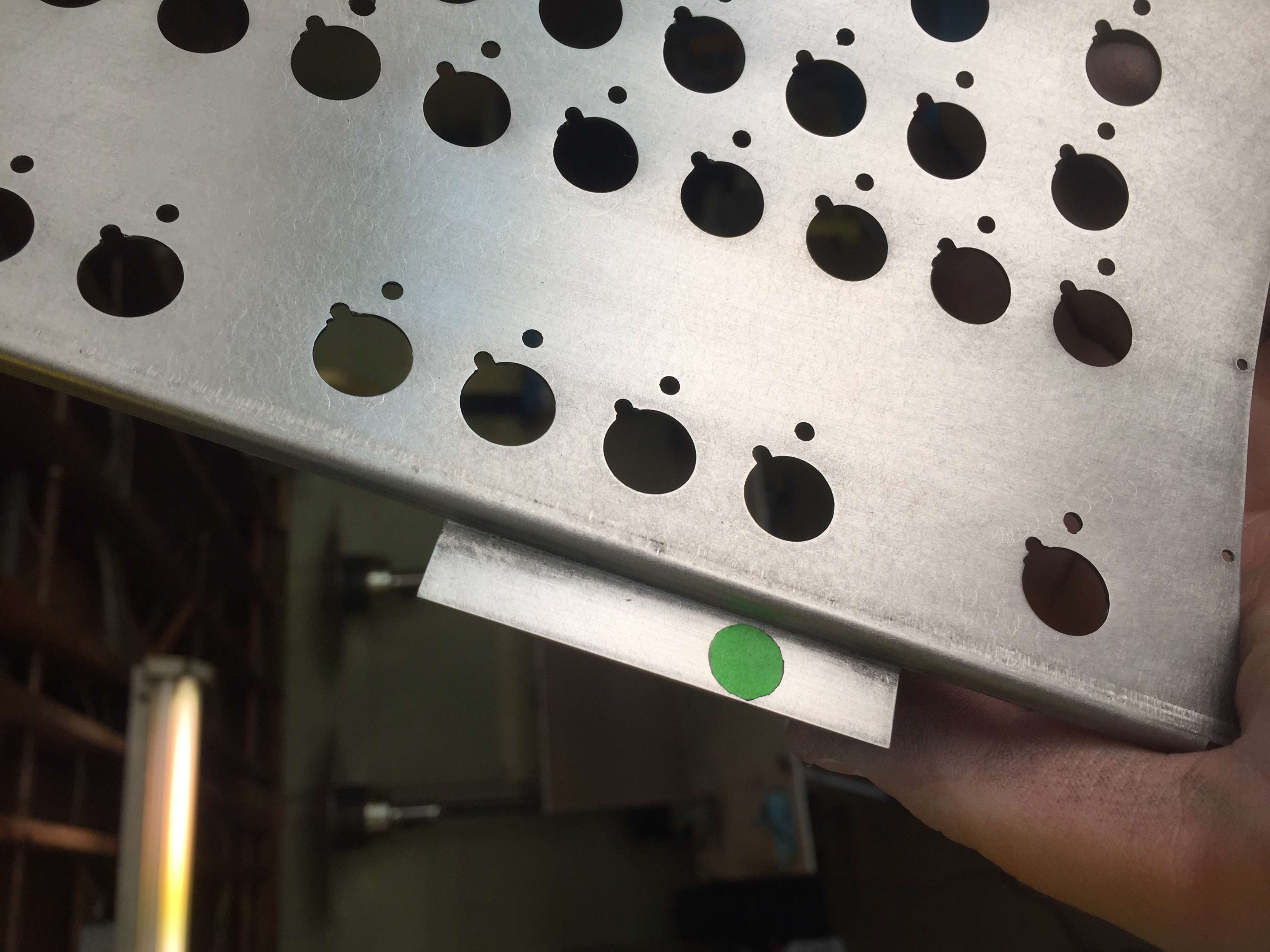

  • Bare Plates Received from Big Big Saw
    Top plate only, preconditioned (no sanding or deburring)
    FullSizeRender (18).jpg (416.03 KiB) Viewed 101647 times

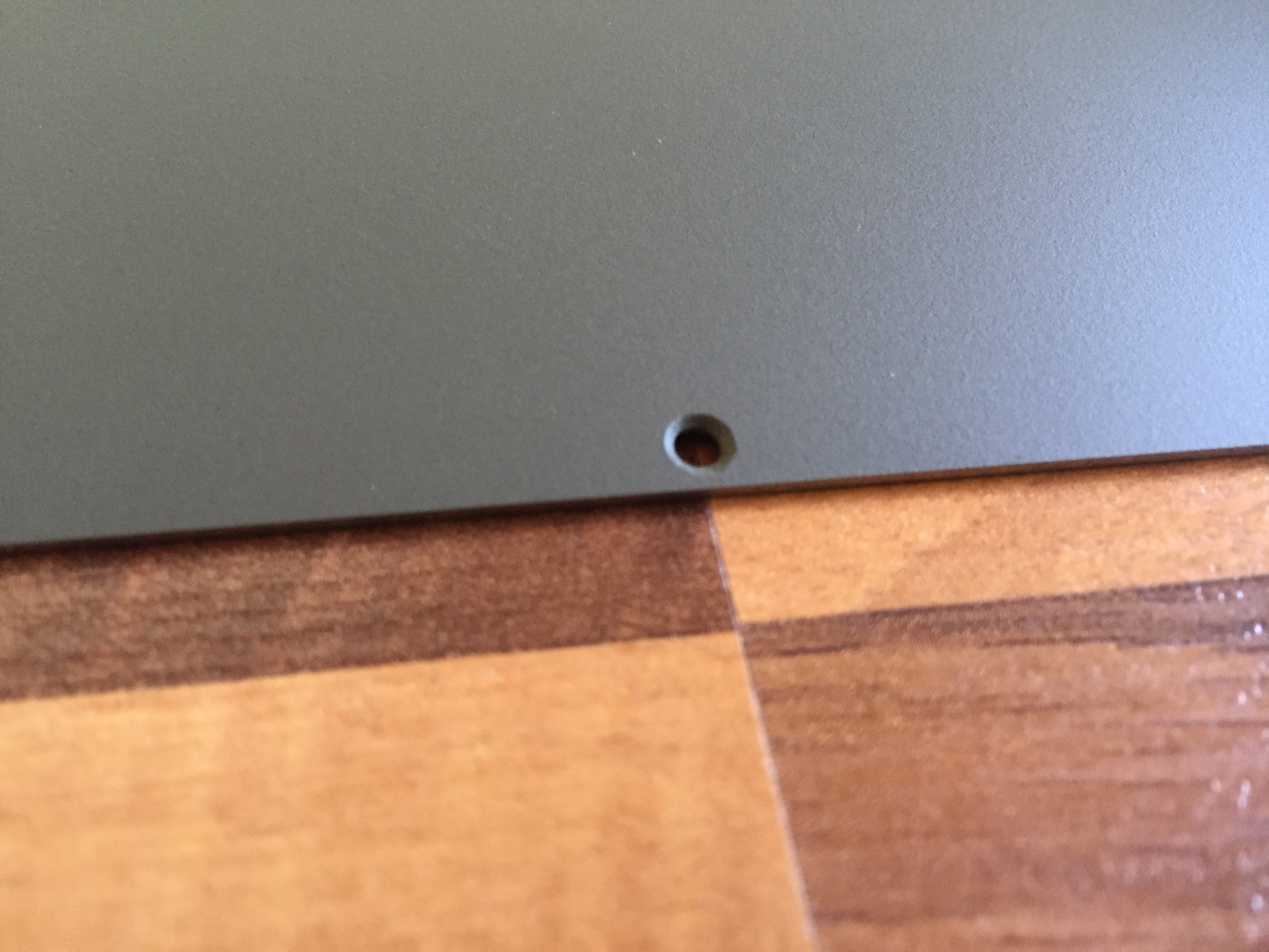

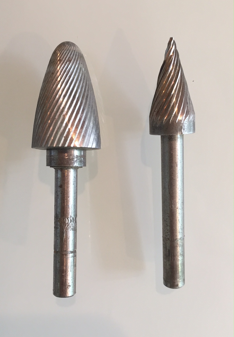

    What big boys use to countersink and deburr circular holes.  With a press, it makes short even work
    FullSizeRender (19).jpg (222.9 KiB) Viewed 101647 times
  • Plates primed with a metal etching primer (to allow for handling)
    Top plate primed with a HVLP paint gun after processing (sanding and countersink)
    FullSizeRender (20).jpg (354.03 KiB) Viewed 101647 times

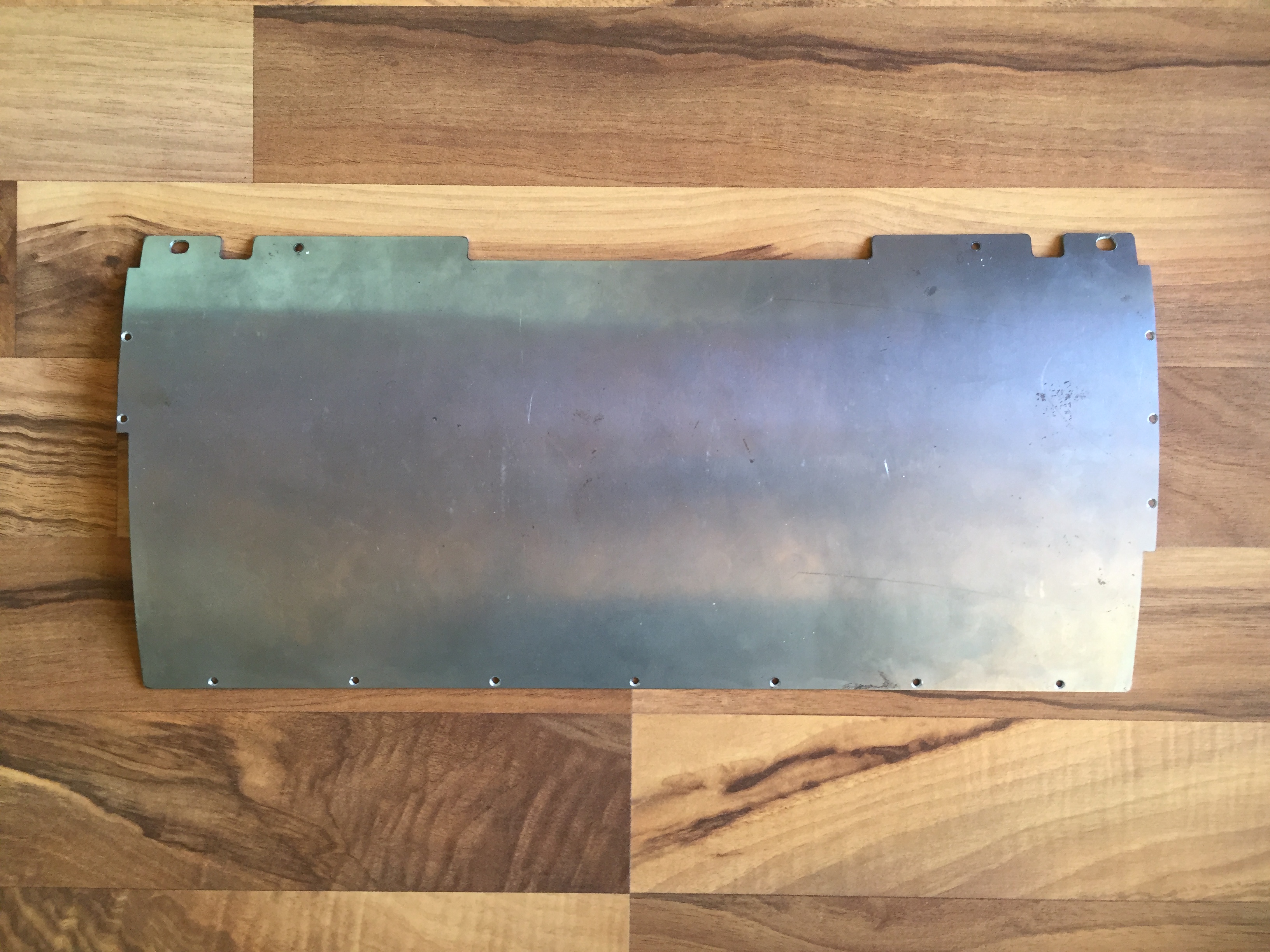

    Bottom plate primed
    Bottom plate primed
    FullSizeRender (21).jpg (297.22 KiB) Viewed 101647 times

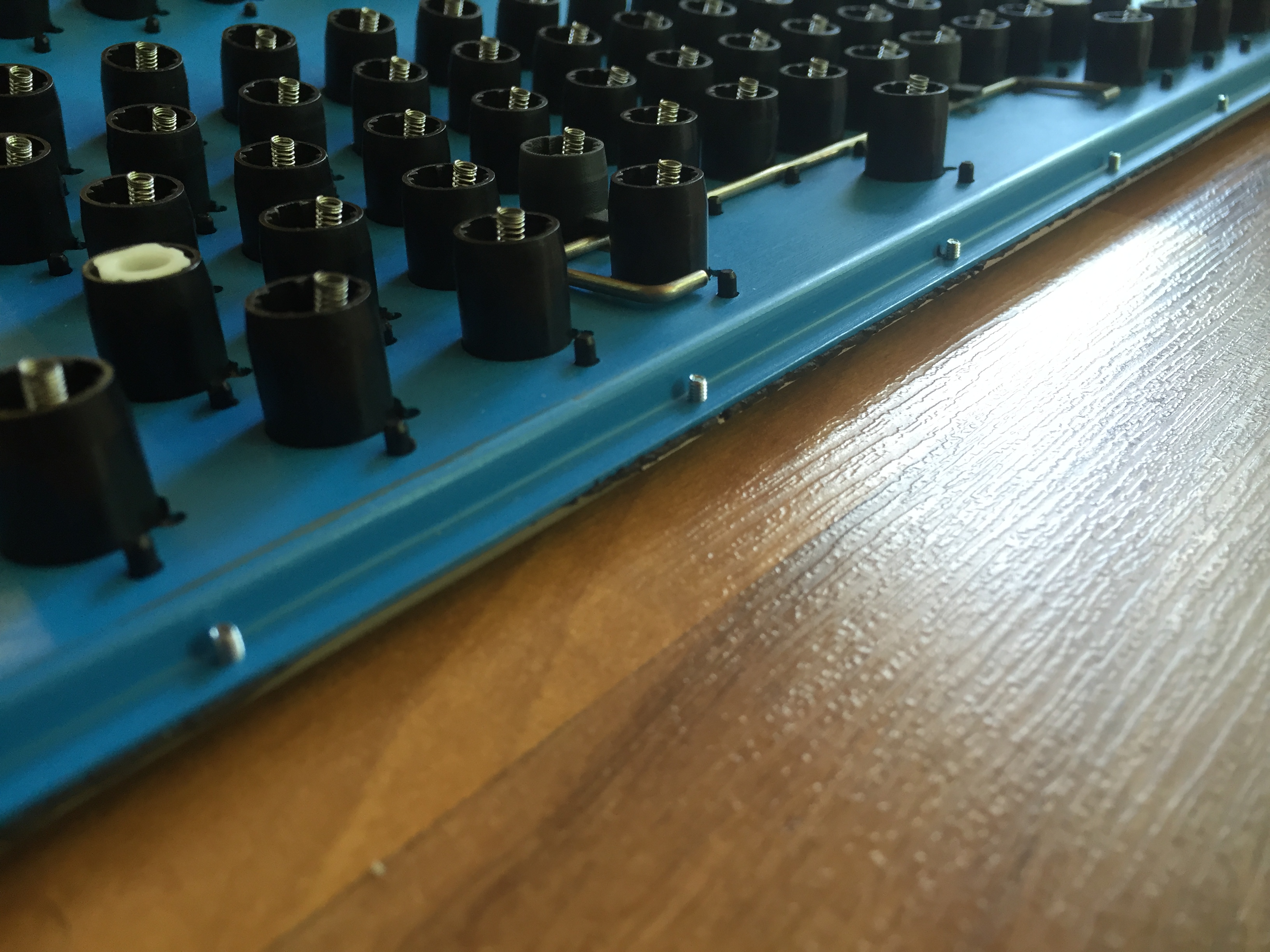

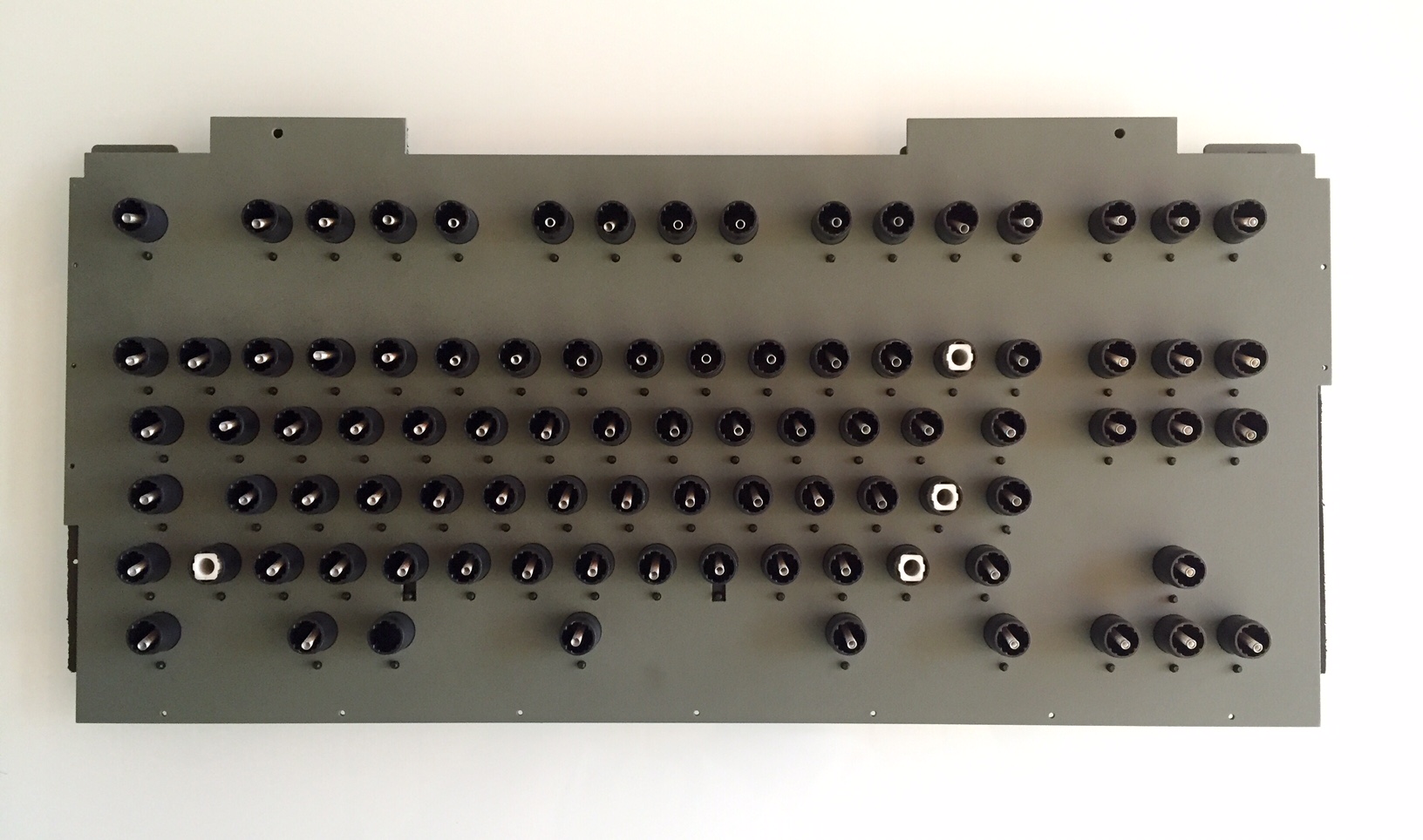

  • Foam, Barrels, Flippers added

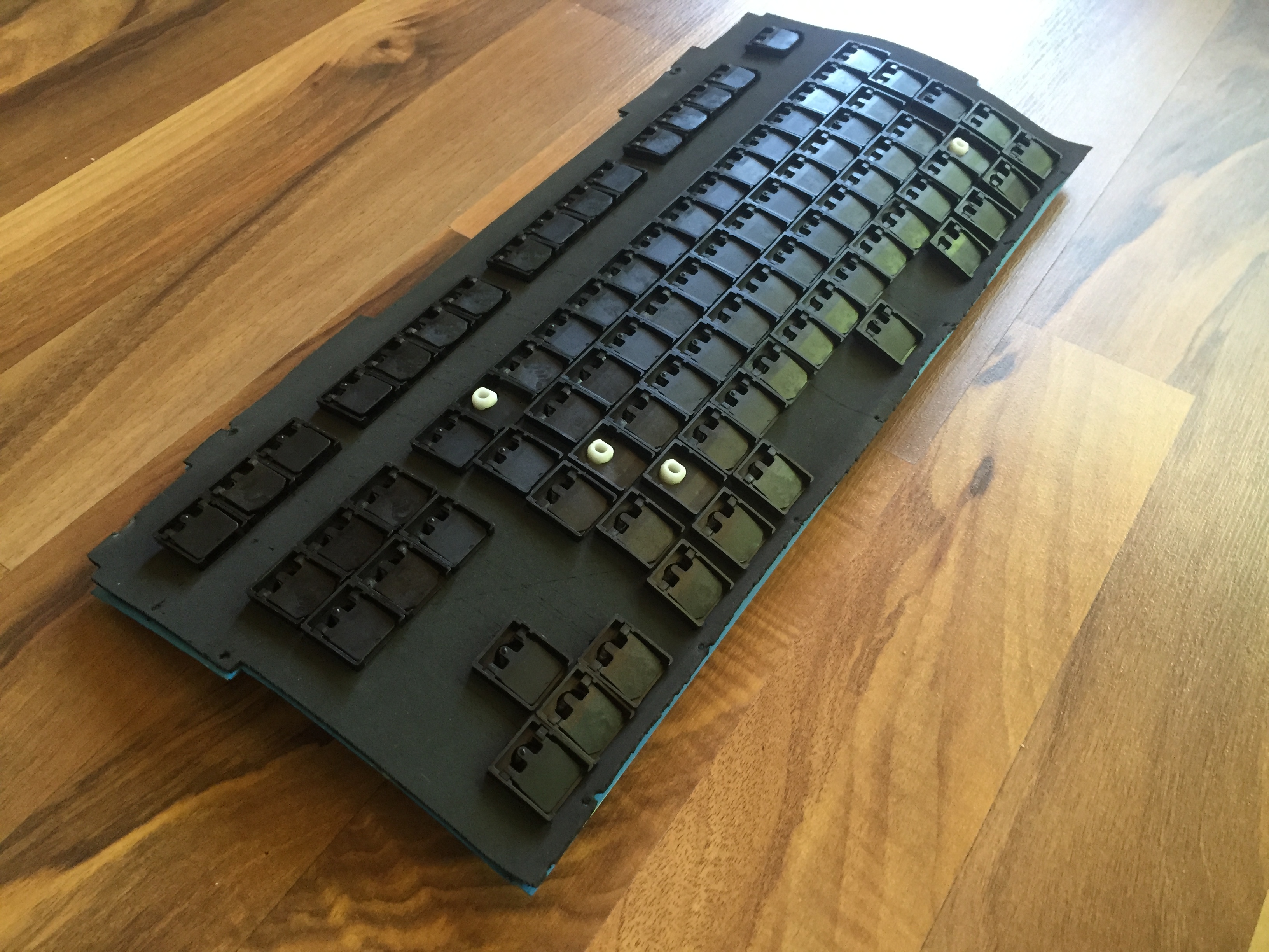

    Foam, barrels, flippers, and stabilizers in place
    FullSizeRender (23).jpg (332.52 KiB) Viewed 101647 times
    FullSizeRender (24).jpg (339.89 KiB) Viewed 101647 times

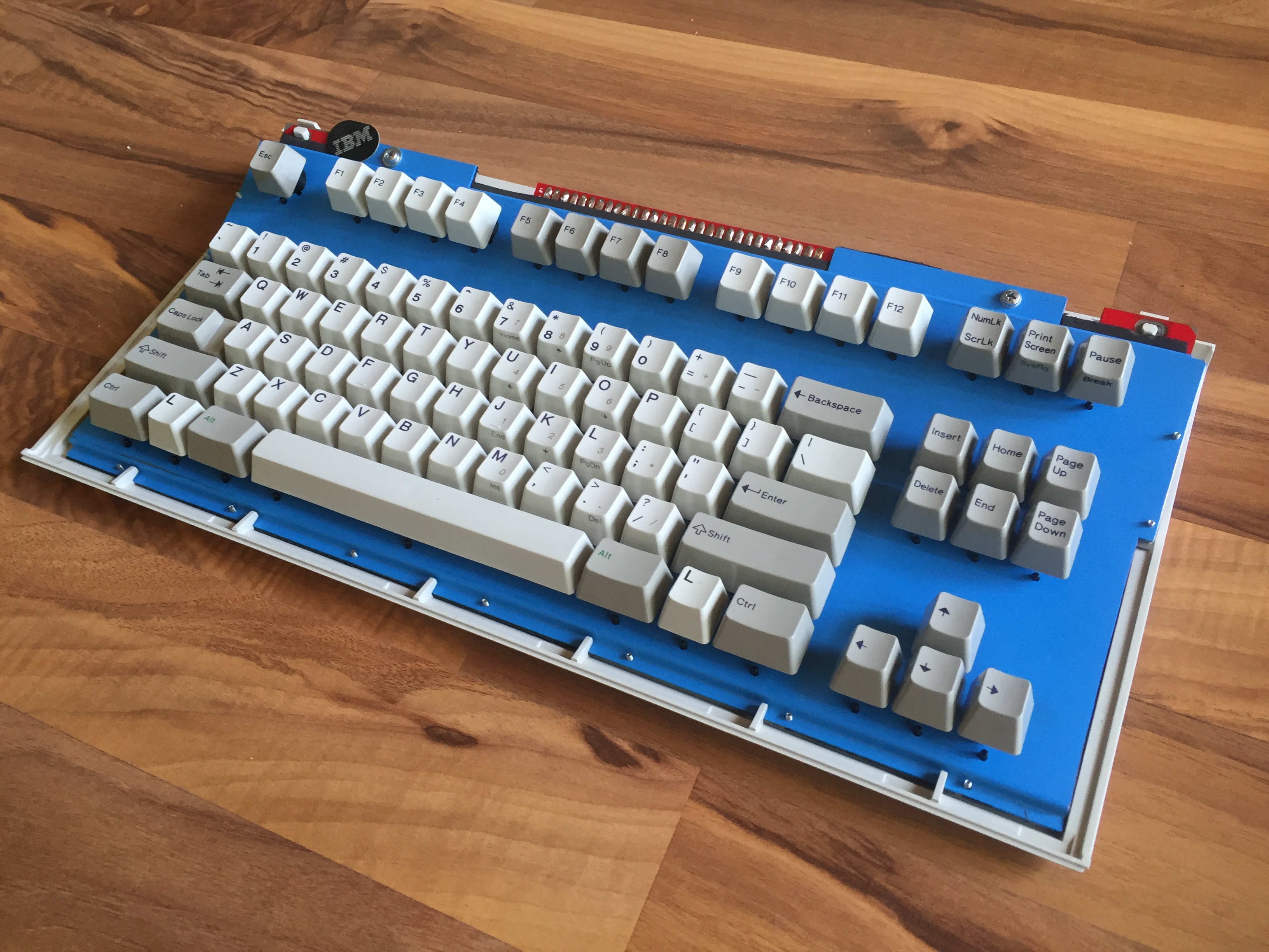

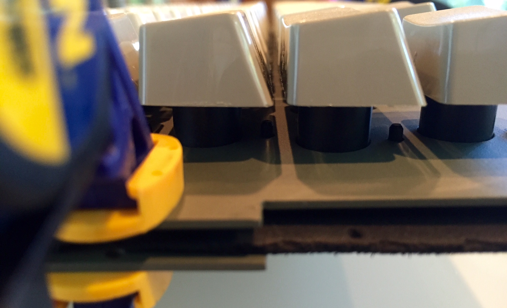

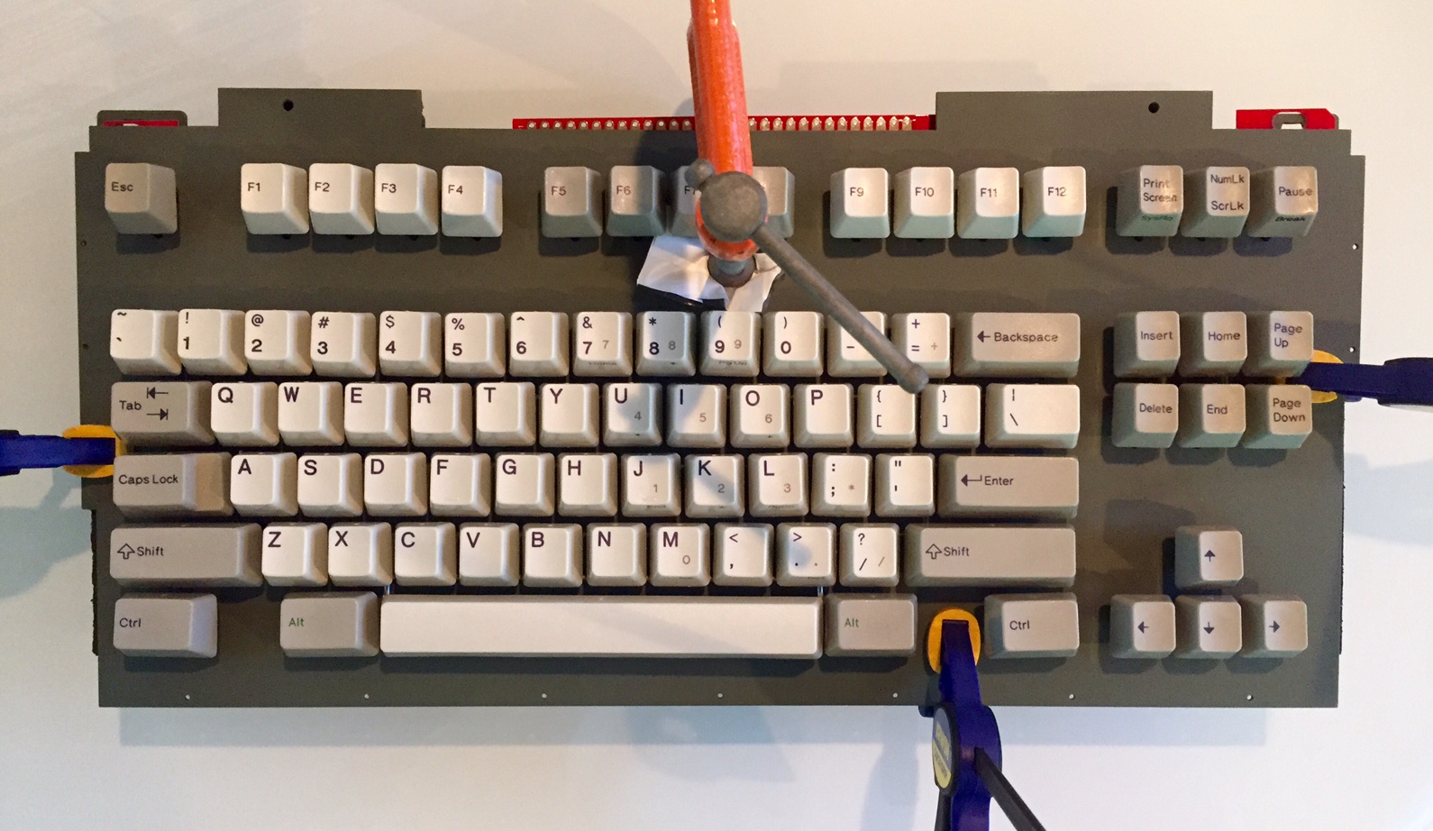

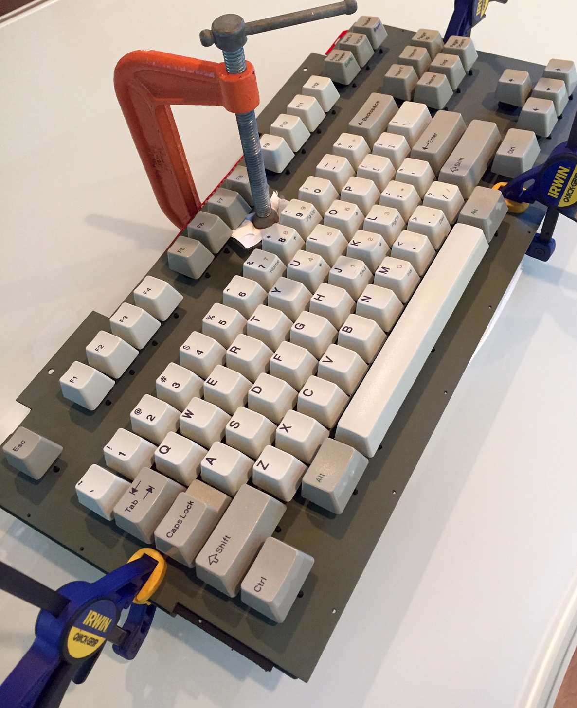

  • Compression of the plates with keys added
    Everything in place with clamp compression (note...  4 points of compression is WEAK compared to what our end result would be)
    FullSizeRender (26).jpg (430.12 KiB) Viewed 101647 times
    Previously mentioned gap that would need to be lessened by ~.5mm per row
    FullSizeRender (28).jpg (359.37 KiB) Viewed 101647 times
I don't currently have the PCB soldered to the controller yet to prove functionality, but aside from the ~.5mm row gap, this compressed contraption is incredible. The keys feel phenomenal with zero noticeable plate flex, even the keys in the middle make the same consistent "ping". I think I can confidently say at this point (knowing that the flipper test worked on the flat PCB before I bent it... with every key registering perfectly...) this would work if it is desirable for Cherry adapters later. Any additional noise or plate flex (I notice none, and I type HARD) can EASILY be accounted for with additional metal gauge or pressed seams (like the Beamspring). I have zero question this works (assuming the flippers register, and I would be willing play Vegas on that one if someone feels lucky ;)). I am SUPER excited about the doors this testing has opened
EDIT: The Shapeways order including the Acrylate keystem adapters, space bar adapter (the reason the whole order was postponed), flippers, barrels, and barrel stabilizers will be shipped out tomorrow (6/1). I should have an update some time this weekend after returning from my work trip

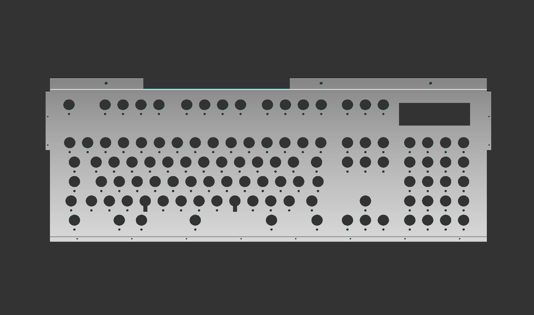

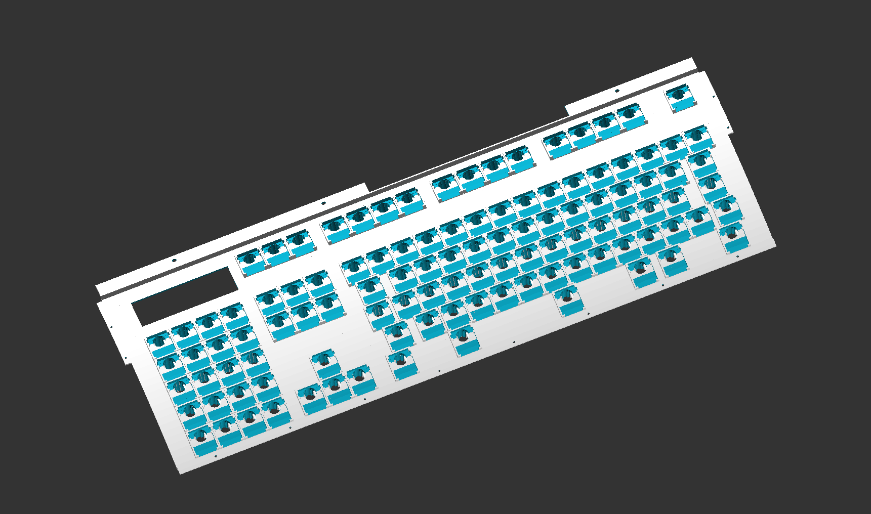

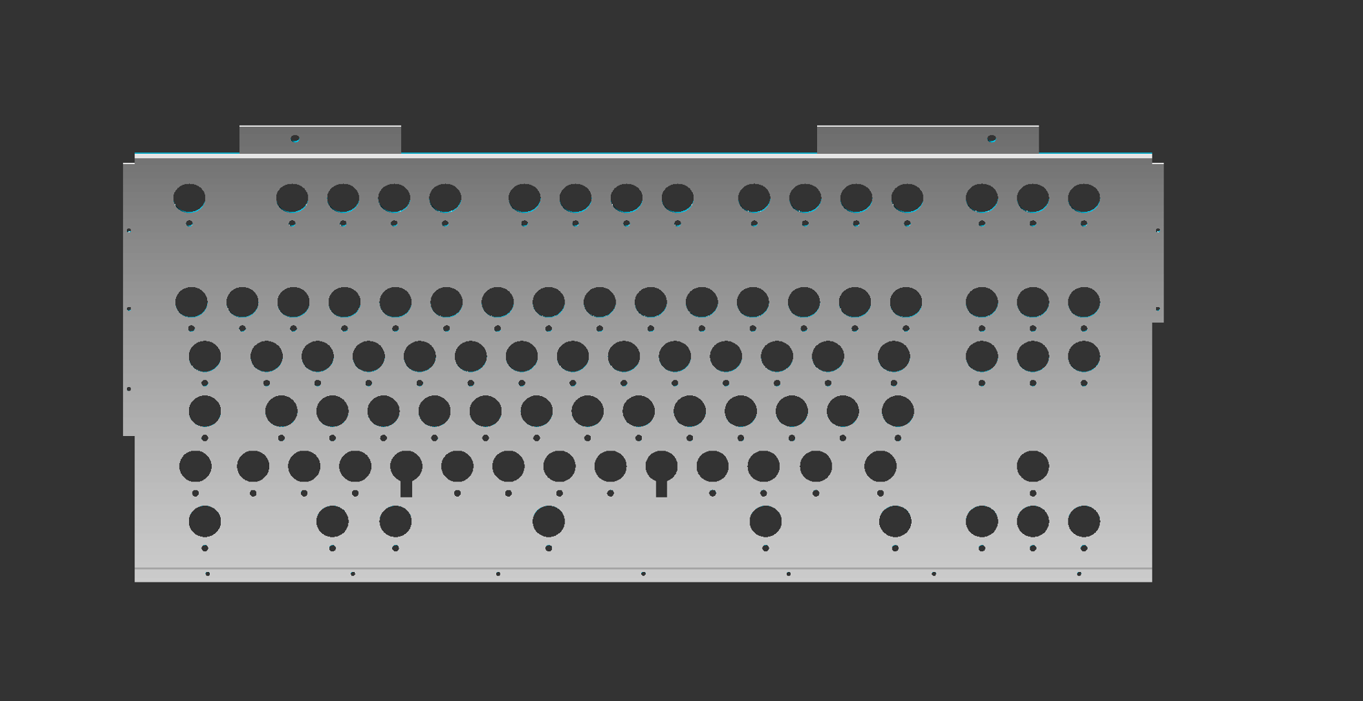

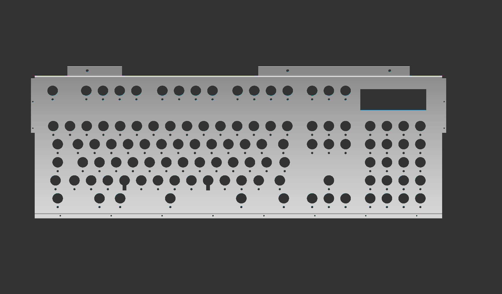

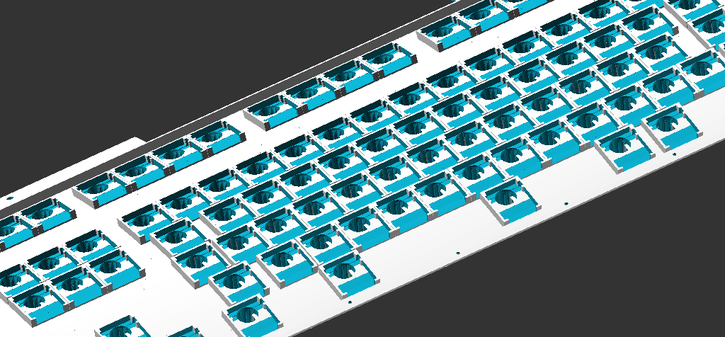

FEXT Assembly Plates
We now have a case for the full size 101-key (FEXT). The only thing open ended here that I see will be the existing LEDs for caps/scroll/num locks, and their integration with the xWhatsit controller headers (especially for the membrane style ribbon cable). To keep the top plate as strong as possible (and eliminate any audible variance for the keys on the top right of the board), the LED location has been made into a cutout vs cutaway. I have left 5mm of clearance on all sides to allow for anything we might need to do with the LED wiring. Also, there were several adjustments as compared to the SSK assembly:
  • The tab cutout that holds the top of the right side of the bottom plate in the lower outer shell was moved closer to the edge (was surprised about this one)
  • Since the full-size M has more room at the top of the outer shell, there is no need for cutaways at the top of both plates to allow the shells screws to pass by (more metal the better)
  • The spacer on the left side of the assembly needed to be reduced to match the right side for case tolerance
  • An additional screw was added at the top of the plates (similar to the ground screw) in the middle for additional support. We could certainly have MANY screws here if we wanted, but I would prefer to have to drill through the PCB as little as possible since there are no cutouts there for screws
I will send this top plate off to Big Blue Saw for water jetting today, and then process the metal for both the FSSK and FEXT. We should have something to report in a couple of weeks

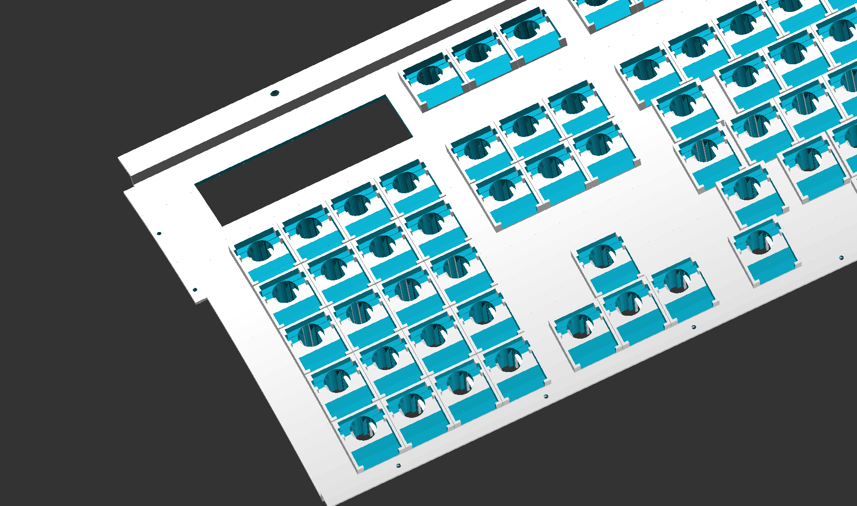

CAD Renderings
Top plate with barrels
Additional renderings

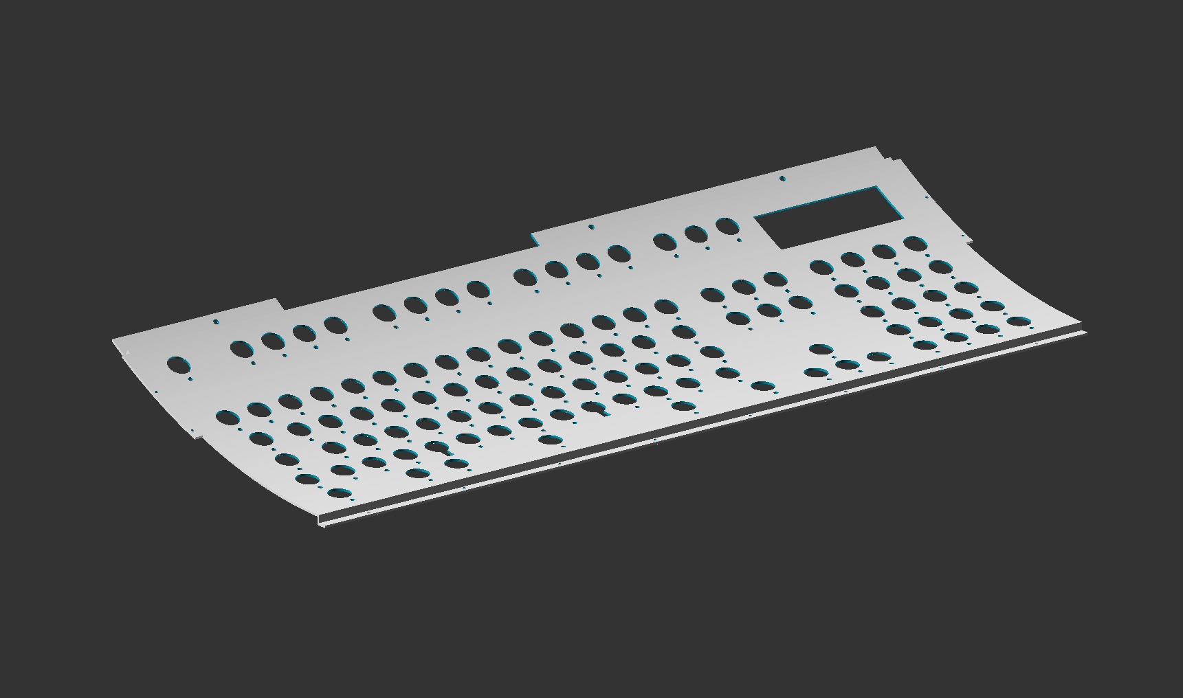

Top plate only
Top plate only
Top plate bottom with barrels test fit
Barrel fitting up close for the 10-key portion

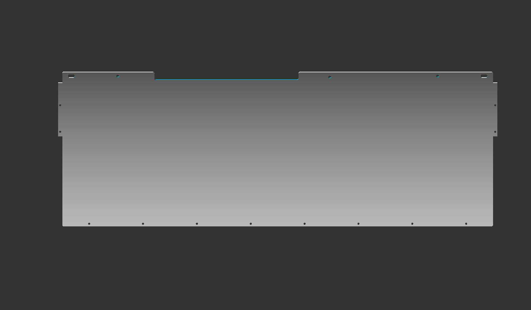

Bottom plate from above

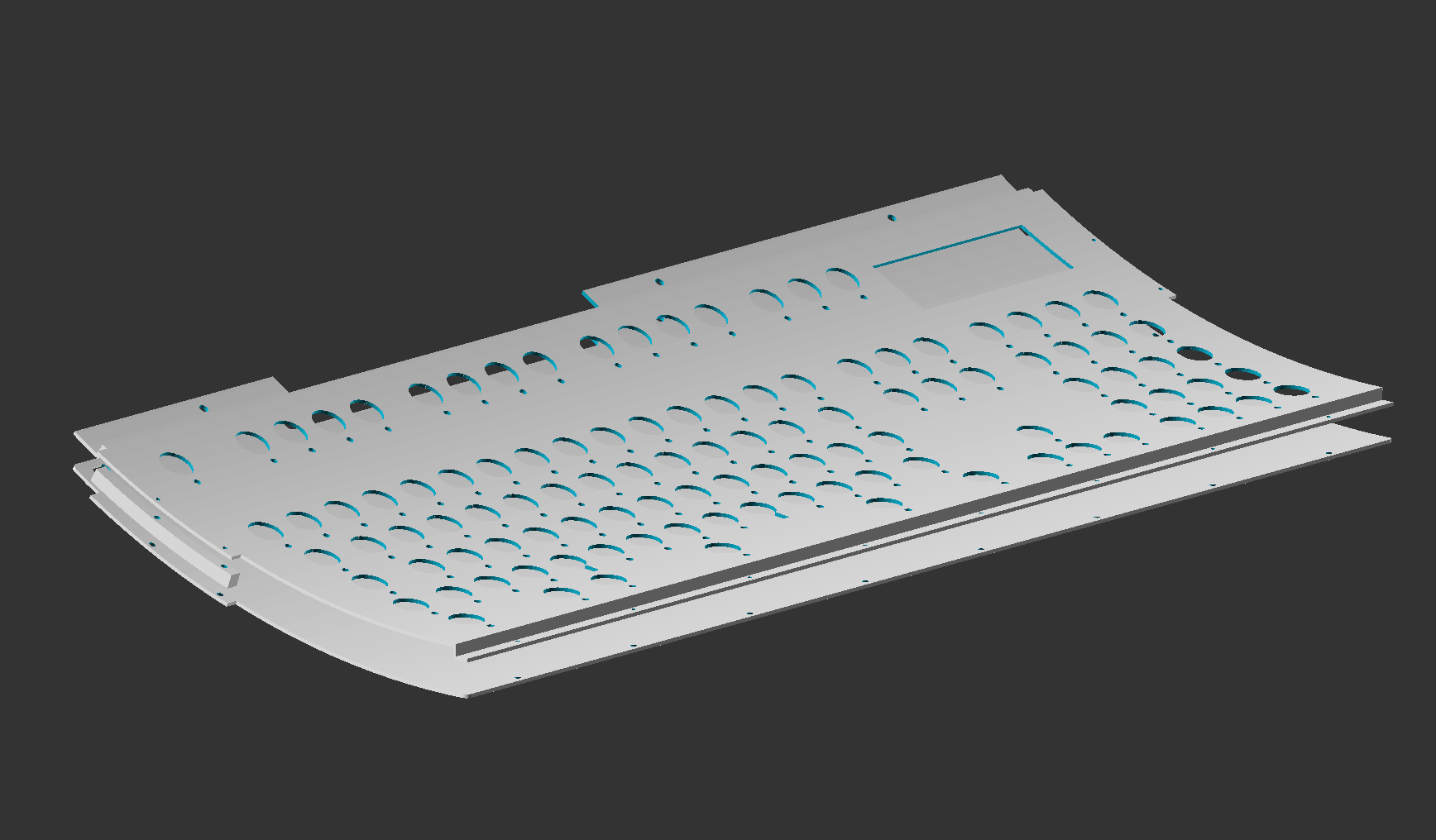

Assembly with spacing for visualization of the layers

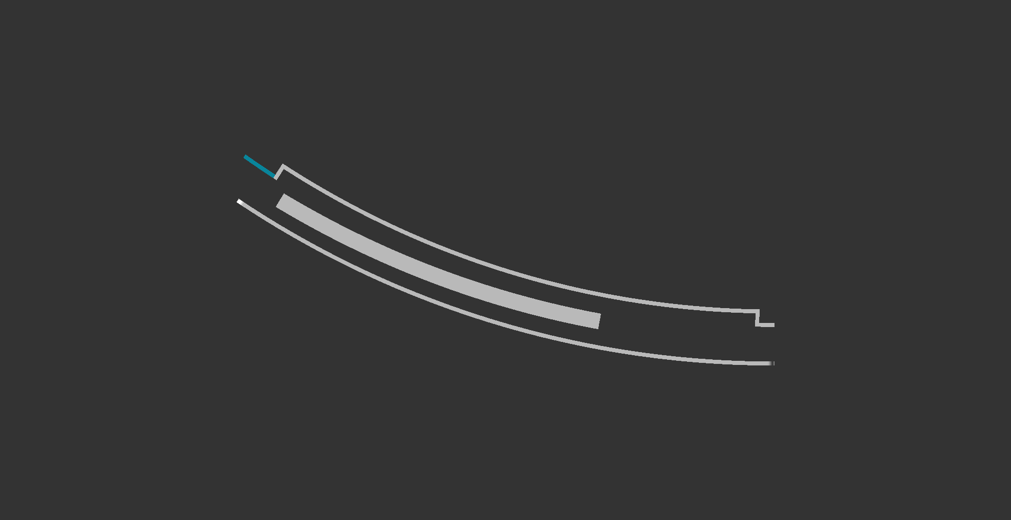

Spaced assembly from the side
EDIT: I just noticed the renderings didn't include the top-plate cutouts at the upper corners for allowing the pegs from the lower portion of the shell to slip through. This change was made before ordering the water jet cutout, but after the higher-res rendering. It is a very expensive process on the PC to generate these renders on curved planes with test-fit barrels, so I will leave as-is, but noting the change in case someone is evaluating this in real detail
Also, I am not going to be able to brake the offsets on the top and bottom of the top plate using a metal hand brake (what I have), because the ~4mm offset is just too tight for the brake plates I have (by literally 1mm). When I return from my work trip next week, I will have my machine shop friends use a press brake with appropriate die. Should produce a cleaner bend anyway than my artistic version. Video below showing a press brake in action. The 300mm radial curve has been rolled into the FSSK version already, and looks quite nice

The Initial Metal SSK Test...
I am happy to report that after a few hours of processing the metal, we have some success to report on the SSK metal prototype front. I am currently typing this from the board, and am for the most part very pleased. I uncovered a small number of issues that are minor, but will mention later after the pics. Again, it is good news, I just report pessimistically :)
What makes up this current build
  • Metal top plate (18 gauge carbon steel... too thin) that has been cut with nitrogen gas for both AT and XT barrels, and bent at ~275mm radial bend. All holes in the top plate are tapped for 2mm screws. Ground screw "taped" off before painting in case it is needed later (so far not the case)
  • Metal back plate (20 gauge... what both should have been... also nitrogen cut) at a 300mm radial bend. The M2 screws in the bottom plate were counter sunk for a tight profile. As with the top plate, the ground screw fender washer was masked.
  • Foam is a neoprene die cut that Phosphorglow was nice enough to send me. It is a bit on the dense and thin side for a production run for later, and is VERY clingy (there is some type of adhesive in the material when compressed).
  • Barrels/flippers/springs are stock from IBM out of an IBM Bigfoot and AT
  • i$ PCB for the FSSK project
  • xWhatsit F controller with a crude ribbon cable. I have managed to procure some .156 pitch cabling from work (don't tell) as a sample, and will use it on the final prototype later (if needed)
  • Fasteners are provided by Fastenal, and I am EXCEPTIONALLY happy with the end result of m2 screws around the bottom and side perimeters, with m3 on the top of the board. I used double sided washers on the top (everywhere else we tapped), with fender washers for the ground screw location if needed.
PIcs...
  • Raw metal after tapping and counter sinking
    Top plate with m2 taps on all holes except the top
    Backplate countersunk
    Note the differences in radial bend between the top and bottom plates.  This is what adds extra pressure to the center key rows.  It took multiple attempts to get this right
    Ground screw taped off for the fender washers in case needed later
  • Plates primed
    Top plate with self etching zinc primer
    Back plate
    Back plate
    Backplate countersinks
  • Plates painted and beginning of assembly
    Top plate painted (this is by hand because my HVLP paint gun is on loan to a friend
    Top plate barrel fitting
    Top plate barrel fitting back
    Flippers added...  ready to assemble
  • Assembled
    Fender washer for ground screw
    Countersunk m2 screws with spacers (had significant impact)
    Bottom row with spacebar ready to go for XT barrels
    Column alignment (running out of images for a single post, but both sides are identical)
    Happily peacocking its winkeys
  • It's new home. Time to unveil why I like the floating case concept for phase 2
    Where I work from when not traveling.  Love it
    Nestled by a glass of celebration...  It's goodness
Lessons learned, and corrections in the works
  • Not sure what I was thinking exactly, but the 4704/AT barrel lock was noticeable off. I am correcting the ~5 degree rotation
  • The F key row was off by ~.5mm from desirable. This has been corrected for both the SSK and 101-key.
  • The plates when processed from the machine shop were both curved at a ~300mm radial bend. I spent substantial time getting a smaller even radial bend on the top plate (smaller radial = more curved). There wasn't enough pressure from the top plate to hold the middle rows well. The lower bend radius accomplished this nicely (eventually)
  • The spacers (white plastic holding the plates on the edges is HUGE. Way more necessary than I originally anticipated. Functionally everything was fine, but the pitch was off on the edges. A firm adhesion with the spacer solved an issues on the edges, and will be better in phase 2 when we can have a full length spacer. Having one in phase 1 would require changes to the PCB from i$ (a big deal)
  • The pitch on the middle of the F key rows is off. Again, they work and feel fine (not noticeable with headphones), but F5-8 is slightly more muted. The thicker metal top plate would help with this, but I will proceed with other avenues in the mean time.
  • The spacebar stabilizer barrel should hold the stabilizer spring about 1mm higher to be optimal. This change has been made
All and all... extremely happy with the result. We strive for perfection, so we will try to finish tuning the slight sound discrepancies along the way.

Would you consider designing a standard Model M plate as well? We'd obviously need another capacitive PCB design, but it would add a lot of value to regular Ms.
lot_lizard
20 May 2016, 18:21
ohaimark wrote: Would you consider designing a standard Model M plate as well?
100% yes.... I should have had that in the post, but got carried away with pics. Thanks for reminding me. That is actually step 2 once the SSK metal version works

May I suggest adding additional holes for barrels between the Ctrl/Alts, for Windows/Super keys? I know that most people would not be keen to cutting their case to fit such keys, but since somewhere down the line you want to produce a new, all-metal case I think it would be neat to accommodate that possibility.

need wrote: What are the differences between a F and M barrel plate?
The M barrel frame is actually a single piece of molded plastic that contains all of the barrels while acting as the top plate. The barrel pattern itself is actually identical (why the FSSK project has worked so well). The F has a metal plate with cutouts for each independent barrel, with foam to help dampen and isolate resonance between the barrels. I will post a study I have done with literally every combination of spring, PCB, barrel, and flipper between the M and F (I tried every combination I could think of... it's A LOT of combinations).
The two factors that really make the F experience so much more "crisp" are the flipper surface area on contact, and the isolated barrels (even more so than the foam). The next biggest factor is the quality of the plastic of the F barrels themselves and lack of friction they have on the keystem. Even a simple gouge test of the two plastics is very revealing.

pyrelink wrote: One question for you, (not really important, but just to sate my curiosity) do you happen to know the thickness of the neoprene foam that you had Phosphorglow cut for you? Was it 1/16"?
I should have measured... Apologize for that. 1/16" (~1.5mm) would be very close before compression based on handling. Since I knew it was temporary, I didn't pay too close of attention. The important part that it helped me with was knowing that the "flattened" version of the top plate was true. I was then able to take that and send off to have the metal top plate cut with a water-jet (used Big Blue Saw for the prototype, and should have back in a couple of weeks).
It will come back flat, and I am actually planning on experimenting with the flat plate a bit first before I roll (curve), break (bend), and tap the screws myself. The bend to the plates add substantial rigidity, but I would like to know how much of that is really perceivable. The reason I even point it out, if the plate can be close to "as effective" (perceptibly) in flat form, we can further stiffen with increased thickness or press ridges like the beam spring plates. Then the Cherry MX key idea REALLY has amazing merit. As it currently stands, the pitches of SA/DSA would be altered by the plate pitch, but not severely. NOTE: this wouldn't be something to even consider for the drop-in replacements at the moment... only if we decided to make our own cases (but I would still like to know for later).
The following was something put together to show what the pitches of the various Cherry MX profiles from SP would be on a 295-300mm curved plane. The blue outline are standard IBM keycaps. I was very pleased with the potential
EDIT: I literally just got an email saying the plates were shipped from Blue Mountain Saw. Those guys really are the best if anyone ever has a similar need (I submitted 2 days ago). Even in bulk they are very reasonable for domestic work (10+ quantities, they would have been sub 50 USD a plate). So we will know something next week :)
pyrelink
20 May 2016, 22:13
Gotcha, 1/16" is what I used on my other Model Fs, just wanted to confirm. Getting SA keycaps on a Model F would be seriously cool, and if I understand what you are talking about correctly, your idea is to see how well the board holds up when used with a flat plate/PCB, as that would eliminate the profile issues with SA keycaps?
The other thing I am interested in hearing more of your thoughts on is this:
As you know the original setup for Stabilizers kinda sucks for the Model F. They have those really weak popins that can easily break, and you are relying on wires. Usually now you just use the Model M barrel stabilizers for most of the keys, but you still have the issue with the Spacebar. I know Wcass (I think) has that washer method for replacement clips etc.
I know you also have that fancy space age looking render for the spacebar/MX mount adapter. So I was wondering what your thought process is for stabilizers.
EDIT: just took a closer look at the main render again, and see where that barrel fits into the plate. So basically just use these stabilizer barrels for the space bar on the 5th row.
lot_lizard
20 May 2016, 22:51
pyrelink wrote: \would eliminate the profile issues with SA keycaps?
Exactly... we would be flat like the Cherry boards, so the profile of the caps would be identical. There are a lot of moving parts here in these special key caps (Capslock, Shift, etc.) and sweet talking i$ into potentially moving the PCB around a bit to make it work (it seems very doable, but needs more study). I would only be interested in the Cherry MX keys if we could do ALL of them. An errand IBM PBT would look ridiculous. Again, I just want to test the flat plate to see how crazy that seems. This thread is about to full of wild ideas (hopefully mostly from you guys fueling it :) ), so be prepared!
pyrelink wrote: just took a closer look at the main render again, and see where that barrel fits into the plate. So basically just use these stabilizer barrels for the space bar on the 5th row
Again... exactly. This one I am very confident in (other than the cost for the tooling for another ABS mold). Even if we have to 3D print 200 of these in HD, the cost will be very reasonable compared to spot welding clips in the assembly process. The other part, metal on metal is never the best idea regardless of friction force unless there is some lube applied on some frequency. This would take us back to the original IBM design of metal on plastic (plastic on plastic everywhere else) for moving parts. The more I study this stuff... these guys (and gals) really were bright, and typically did things back then for reasons other than cost (they were in an era would there was no competition, and the customer would pay). The M introduced cost savings. Plus this design gives us "easy" replacement at some point

emdude wrote: May I suggest adding additional holes for barrels between the Ctrl/Alts, for Windows/Super keys?
I know I$ already has spots on the PCB for split left and right shift, as well as ISO enter, but he is missing the ctrl/alt gap keys. I agree we should have one PCB that accomplishes any wants, and a top plate to match. I'll update the CAD for the plates soon to accommodate (won't be in the first metal protoype though). Nice catch

Muirium wrote: ...but going flat backplate is a huge change for a buckling spring board. I'd expect a dazzling new low-profile case to tempt me good and proper. With just enough room round back for a bank of batteries for the you-know-what!
Flat plates might be a complete "dumpster fire" of an idea, but I'll be in a unique place to try it... So why not?!? I have purposely left my second FSSK PCB from i$ flat for testing. If it I can get it very comparable (I'll try thicker back plates, different foam, etc), it would definitely open up options for us from caps to cases (at least we will know going forward).
