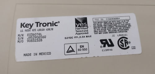

That looks like one of those Keytronic RDs, E03601 I think?
Harshmallow
23 Feb 2017, 23:47
alh84001 wrote: Thanks! And this one?
http://www.ebay.com/itm/Vintage-1991-80 ... 2254747613
Good call Emdude! I actually got a photo of the back label from this seller a while back cause I thought it looked like a model M or something.

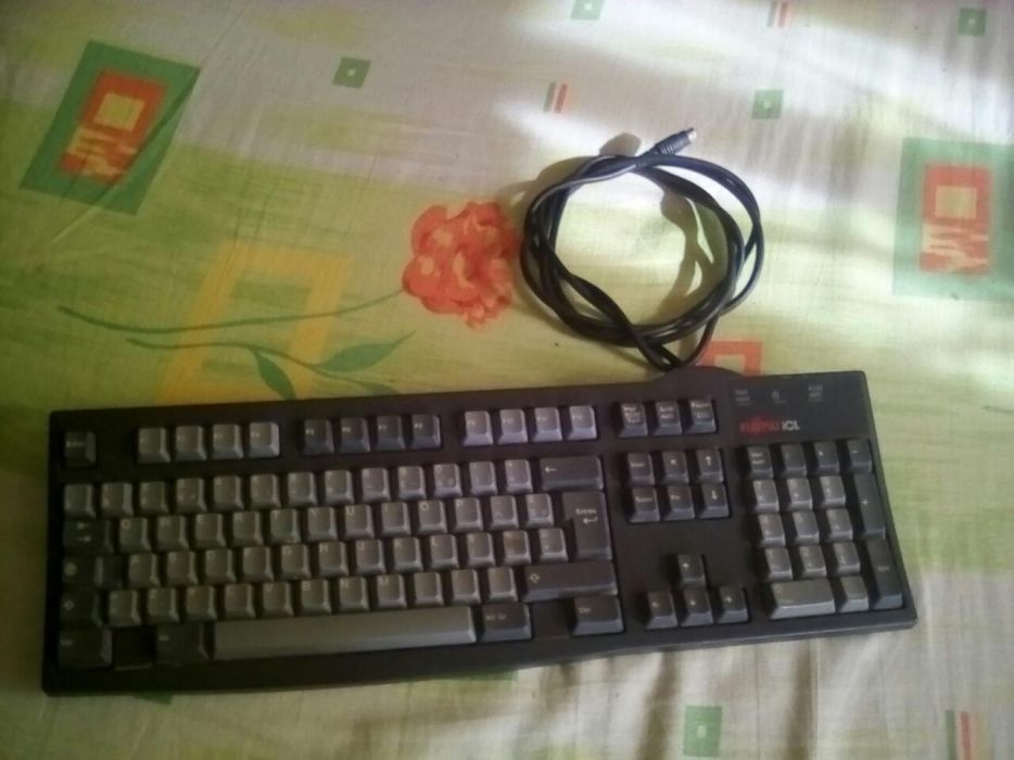

Who knows what model this Fujitsu keyboard is?
thebluefox
25 Feb 2017, 17:05
In the meantime I found out. It`s dome over slider, with high quality keycaps though.
