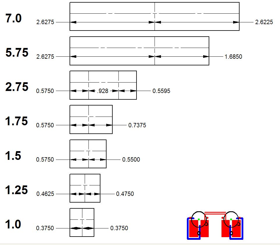

This is the spacing i use.
Model F key spacing.jpg (70.1 KiB) Viewed 6424 times
If you prefer metric ...
1u = 19 = 9.5 + 9.5
1.25u = 23.75 = 11.75 + 12
1.5u = 28.5 = 14.5 + 14
1.75u = 33.25 = 14.5 + 18.75
Code = 52.25 = 14.5 + 23.5 + 14.25
5.75u space = 109.25 = 66.75 + 42.5
7u space = 133 = 66.75 + 66.25
20.5mm row height
I place these boxes corner to corner to build key clusters (space between keys is built-in).

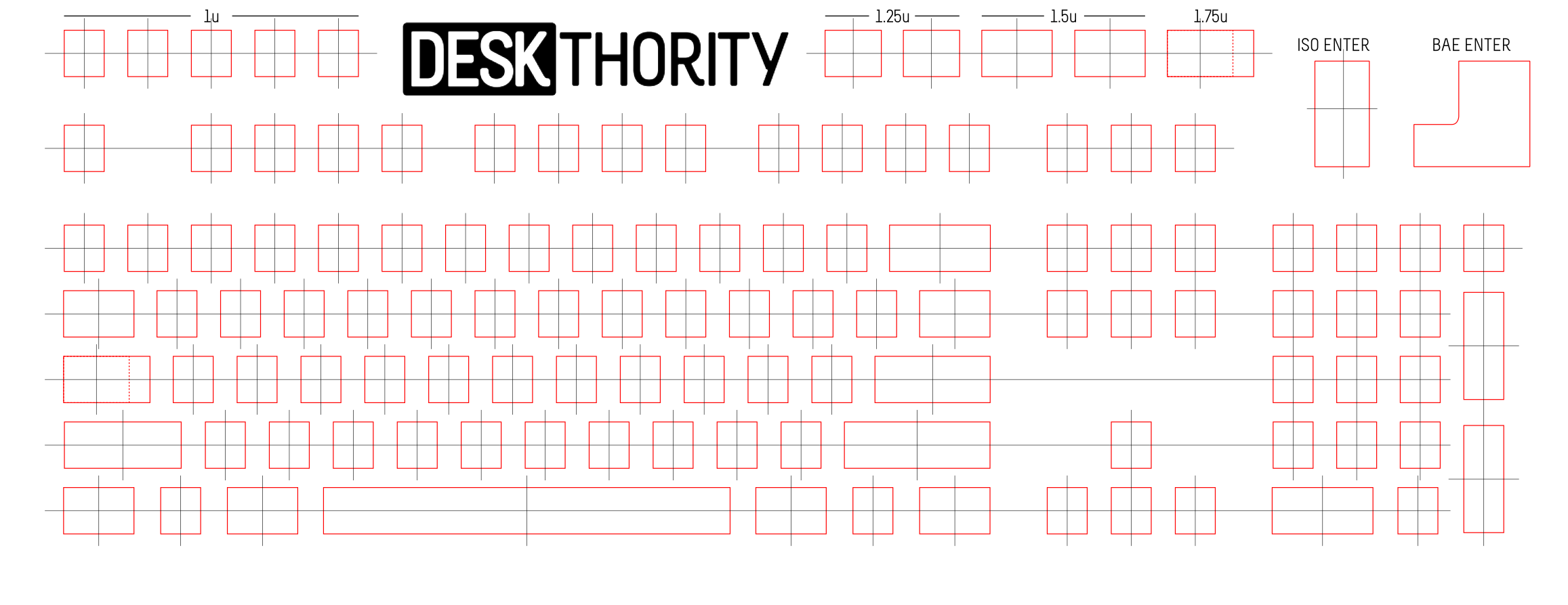

lot_lizard
05 Oct 2016, 19:39

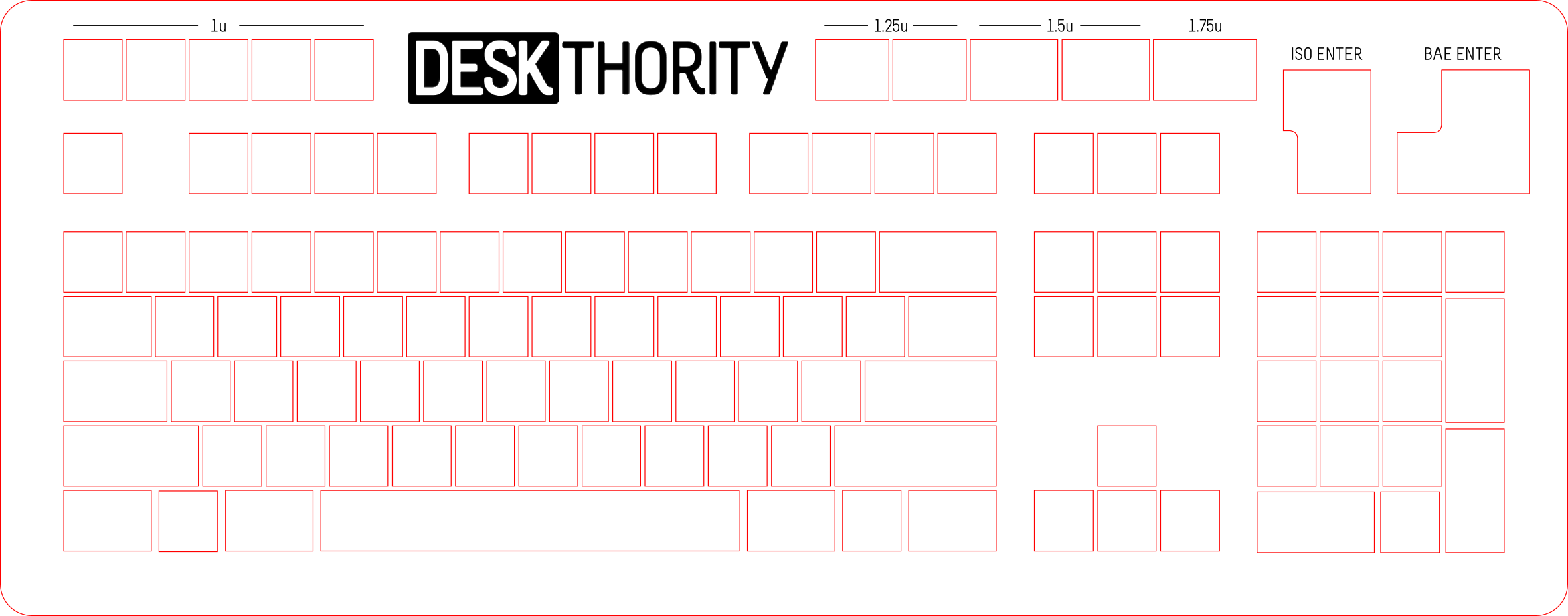

With updates... I believe this accounts for variations we mentioned, but a double checks are appreciated.
E TwentyNine
05 Oct 2016, 19:49
That's the BAE. ISO enter is vertical.
lot_lizard
05 Oct 2016, 19:59
Sounds good... does anyone know if that is identical to the XT enter? Otherwise I need measurements.
EDIT: just looked. It's not. Need some help there with measurements

lot_lizard
05 Oct 2016, 21:34
Ratfink wrote: XT enter is 1u wide; ISO enter is 1.25u wide for the bottom half, 1.5u wide for the top half.

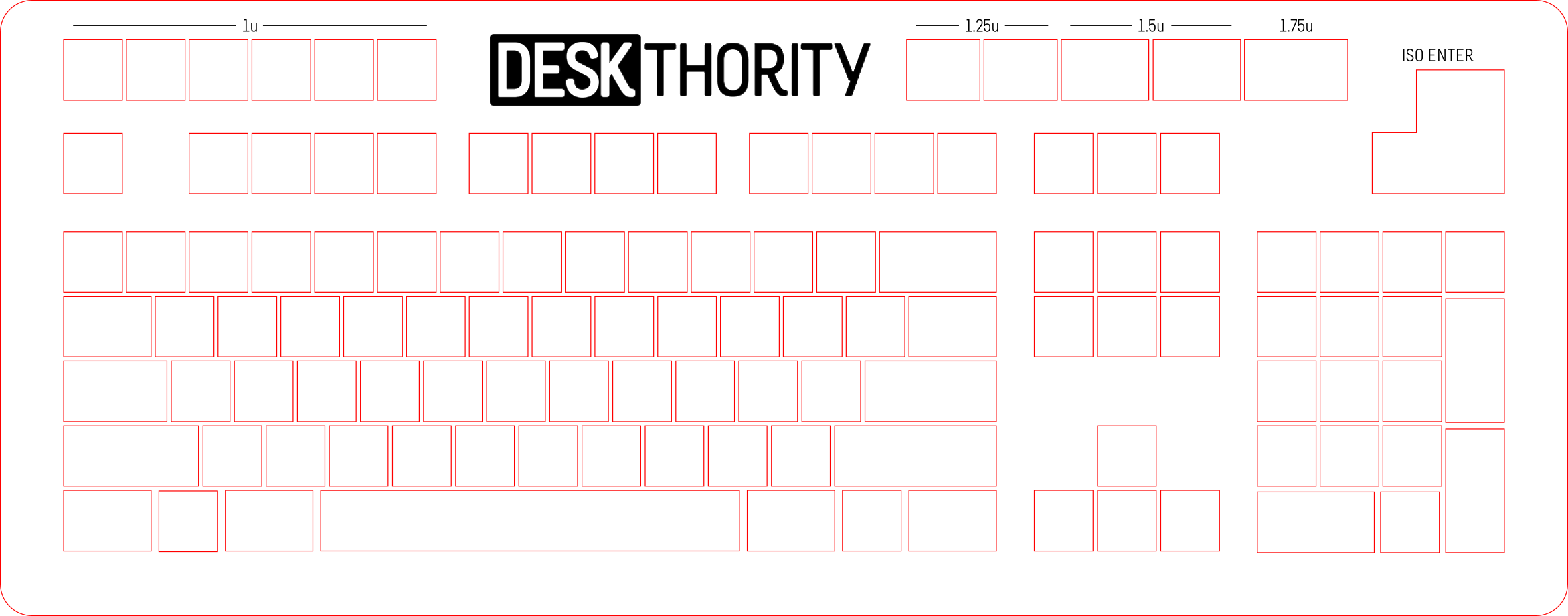

Thanks... With updates below.
This is a bit trickier than typical key spacing, because I am wanting .1mm tolerance (all sides) in the jig around the cap itself. I am wanting to turn on air-assist with this engraving process since we will be burning off 100+ caps at a time, and there will potentially be some smoke as the ink/plastic vaporizes. My compressor only goes down to 10psi (2/3 bar) reliably, and it will blow these light little caps around if they aren't secured properly in the jig. It's the real reason for wanting dedicated cap size spaces versus overloading. Smoke isn't a huge deal, but if there is enough of it... the laser looses focus. Might be overkill... but doesn't hurt.
06 Oct 2016, 10:30
so is split backspace and split numb pad + still an option ?
lot_lizard
06 Oct 2016, 10:52
andrewjoy wrote: so is split backspace and split numb pad + still an option ?
In that example, you would just use the spare 1u's at the top, and leave out the standard locations when filling out the pattern. But I believe the combinations we mentioned before can be accounted for with these extras. I might shrink down or 86 the logo to make more room for 1u's in the end, or as WCass mentioned... fill in the cursor key gaps. I can certainly make multiple runs as well if everything you needed didn't fit in one file. You can fill out as much of a template as you desired, even a single key is fine. I just have some spare acrylic sitting around, and this is about the limit of its size before it would force me to buy more :)
Also... the image you are seeing is for cutting the jig with the laser cutter. The template everyone will fill out in the end will look different. The caps will be smaller, only showing the engravable face of the cap, and there will be some sort of center cross-hair to you line everything up. You would take the SVG file template, add a new layer (so I can delete the template layer later when hitting "run"), and add anything you like over the top of any location. I just made it look like an actual keyboard to help you keep track of everything when filling it out.
lot_lizard
06 Oct 2016, 12:49
Since I know this isn't always the easiest to follow... I threw this together to better visualize what this jig is about, and to make sense why the template you will fill out later will be yet another SVG altogether.
The tool (jig) I am making is composed of multiple sheets of acrylic. Since we are allow for not only 2-piece cap tops, but wider keys... we will need to account for the key stems when the tool sits on the engraver bed. The red and black are what we have been looking at (red is a cut, black is engrave). This is the top layer that surrounds the caps and holds them steady laterally. The blue is another thicker acrylic sheet that will set beneath, and act as the lip that raises the caps off the engraver bed at a consistent flat height. I'll then bond these two layers (possibly 3, with 2 being the bottom "layer" since the engraver might struggle to cut 1/2 inch) together with some screw fasteners. We don't want to use adhesive since we might alter individual layers later.
Hopefully this makes more sense. I return from a work trip today, and will give it a go.

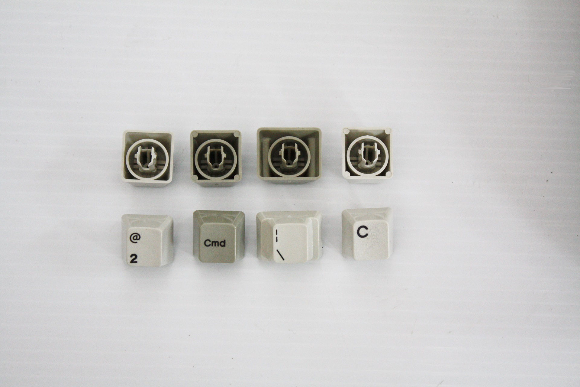

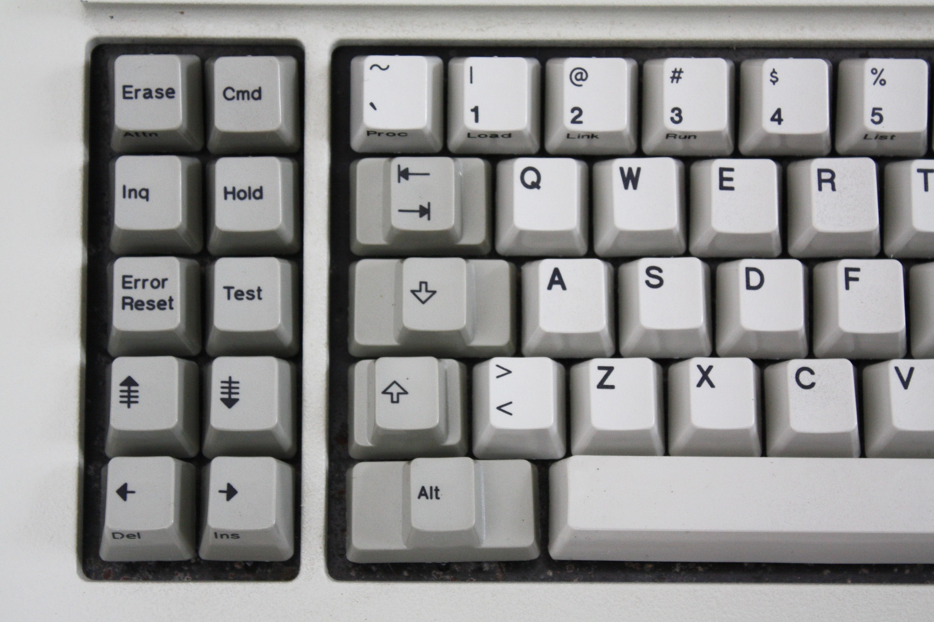

06 Oct 2016, 19:59
lot_lizard wrote:
Can you give me every variation of stepped and non-stepped keys I have to think about?
Snuci posted these cool things this morning:
IBM 5322 - key caps.JPG (244.13 KiB) Viewed 6216 times
IBM 5322 - keyboard close up.JPG (576.43 KiB) Viewed 6216 times
lot_lizard
06 Oct 2016, 21:13
Good point... Thinking about the silly XT guys is making want to avoid it altogether. Let's start with this, and we can always come back to the template and modify as requested (not a physical thing).
http://www.pckeyboard.com/page/product/mwide
I'm assuming the Unicomp blanks (the target of this exercise) are stepped for ISO Left Shift, ISO Enter, and Capslock. I have only ever ordered an ANSI APL set from them once. This BAE Enter slot is probably worthless due to lack of blanks, but leaving for the time being.
06 Oct 2016, 22:14
If you are talking about buying blanks and dyeing them, then Unicomp stock is probably about it.
I personally love stepped keys but I know that most people don't.
It won't help in the larger scheme, but I think that I have 2 Big-Ass Enters I could sell to somebody who really wanted one.

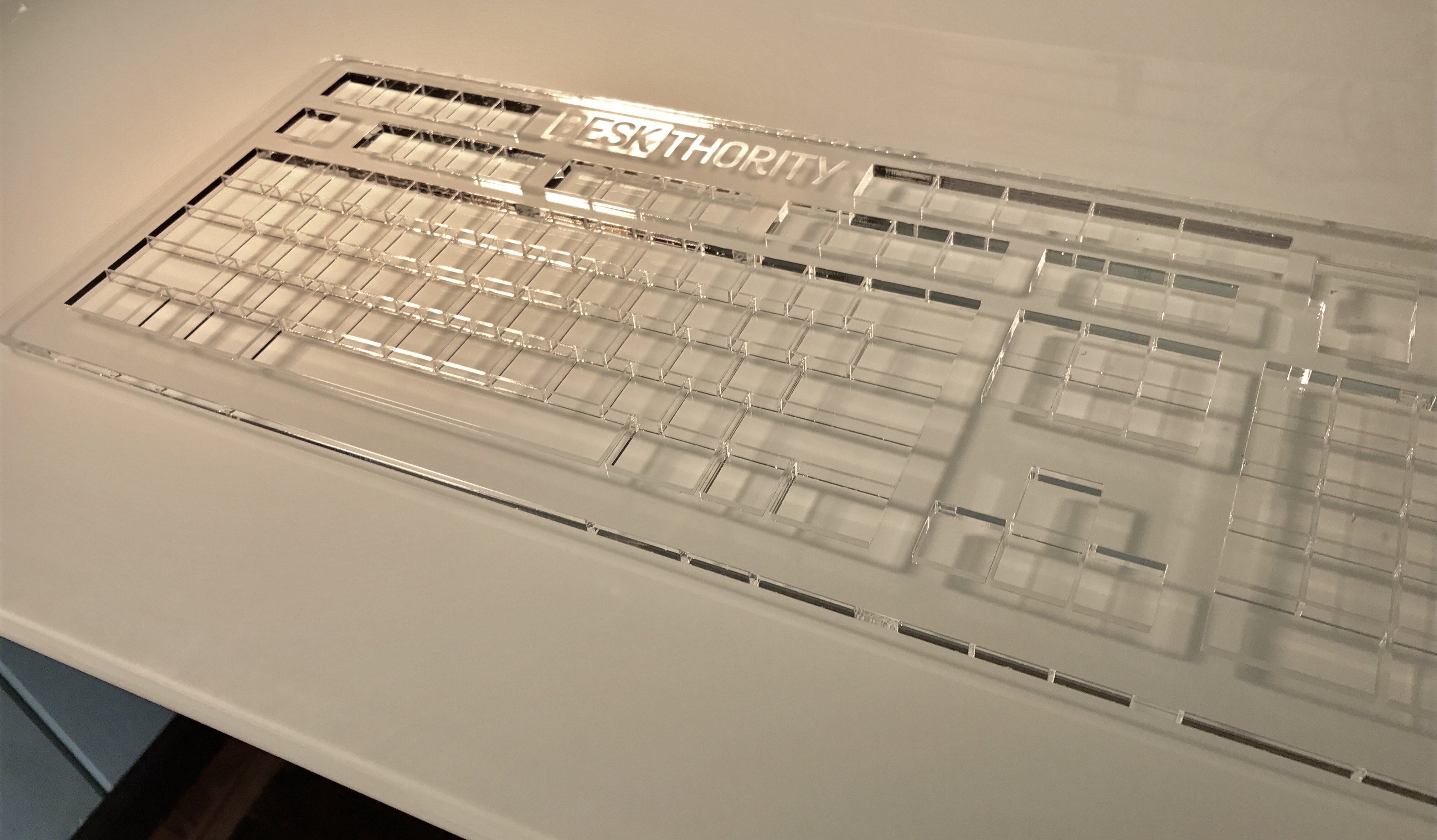

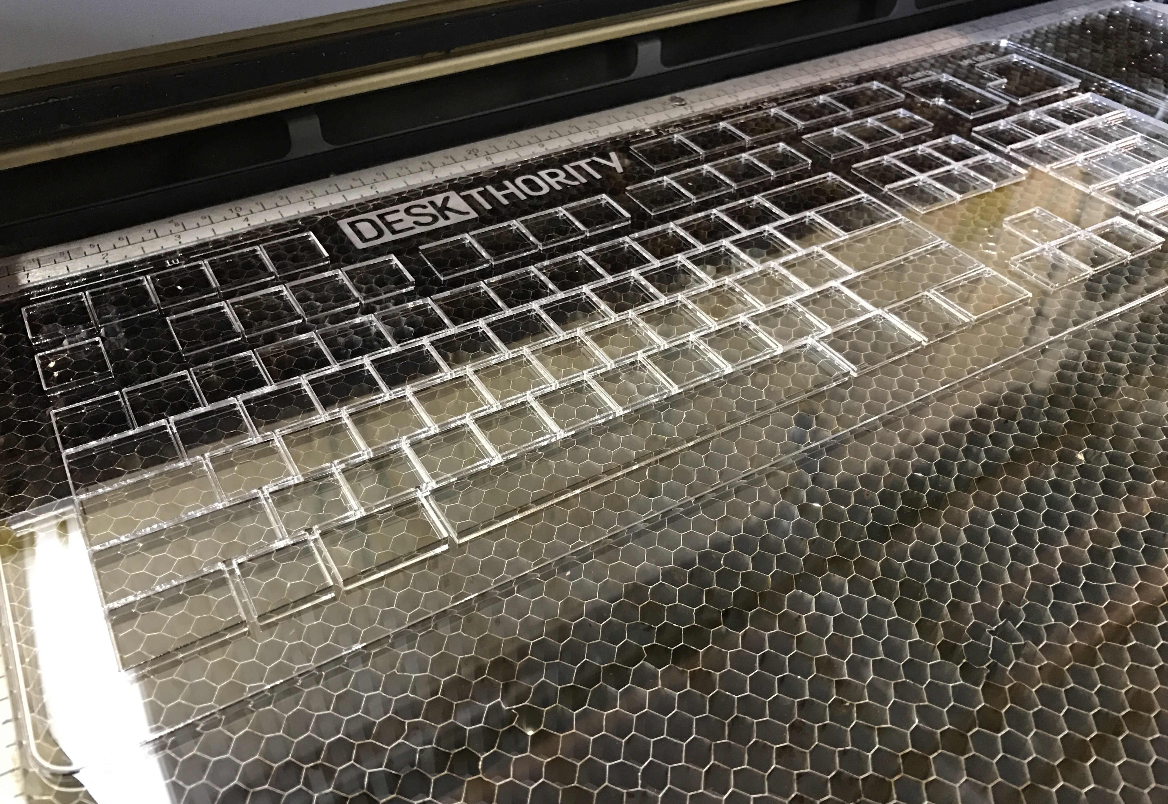

lot_lizard
06 Oct 2016, 22:52

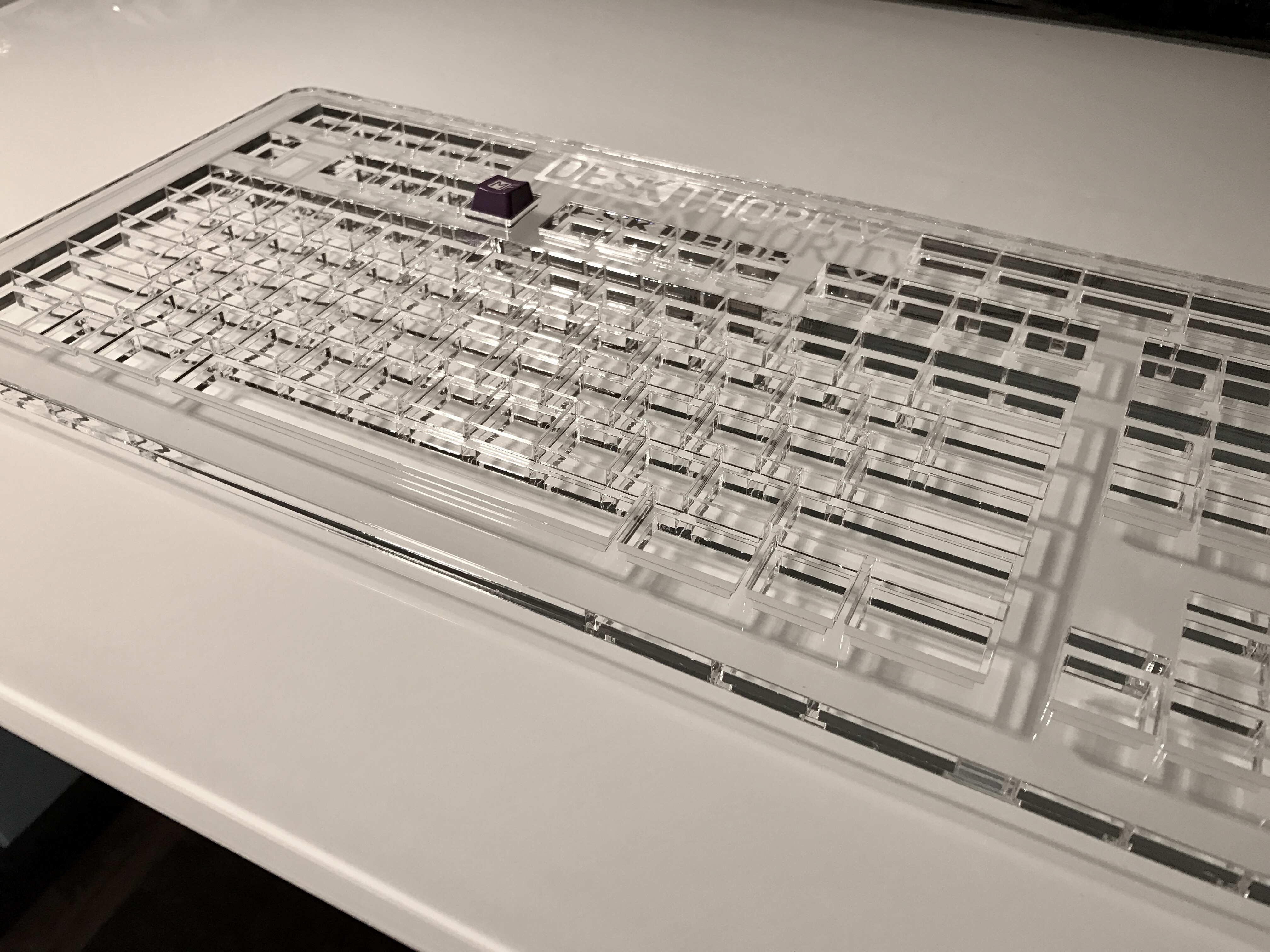

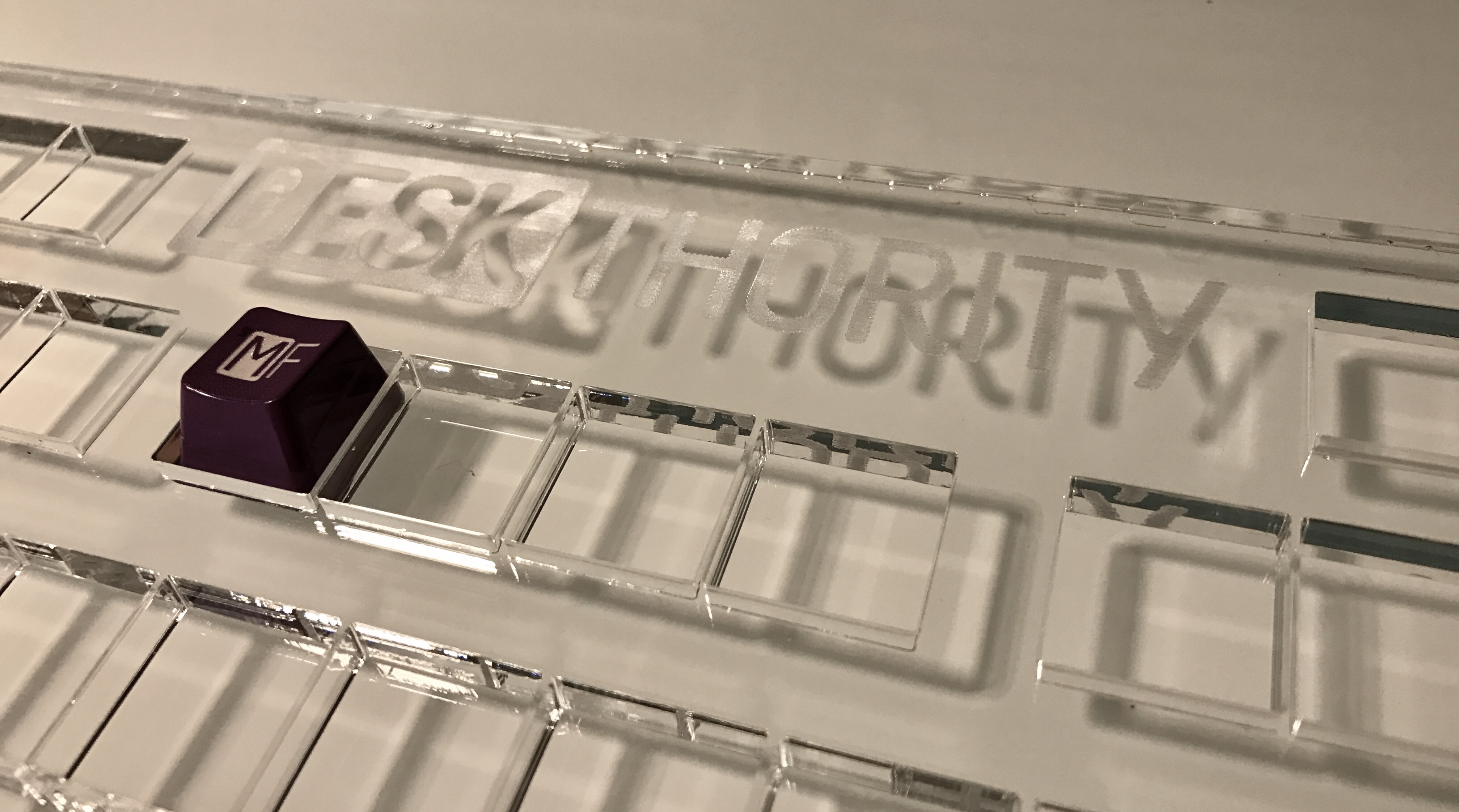

Short last connection, and plugged the plans in... Fits like a glove all the way around (surprised a bit actually :)). This is the top plate of the jig. It would be the only, but we have some keys with stems, so we have to raise the deck for all
Hopefully this helps to visualize what's going on.
Immediately after finishing in the cutter
Resting on some glass
With a 1u ready
With a 1u ready

Wow, that's cool! Back to your question about stepped keys, I don't think the ISO left shift is stepped; at least not the F/M-122 and Unicomp versions of it.

lot_lizard
07 Oct 2016, 01:15
Techno Trousers wrote: Ooh, semi-insane follow-up: Do you have any interest in lasering the *fronts* of keys? (Evil grin).
Not insane at all... I was going to kick the idea out too, but was afraid it was too soon to follow, and wanted this first pass to become viable. Front printing is actually a much more simplistic "tool"/template to produce.
Finished cutting the second sheet of acrylic that will act as the key bed (not sure how easy it is to see in the pic given the clarity of everything). We will need to produce one more of this bed sheet to raise the stems the ~1/2 inch we need. Given how it is turning out, I do think I will go ahead and permanently bond the layers. Just more stable, and really don't envision this changing much (better then I had originally envisioned). If we need additional keys at some point, I'll just make a secondary layout altogether.
I am anxious to test it out. The template for you to fill out is close to complete (lacks 3/4 of the "weird" keys). I would start dyeing caps if I were you ;)

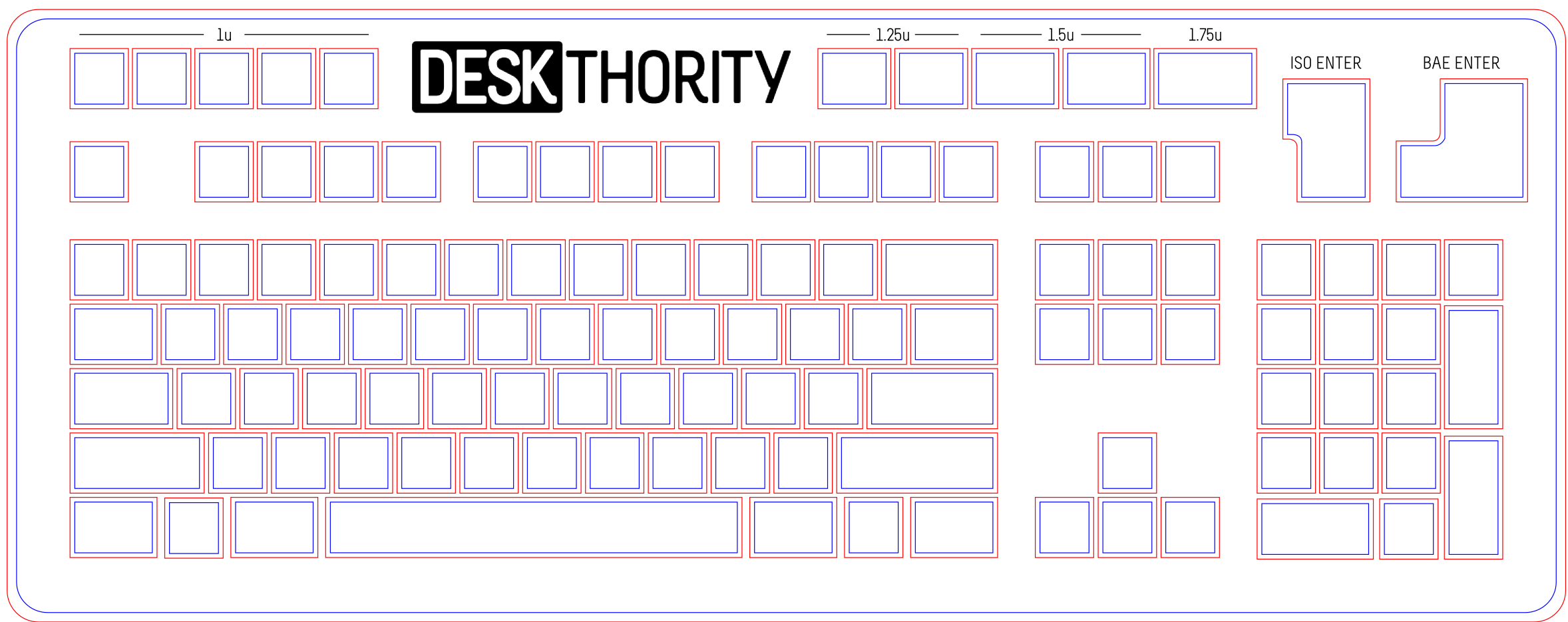

The template is ready to go (but extra reviews and thoughts are appreciated)... These are the key cap faces only, so line everything up like you would expect it to sit on the cap top. The red border is NOT part of the cap top, so make sure you sit everything inside. The cross hairs are a separate layer so you can get them out of the way if they are annoying you. Currently, Capslock is the only stepped key, and represented by a dashed line for the step. Remember... YOU NEED TO CREATE A NEW LAYER FOR EVERYTHING YOU ADD. I will want to remove the template and cross hair layers so that the only thing that gets fed to the engraver is what you have added. If any of this is causing confusion or there are other inhibitors, please feel free to reach out. I would like to see this thing get utilized given the upfront work.
Attached is the zip file containing the SVG template, and an image representation of the template. Use the SVG in the zip file as the template, and not the image below as a starting point.
